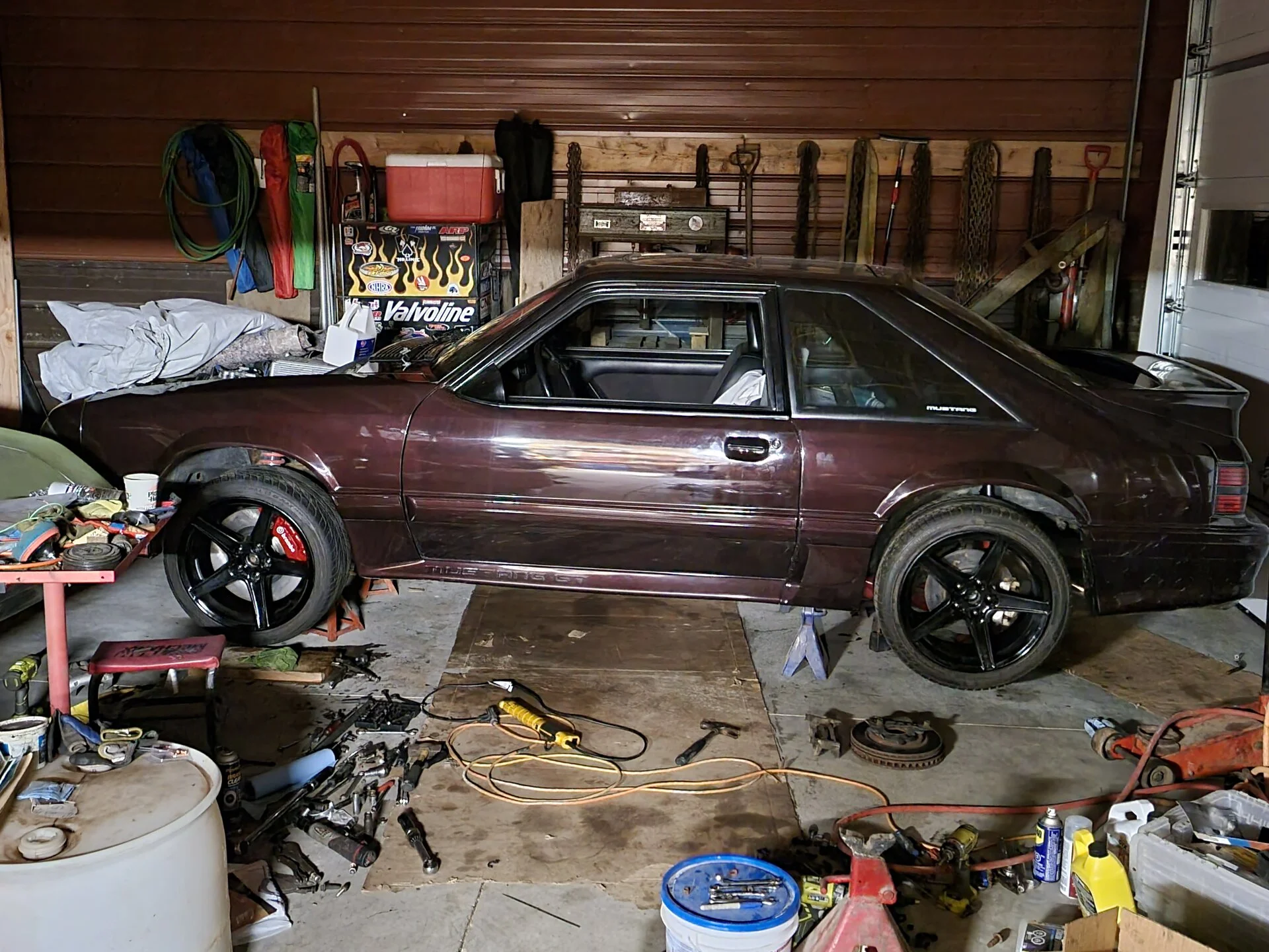

The bigger ones yes. Not sure about the 3 ton ones, but that next size up. 20210628_011600.jpg
This was my car while doing the auto to manual swap. In this pic the front has an okay 3 ton jack stand (can see the top of a big one in lower part of Pic beside blue lid pail). The back is held up in this Pic with a good 3 ton under my sub frame connector near the rear torque box.
Reactions: General karthief
Agreed, the bigger ones (5 or 6 ton) either lowest setting or first or second notch. Basically as high as my floor jack will lift when under the rear axle and k member.
