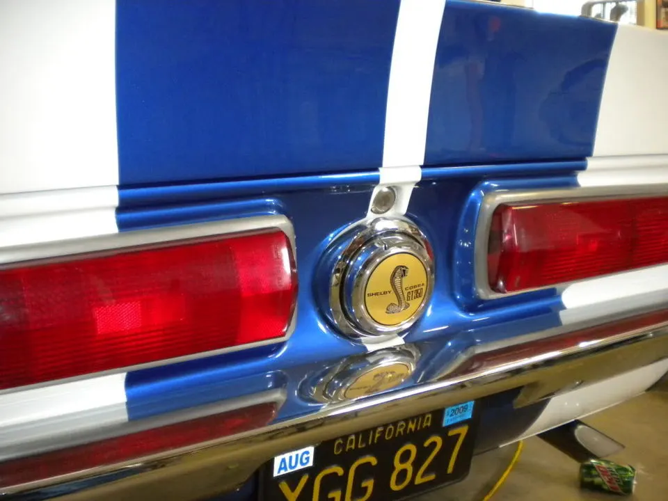

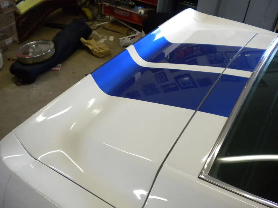

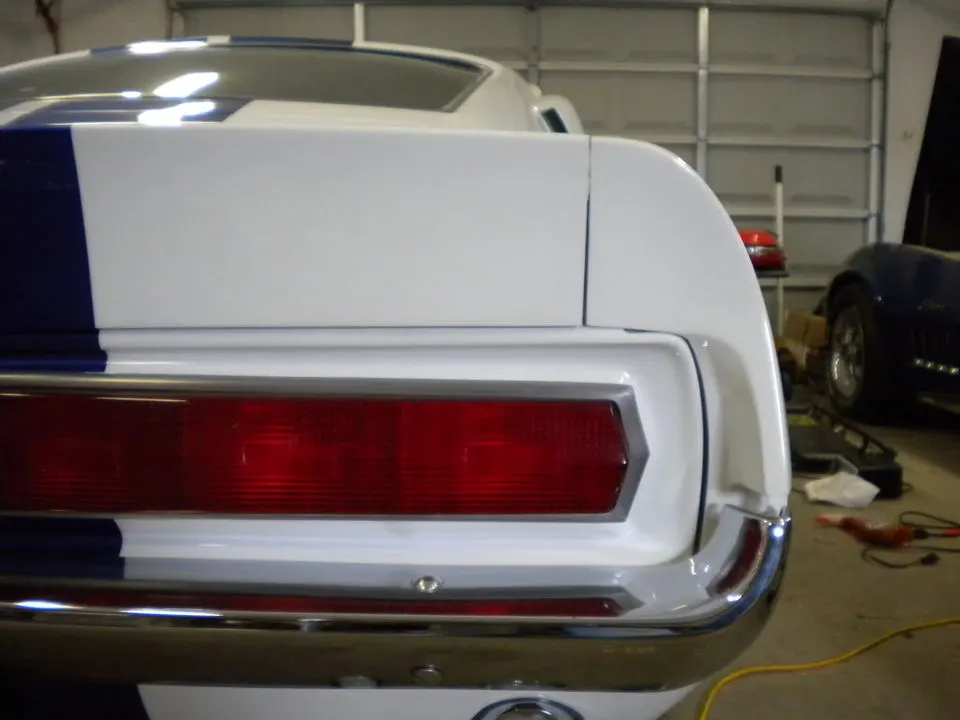

I'll post some pics of mine if you tell me what you want to see. I can tell you this much: bolt on the rear bumper and line everything up from that. The bumper cannot be moved front-to-back and I learned the hard way that if you just start bolting stuff on, it's likely too far forward. I got to do mine twice.
Here's a few quick pics. I don't know where you got your stuff from. but I got mine from Branda and it didn't fit at all, especially the end caps. They took plenty of work just to get them on the car. The trunk needed to have 'glass added all the way around because it was too short, too narrow and the gap where it meets the taillight panel was HUGE. The taillight panel was another headache and it too came from Branda. Get used to making fiberglass fit yourself because none of the parts I bought from many different suppliers fit any better than the rest of it. Hope this helps, Jim
