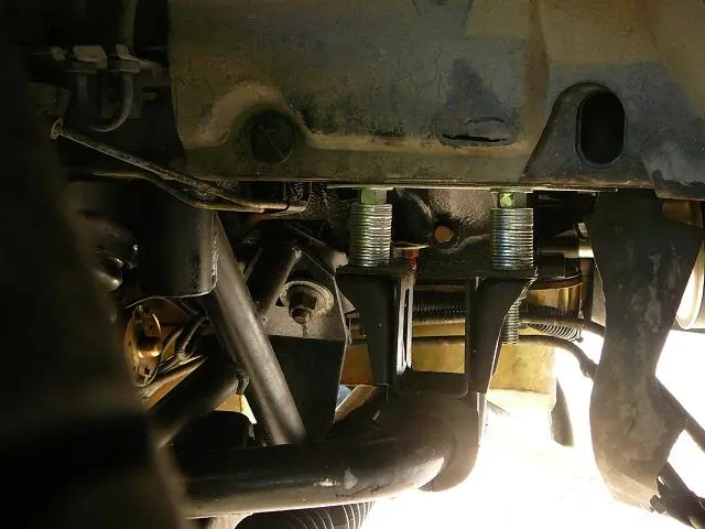

Well, I am answering my own question. I built some spacers for the stabilizer bar brackets using some 3 1/2" long 3/8"carriage bolts, a couple of thin metal plates, and about 80 or so 5/16" washers. That moved the bar down low enough that the bar now goes under the oil pan when the car goes over bumps. It also makes the geometry of the stabilizer bar end links more desirable.

stabilizer bar=sway bar ... the bar that attaches on each end to the lower control arms. it is held in place on either side by brackets that bolt to the frame.
i can take some pics of it and the way i lowered it so that it wouldn't hit the oil pan
