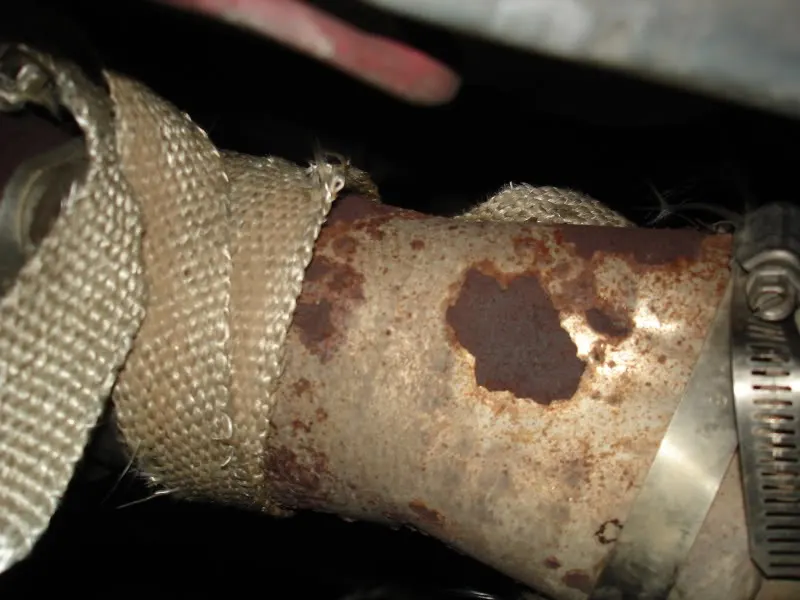

Ok then this isn't rust. on my bbk Longtubes. that are 2 1/2 years old, I do daily drive my car.

hmm... yes that is rust. I have no idea if it was because of the header wrap tho or your environment. I am not trying to get picky on you but if it was because of header wrap then why aren't mine rusted? Most headers will get rust after a few years tho as they are metal.
And after reading what everyone say this on the net, I thought my cheapo flo-techs should be rusted thru after 3-4 years and they aren't and they look nothing like that. After having no rust with 2 sets (same wrap as you it appears), its almost as if it protected them. My wrapped headers look better than my accufabs at this point. hey,..thinking as I type..I forgot to mention that I always coat mine with a high temp silicone spray sealant as it was recommended before putting any header wrap on... I did this on BOTH sets. My bad that I did not mention that first.

Header wrap rusts the crap out of your tubes. It locks in all the moisture. I used header wrap on my BBKs, and within 3 years, I had a header tube colapse it was so rusted out. I even used that silicone spray. I'll never use header wrap again.

I hear ya and I hear that all the time - fewer 1st hand examples. But I used it for the same length of time with no issues. You both had BBK's. Maybe buy the cheaper flowtech's next time.
