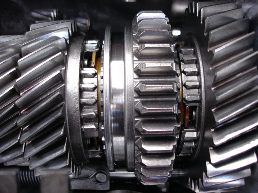

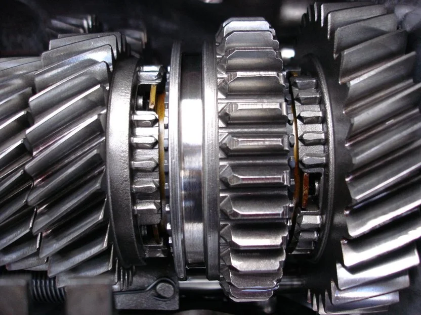

Here's some pics of a 2nd gear popping and grinding culprit. You can see what i mean
Here's the damage to the synchro slider
And here's a healthy gearset. It's actually an '85 T-5 with 20K original miles :)
