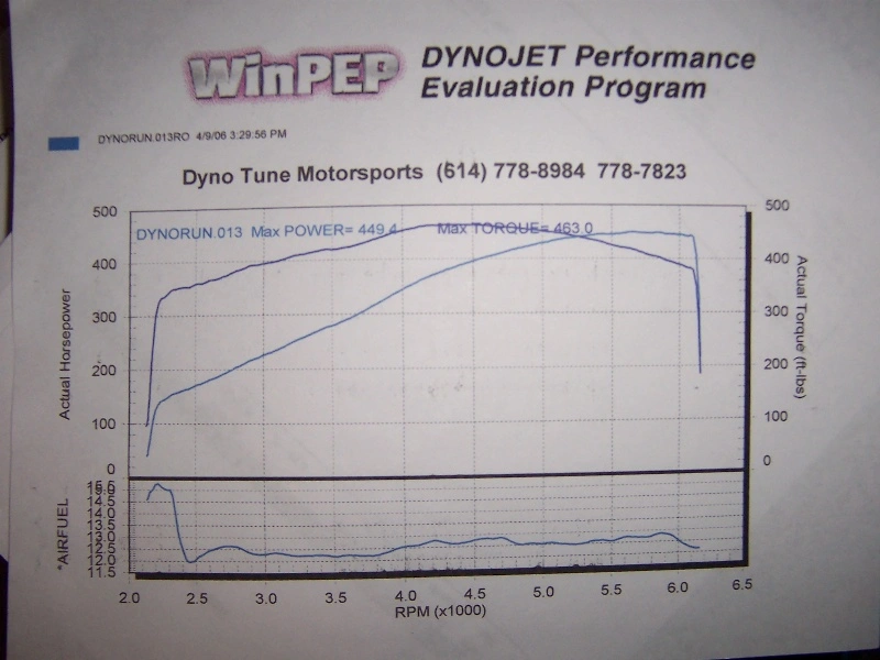

my combo is similar to his in some ways ... 408 (+/-) flavor, AFR heads, custom cam, kooks headers.
he has AFR 225s, mine are AFR 205s.
he has a Victor EFI intake, mine will be a RPM intake. I'm going for a lower rpm range
he puts down 449 at the wheels :nice:
i don't have dyno numbers yet. it is still being put together. i am hoping for 450 at the wheels too
Sig
Dyno Sheet

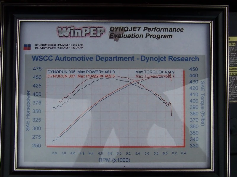

A friend of mine has the same combo as mine, except his is a 427, TFS stage 3 cam, and Spyder intake w/90mm tb. Here's his dyno sheet.
