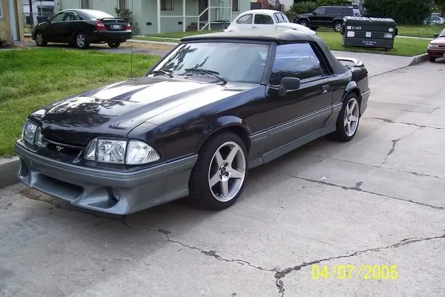

My Stang:
Those wheels have me torn between converting to 5 lug or staying with 4 lugs and getting those. At first, the replicas were said to have a chance of being available in 5 lug, but now WR says not anytime soon.
BTW, Manson, do you have a drum setup in the rear? That's what it looks like to me from the past two pics you posted. If so, I'm curious how you feel it performs with the 13 inchers up front. How difficult was that conversion to do? I've read up on it so many times and it doesn't seeem hard to do, but I have never removed a MC or Brake booster.
Currently I have drums, only because I had to get the car together for FFW last weekend and didn't have time to do everything I needed to do, including rear-disc swap. So I didn it the quicker way.
It performs better than stock, that's for sure and probably obvious. The big dual piston setup in front stops the car very well.
I'll have the discs in the rear next week, at least that's plan. I can't wait to see how it stops THEN!
