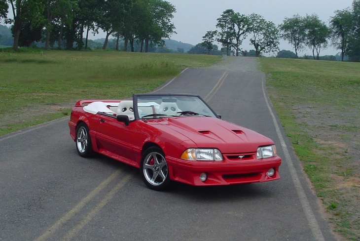

Seeing that I have one on my car, yes I'm sure :) But you're right, it's Cobra STYLE. My car:
Since the Cobras were hatchbacks, the wing doesn't really flow well with the convertible lines, so modified versions were made in the same style to work with them and coupes.
