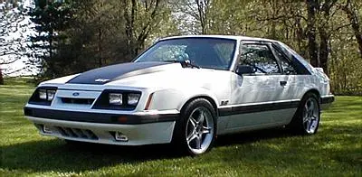

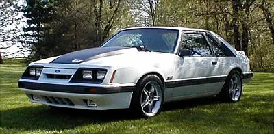

There is no better looking mustang from 1979 to the present
A picture says a 1000 words. The style factor alone is worth not spending too much time worrying about the few HP that the 86 motors were down. Like has already been said, all you have to do to bring it up to post 87 HP specs is install some E7 heads and a later upper intake. Both can be had for cheap to absolutely free since so many poeple have this stuff taking up space in the garage after swapping on aftermarket stuff. If its a solid car, jump on it. They are getting harder and harder to come by.
