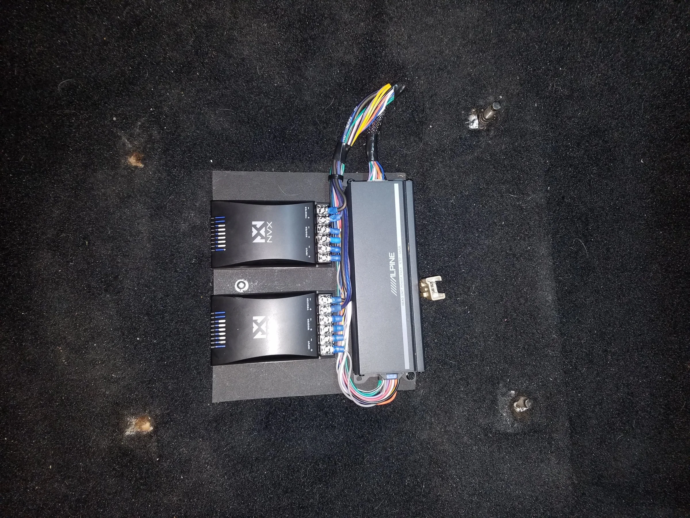

My car had 6 speakers in it when I got it but not the premium sound system. The dash and door speakers were just wired in parallel with each other. I installed a component set and used the factory wiring for the mids in the doors and ran new wires to the tweeters that I installed in the dash were the 3.5" speakers normally are. I used the Metra harness to interface my Alpine amp to factory wiring. Here's a picture of the amp and passive crossovers under my passenger's side seat.
Thanks! It has been great so far. Plenty of power in a small footprint. It's actually the 2nd one I've owned. The 1st lived in my boat for 2 years till I added a sub and swapped it for a 5 channel. It was also flawless.
When I got the car it didn't have a factory amp just a Sony head unit wired into the factory wiring with a Metra harness. I guess it could have been removed long ago.
