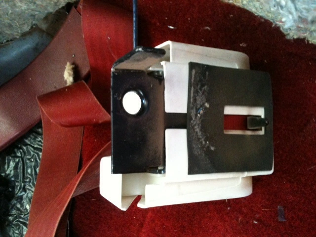

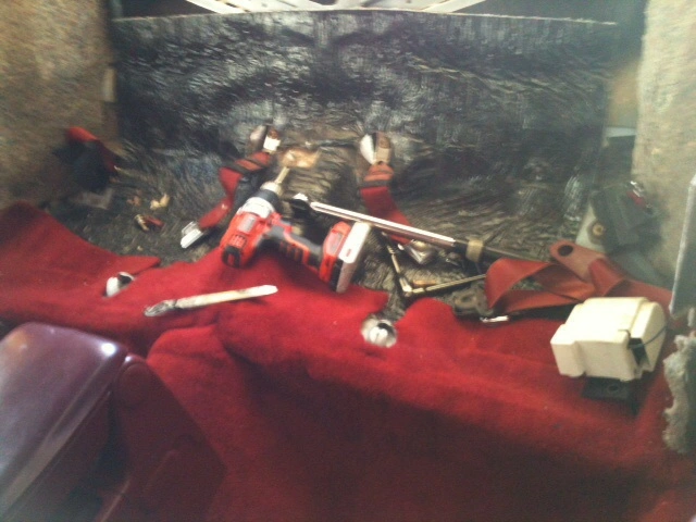

I used LMR fronts as my stockers were not retracting very well. Scarlet red in color with door grommets for the hole that be there after removal. I'll take some completed pics. The new ones seem to work great.
