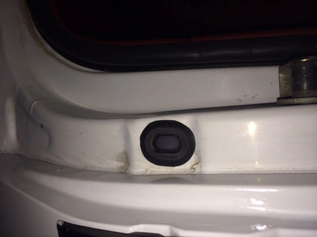

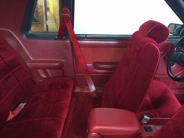

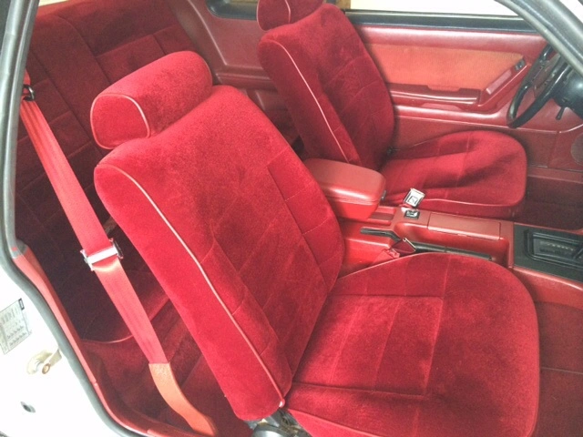

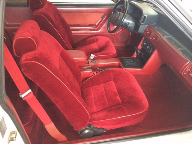

Completed pics after adding:
LMR seat belts
LMR Grommets
LMR Belt sleeves
LMR Belt opening bezel (originals will break)
Reactions: Jarrod@latemodel

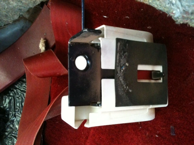

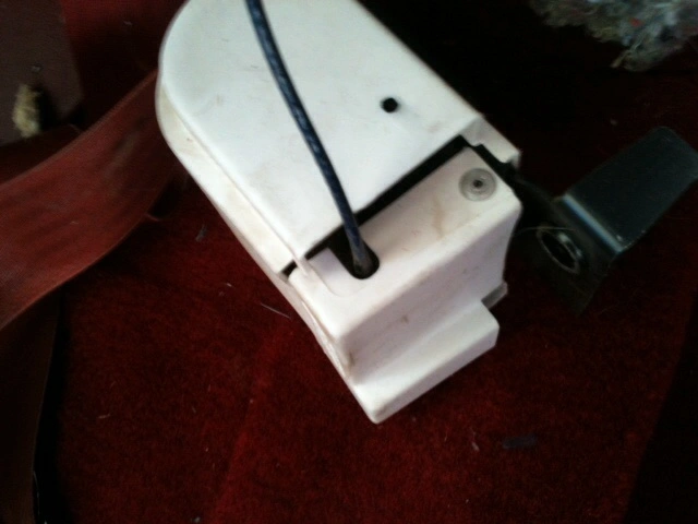

The stock seatbelt has a retractor button. When you open the door, the retractor engages and the seatbelt retracts. Take a look at the stock pic, there is a back cable attached to the retractor button. The new belts do not have the white casing or retractor button. You simply use the grommet to plug the hole of the now removed retractor button. There is no further use for it. To remove you have to drill out the rivet and uninstall the assembly. Hope that helps.
