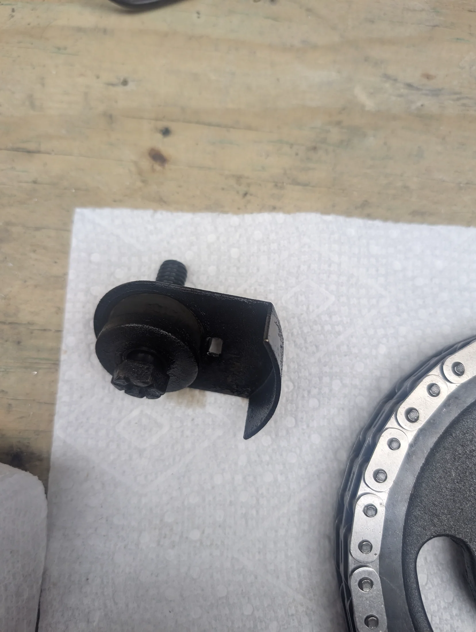

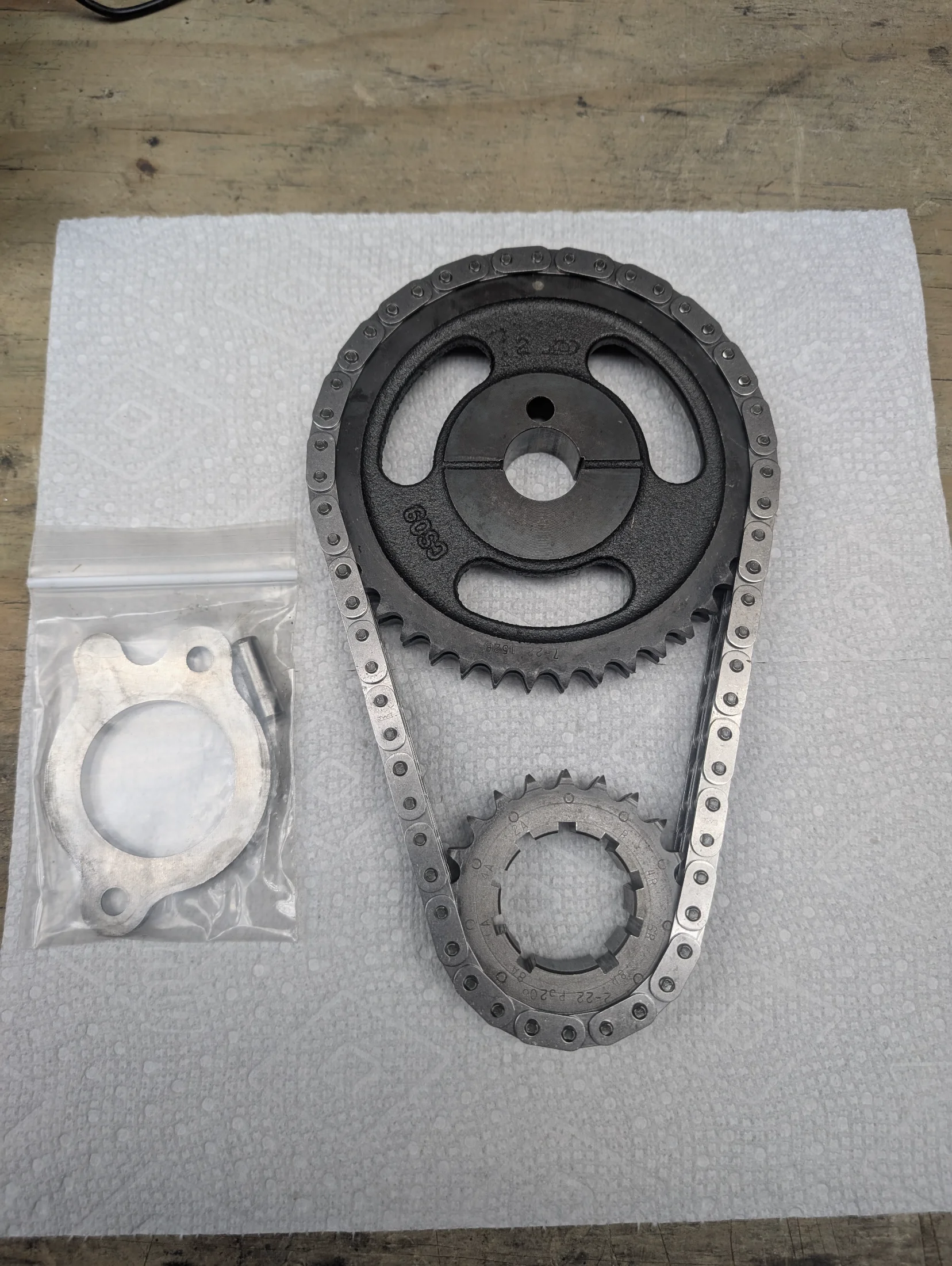

I bought a new bolt, but do I reuse this little bracket on the cam sprocket? Or no since the new is balanced? Also, on a stockish engine, any reason to alter the timing at the crank?

New hotness.

OK. So I can't find any info on this here or the web in general.
This thing was on the front of the cam sprocket:
It has a tab that locates it in the dowel hole. Also the rotation axis of the sprocket that was on there is eccentric. The new one is not:
What does that mean to me at this juncture? Nothing? Bolt it up with the new and send it?

Nevermind. I'm an idiot. It just looks eccentric because of the way it's machined. But the question still stands if I need this add'l washer with the bend in it.

That thing is called an oil slinger. If you Google that term you'll find info on it. I'd put it back on. Just make sure the nub on it doesn't contact the dowel pin and keep it from sitting flush.

That L shaped piece is for a manual fuel pump,
NO! I figured that much out. The manual fuel pump thing looks like a full cup. that requires a longer dowel

Fwiw I always put that back

Degree the cam. Never hurts and it’s free hp at this point.
I do not have that slinger on any of my SBF’s but it’s there so bolt it up.
