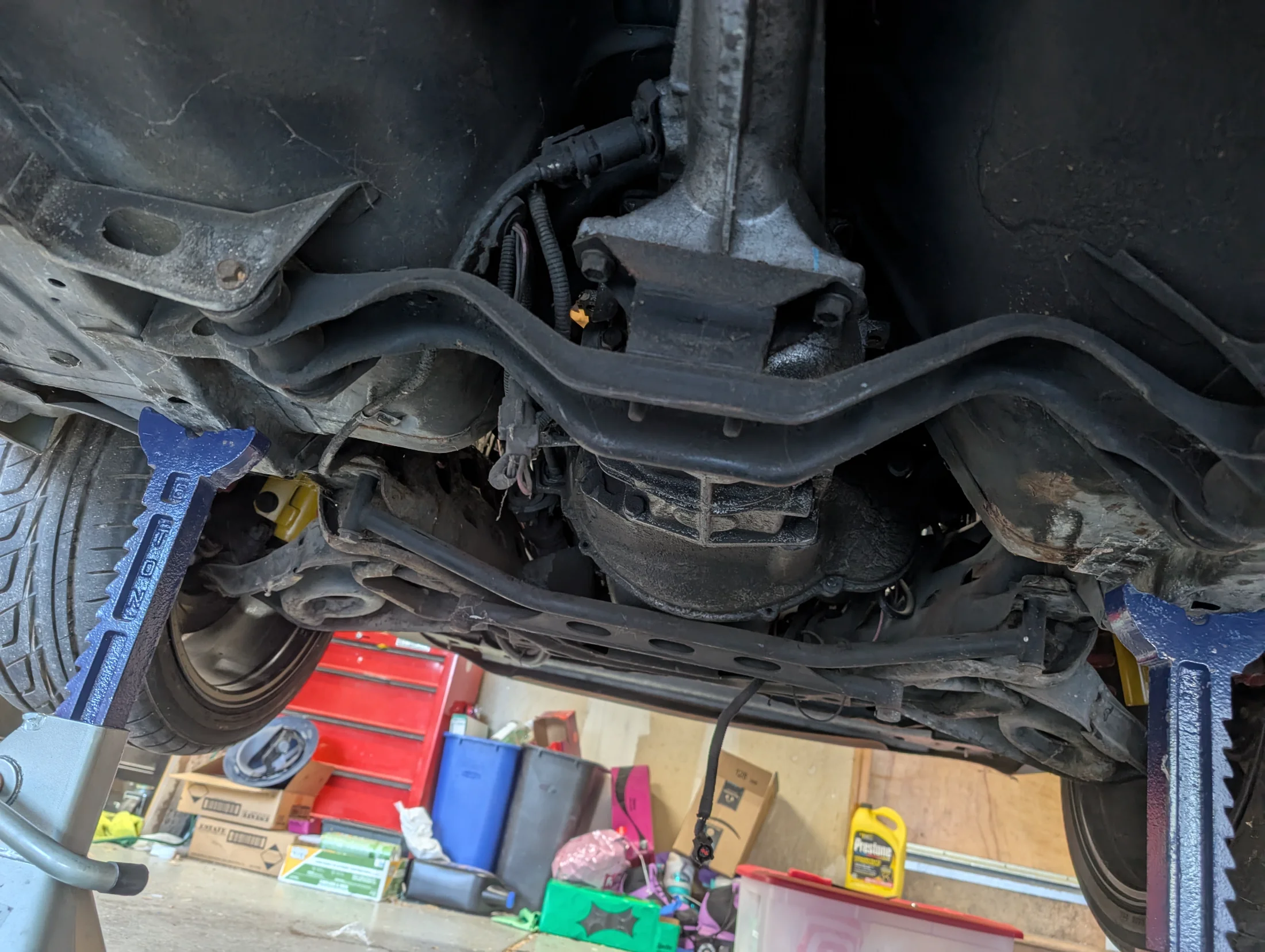

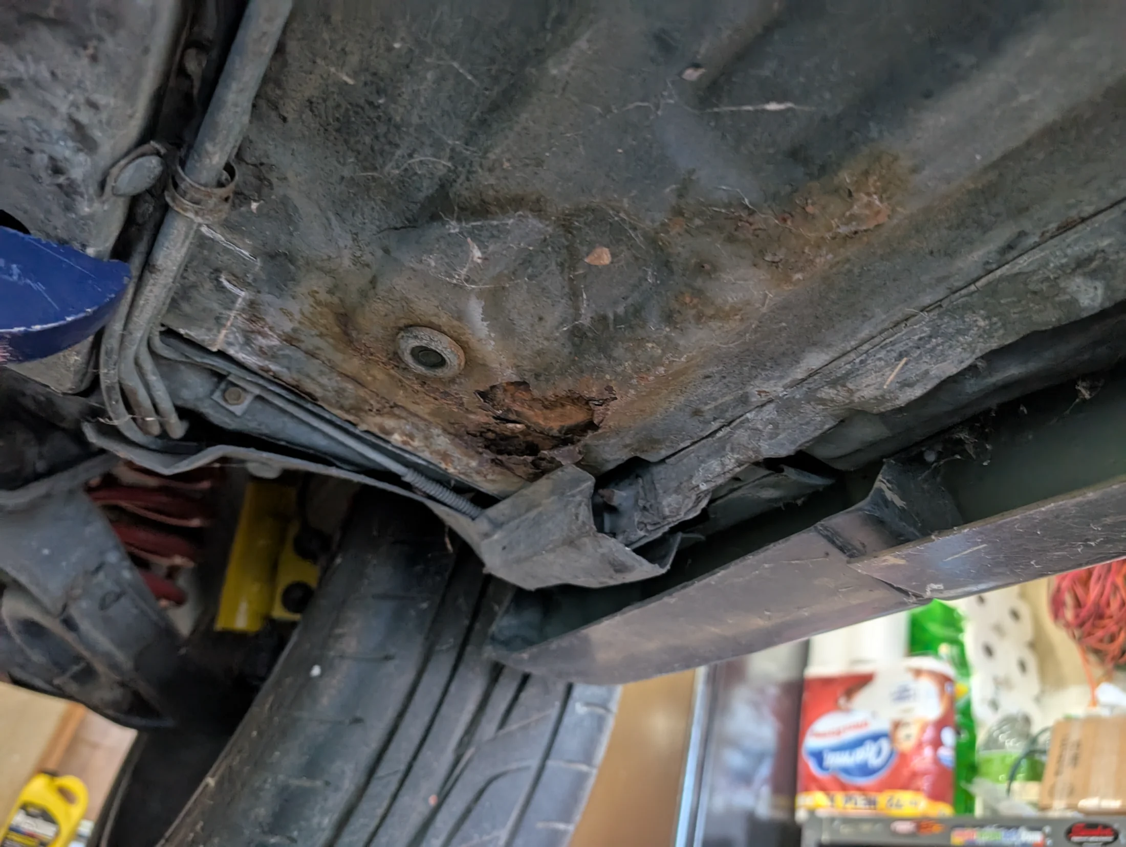

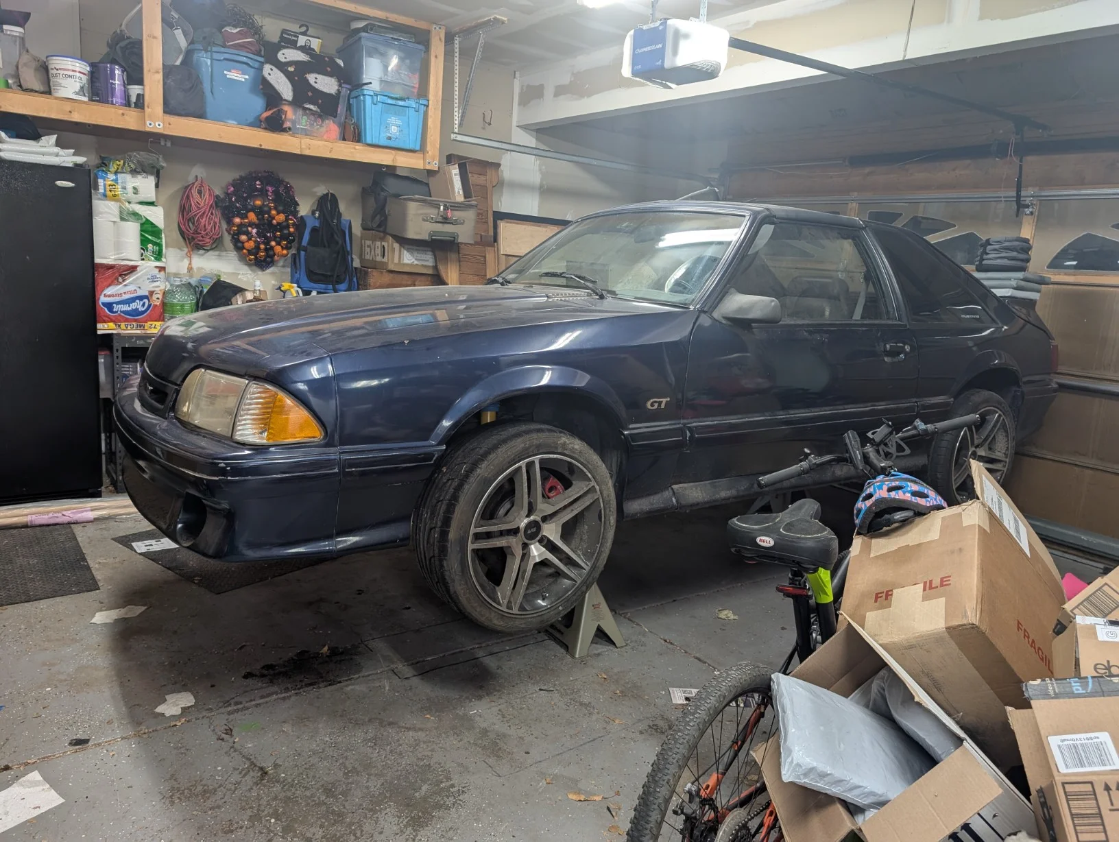

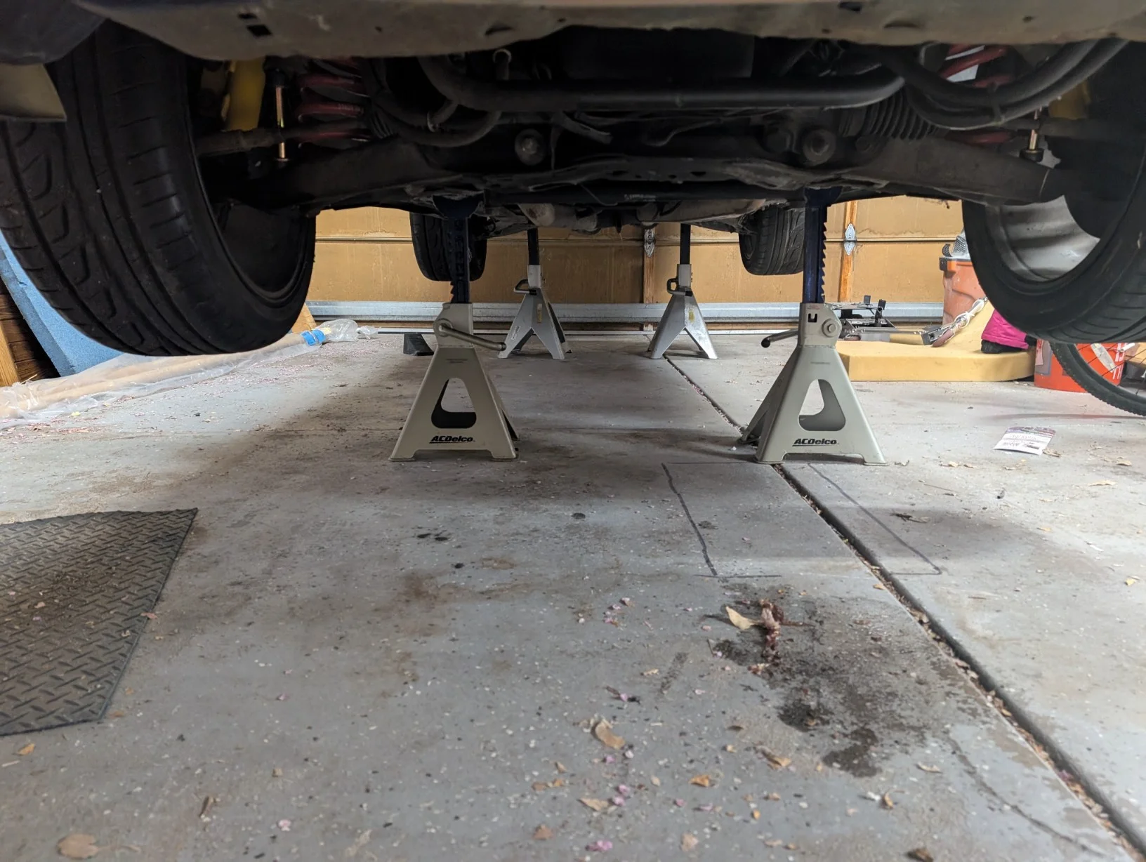

I didn't know these things could fly?!
So much room for activities. Time to pull the transmission.
The IRS subframe makes an amazing lift point. All the room to do all the things.
24" clear to the bottom of the floor pan. Seen more rust than I'd like this evening. Might POR a few spots.
Admin Dude
Jan 4, 1985
43,353
21,554
Box behind Walmart
Apr 20, 2025
#88
  • Apr 20, 2025
  • #88
Hover Mustangs have been around since the first time a turbo kit was installed.

I like to use the Jack stands that have a safety pin you insert after the car is at height... I made it to 70 for a reason
General karthief
Mod Dude
Aug 25, 2016
28,029
10,654
213
polk county florida
Apr 20, 2025
#90
  • Apr 20, 2025
  • #90
You made it to 70 because you were LUCKY not because of any pins you stuck in a jack stand.
Reactions: limp

Got the off road H removed.
I feel like this crossmember should have the bushings for the hooks in the pipe. But it doesn't. Now I'm trying to remember if that was the original crossmember or not.
Also found a hole in the passenger floorboard. It's totalled. Time to throw it away.
Or just get some sheet metal and weld a new piece in and POR the edges.
Rest of the tub looks good. Just some residual surface rust I need to kill.
