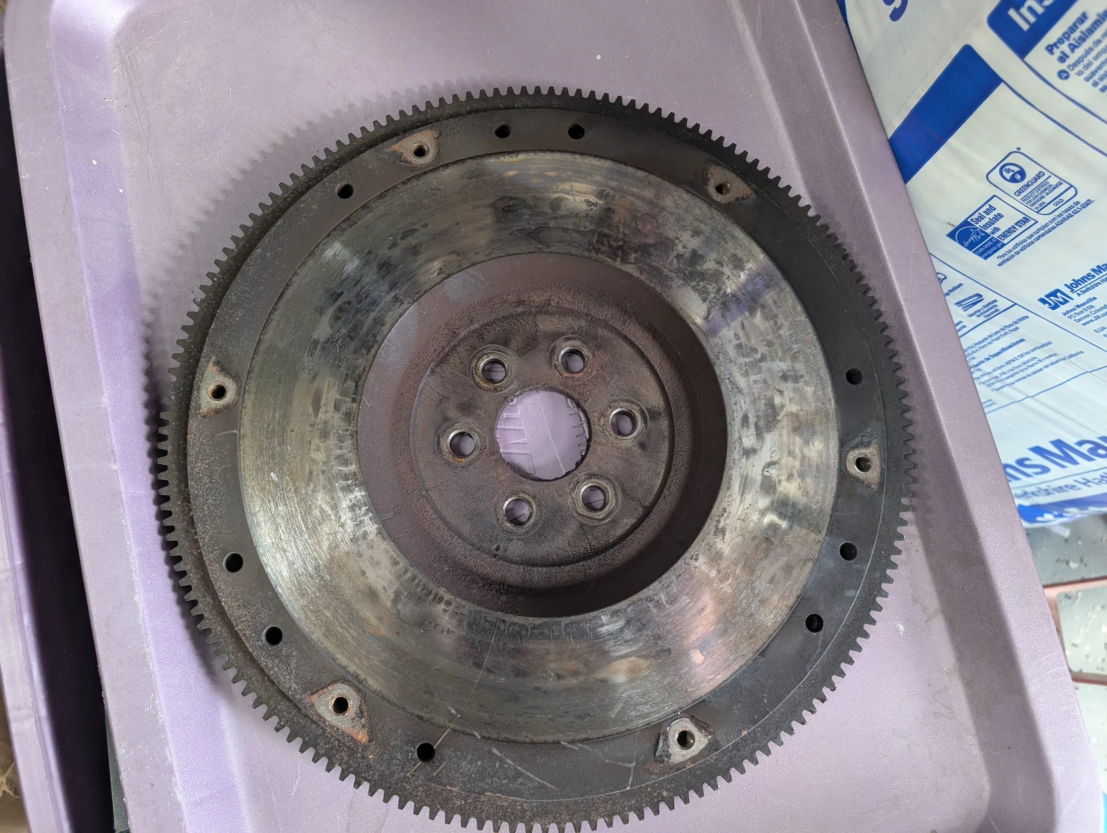

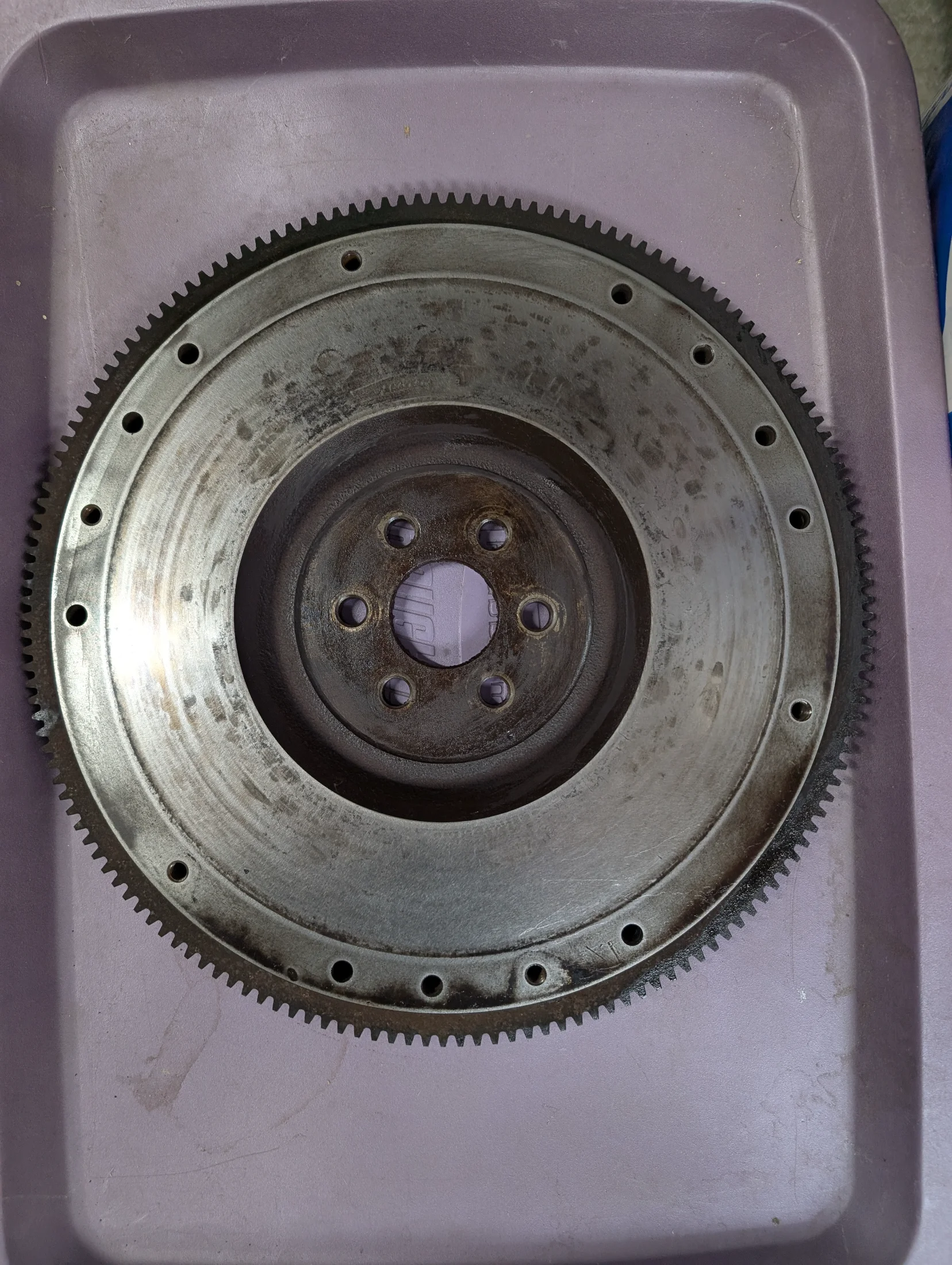

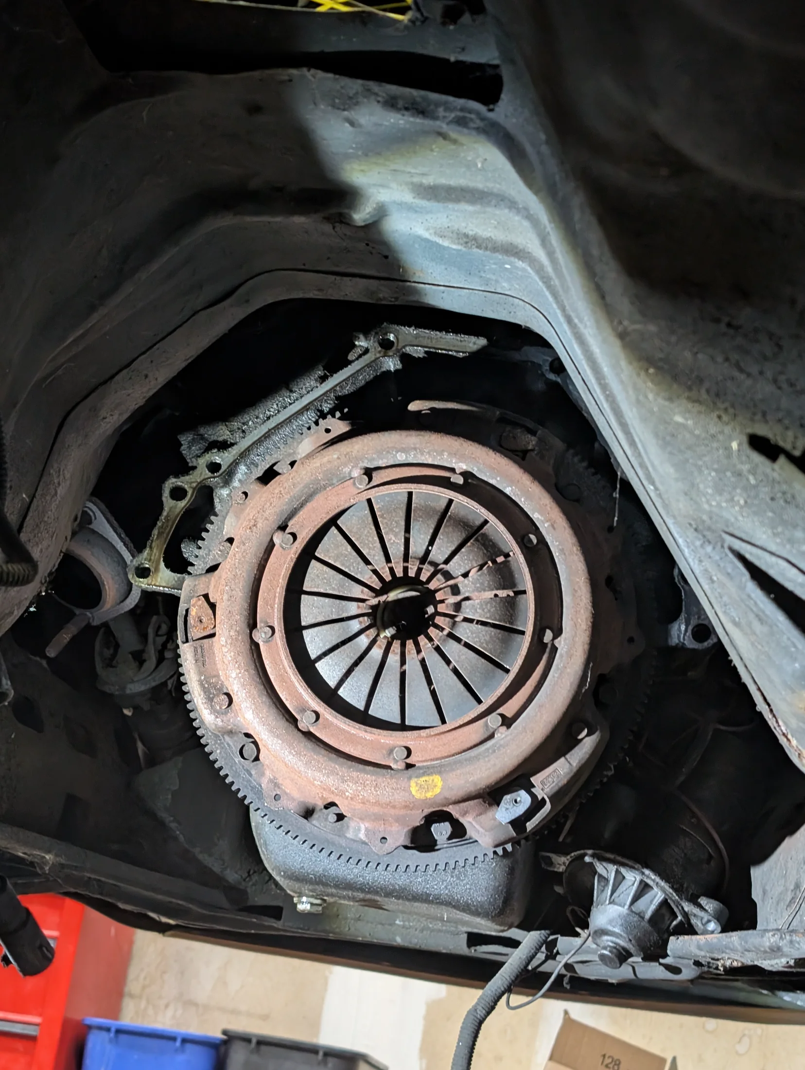

Yeah. Gonna need a new flywheel. And pilot bearing.
And apparently the rear main was leaking. Just not enough to keep the rust off the clutch. So. Hooray! I hate money.

Hell, except for the rust, that flywheel, PP, and clutch looks it could be scuffed up and tossed back in.
Is there a ridge in the flywheel that we can't see in the image?

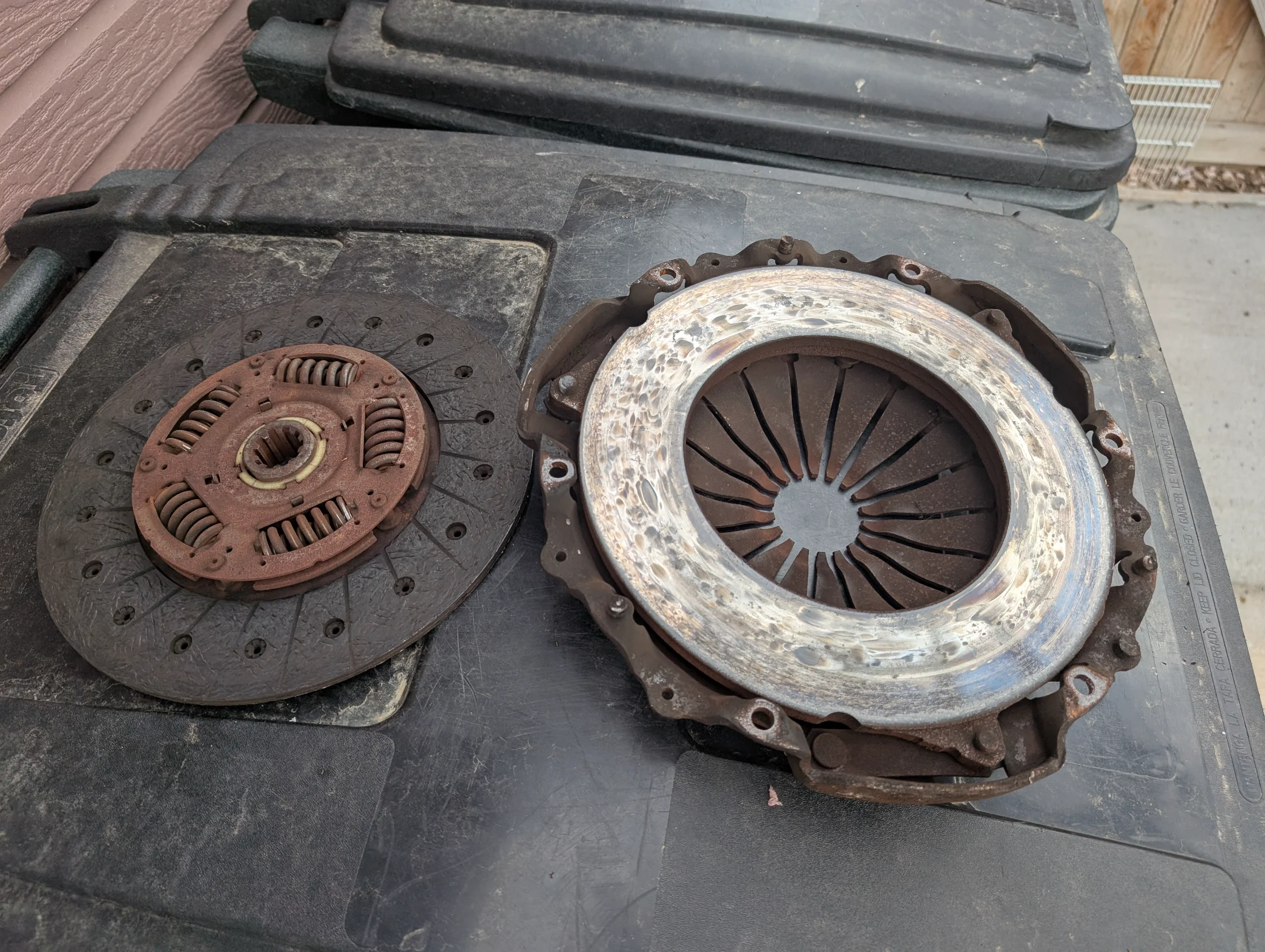

There is a SLIGHT tactile ridge on the flywheel. I might try cleaning it and see if it's just corrosion or actual wear. This clutch only has about 15k on it. The friction surface isn't bad at all, but the rest is a hot mess.

Blocking plate will be here this week. There wasn't one at all. Along with a new rear main, and bolt/dowel kit for the pressure plate. If I can get away with using the flywheel, that'd be great.

You should have the flywheel surfaced. Looks a bit rough for a new clutch to break in on. Cheaper than a new one and you might be able to find a shop that could knock it out tomorrow or Sat.
At the advice from a buddy I hit it with a random orbit sander and some 400 grit. There's zero lip now. Still some hot spot burns in one spot, but I'm feeling better about it.
