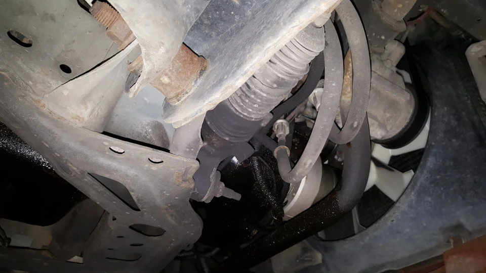

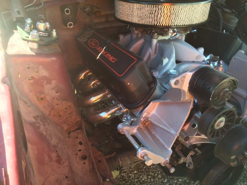

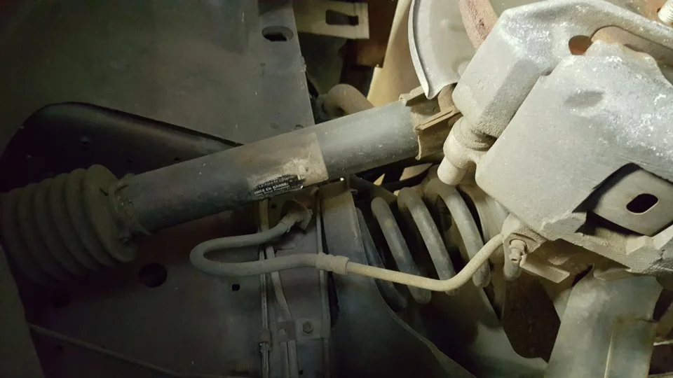

One image is part of ky oil leak i may,have to get better pics later after work. Another pic is the engine i was thinking about getting but ill just use my engine .

Oops uploaded a wrong photo.

You sure that isn't a power steering leak ? Maybe running down the line from the back of the pump and coating everything thing

There is another leak down there near the oil pan somehwere i know there is a oil leak because i smelled the oil when it was on the ground

If the leak is on the drivers side around the middle of the oil pan it is most likely the oil level sender.
