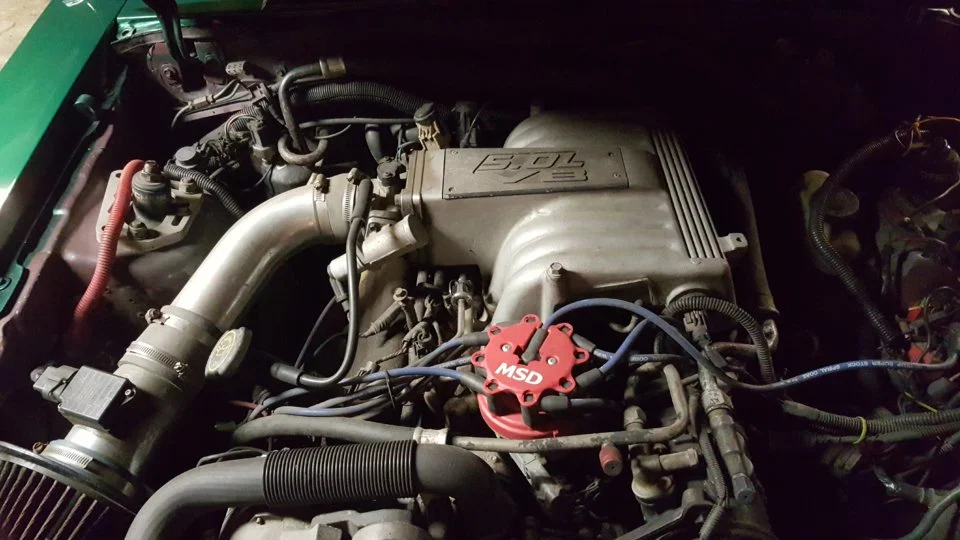

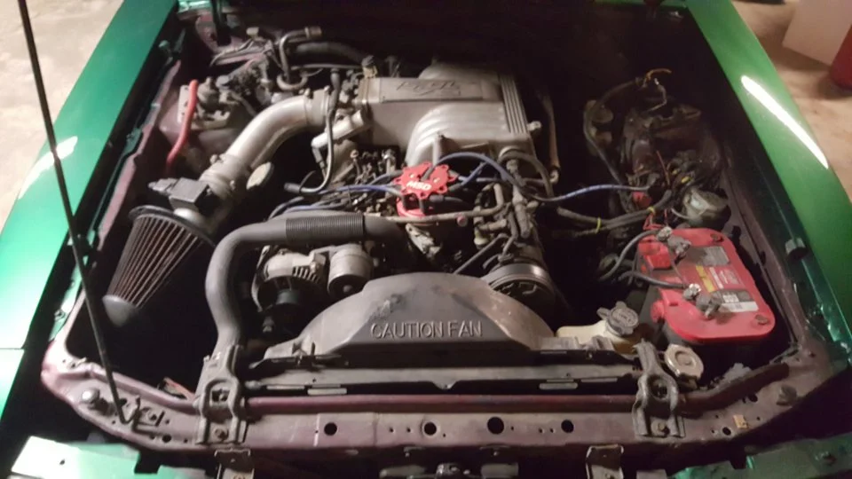

Heres what i have engine wise. I have gears already underdrove pullies msd cap. Shortys, subframe connectors .
Hotchkins struts .
Rear tb.

You can see the runners look staggered, if I'm not mistaken the stock intake has the runners in a line. The Explorer intake is a very good street intake it flows enough air to make power but it's long round runners also produce torque. The gt40 family of intakes is what every aftermarket intake is compared against.
I'm late to this party! Great advise already given. My present project is to get 400+fwhp out of a fuel injected 302(350rwhp). To give the op my perspective you're not going to get there with a 3000$ budget. You CAN rebuild the current bottom end(rings,bearings,gaskets,etc) and add a few boltons for that price. It looks like you already have an explorer intake and possibly an entire motor. That's great! That would mean you already have some fairly descent topend parts to work with. Overhaul the shortblock,heads(with some new seals,guides,springs,upgraded valvetrain,etc),a descent cam(tfs1,comp cams 270,etc) and all the incidentals and make a very healthy street motor. All without blowing your budget out of the water. This type of build has been done many times over and should make close to 325fwhp and last a long time. Also it would give you a ton of expierience in building/working on your car. I do recommend having someone experienced to help/teach along the way.
