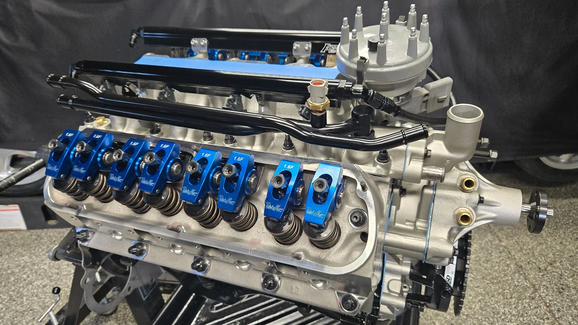

nicholase said:
^I don't have any experience with the 94-95.
Looking at you pic i see how different they are. It's just got to go somewhere in that tube. Doesn't really matter too much where. I'd keep it as far away from the MAF as possible as a rule of thumb. Just not to disrupt its readings. But that's just a suggestion.
I've had mine three ways now.
First was with the entry kit. The elbow that it ships with actually has a bung you can use. I have no idea why it's not utilized. It just needs to be drilled out and a nipple threaded in.
I dont have picture of that. But I do have the elbow from the upgraded discharge pipe with bypass. The large bung on the bottom is for the bypass. The smaller one on top is threaded but sealed off. All you gotta do is drill ot out and put in a threaded hose barb there for your PCV inlet. The entry level kit was almost exactly the same except it didn't have the bypass bung.
Then the UPR. Its plastic and not great to thread into. I epoxyied several layers of thin plastic. Like a plywood construction of plastic/epoxy/plastic/epoxy and let dry to build up the thickness. Then I drilled it out and tapped it with a NPT tap.
The little silver canister is an oil seperator.
While I feel it would hold up, I really didn't like the "makeshift" bung. So i went with the Anderson Powerpipe I posted earlier and welded a bung in for the PCV let.
Then powdercoated it.
you still around man lol? I got the IAT sensor figured out but few more questions. Looking back at your pics here I saw you are running your ECT the same way I planned with Vortech's instruction of trimming the heater tube 3 1/4 " and running there 5/8" supplied hose from the firewall to the water pump. The ect will hit the back of alternator and also needs to be removed and relocated. Looks like you have the hose connected to the front of the tube still, did you trim it and still used the hose? More pics if you have would help.
oh and also reading up on another thread on the corral where they list the supplied hose as 5/8 and just called vortech too. He said they don't have anyone call with questions so the supplied hose must work. But the barbed fitting on water pump that goes to the heater core is 3/4", not 5/8. So reading up on this other thread now to see what they ende up doing to.
I not sure what your talking about. Must be the ECT is an interference with something on the 94-95?
My ECT is just mounted in the factory style tube. Mines a "cobra" style that doesn't have the coolant tubes for the EGR cooler. Other than that it's just an factory replacement. No cutting or trimming.
Looks like this
You might be overthinking this. Vortech has sold thousands of these kits. Just use what they send you. It'll work.
