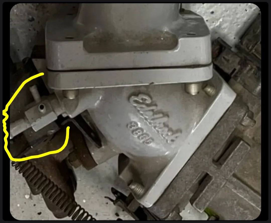

I'm thinking back to things you said about your setup.
The vacuum line to your FPR should be attached to a vacuum source [before] the blower and not to your intake manifold where it will see boost.
Remind me where yours is connected again?
The vacuum line from the fuel pressure regulator is on the if you go back to some post maybe last week or so there was a picture I showed where there's a screw in Port thing that has three ports that gets vacuum. The fuel pressure regulator is going to one of those ports. The only thing that's going to the intake manifold is the bypass valve for the supercharger coming off of the discharge
Ar one of these spots
