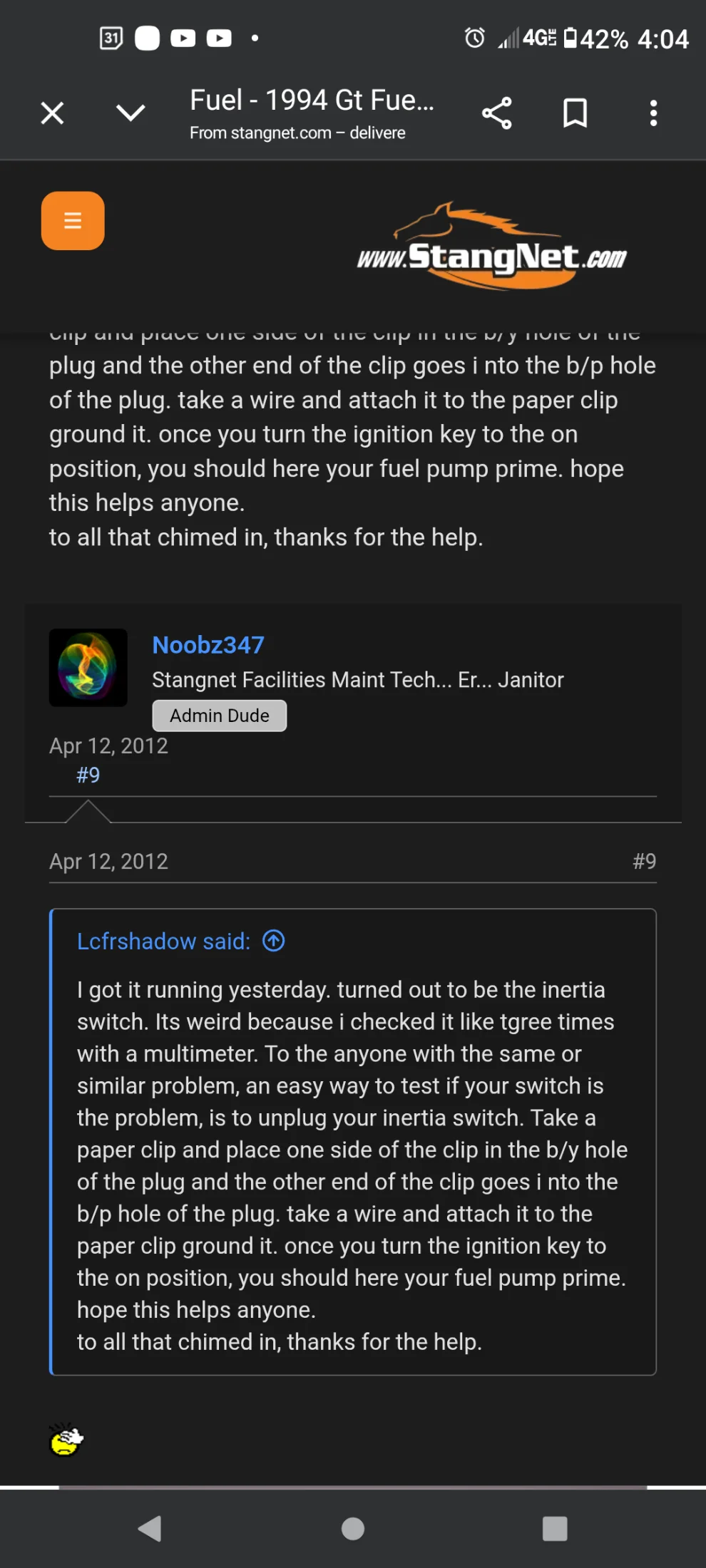

And I found this while googling some stuff earlier. This guy said this is how he tested his inertia switch or rather when his was bad. By your reaction it doesn't seem like you think this should work. I'm not having this issue because my inertia switch is supplying power but I'm just curious as to the paper clip thing that he did LOL
I think what you're getting at is the "how". It looks like the way he tested it does not account for current draw.
If you test with the pump [running] you get to see if there is a problem with voltage drop when the pump turns on. If it drops for a second and recovers, that's usually fine. If it drops and doesn't or it fluctuates a lot... that's not so good.

Yeah you can hot wire it to see if the drop is a the pump. That's good info to have.
I would [still] to the paper-clip method if the pump checks out. This will tell you if you have a wiring issue.

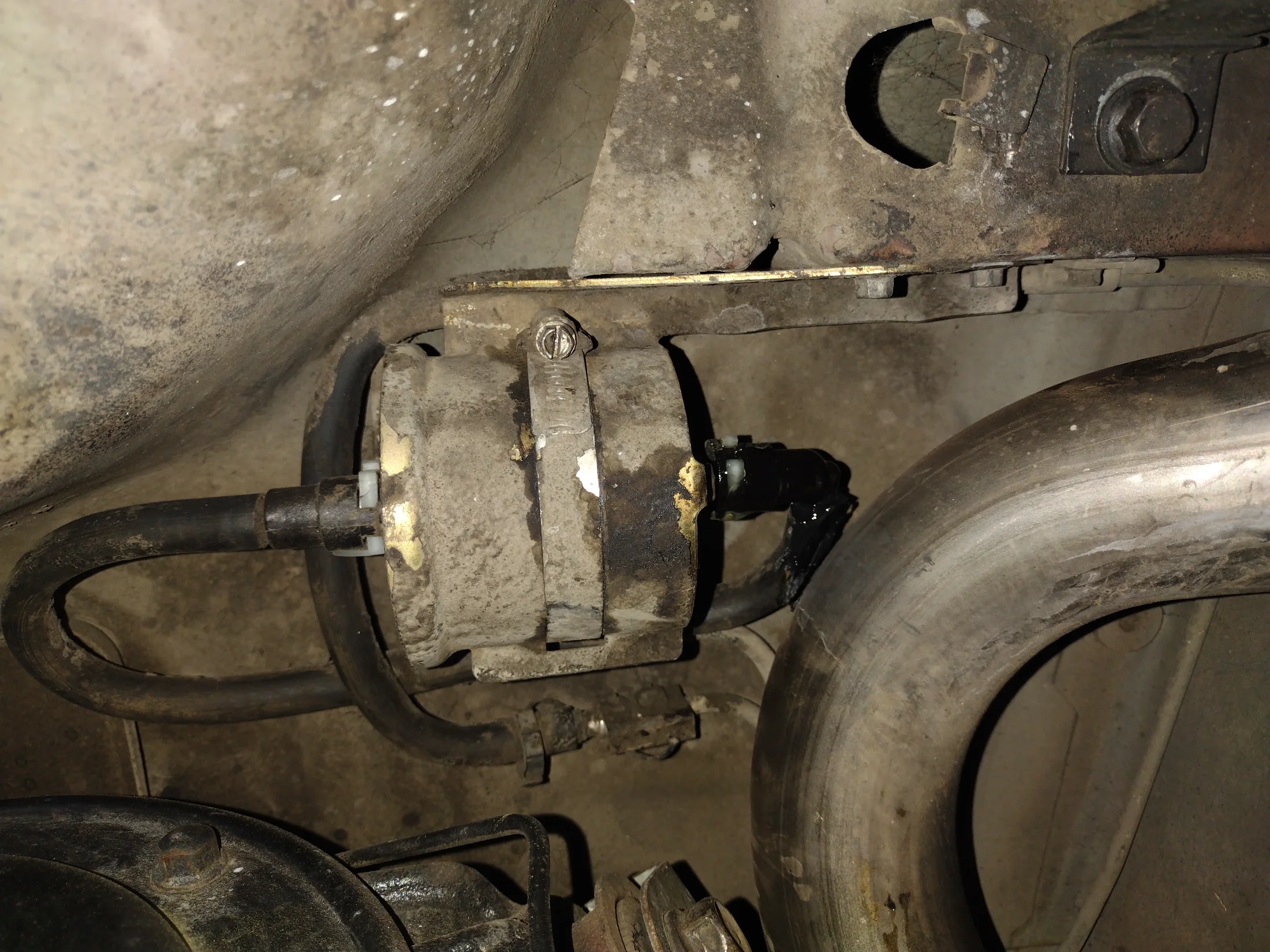

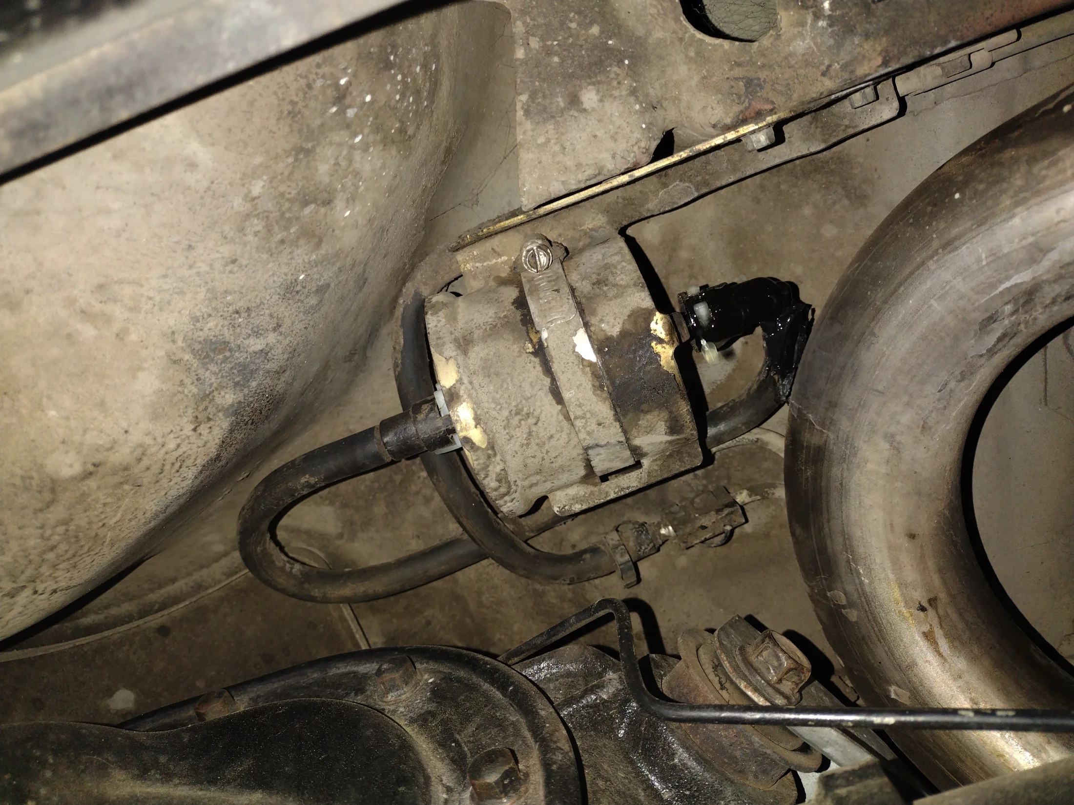

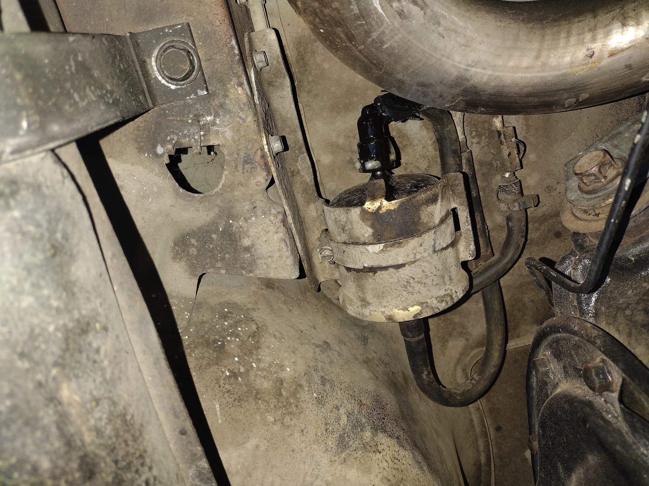

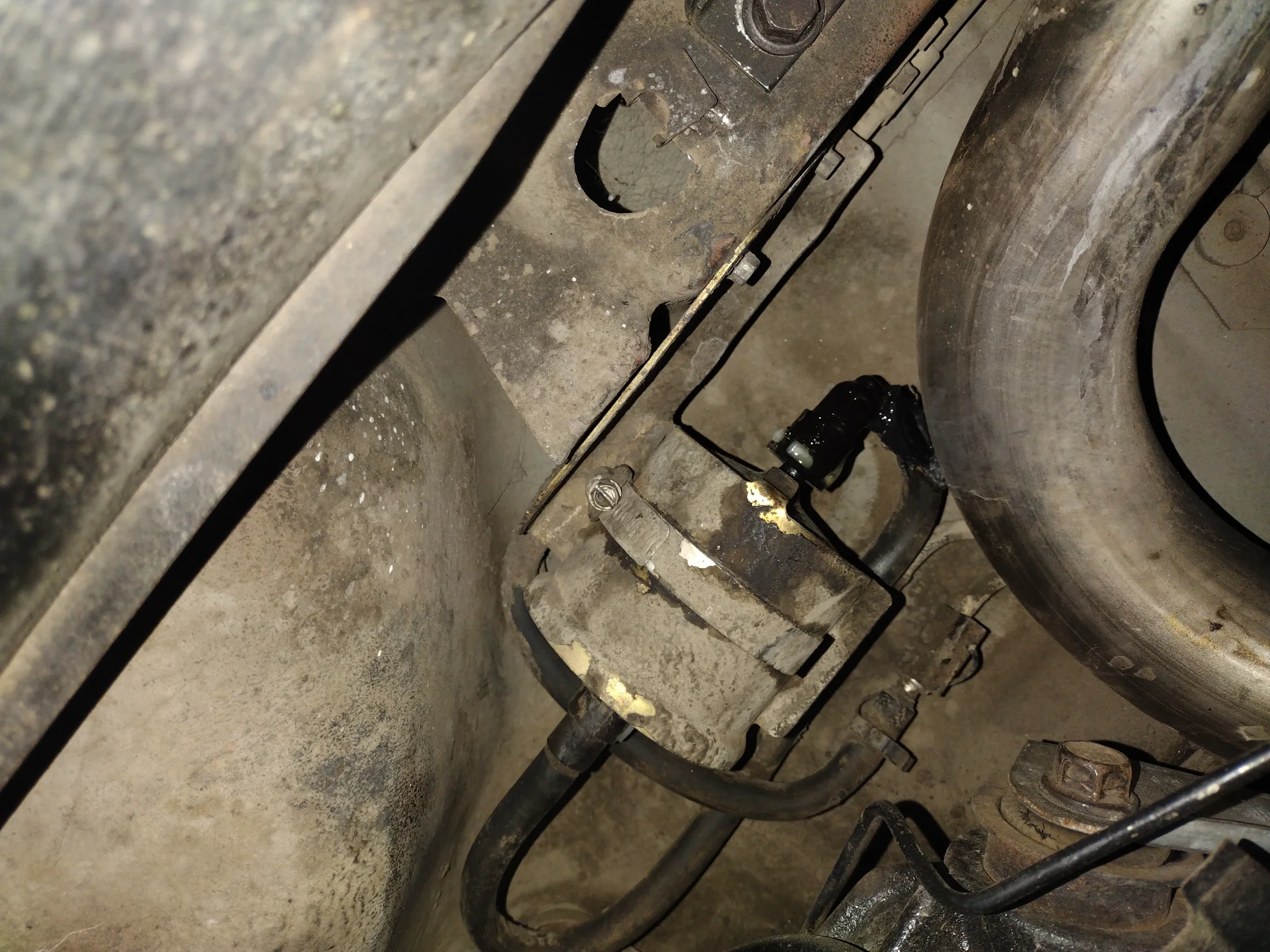

Found this issue this morning so diagnosing what all I have to do to replace at least this line. Looks like it connects to the fuel pump so I'll probably have to drop the tank and replace just that line. The two lines is riveted at a point to the underbody so I'll have to drill it to remove and see if I need to put a self-tapping thread back in that spot or next to it.
That tail probably moved at some point and got close to the fuel line so I will have to see if I can move it or take it to an exhaust shop let them adjust.
i was hoping I could slide the fuel filter bracket over a hair and get it away from the exaust but might have to tap after I drill holes. It kind of look like the oem holes are tapped and might be a metal washer thing in behind not sure.....

Yeah, that bracket looks like it needs to be relocated.
Actually I should have paid attention to the signs of the exhaust rattle and had I got up under there and checked I would have saw the exhaust was a little too close and eventually started touching that fuel line. Anyway going to drop the tank now and I just took the other fuel line off the my other old car that's taken apart and I'm going to swap it
