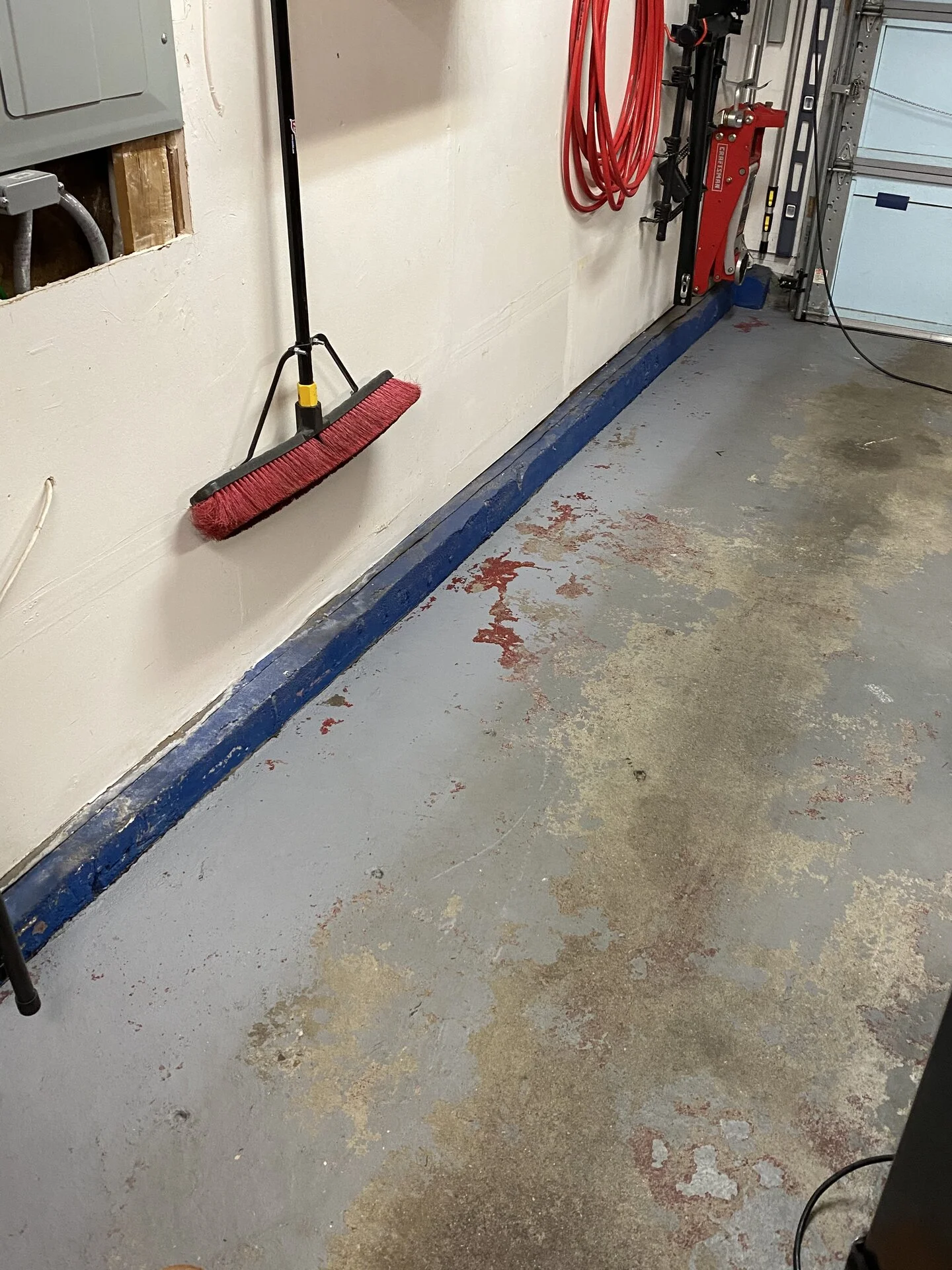

I guess your talking as a pre paint step? I pretty much live at the Lowdepot, so what’s one more run!!
Yes but the most important thing is cleaning up the oil and grease from the floor, I would take some 'oil dry' granules and a flat piece of cement block and grind the granules into the floor where the oil stains are. Wash down with soap and water and let dry, a leaf blower helps. If water beads up on the concrete the epoxy will not stick.
Reactions: Rdub6
Yep, last time I did it I used Oil Eater, and the leaf blower to dry.
The one spot that gets oil all the time under the Mustang is pretty clean. I wipe it every time the car is out. I’m pretty confident I’ll get it good and clean, and it it’ll last me a few more years!!
Maybe I’ll finally get the leaks fixed in the Mustang so the floor won’t be a problem.:shrug:

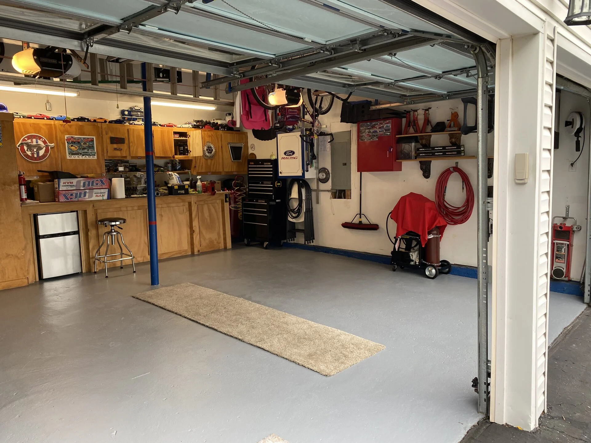

So before I mess it up again this winter, I figured I should clean up the garage. That led to finding another gallon of gray epoxy floor paint, which led me to cleaning around the edges, which will lead me to painting it tomorrow. It’s not going to be @Reddevil91 quality, but it’ll look better for a while at least!
Stay tuned..... I’ll be back tomorrow with more pics!
Nice!! Yeah I used the etch that came in the kit plus I bought an extra. Degreased and scrubbed first, cleaned up some paint someone had dropped previously. Then etched a couple of times. Made a huge difference. I then used this primer and laid down a good coat even though the floor was never painted or coated etc. , followed it the next day with the epoxy. Don’t do what I did lol and start laying down the paint or epoxy and with the garage doors down and drinking whiskey with no ventilation bc it makes you get kinda whacked out!!!
Cleaned it up this morning, and then got two more coats of paint down. It’ll peel and chip like last time, but I’ll get a few years out of it!

Thanks man! It was way overdue. I’m thinking it was probably 10 years ago that I painted the floor the first time. With all the dirty work I was doing on the car, the whole garage cleanliness got neglected for a while.

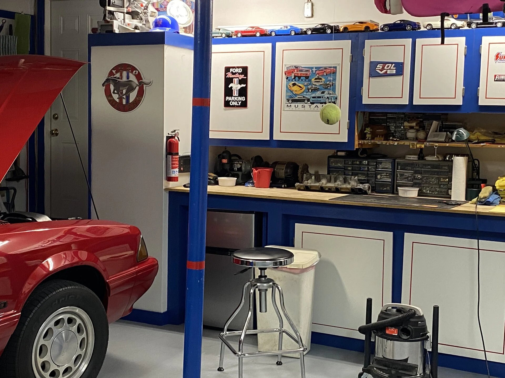

Did you build those cabinets?
Yeah. They’re just 2x2 skeletons, wrapped in plywood. Then I trimmed them out in some 3/4x 2 pine strips. The bottom I just used strips of the leftover plywood to trim it.
Poly’d all the uppers. Never got the bottoms done. Now I’m debating on painting them like the cabinet on the right with the Blue/white with the red trim.

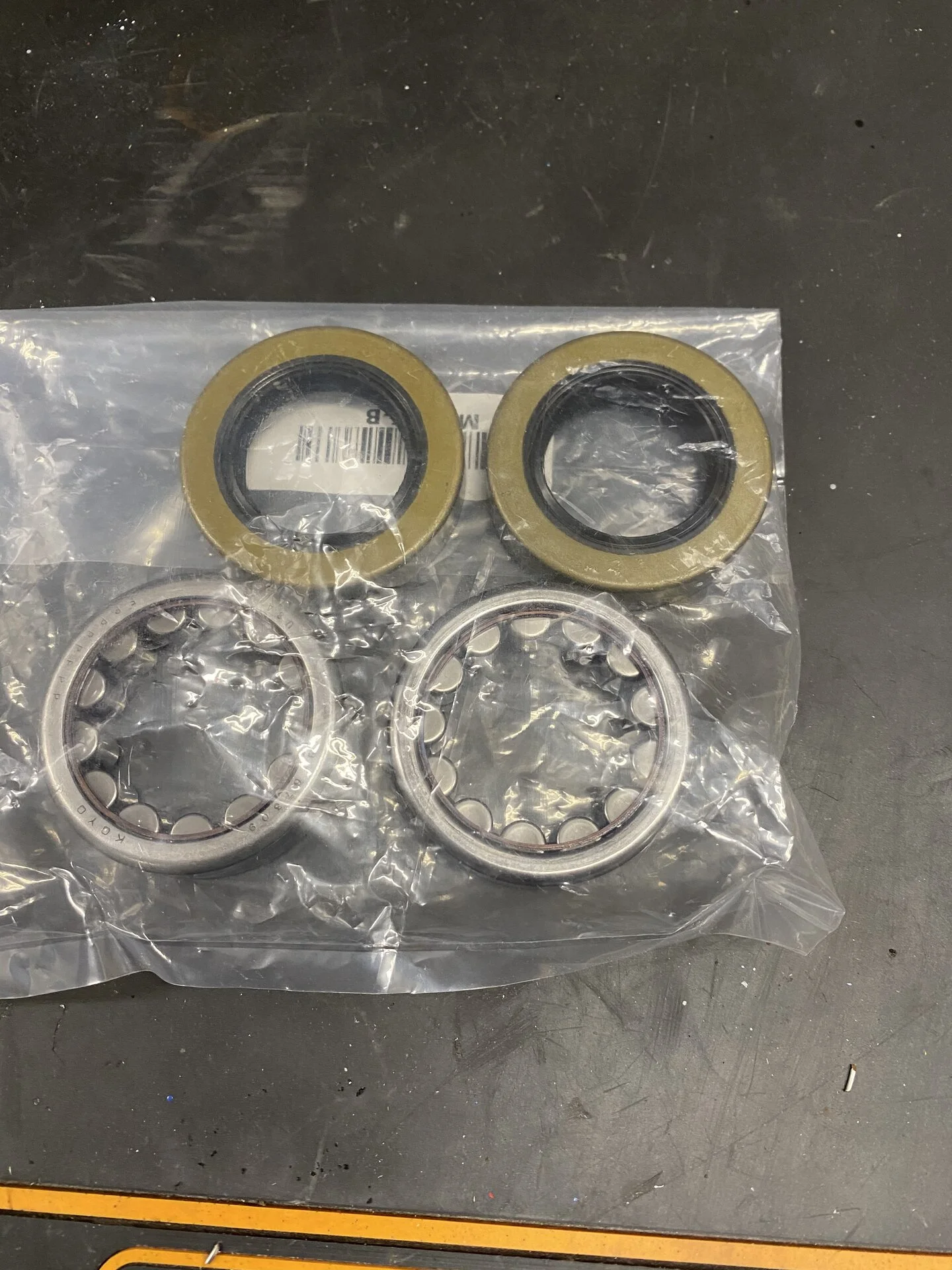

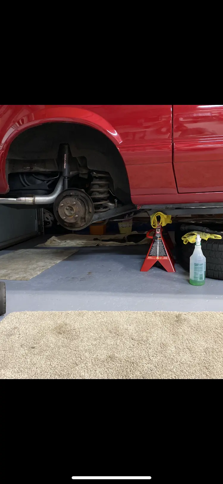

Are you doing Traction-Lok work.
When I bought the car, he gave me a set of 3:73 gears and all new clutches for traction loc.
I’m going to clean up/ paint the housing, attempt to do the gear install, and then continue with my planned 5-lug swap..... assuming I don’t ruin things attempting to do the swap.
