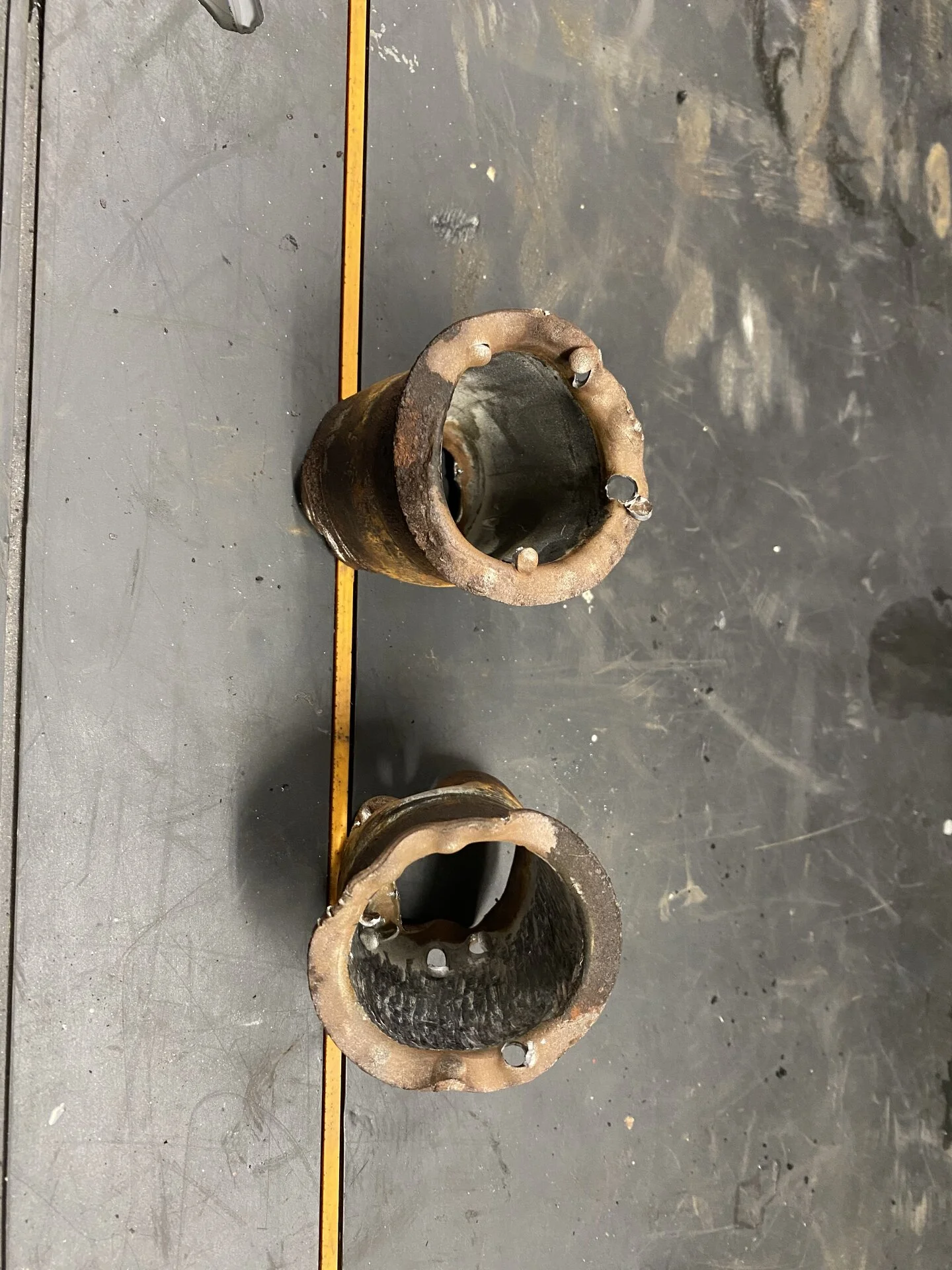

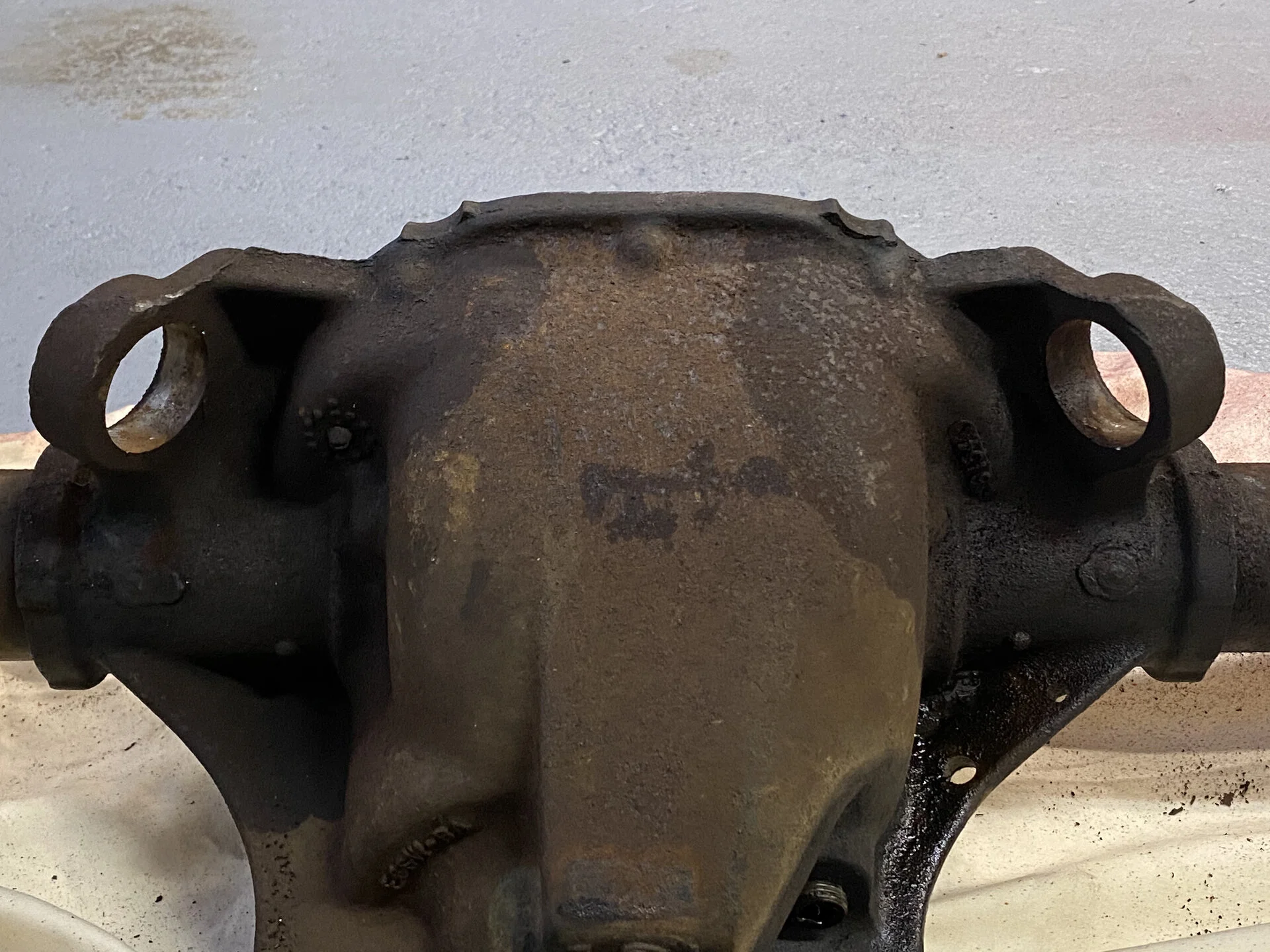

Finally got the last of the rear end taken apart. After a week of PB blaster every day, I still had to beat the snot out of these bushing cases........ but they’re out. (I really need to get an air hammer)

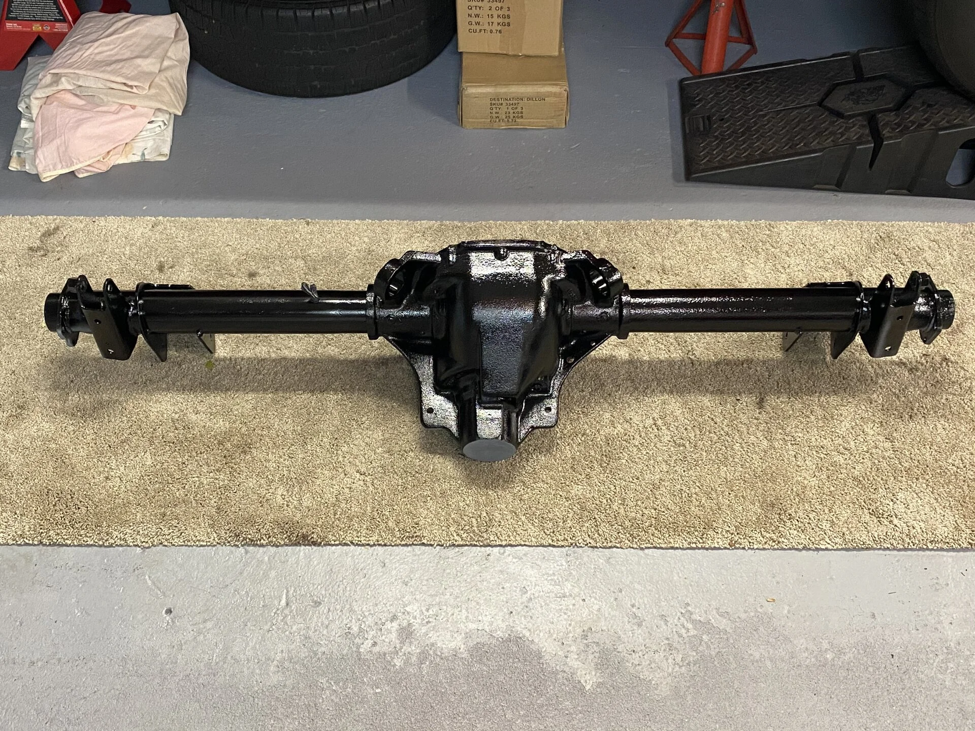

Off tomorrow, but as my luck would have it, a Nor’easter is bearing down on us. So painting the rear will wait!

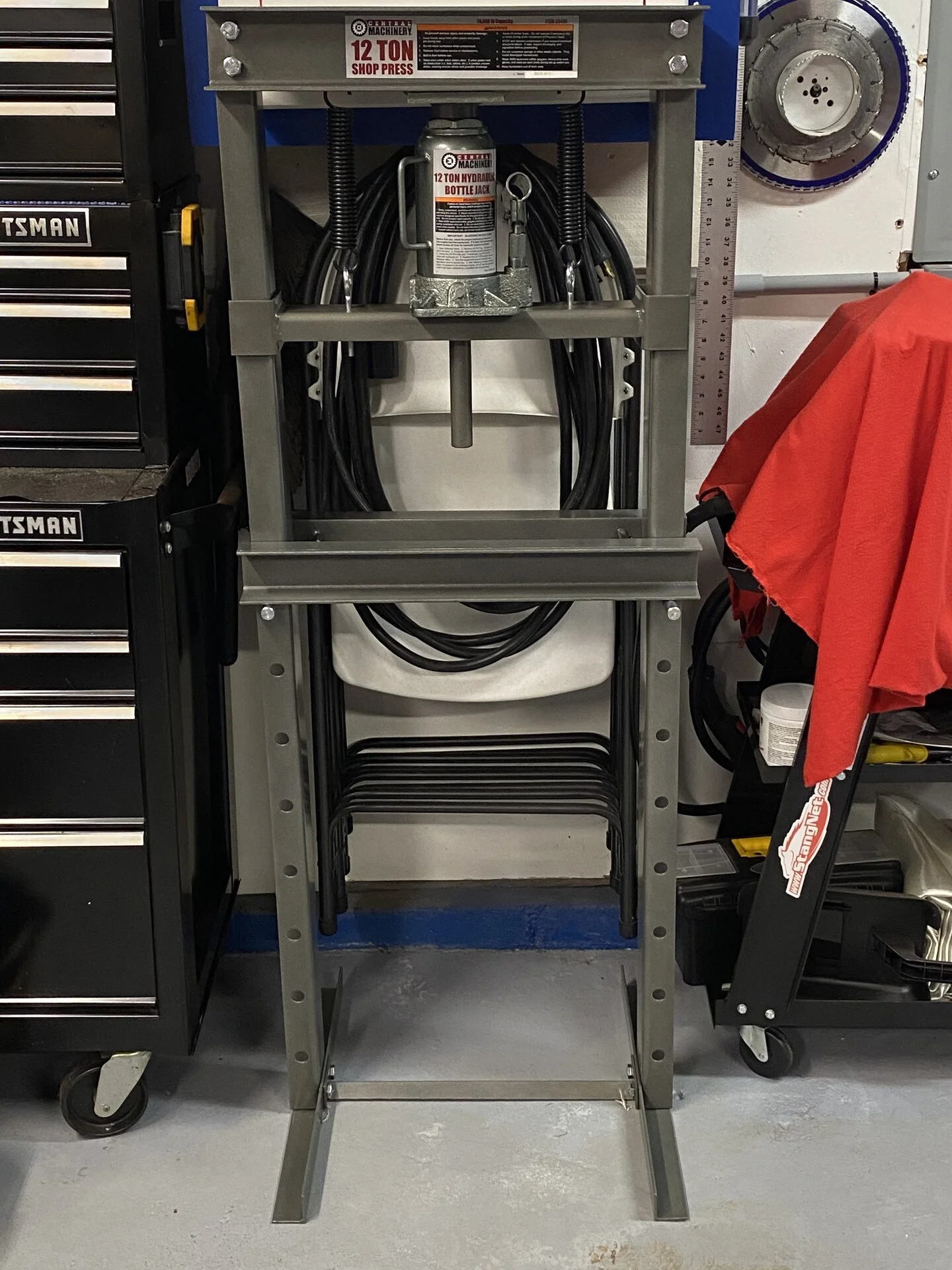

I did have a small stroke of good luck though, and I noticed online today that another local Harbor Freight got the press back in stock. Ran there before work with my rain check for $119, and sure enough they had them.
So hopefully tomorrow I can get that put together and set up!
So, like a kid on Christmas...... got home from work and had to put the press together. It was almost too easy to get this bearing off!!

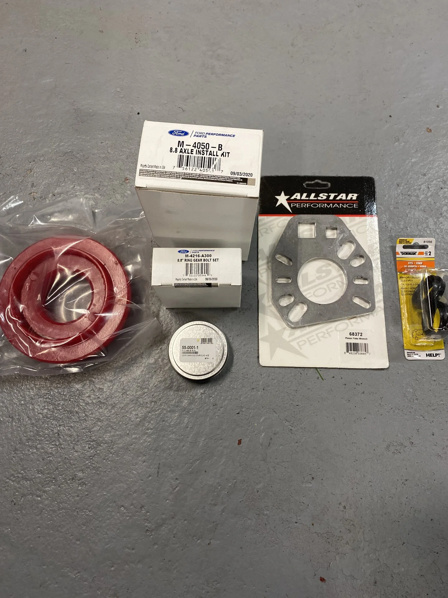

Came home to a box of misc. parts from Summit too. Now all I need is some time!

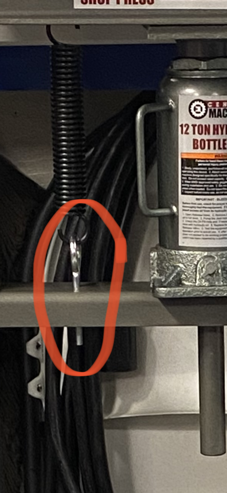

Pretty simple machine....... and not that you need a tip, but leave these eye bolts pretty loose at first. Makes getting the large springs on nice and easy, then I tightened up the eye bolts to take up the slack.

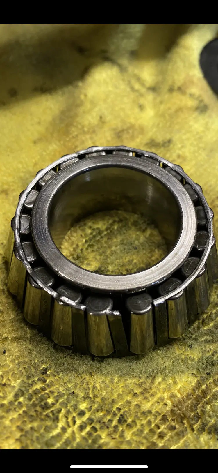

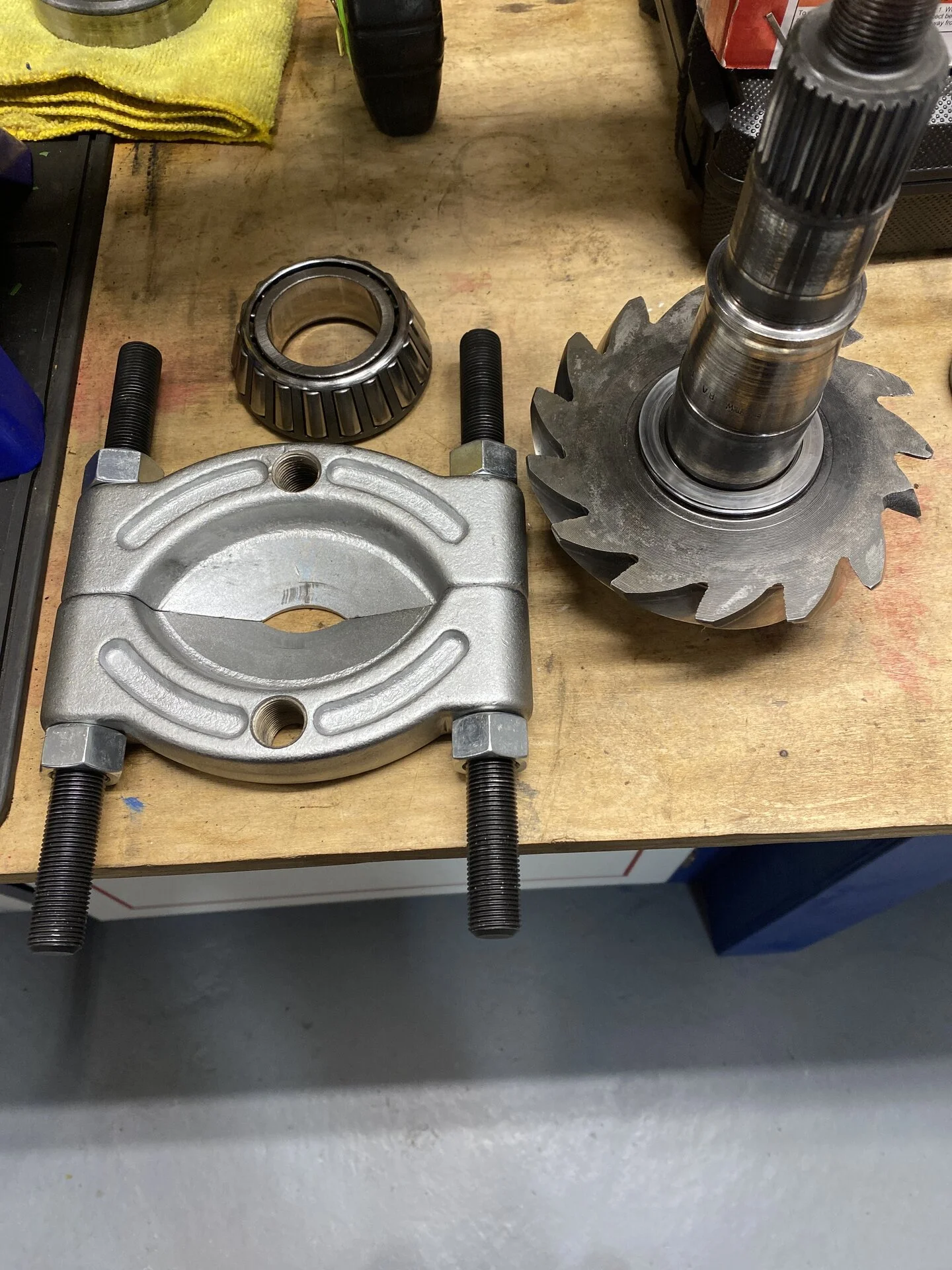

So I’ve hollowed out the old Timken pinion bearing and got it to slide over the new pinion gear, to use as a set up bearing. But much like in the Eric the Car Guy vid, my new pinion bearing is a Koyo. They don’t fit in each other’s races, so now I will need to order a new Timken bearing and race if I’m going to be able to use this one as a set up piece. :mad:

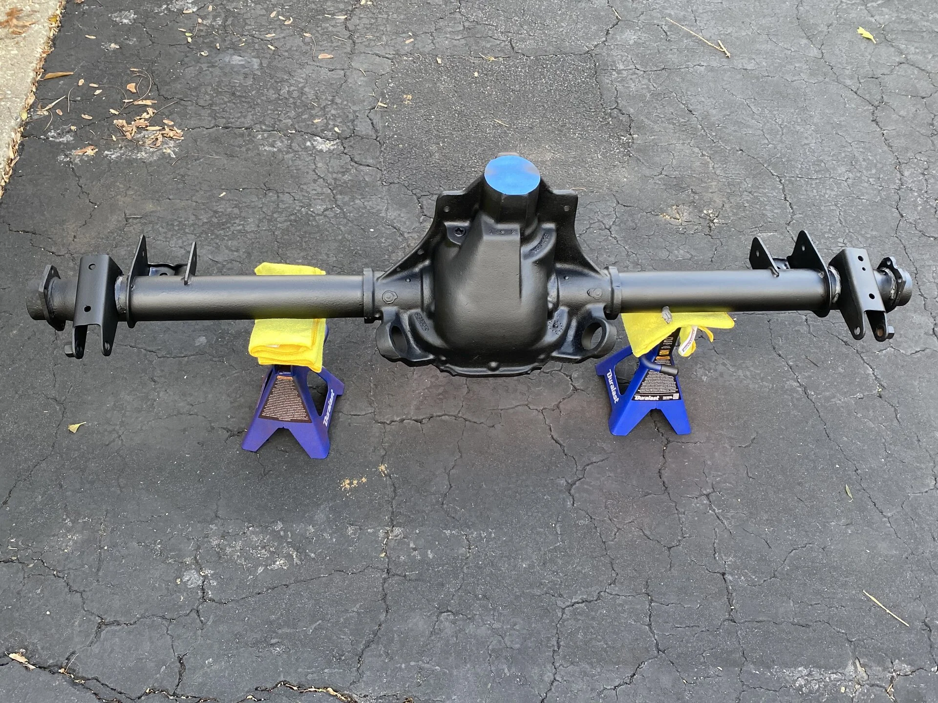

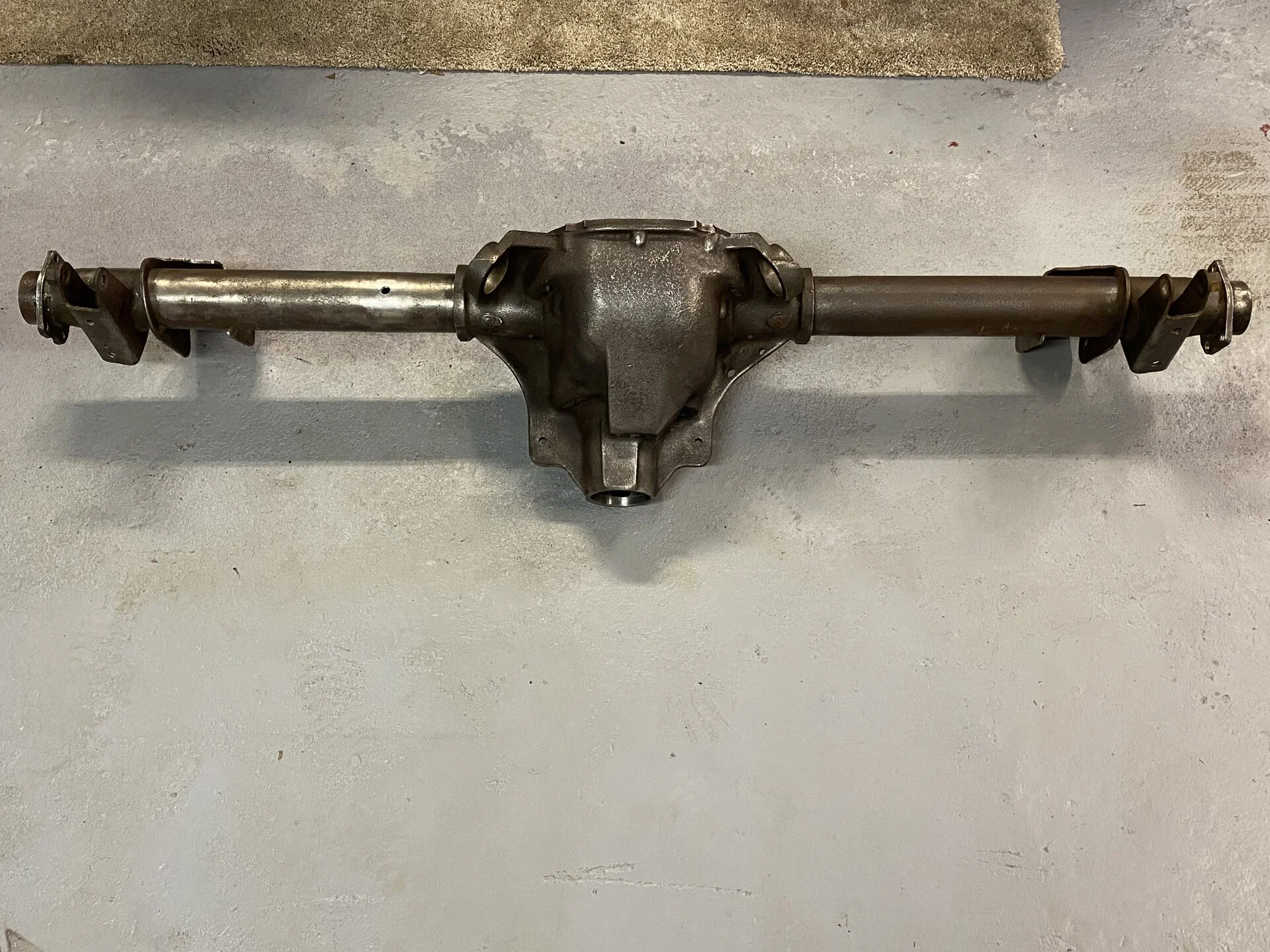

Productive day today. Got the housing all painted:

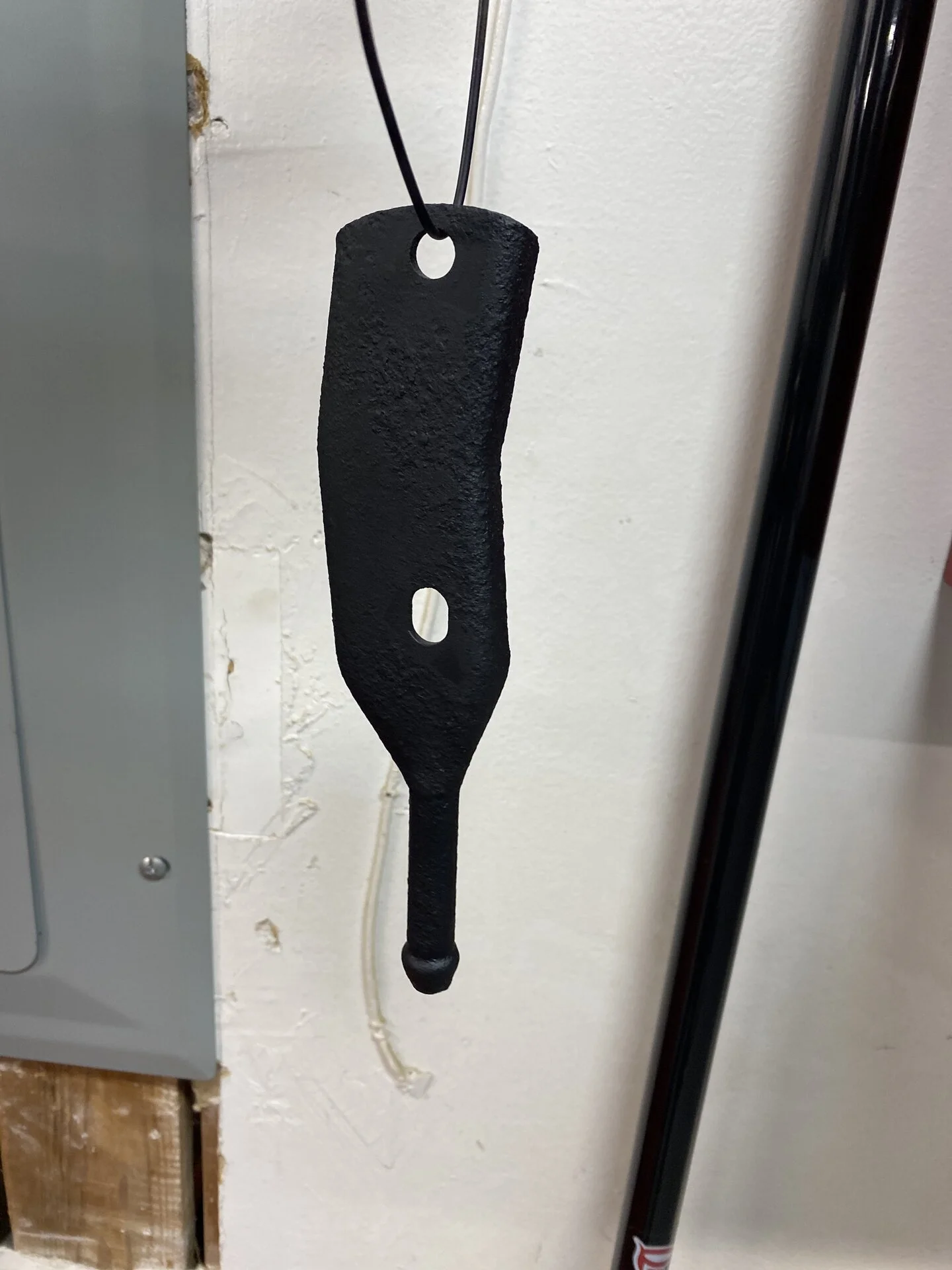

Pinion snubber mount cleaned up and painted:

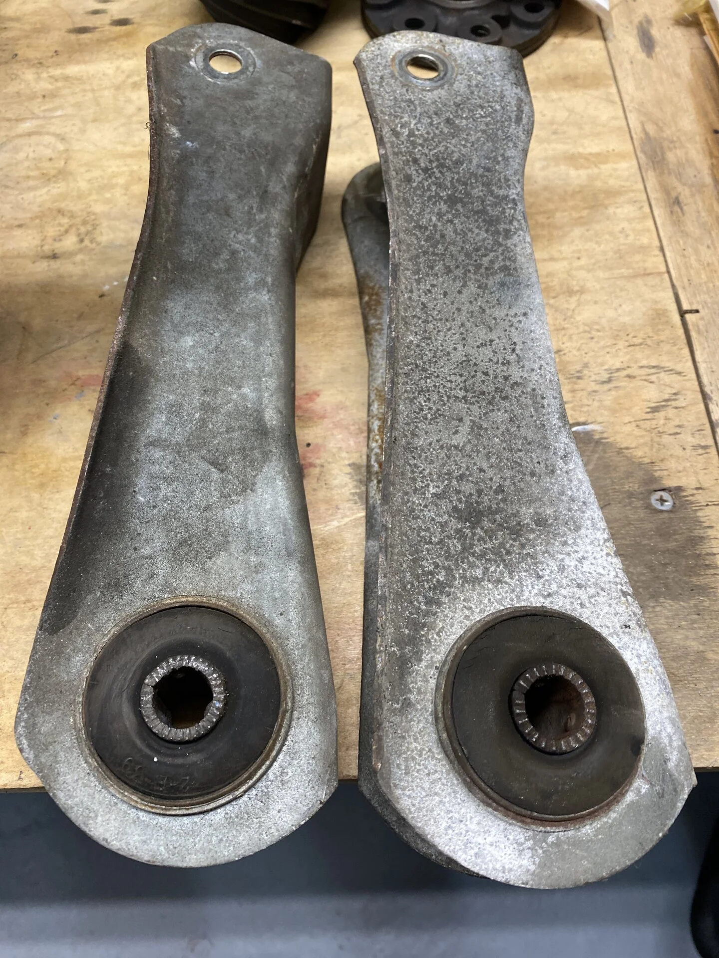

Rear upper control arms removed. Chassis side bushings don’t look bad. Should I drop the $100 on new from MM? I need to think on it.

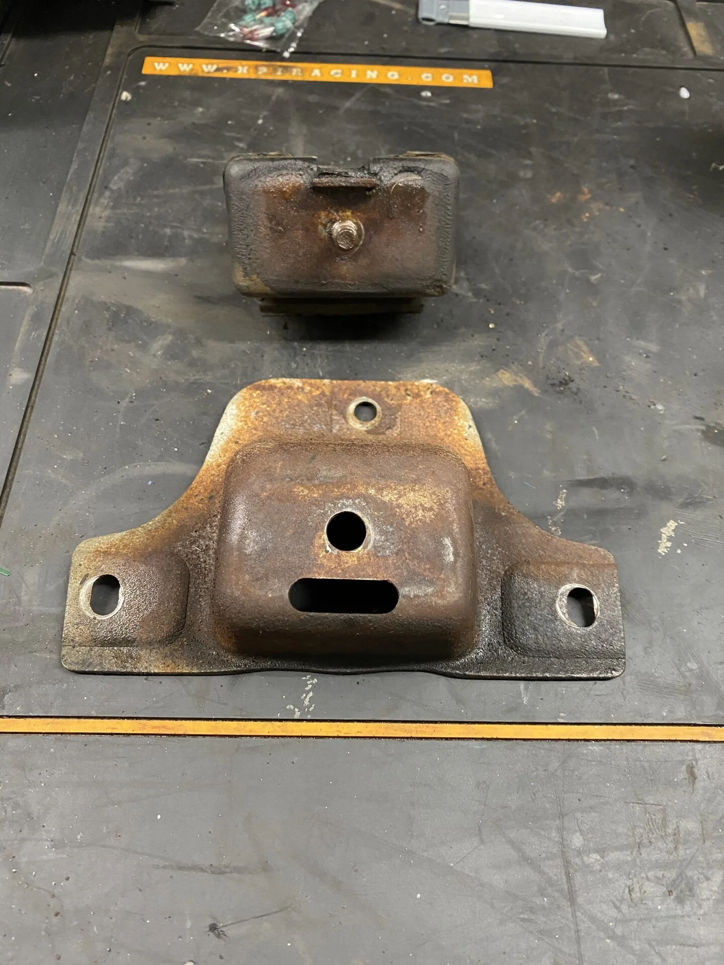

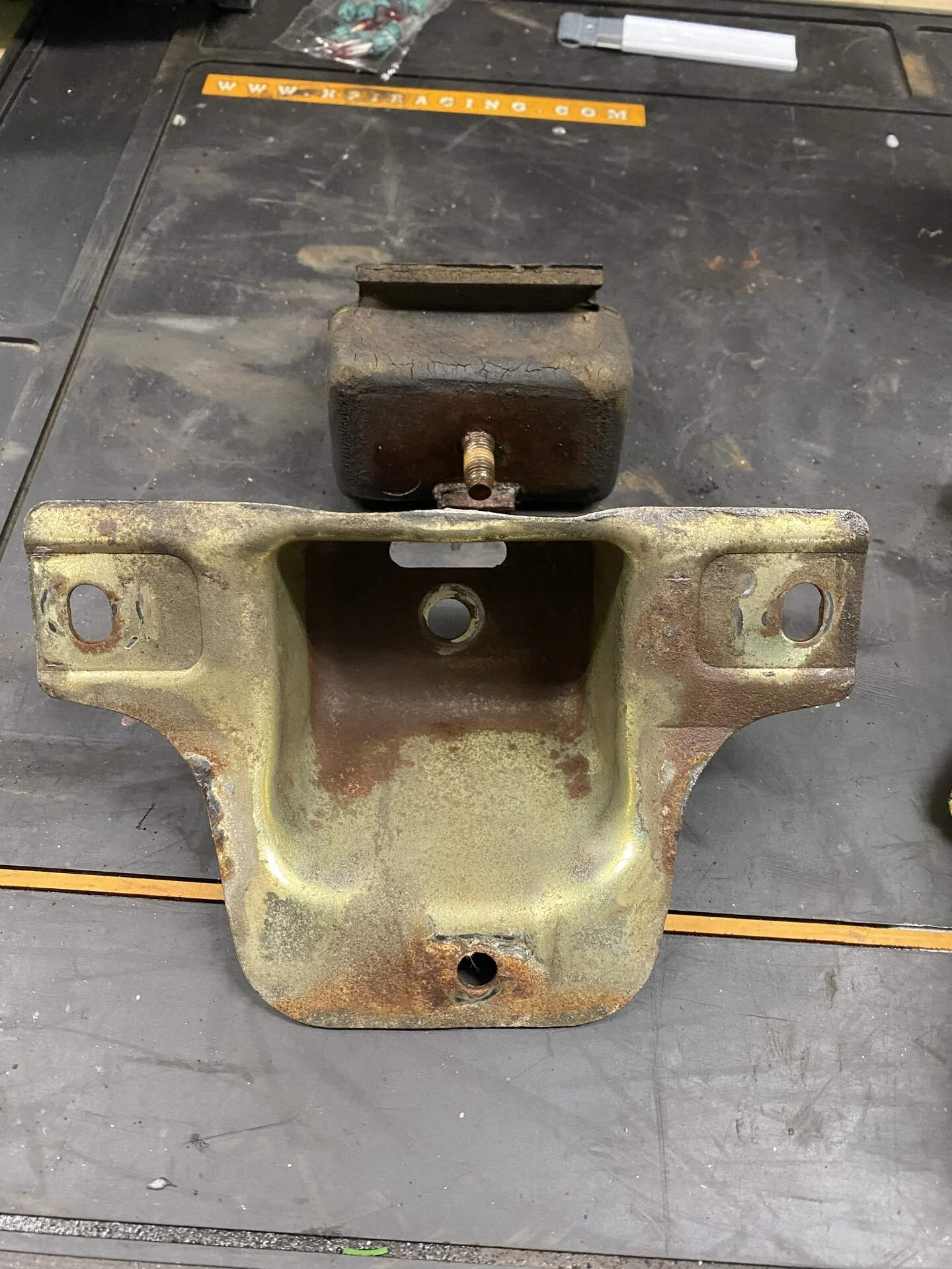

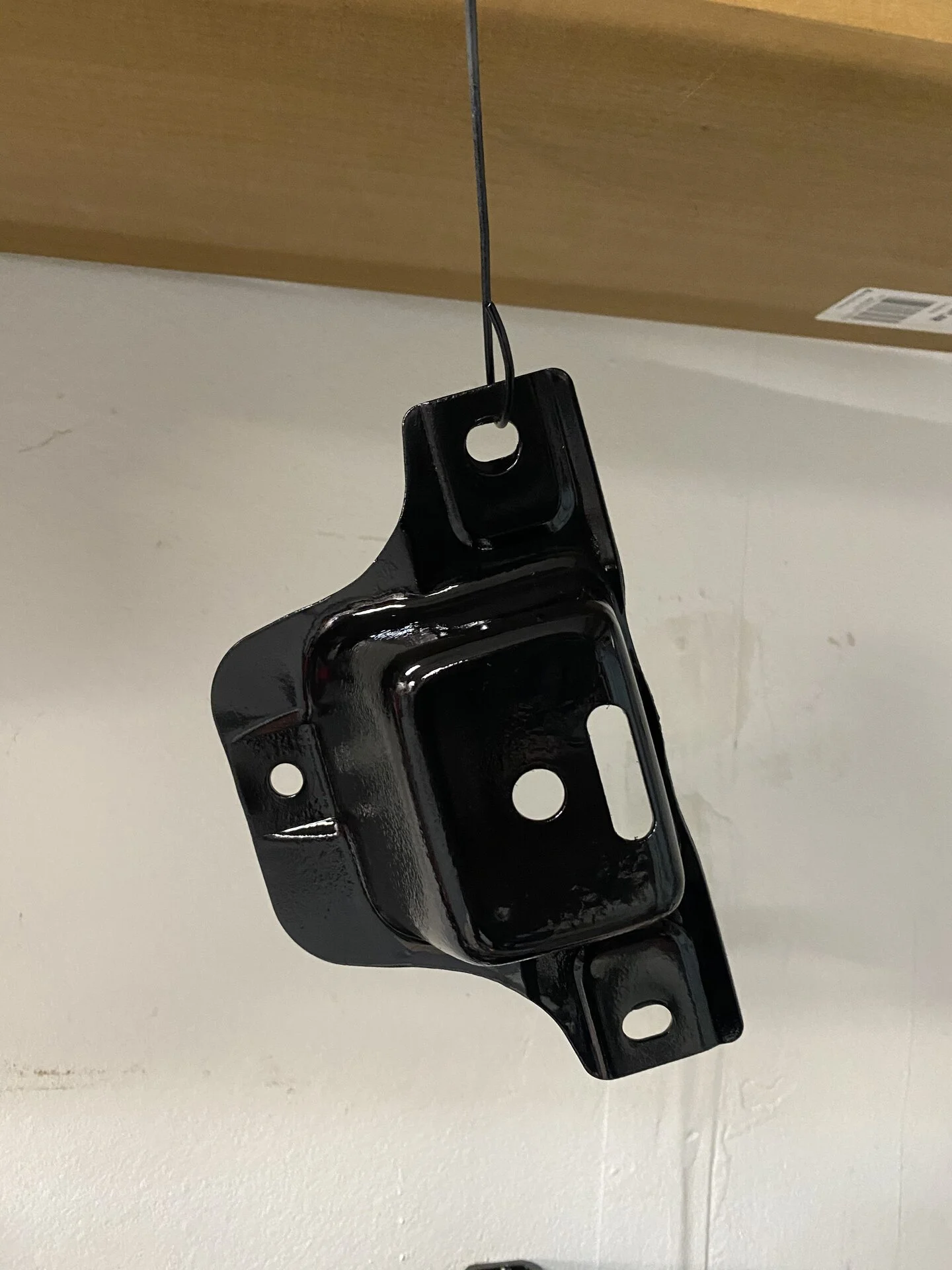

And one of the muffler mount brackets cleaned, and coated with Rust Reformer. I’ll hit it with paint tomorrow:
