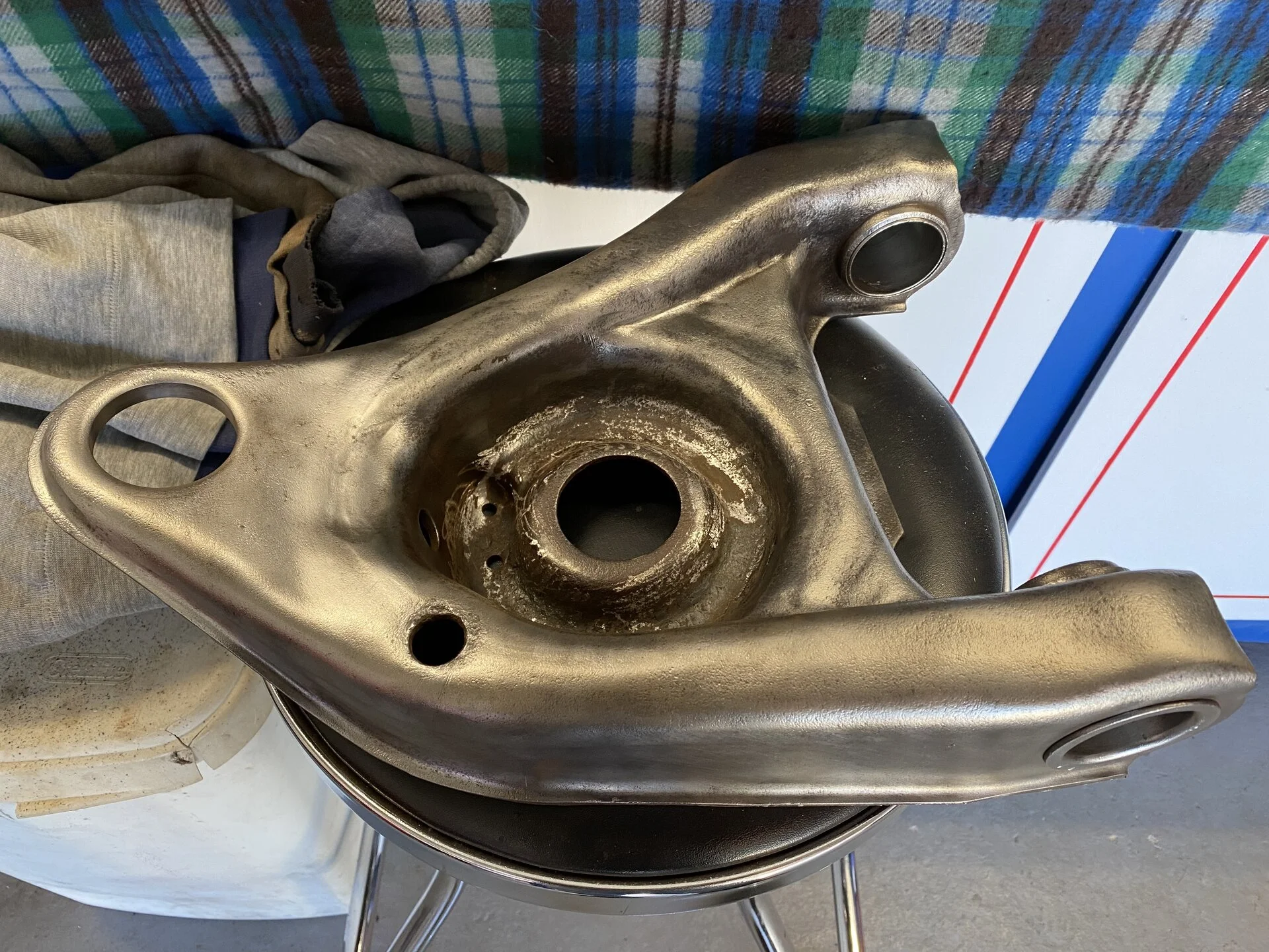

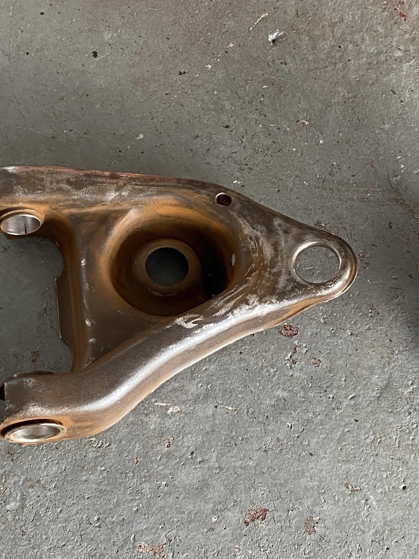

Started the cleanup today while I had a few minutes.
Some more work on Friday morning. Now I know why they invented sand blasters! This is taking some time!

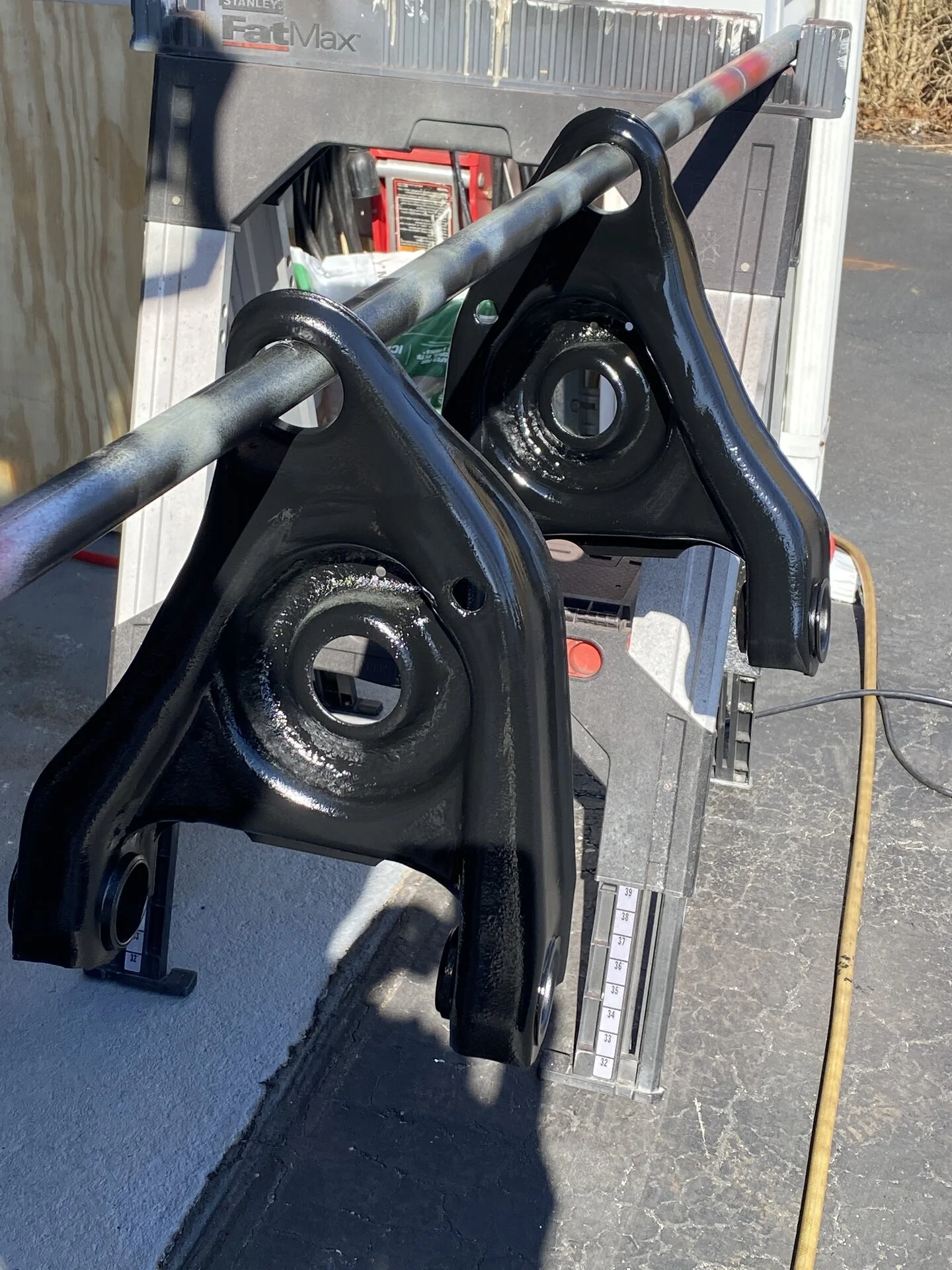

So while I contemplate my torque boxes, I took advantage of the 60 degrees and sunny today, and got my control arms primed and painted.
Not the best, but better than buying new for now.

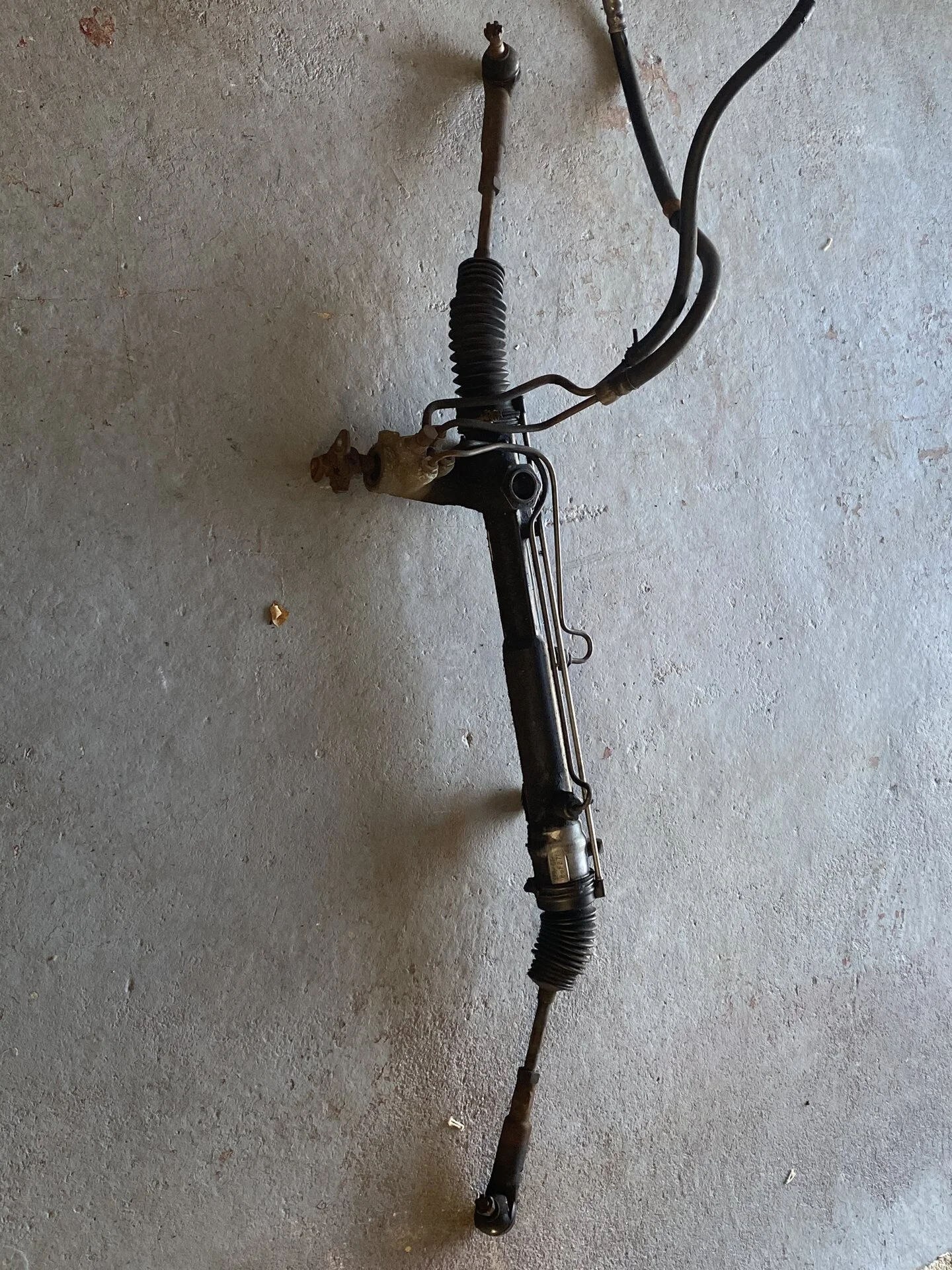

Also pulled my steering rack today. Another thing on the list...... just need to decide which way I’m going on a replacement.

Whomever let this power steering leak all over did me a favor, because the paint underneath it on this k-member is like new!

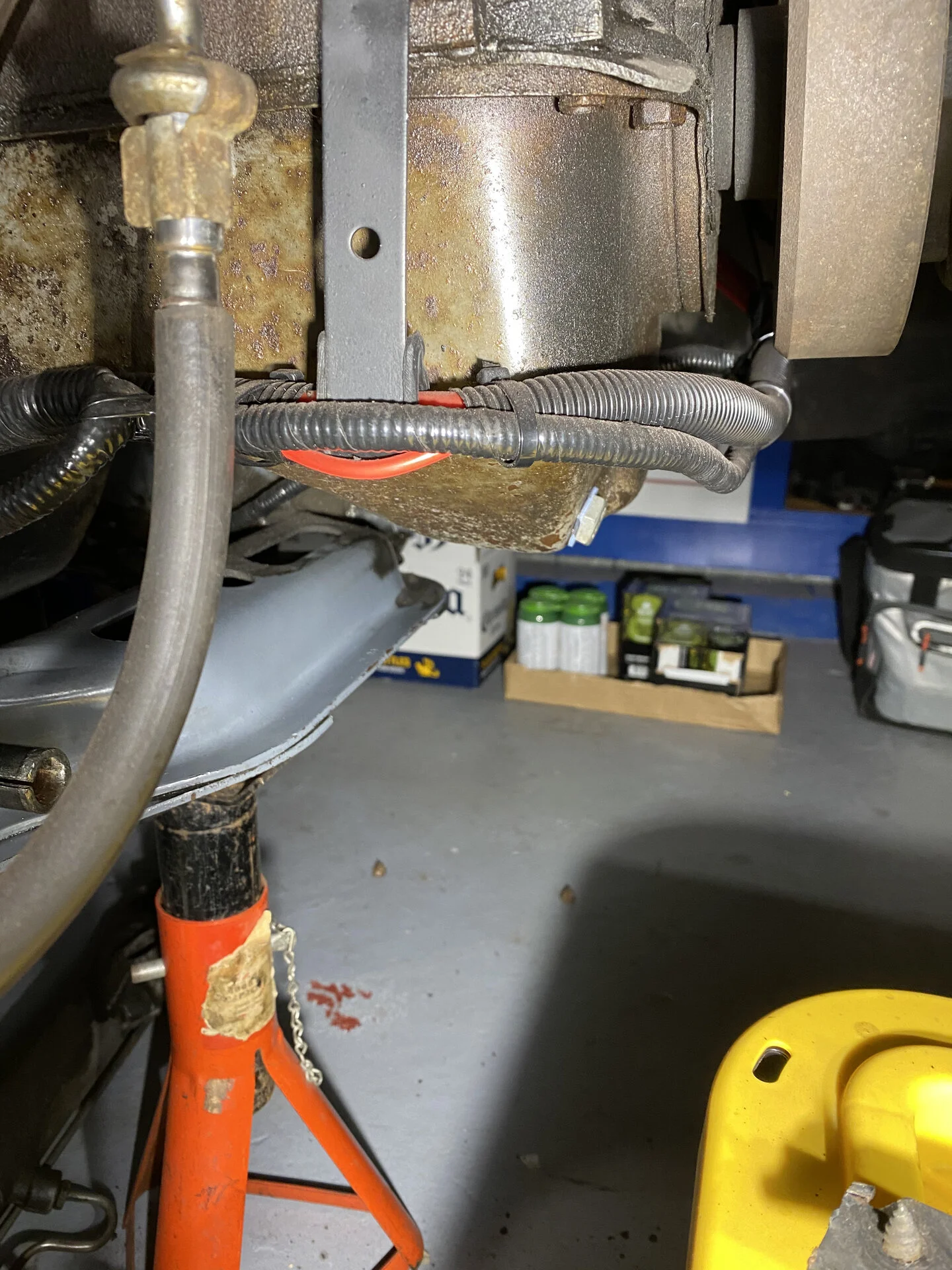

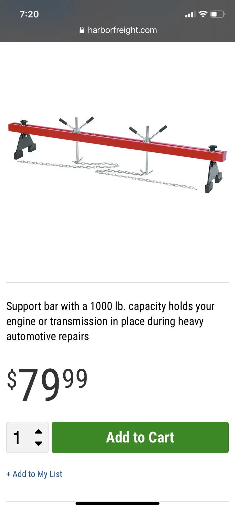

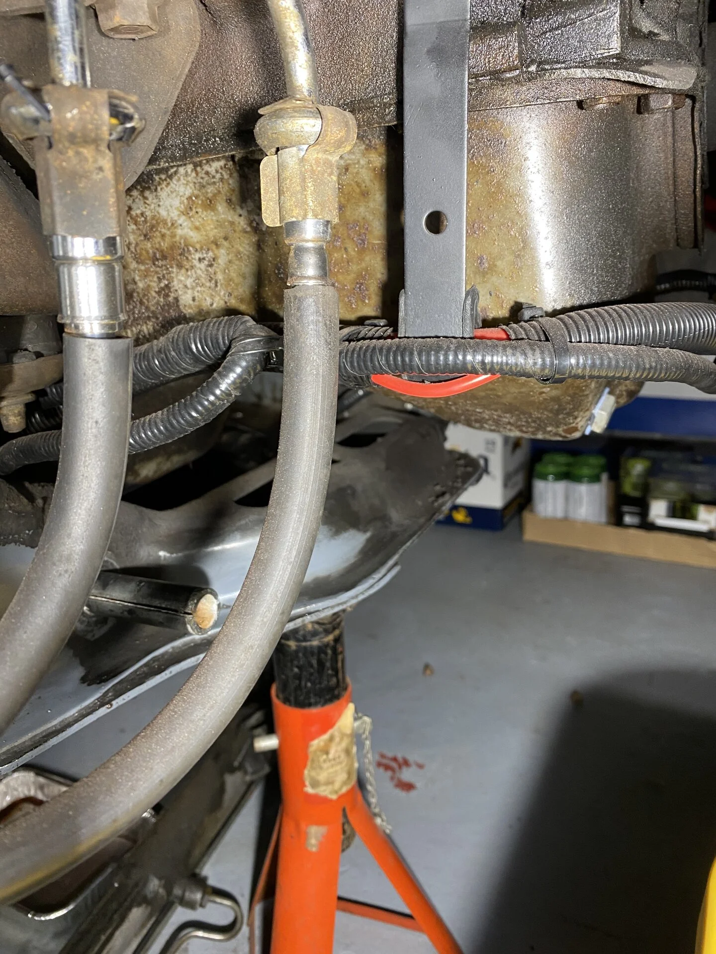

As I clean up this k-member, laying under the car, contorting my arms into places that they don’t want to go, I’m noticing that I’m 8 bolts, and two motor mounts away from being able to drop this thing, get it completely cleaned and repainted.
Im really considering one of these bars, and just drop it down.
And in the “while I’m here” thought process, I can change the the leaking pan gasket, and clean and paint the pan.

  • #699
I've used that bar multiple times on my 93 as well as other cars, does what it's made to do.

I guess the bolts at the front of the heads are the best to go with?
