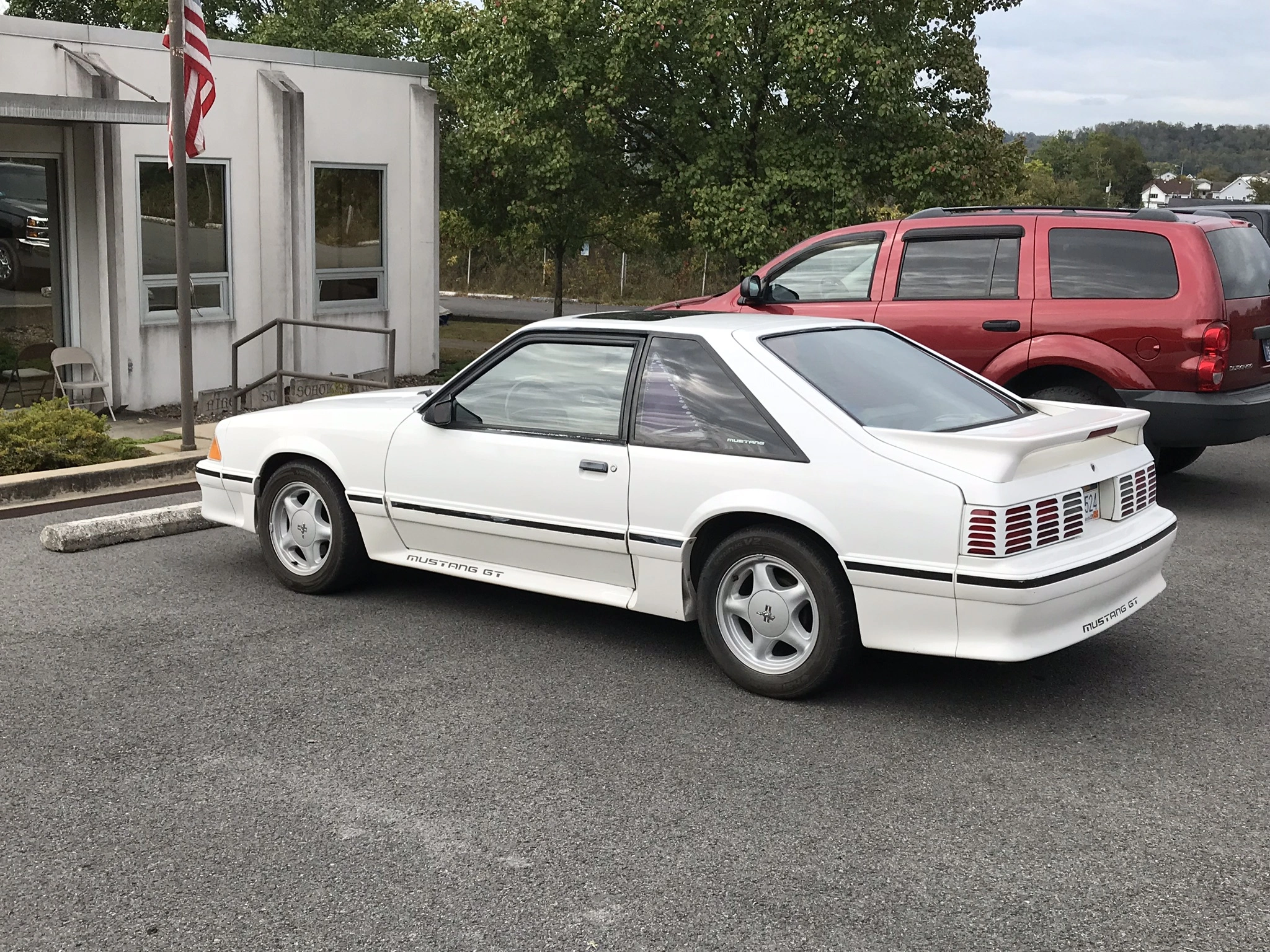

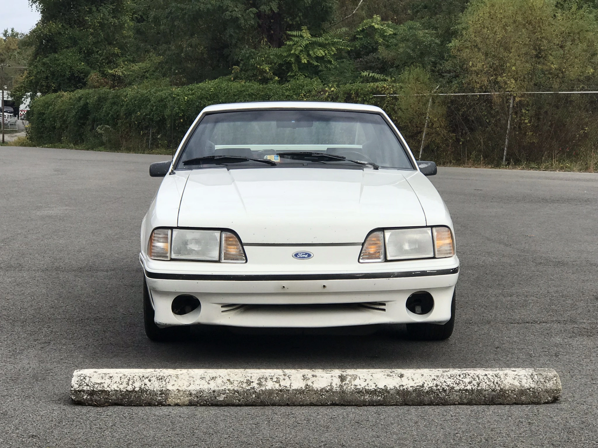

So here goes. White '93 GT 5speed, 140k on the clock. I’m the third owner. It lived in a garage until 2013, when the PO bought it. In around 4 weeks, my garage will be finished and it will go back inside, and the real fun will begin.
THE GOOD
I can’t find any rust on the car anywhere other than some small paint chips. All stock motor and trans, no mods other than a BBK CAI, and full exhaust of unknown manufacturers. It starts right up and drives straight and smooth, shifts well except downshifting from 5th to 4th feels strange to me.
THE BAD
The steering rack is leaking from the passenger side boot, and it also appears that oil is leaking past the front main seal. Everything else under the car is relatively clean and perfectly dry. Lots of little maintenance items are needed like door hinge pins, broken ashtray door, etc. Normal foxbody things that are expected on a 24 year old car.
THE UGLY
The paint is not amazing by any means. There are plenty of rock chips on the front clip and 3-5 small dings on the sides of the car as well as a small ripple in the sheet metal near the rearward corners of the sunroof. It appears maybe the car was “parked” a bit too close to a parking stopper, evidenced by bent fog light brackets, tweaked air dam, and dinged lower core support. The interior is all there, but the carpet is stained and the seat upholstery is quite “previously enjoyed”.

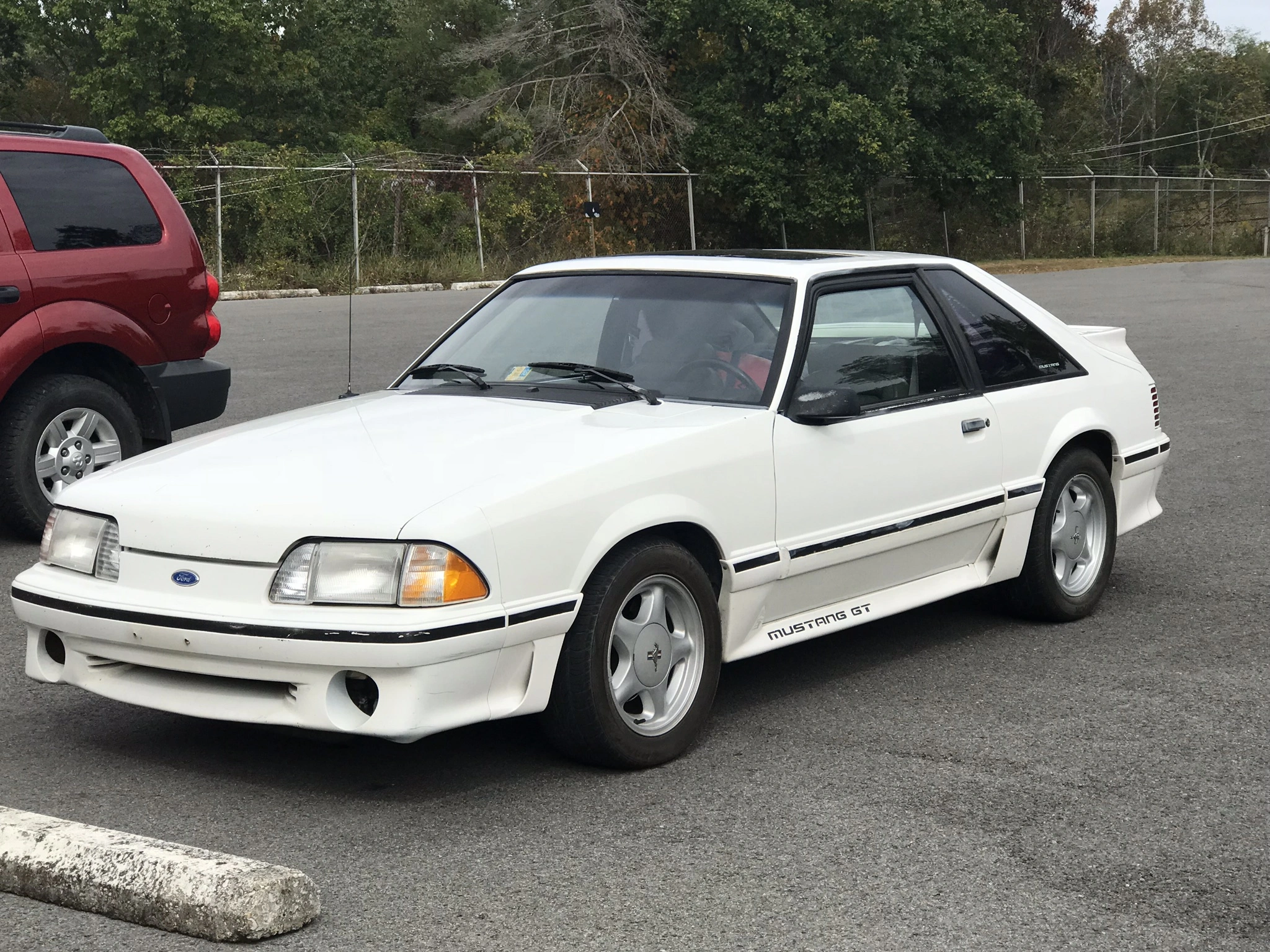

Picture of tweaked lower front bumper cover:

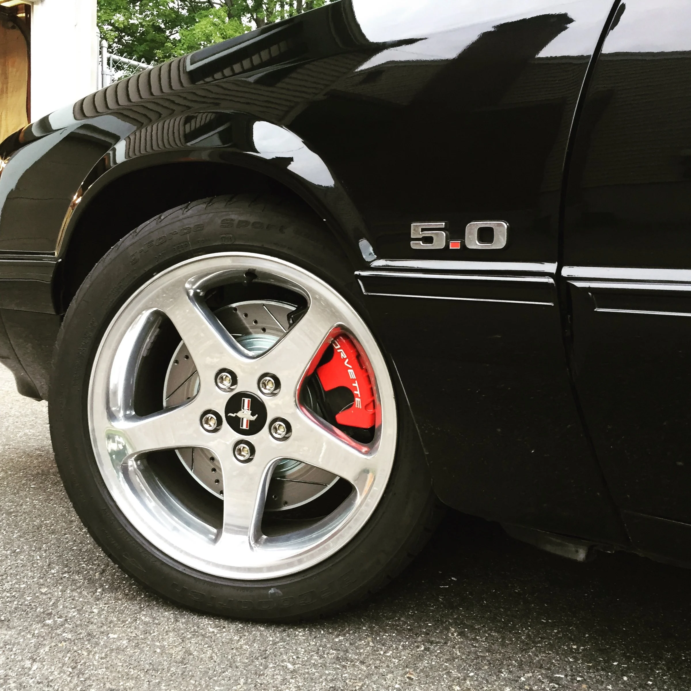

I upgraded my brakes to the OEM Cobra 13"/11.65" versions. Excellent braking!! I found OEM Cobra calipers, rotors, shields on Ebay. I paid about $400 for them and they worked perfectly. Added some SS braided lines from Maximum Motorsports front and back, FRPP adj proportion valve, 93' Cobra brake booster, 93' Cobra master cylinder and flush the whole brake system and refill with new brake fluid. I put in Hawk HPS pads all four corners and car stops incredibly well.

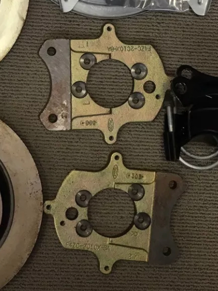

Are you going 11.65" Cobra rear? I can't tell if those are the correct brackets. They may be I'd run the part numbers on them.
Depending on price, you can get rear kit here
https://www.summitracing.com/parts/fms-m-2300-m
No calipers however
The primary difference is that the Cobra rotors are vented which makes them thicker which means you have to purchase thinner brake pads for the rear.
EDIT: bad info removed
I believe the brackets work the same for both GT and Cobra rear brakes, they're both 11.65" dia. The primary difference is that the Cobra rotors are vented which makes them thicker which means you have to purchase thinner brake pads for the rear.
GT rotors are 10.5". There's a offset difference between the GT and Cobra brackets to account for it
Googling the part numbers on those brackets is telling me I need to run SN95 length axles. I don’t want to do that right? I can go through north race cars for the brackets, these just came up on a kit on eBay that’s going for cheap. Dust shields, moan brackets, calipers and rotors and those brackets. Thought I might bid if it stays cheap.
And yes I’d like to be 13” up front and 11.65” in the rear. So If everything comes from a 95 cobra beside master and booster I should be good? I’ll get the lines and miscellaneous from maximum motorsports and lmr depending on what I need to complete.
