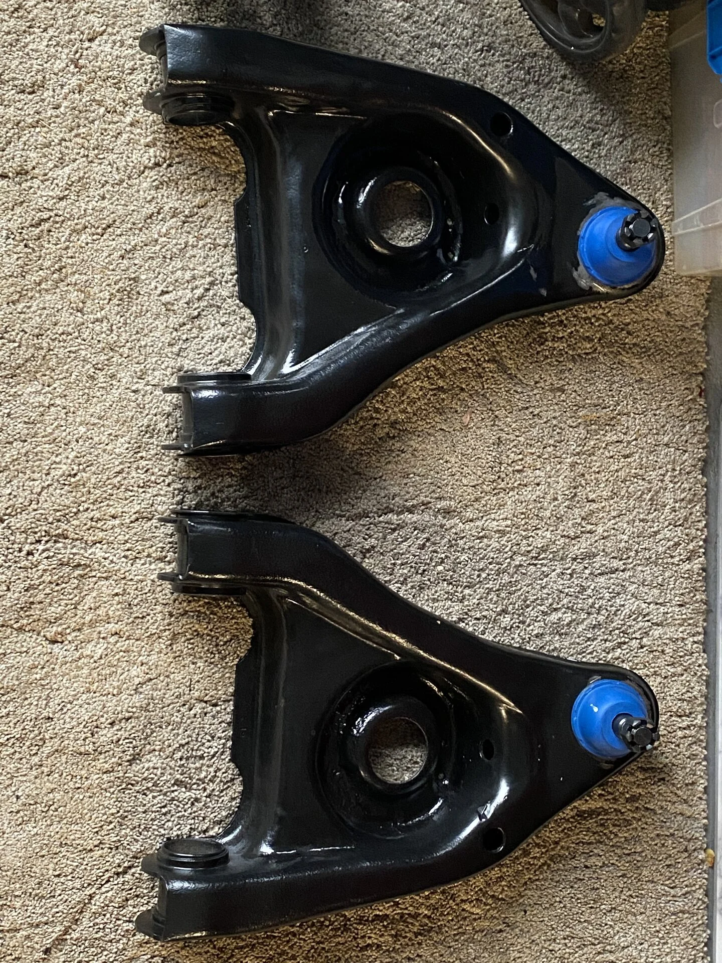

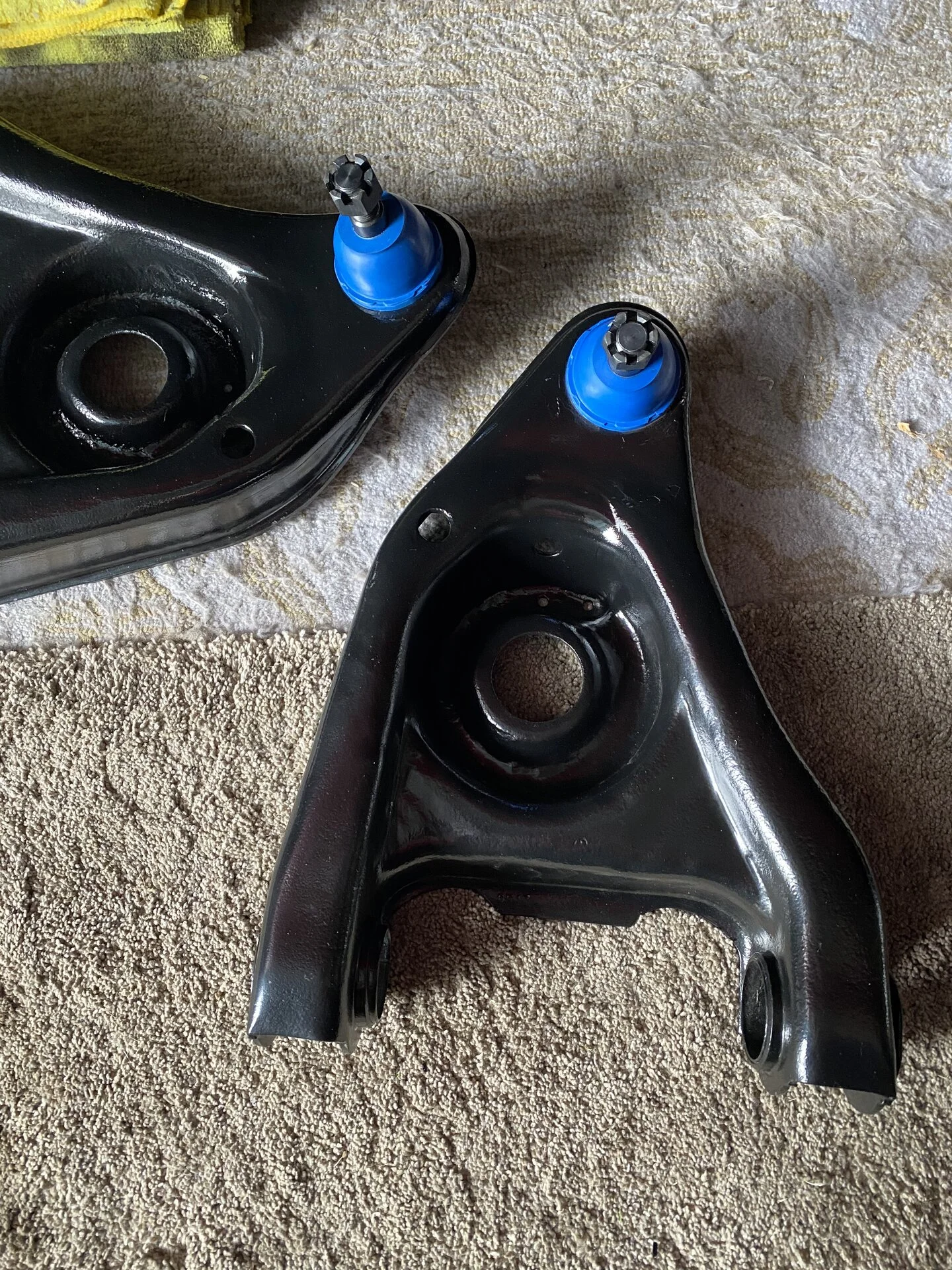

A little work here and there. Got my sn95 ball joints into my control arms. More of a PITA than I expected, but they are in!

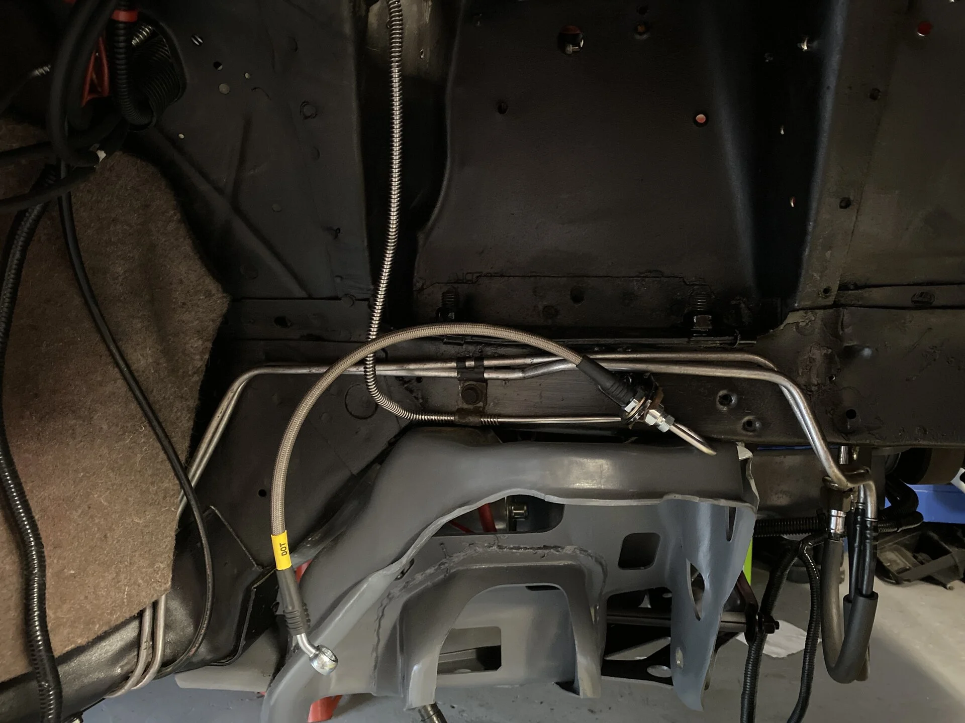

Also did a little more work getting my brake lines finished up.

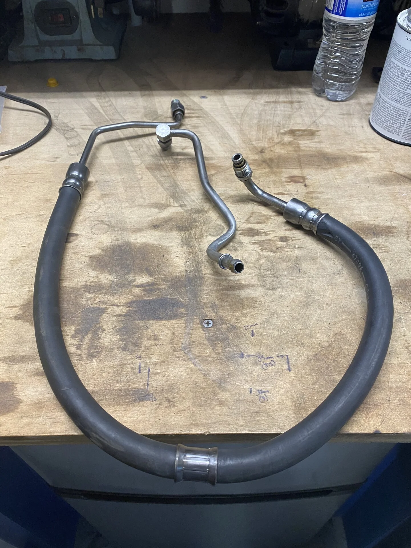

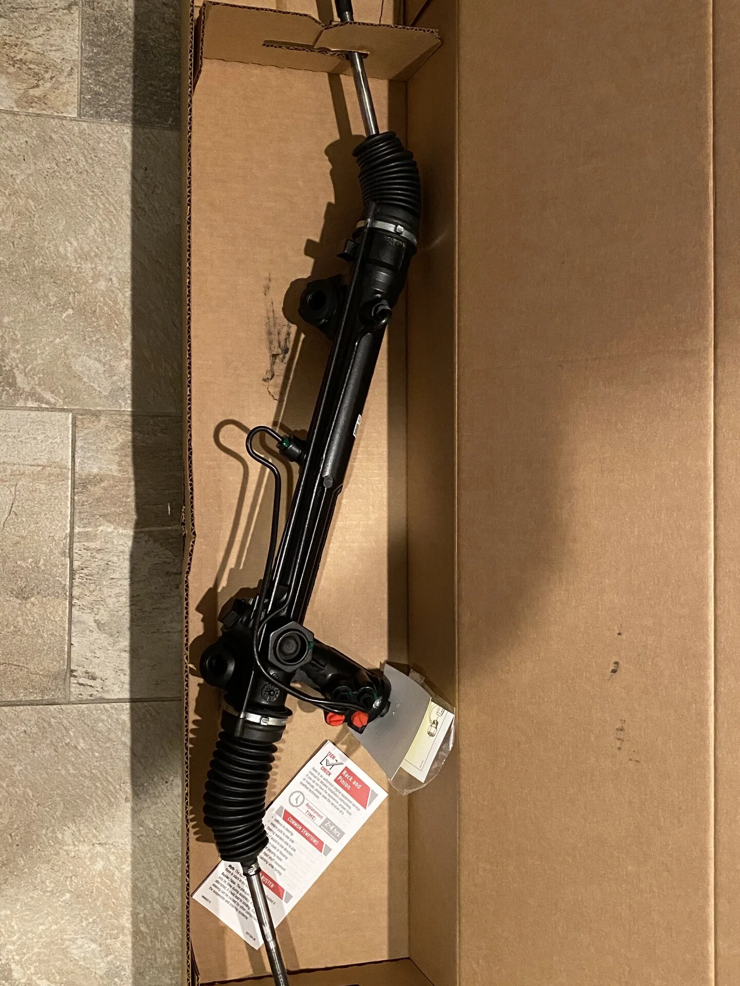

Hopefully I won’t regret this, but I picked up a remanufactured steering rack from Advance, today on my way to work. I guess it’s got to be better than one that was leaking...... I just hope it lasts a while. I’ll check it out when I get home tonight!
It's a crap shoot honestly.. sometimes you get junk other times it actually works and doesn't leak or have tons of play. Good luck

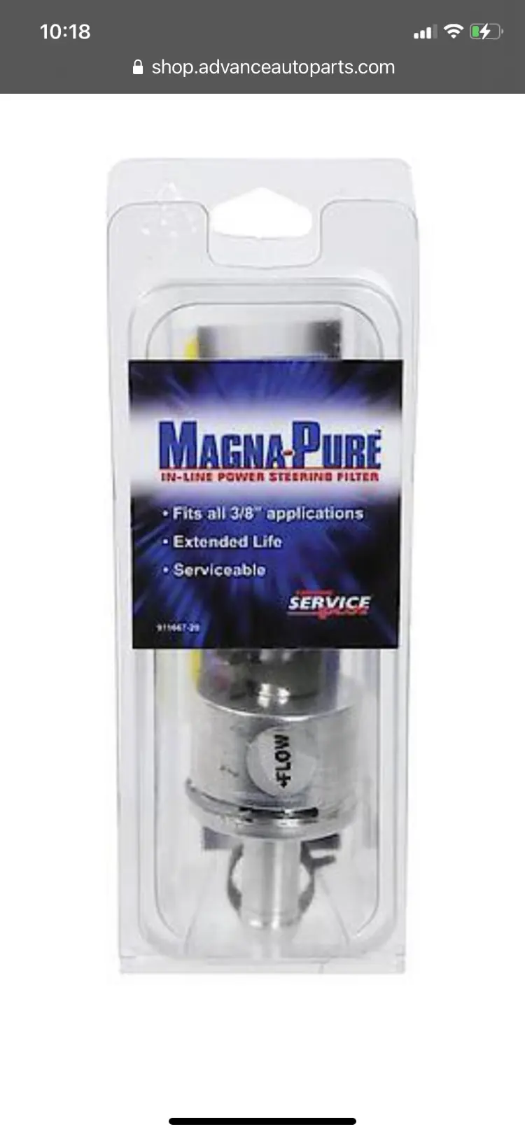

i got mine from Advanced , and it's great. Just get the filter, and you can't beat them for the price.

Did you get the filter at Advance? Happen to have a pic, or a link to it?
Heres the one I got. Would rather it be silver, but I’ll probably just leave it, and switch out the bushings for my poly.

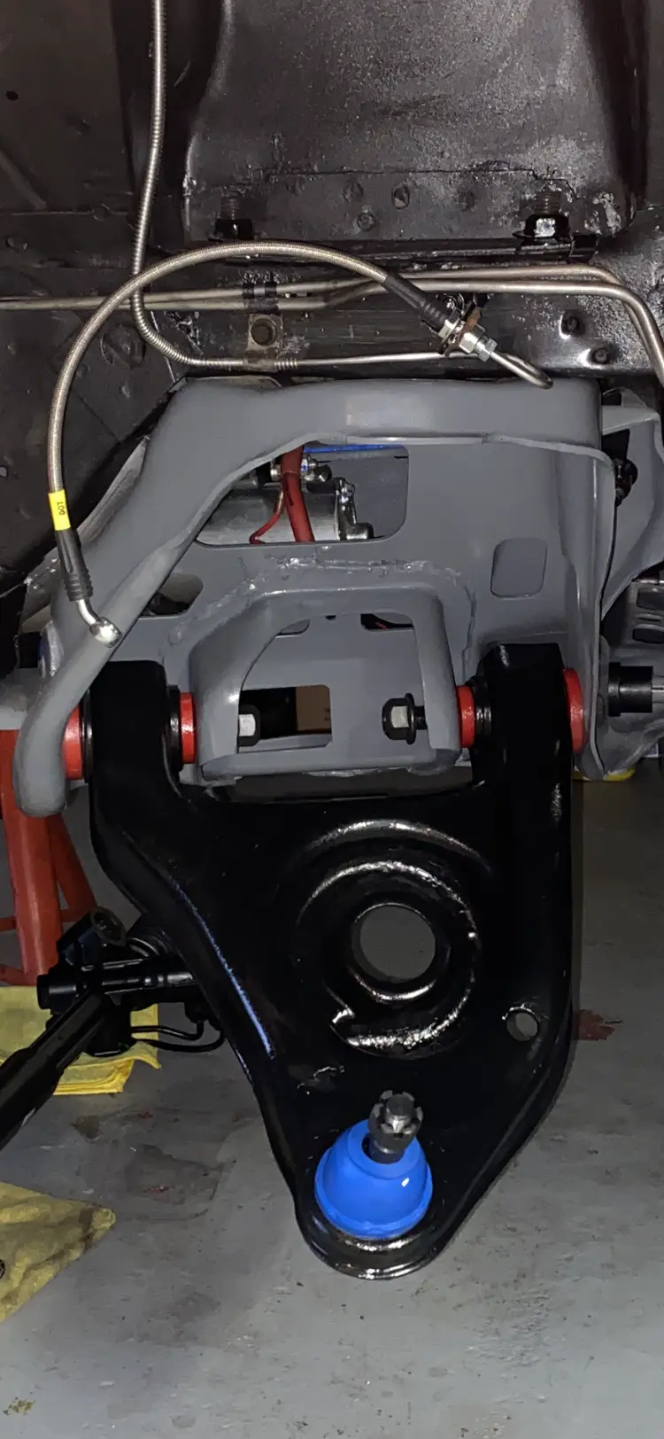

I almost put the steering rack in, and then remembered about the control arm bolts being a bee-atch with the rack boots in the way.
So I shifted gears, dealt with that super sticky prothane grease, and got my control arms in.
My question here is....... can I torque them to spec up in the air? Only the rubber needs to be pre-loaded, correct?
This probably seems trivial to most, but it feels pretty cool to me to be making progress with things going back together! Definite boost of energy for the project tonight!
I torqued my lower control arms when the suspension was together under a load. I took my floor jack and jacked up the control arm till the car started coming off the jack stand on that side. I was worried the car would not sit right If I torqued them when it was not under a load.

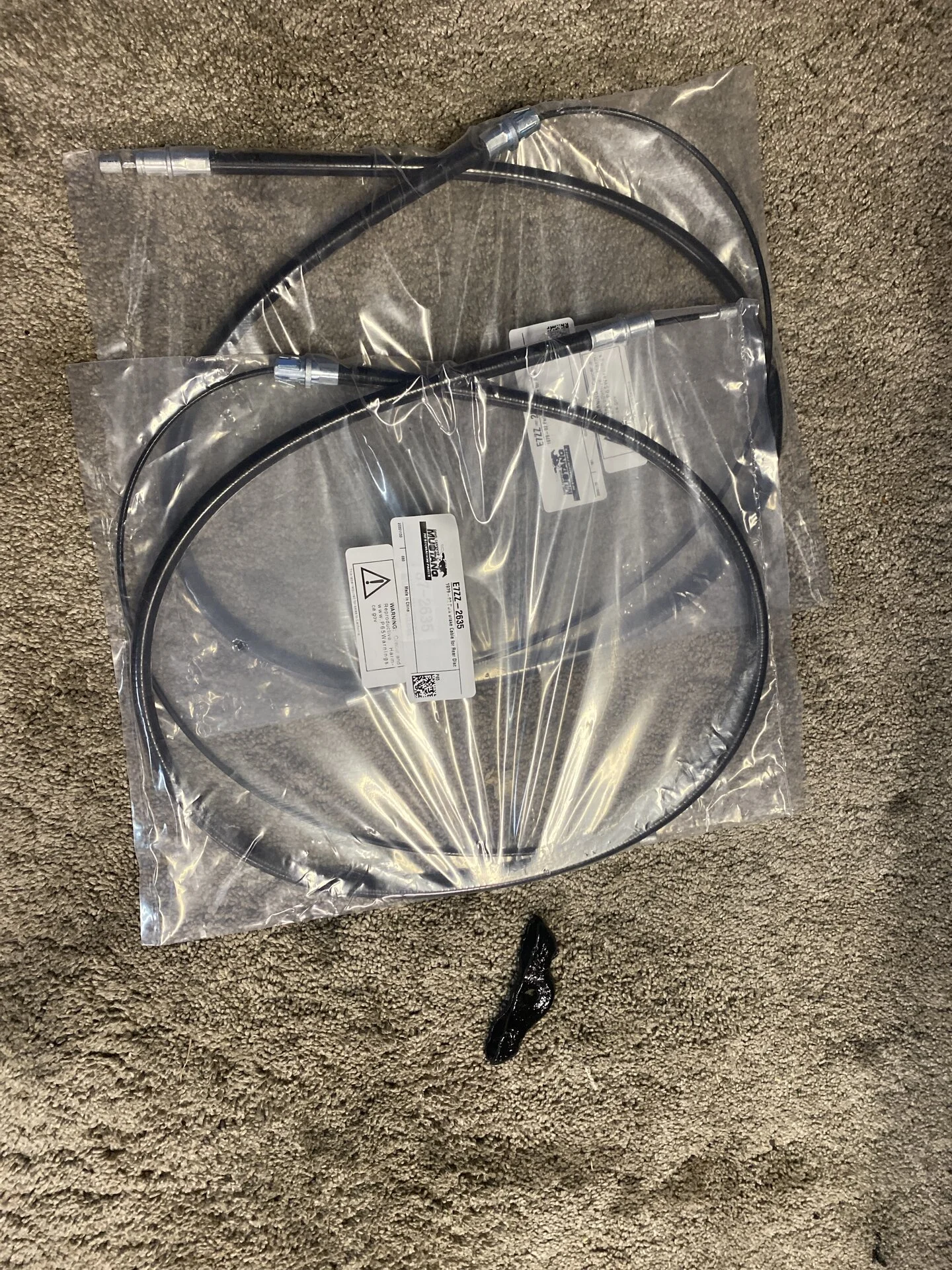

Last night I ordered my rear parking brake cables.

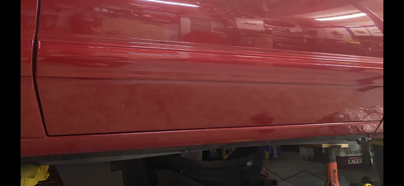

The pinch welds were always a mix of primer/ red/ black. I finally got them masked off to look a little better as you look at the car. ...... and now im realizing I gotta work on that paint, as the reflection is nothing like @95steedamustang paint. Lol

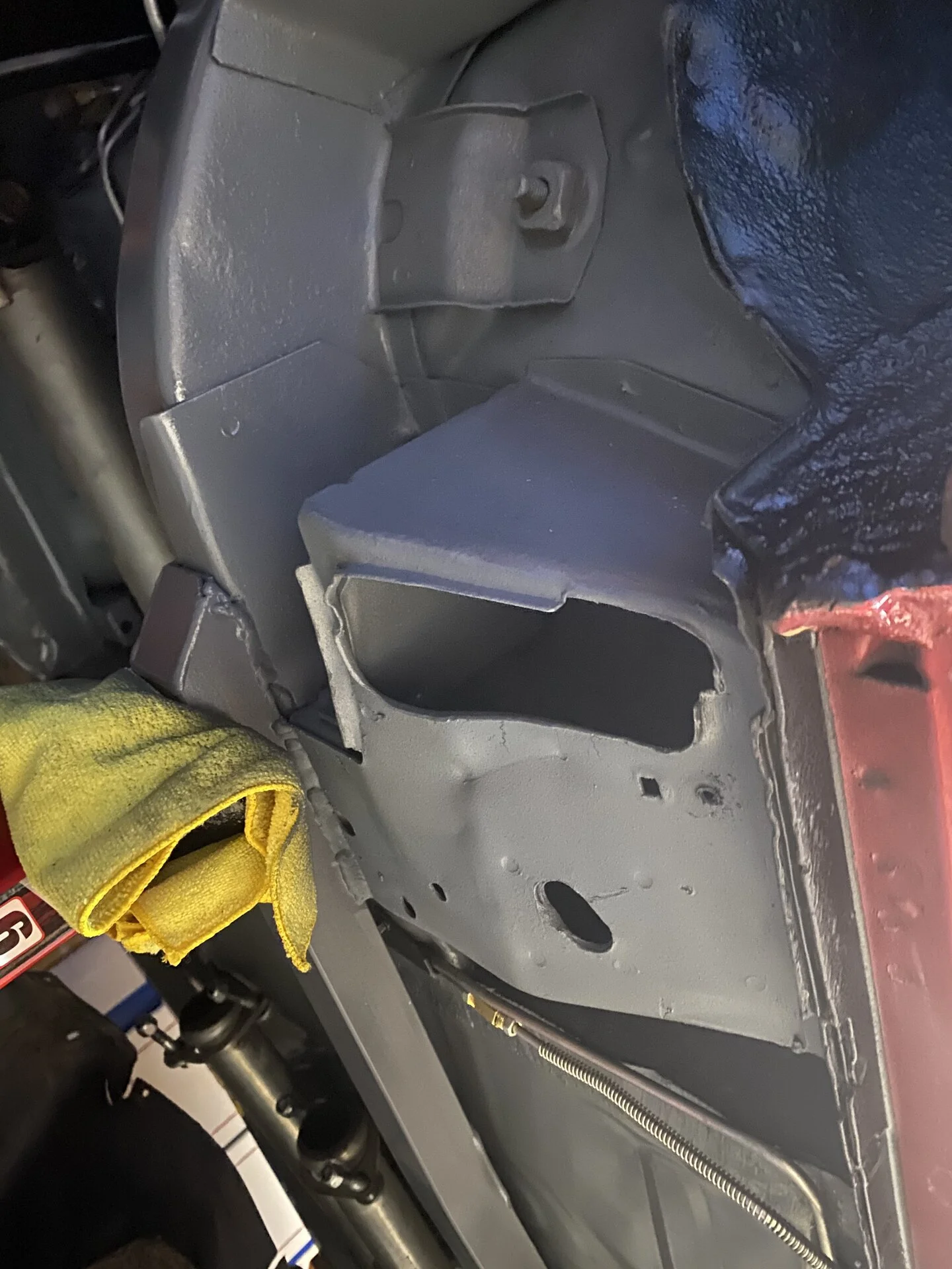

Got some more paint done underneath on the torque boxes as well, while all the suspension is out.

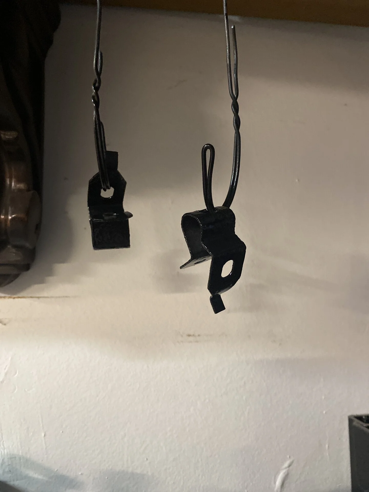

It takes some time, but I like when I can restore and refinish the original brackets and hardware. This car is nothing close to original, but for some reason I enjoy these little details.
