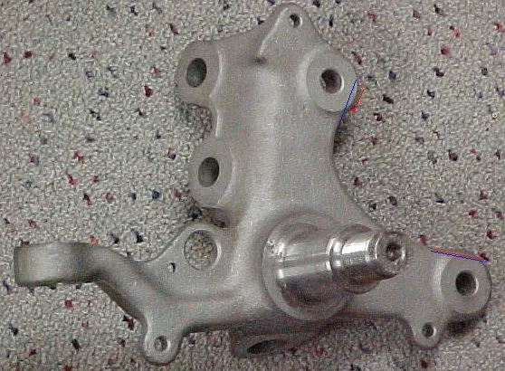

Spent some time grinding the two spots on those spindles to clearance the PBR’s. It didn’t take much at all!!
do you have to clearance the spindles regardless? that is the one thing i didn't do, and thinking i might need to do before i button everything up.. Could you point out the spot you had to work on?
THanks.
you can see where the red and blue lines are. That’s what needs to be taken off. I juat ground a little, checked fit, ground a little more, check.... etc etc until I got it where I needed.
Thanks. I didn't see any issues with mine but maybe need to look a little closer, will poke at it today.
I’ll see if I can grab one from my plastic bins where I have them stored, and a get a pic of everything together. It wasn’t a lot, but it definitely needed to be shaved down a little.
No worries. Just wish I would've thought about it ahead of assembling everything. Should be able to take a grinder to them as they sit though. To conform you have 94-95 spindles?

Yes..... 94-95 spindles.

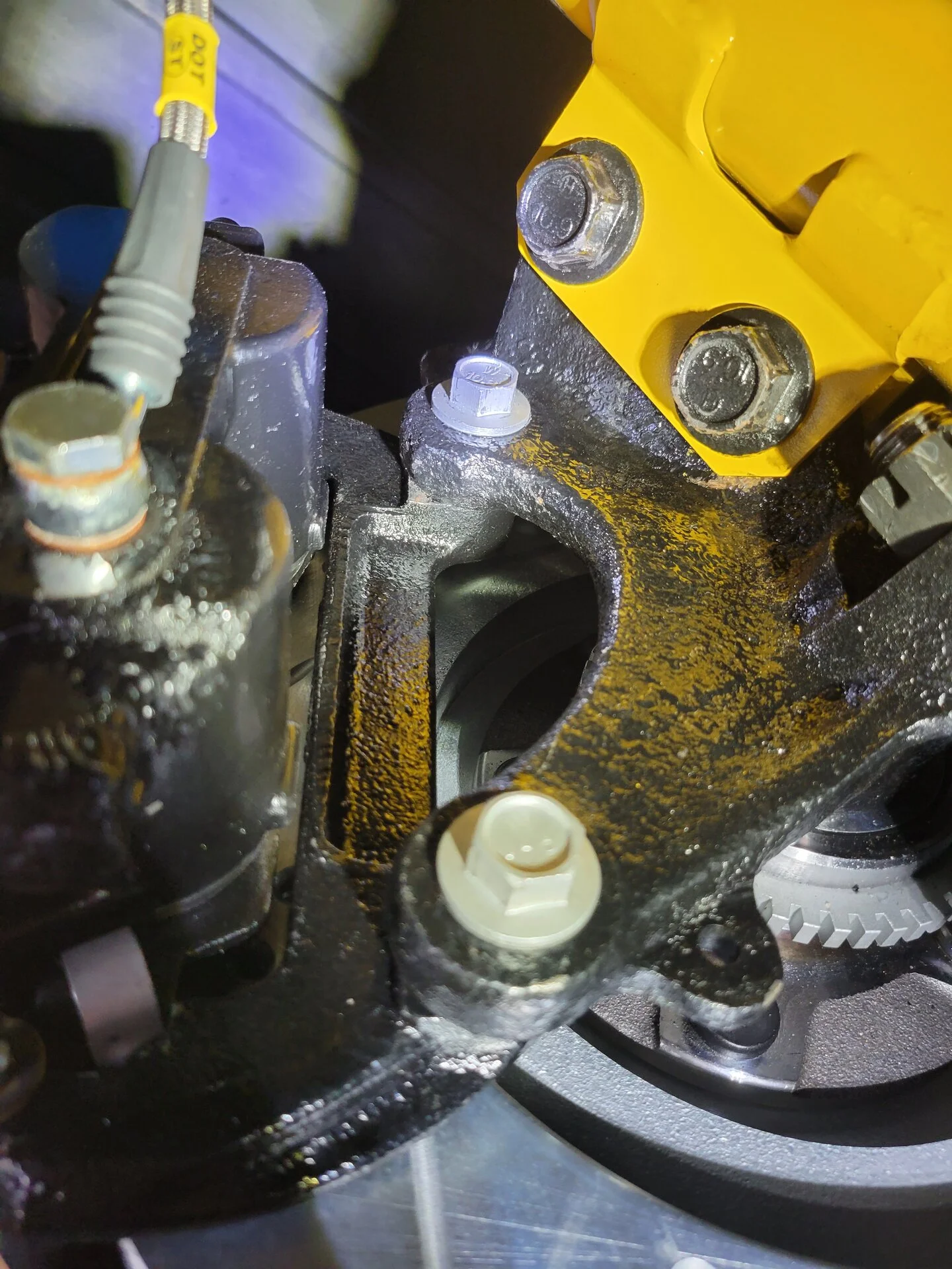

Ok, not seeing why I would need to do this with my setup.. am I missing something? **edit** are you using 11" or 13" rotors? I think that is where the difference is here.. I have 13" rotors which set the caliper out further from from the ears.

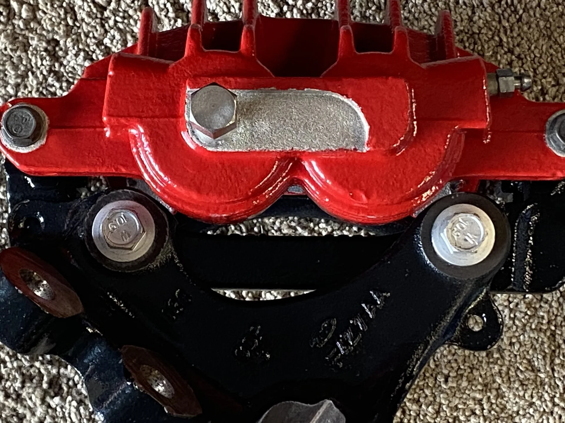

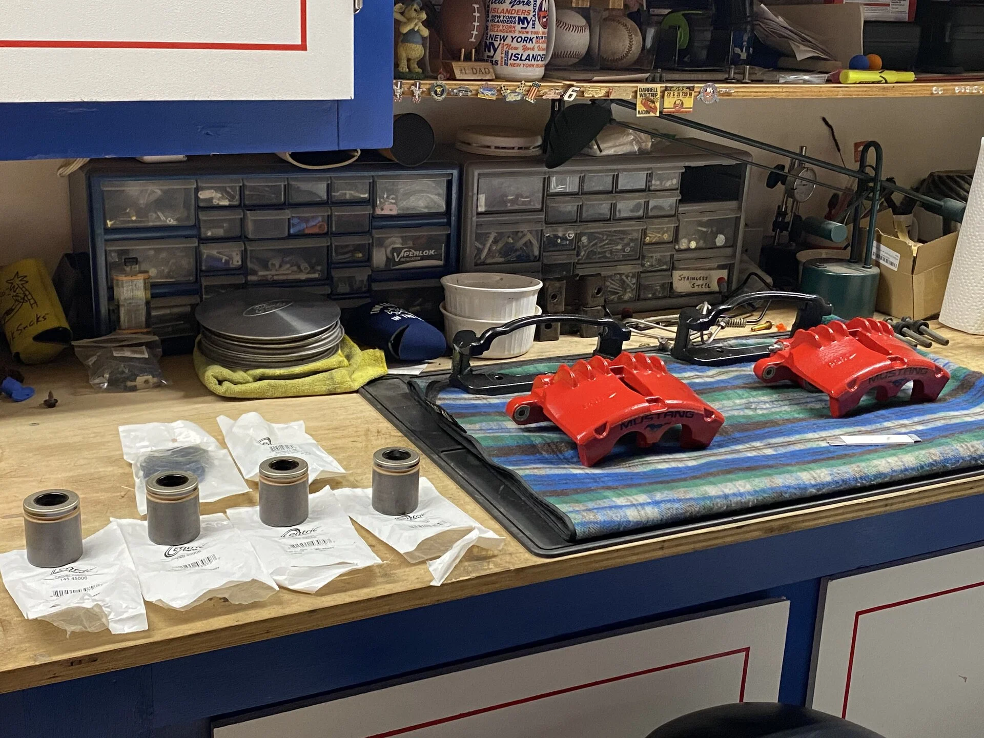

I finally got the rear end off my workbench, and now I can start final assembly on my front calipers.
Eibach Pro kit should be on its way soon. Max Mtrsprts said it would ship the 9th, but haven’t heard yet. No big deal..... still have to order lower control arms for rear, and CC plates for front.
I have officially emptied the bedroom closet of “parts in waiting”, so I feel like this is getting close!! Can’t wait to get it back on the road!!

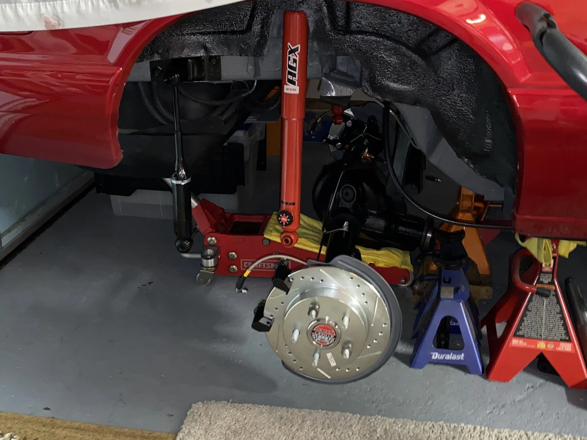

looks sharp! did you use an undercoating in the wheel wells?
