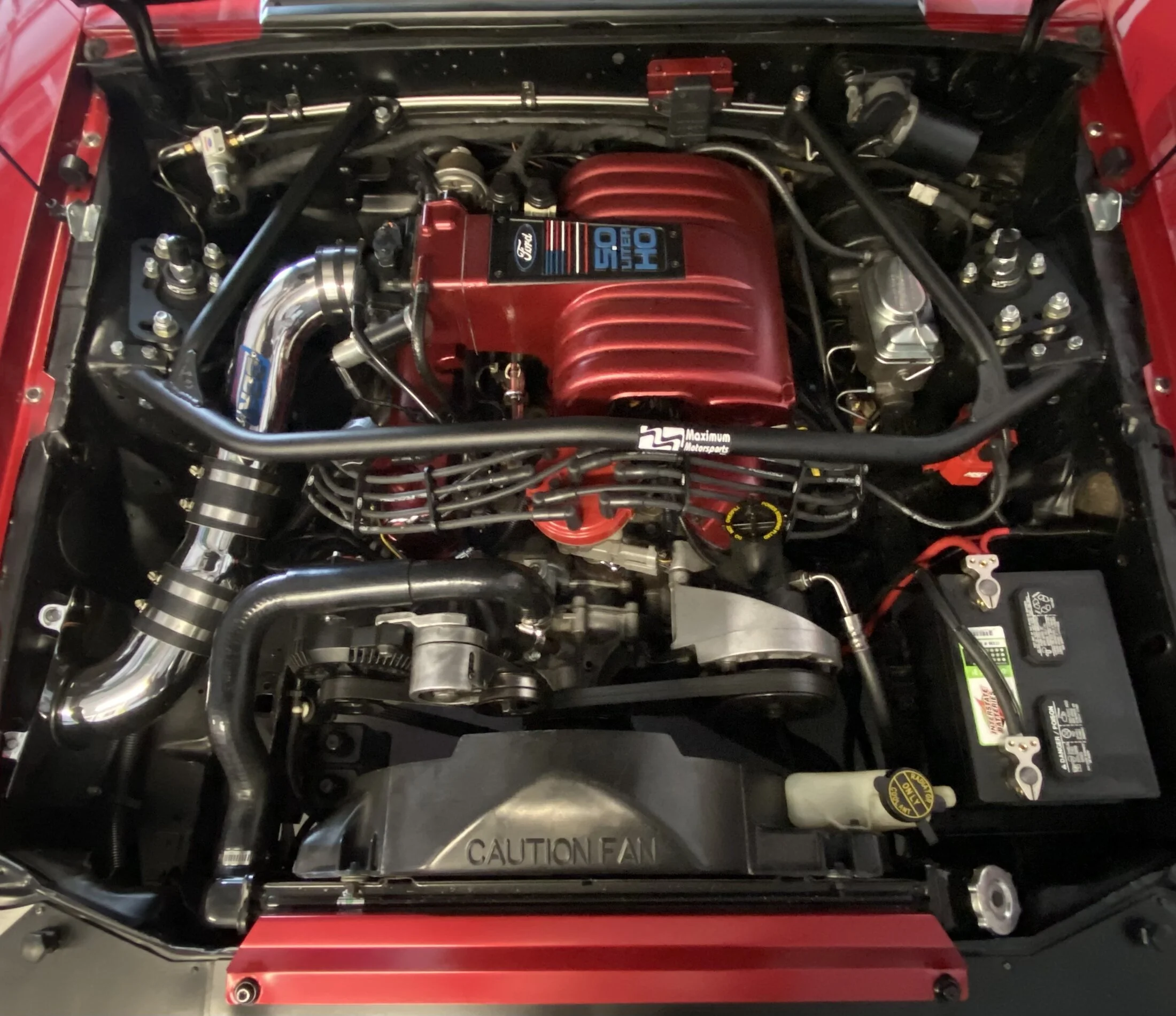

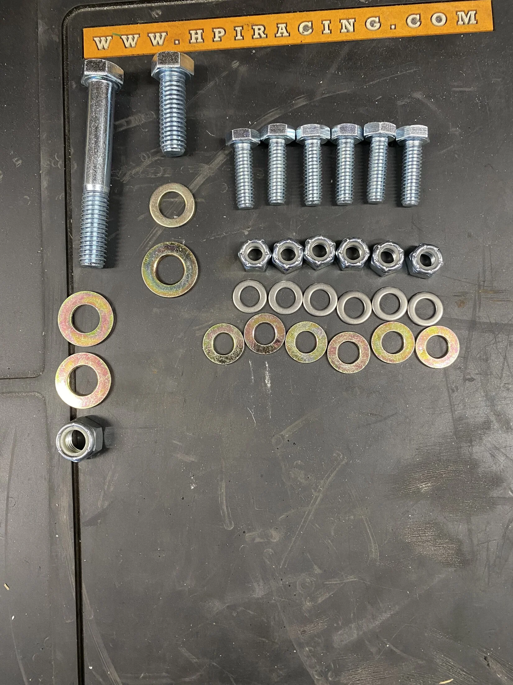

On a positive note, the MM brace is here, and on initial fitment, it looks like I’ll just have to tweak the brake lines a little, maybe adjust the harness under the pinch weld, and it should be good to go.
Edit: When I say there’s always something, there’s always something. One large locknut is missing, so Ace Hardware here we come!

Man that engine bay looks gorgeous, yeah when I put mine on I had to tweak a few things, where it bolts to the pinch weld on the driver's side it's reaaally close to my brake line so I put a little piece of this stuff we use at my work called Fabreka, it's like hardcore rubber just in case that bar was gonna flex and rub against the line, I'm sure just about anything would work.
Those strut tower braces sure are worth it specially on a vert,I have a 89 and a 91, my 92 is the convertible, when I installed my new engine back in November and I pulled my brace off those pinch welds looked like they had gone thru hell flexing.

Looks like he’s resting on the CAI and still needs to come down a couple inches. That sucks!
As common as aftermarket intakes and air tubes are, I’m surprised MM haven’t come up with a “modified” brace in their lineup.
Exactly this. I've got a buddy who's a great fab guy,gonna have him look at it.

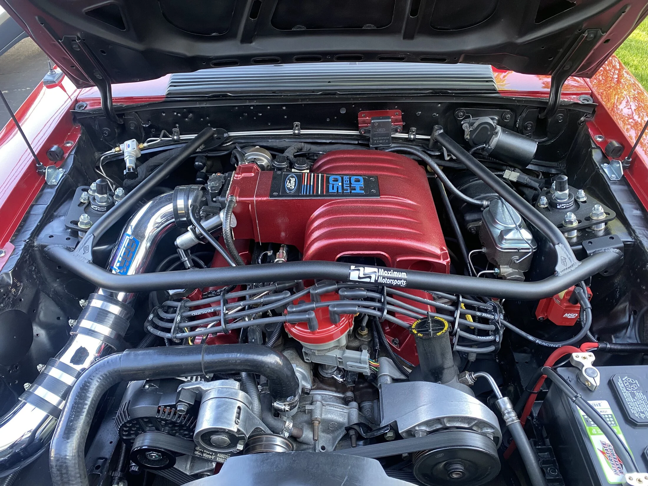

Strut tower brace mounted and secure. I’m liking how it looks with the rest of my engine bay. Fits right in!
Used a split silicone vacuum line behind the left pinch weld mount for the brake line protection. The right side had those “springs” wrapped around in just the right place, so I think they’ll be ok.
Looks really nice man,love that red on the intake and the flag motif on the plaque, super cool, I have a Explorer intake on mine and I tried to do a flag once on tht plaque but the colors ran into each other because of the way it's made and it didn't look good.

Thanks man! That flag on the plaque was one of the first things I painted when I started on this car, and is still my favorite piece!
I have an Explorer intake on the shelf, and if I ever get it onto the car, that flag will be switching over to stay on the car for sure!
