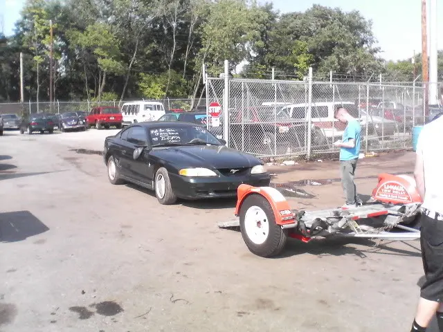

here is what were starting with...rust free 98k miles with no rust and clear title... :nice:
were pulling the 3.8 out after school tuesday...
here are the pics..it will be getting painted ect later on..maybe some 18" bullets!

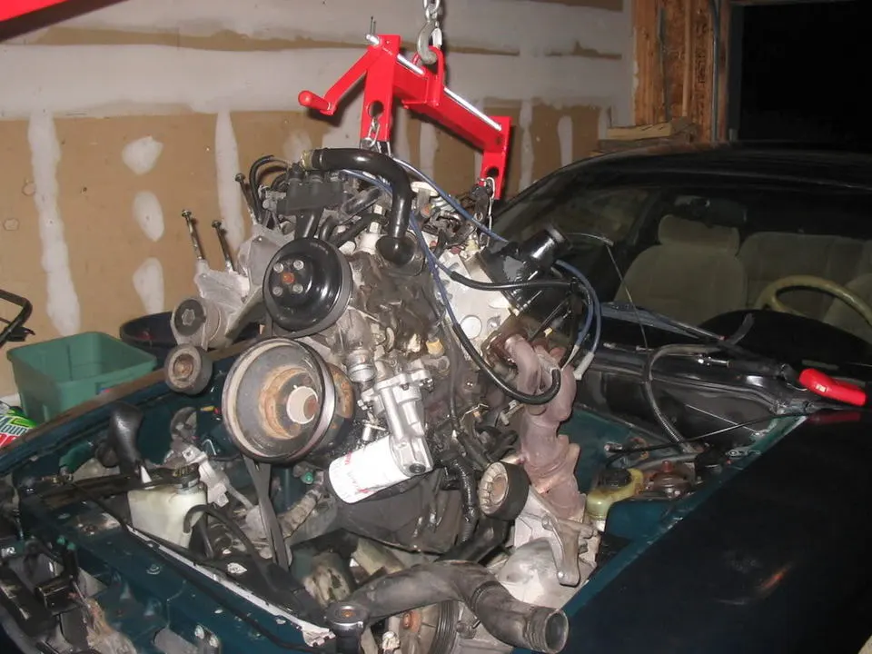

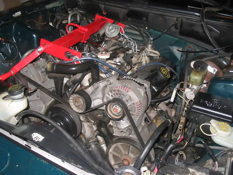

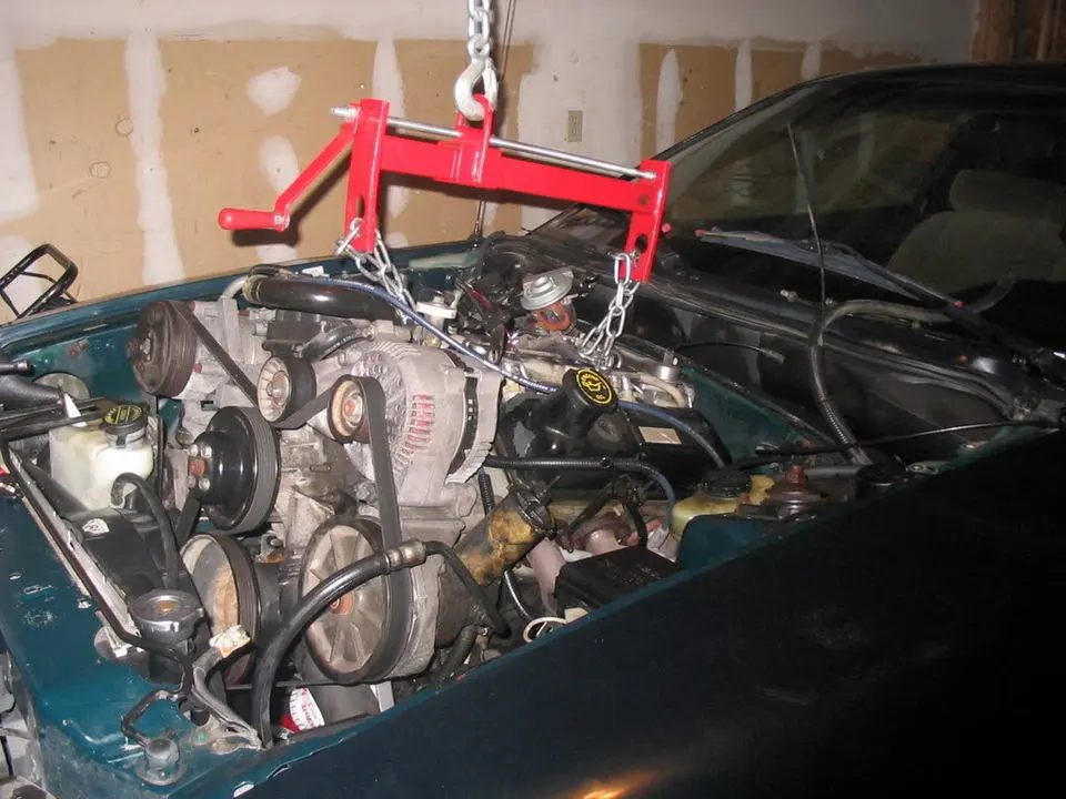

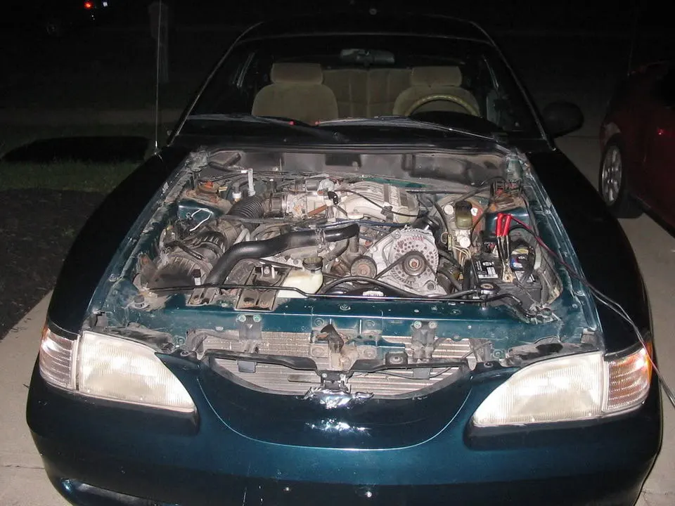

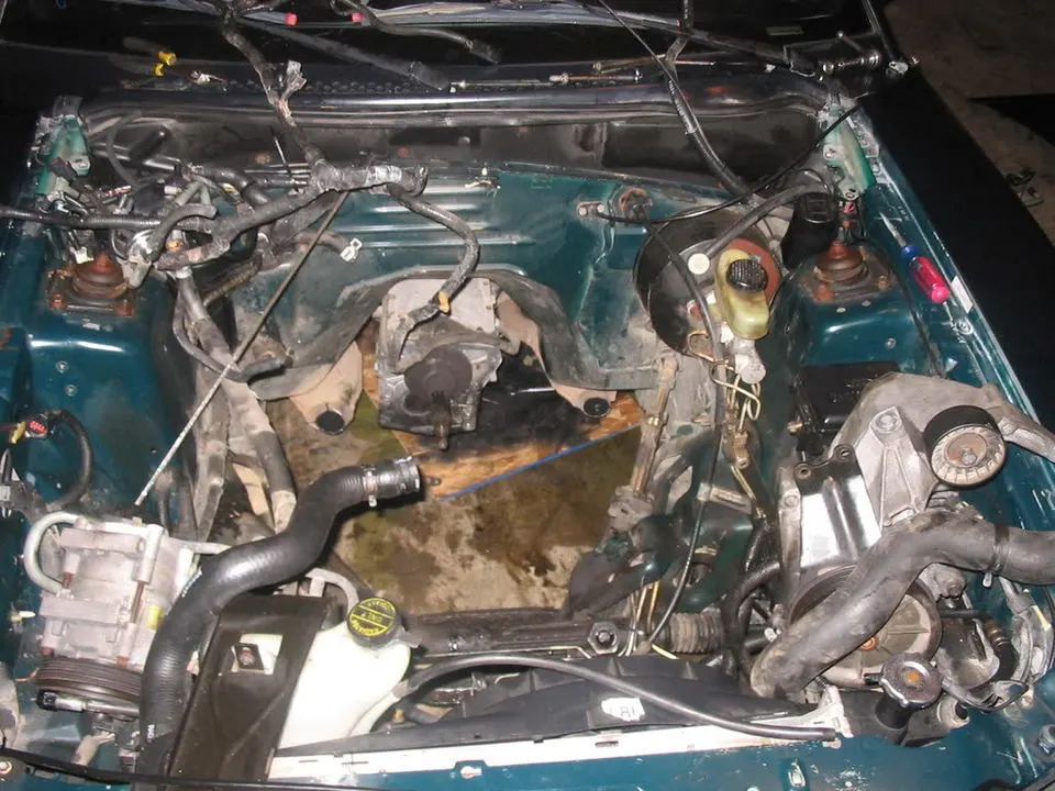

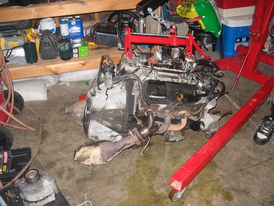

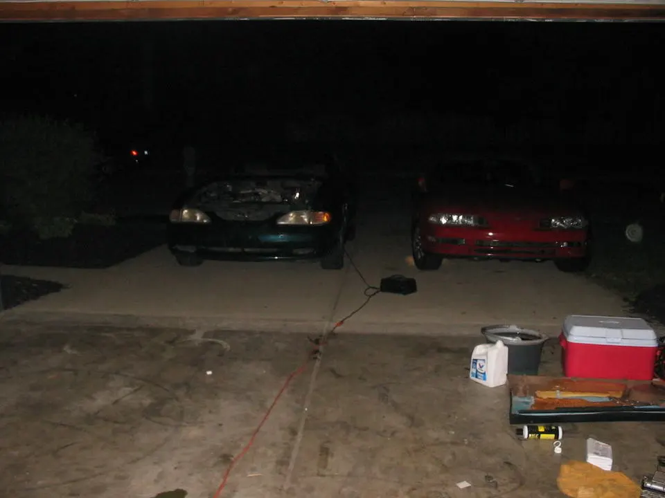

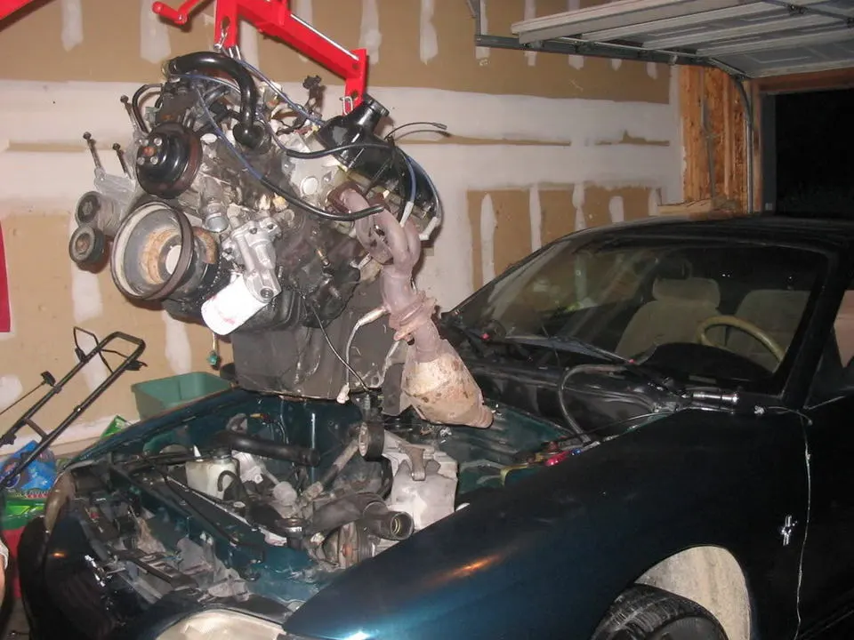

yanked the engine out today...took about 2 1/2 hours from start to finish....we made a mess :rolleyes:
all went well and smooth...pretty easy pull..
here are some pics..

I'm doing this for my brother as a surprise present for his birthday on 9/15. I'll be finishing installing the engine in his 96 3.8 5speed vert this weekend.
which year model sc engine are you using?? 89-93 or 94-95?? personally, I'm using a 93 engine as that's what I had around.
had to swap the timing cover, harmonic balancer, get a flywheel for it, a pilot bearing...not to mention swapping everything over from the mustang's 3.8...
oh and go ahead and re-use the harness from the mustang engine and sell the harness/ecu from the supercoupe and use the money to get a chip for the mustang ecu....sooo much easier.
I'm also realizing that it's a PAIN in the arse to have the intercooler tubes bolted to the engine while trying to get it back in the car hahahah
edit: oh yeah, um, why did you cut the exhaust behind the cats when all you had to do was unbolt them?? no impact gun or anything??
