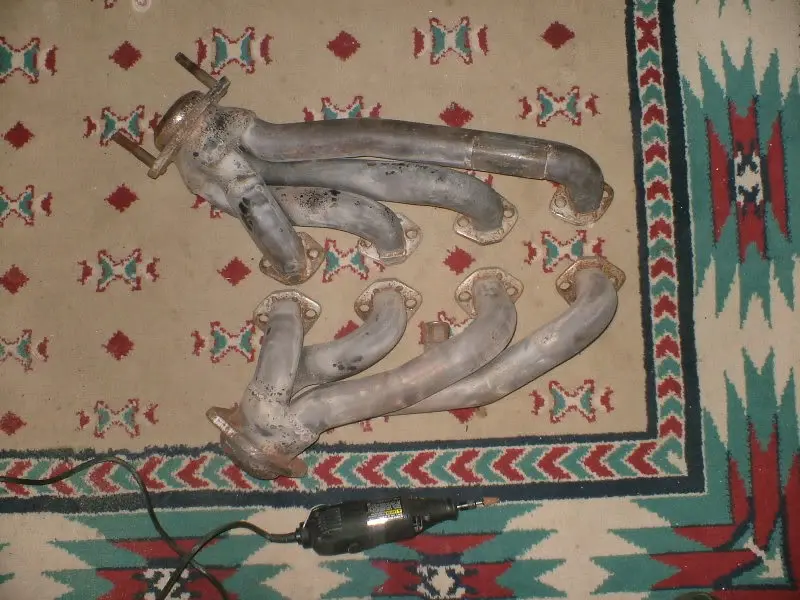

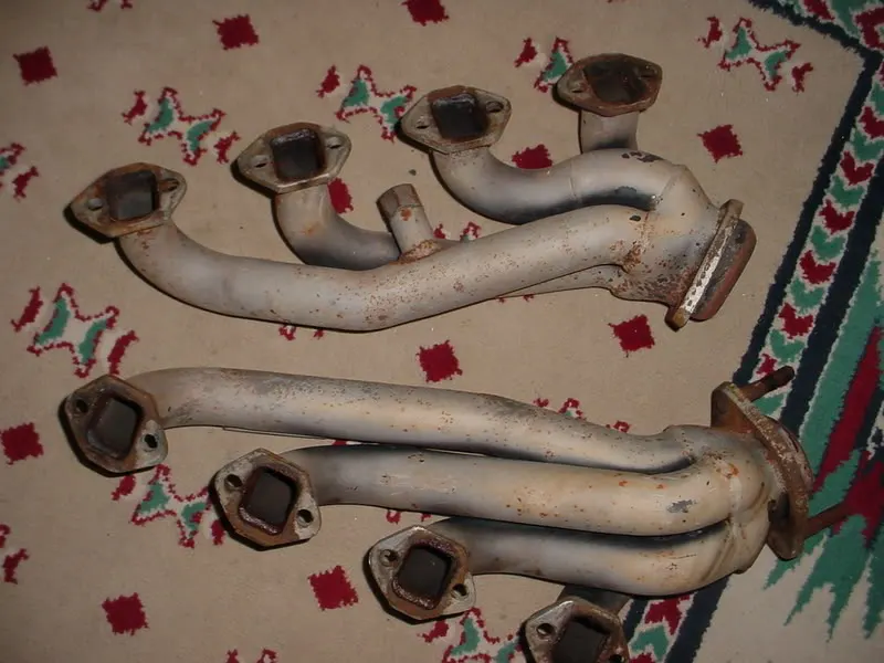

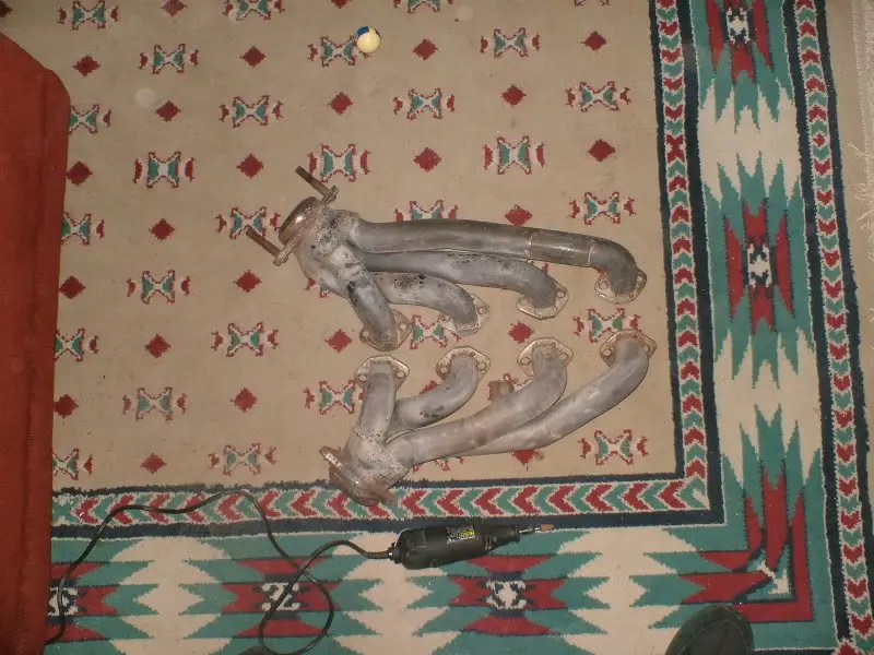

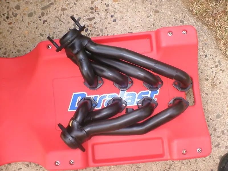

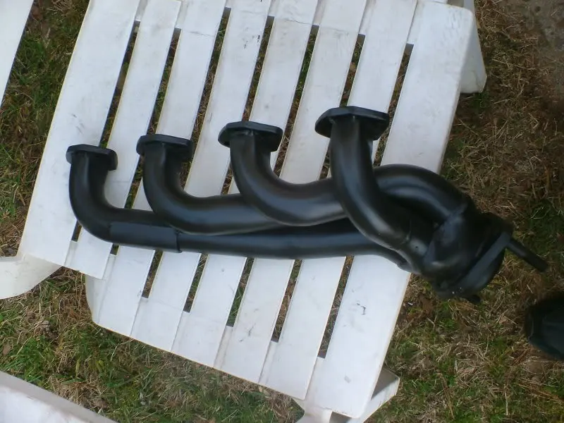

Well the instalation is almost finished plenty of problems... see tech section under HEADERS UGGGH! lol.... but here is some pics of the clean took about 3 hours to do everything... sanded hit it with a dremmel wire brush and sprayed...

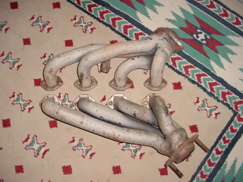

How they came....
Sanded and brushed....

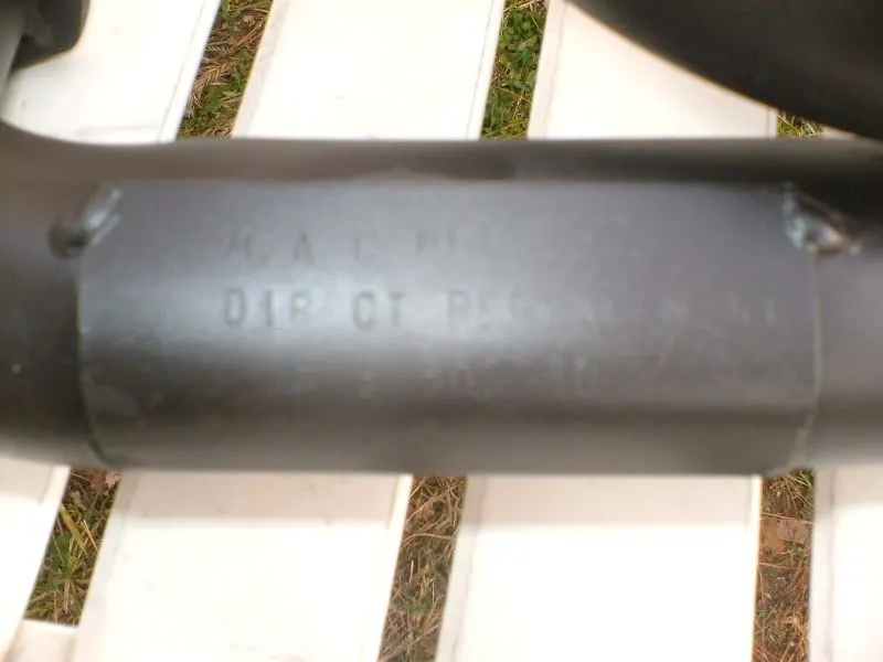

Fixxed a few bad welds...

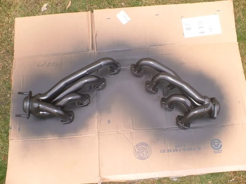

Time for paint...

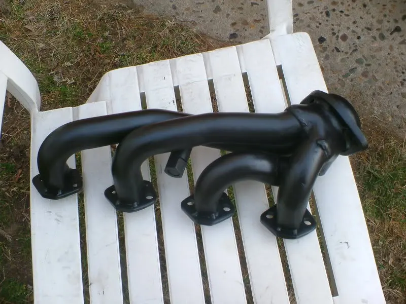

Finished product....

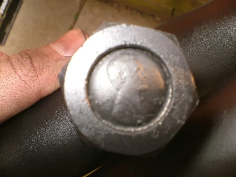

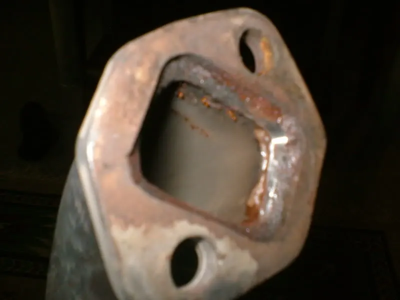

LOL what i found in the egr spot...

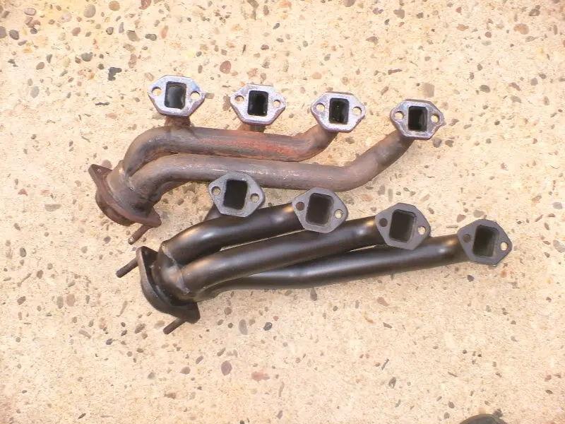

VS stock...

belive it or not the paint took a beating while i was installing them... scratched a few spots.... but didnt take it down to metal... its doing a great job so far... ive used other paints that just seemed fo flake when hit... but this paint is awesome....
The heat is the true test..I used the 1500 degree VHT stuff....so I'm curious as well. The headers in my coupe look better than before (all beat down) still a silverish color just lots of flaking.

That penny WILL blow out just so you know. Many have tried and almost everyone has had issues with it. Just be forwarned.
Why do the headers look silverish in the first pic and then black in the rest? Did it change color as it dried?
