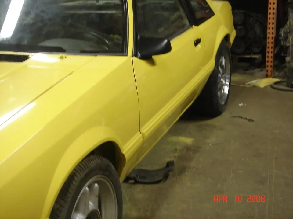

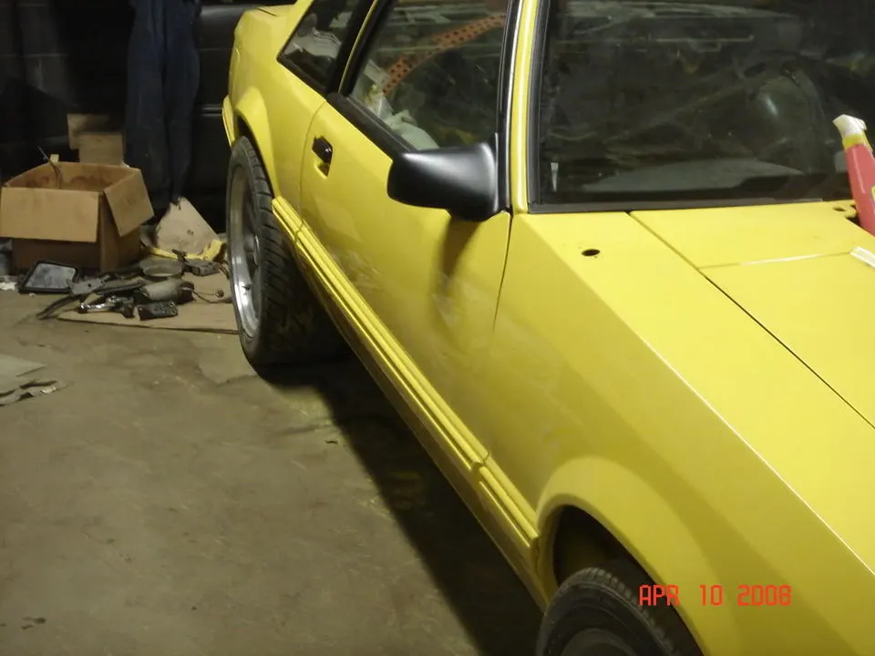

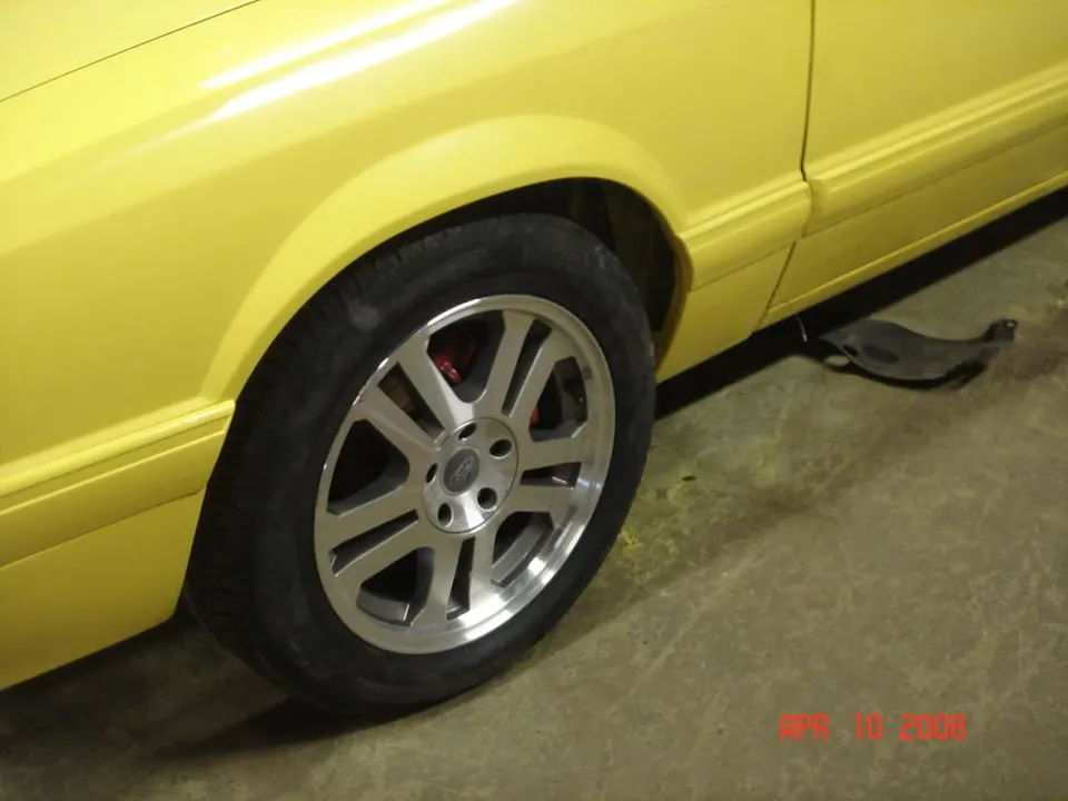

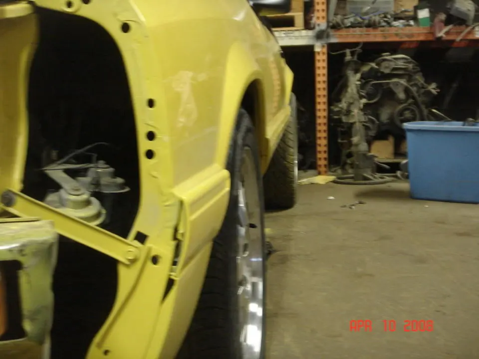

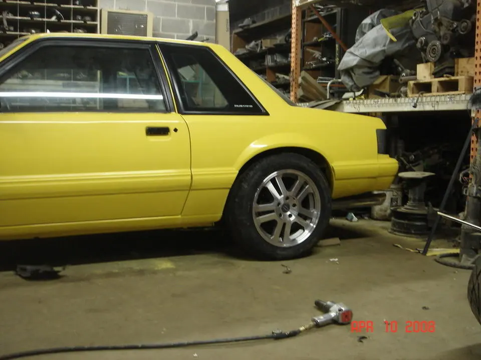

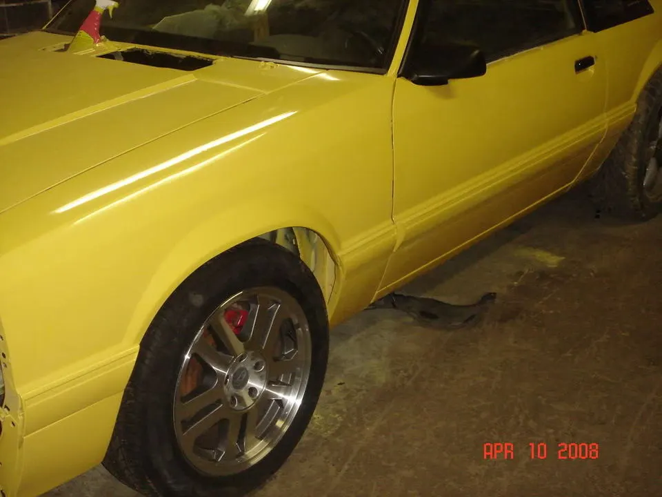

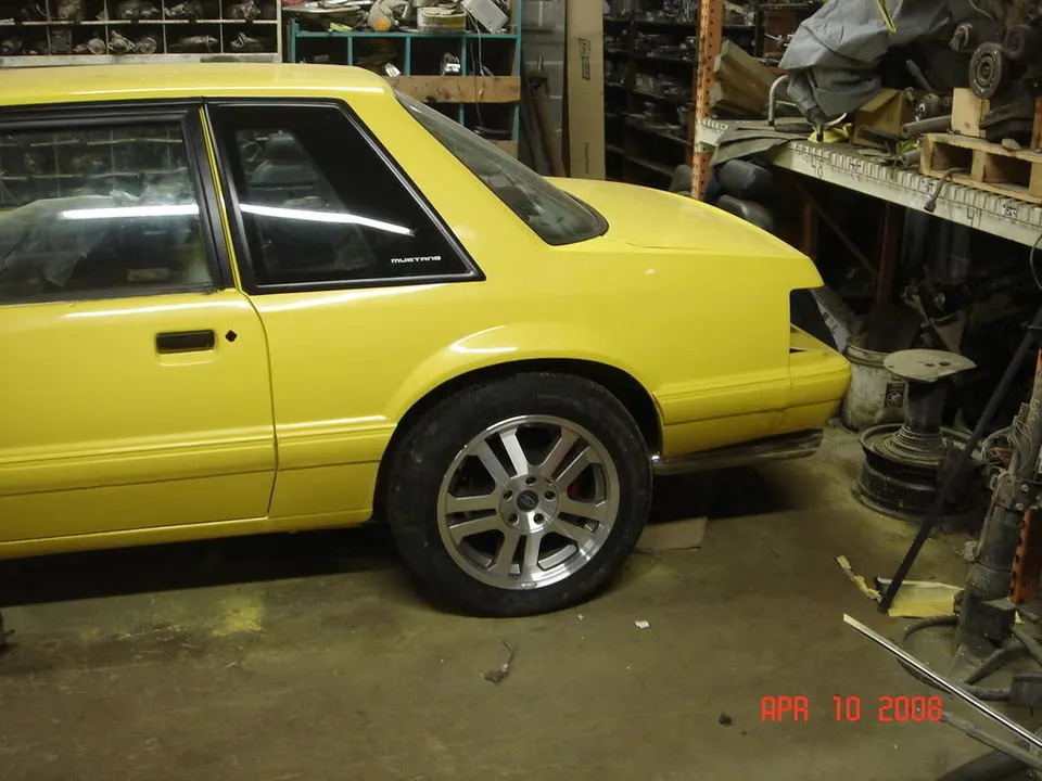

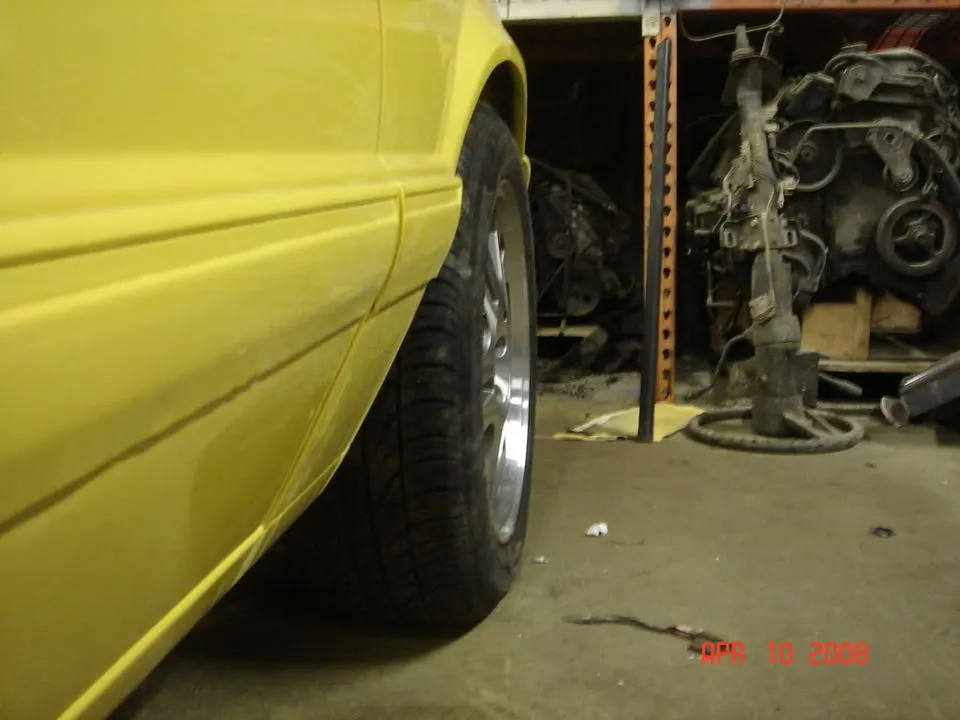

05+ wheels, 81 Hack Job...PICS...Mustang 5L5...you will like
I put some 2005 Mustang GT 17X8 wheels on my fox. These wheels have 235-55-R17 tires...ignore the tire and pay attention to the +45mm offset vs. my 17X8 Bullit wheels that have a +30mm offset.
First pic on the front. These wheels will clear the strut on a fox using 96-04 spindles. They will clear 94-95 spindles if you use a spacer. They are very close to the strut with the 96-04 spindles.
These will straighten out when the car is rolled forward...I just set it down.
The rear wheels with the +45mm offset fits perfectly with the 2001 axle which is 1-1/2" longer on each side than Fox bodies axle, and 3/4" longer on each side than SN95 axles. If you have SN95 axles picture these wheels inward 3/4". Again....pay no attention to the tire, if I use S197+ wheels, I will be using 245-45's.
Here is two last pics. This shows the 17X8 Bullit wheels +30mm offset on the passenger rear. This also shows the 17X8 S197 wheels +45mm offset on the drivers rear.
Now............what do you guys think about this exact wheel on my car? I'm not digging the look of this particular 05+ wheel. The tire doesn't help my decision either, but I am not dismounting it because they are a friend of a friend's wheels. However, I am digging this offset, so I might go 05+ Bullit wheels, or the 17X9 Pony R's 17X9 with the 45mm offset.
I might buy them anyways because he only wants 200 bucks for 4 wheels with tires. I could flip them easily.

why must you taunt us

Thats a pretty damn good fit. As for the wheels themselves, I kinda like them...but I don't know if I like them enough.
It's definitely a different look for a fox....but I'm just not sure. $200 for the whole set + tires is a great deal though.
