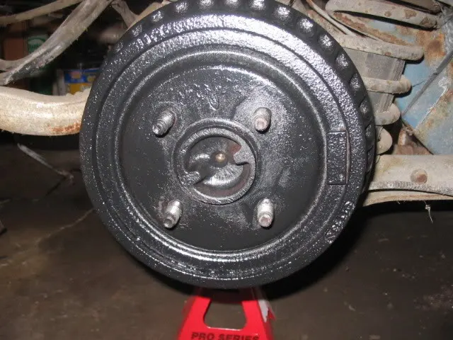

in a rust prevention primer... slowly getting there.....
MAC'n89Blckstng
Jun 11, 2003
1,012
36
NJ
Apr 30, 2007
#65
  • Apr 30, 2007
  • #65
That primer aint gonna do anything over that rust. I would have taken the rear out for that project and just POR15 it. That spray bomb stuff isnt gonna do much.
yeah it will...we used it on my dads 86....2 years ans counting....its holding up just great..yeah but this will be a DD so no need for it to be all show....just cleaning it up a little...

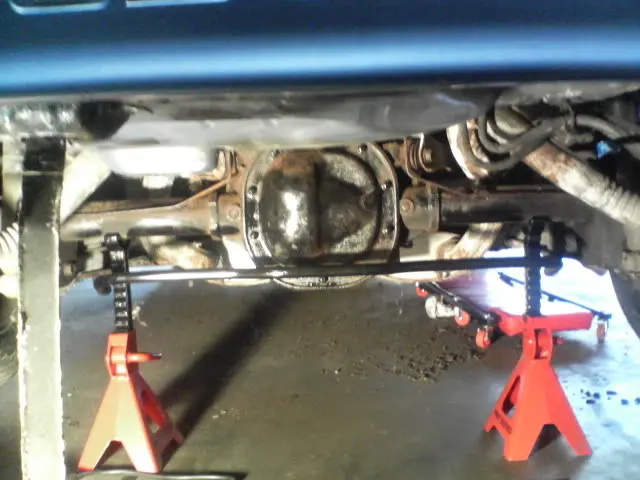

you can unhook the shocks and quads to get the diff lower and have room to paint better... better use a lot of loose-nut first though...

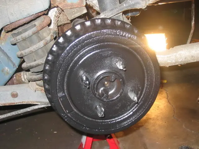

If you end up POR15'ing your rear end (which i recommend also), make sure you dont accidentally get it on your jackstands... they dont like to adjust much after the stuff has dried in there. Ask me how i know

here are some pics from today...
(1 coat)
