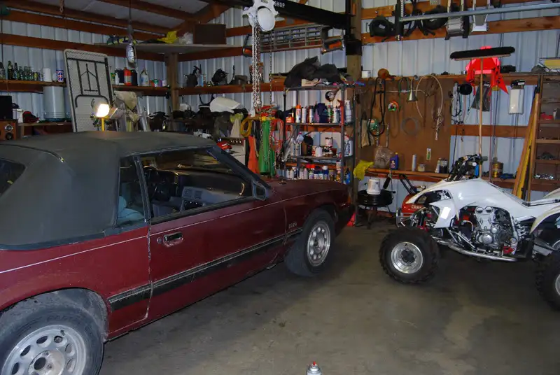

The 5.0 'vert shortly after I picked it up

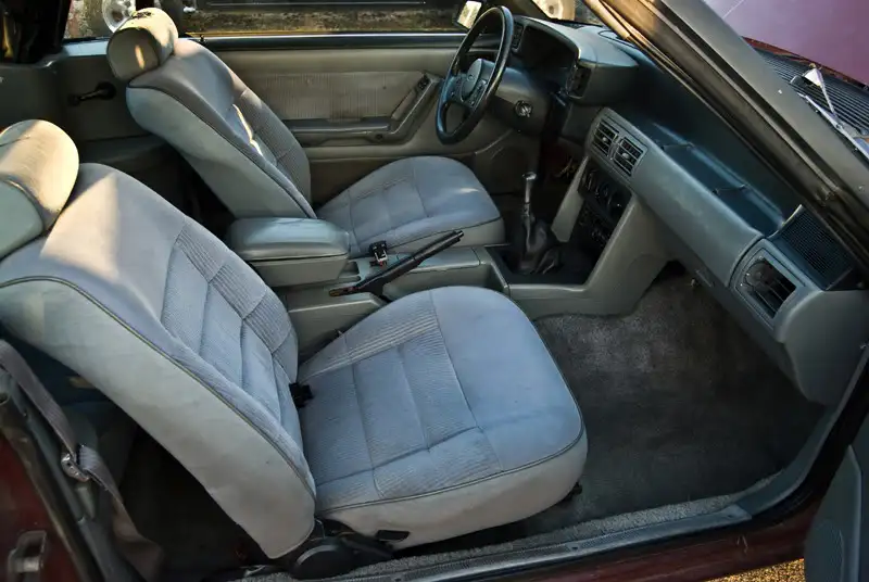

After stripping the interior and spending about 2 days cleaning I got the inside looking somewhat decent.

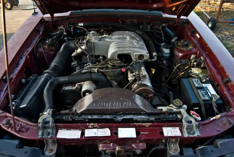

Engine shot

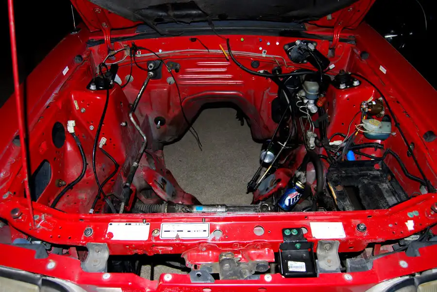

Here is the 92 coupe.

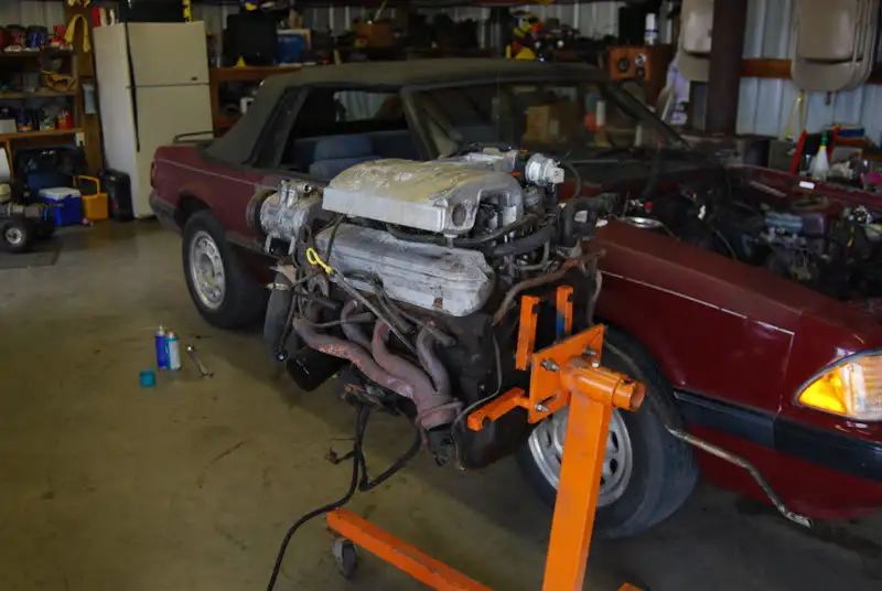

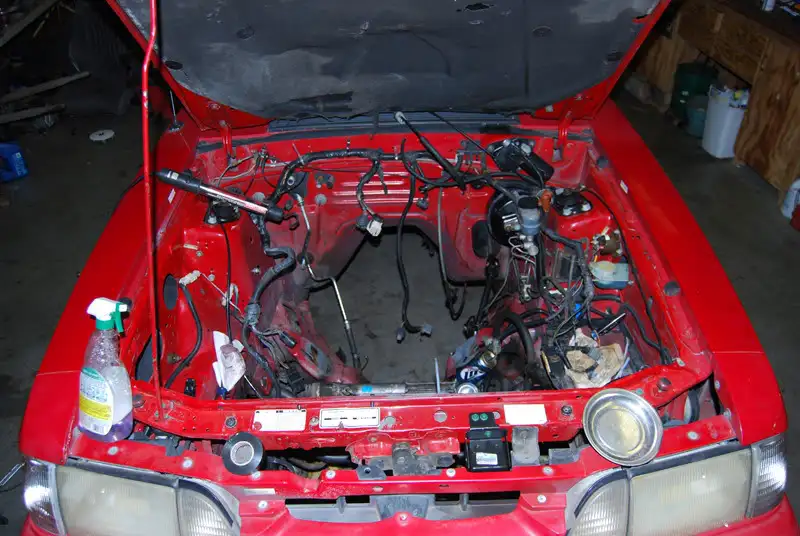

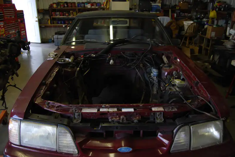

The vert in the shop, getting ready to pull the motor.

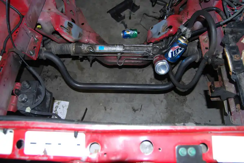

All gone. lol

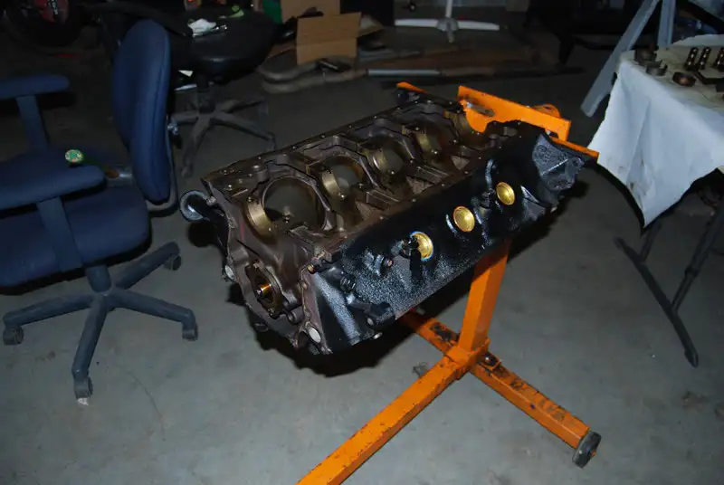

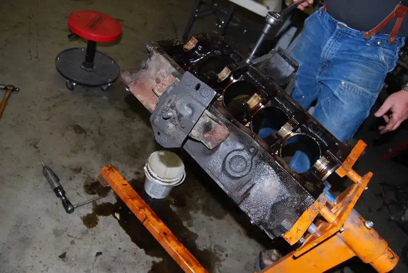

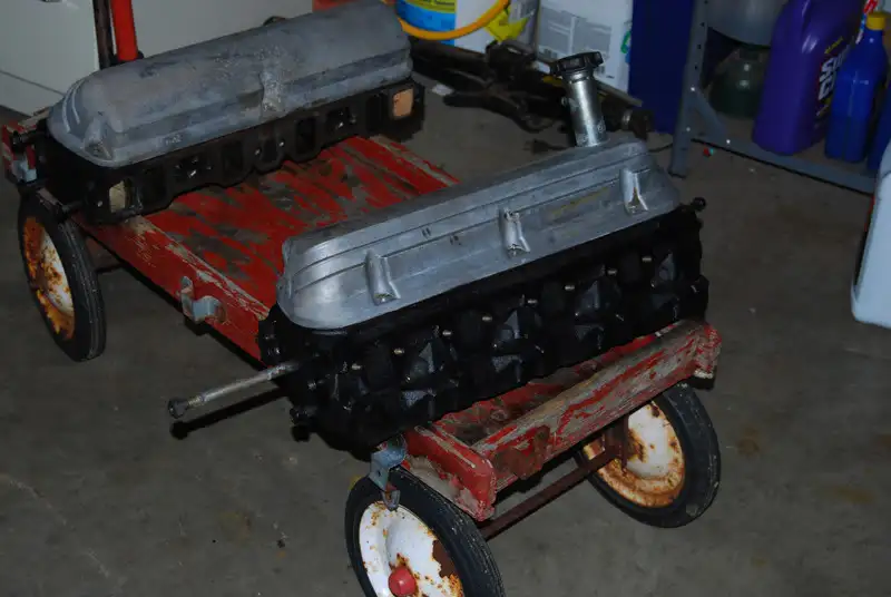

Stripping the block down. This thing was disgusting.

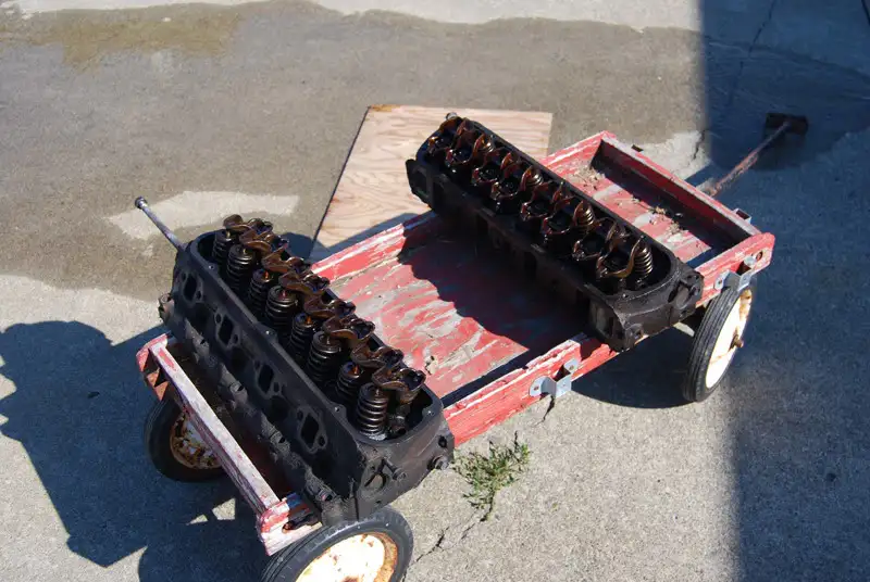

As were the heads.
Pressure washed the block, painted it, and put in a new set of freeze plugs.
Cleaned up the heads as well. Painted them too.

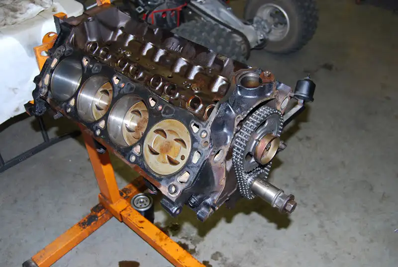

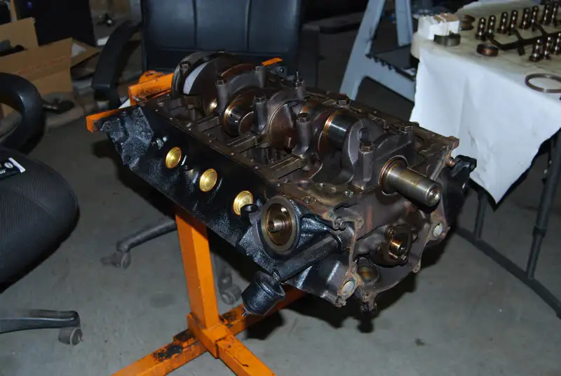

Got the crank back in the block.
Pistons and rods re-installed. As well as the comp cams timing set.

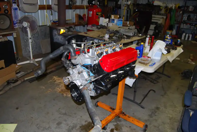

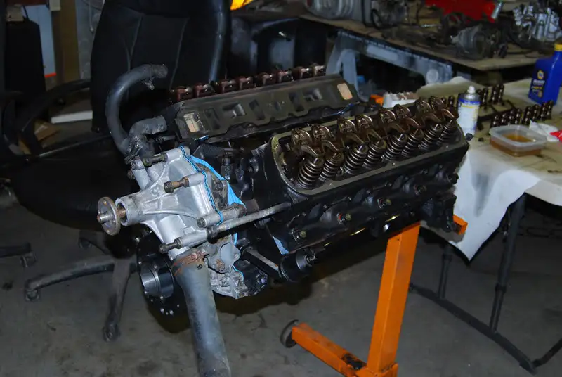

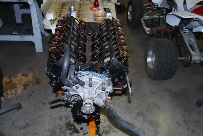

Heads and water pump back on, all stock stuff.
Pushrods and lifter back in.

that notch looks clean under the hood.
It's not as clean as the pictures give it credit. :p

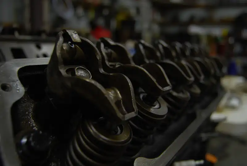

Random picture of my all-mighty stock rockers. Haha.

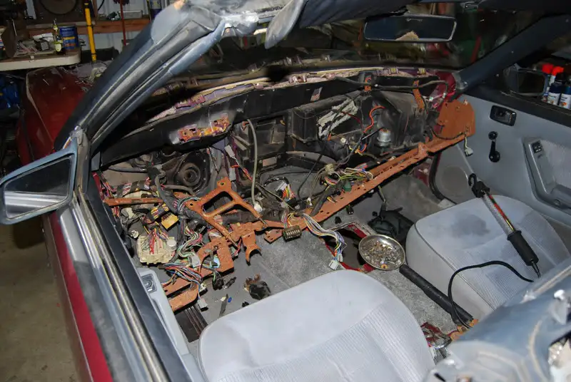

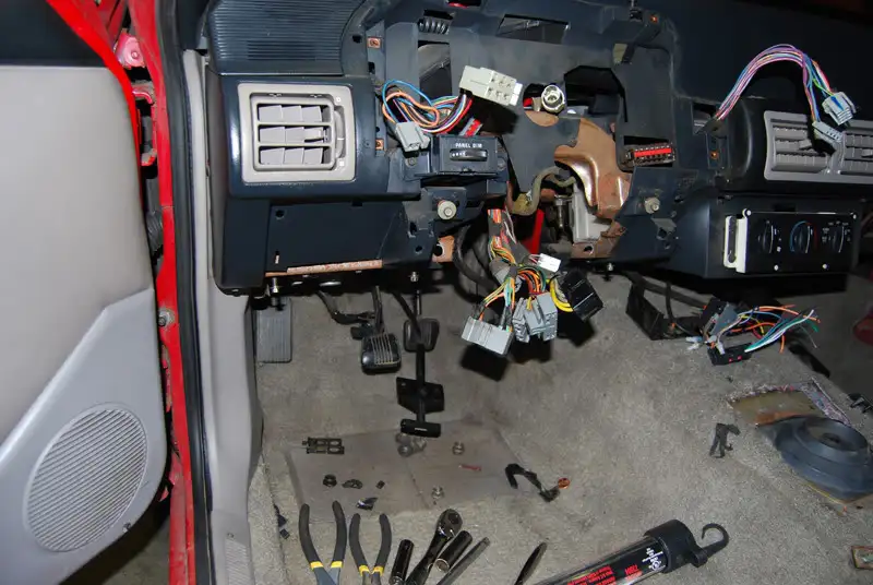

This is one way to take the 5 speed pedals out of your donor car. I wouldn't recommend it though. :rlaugh:
I put them in the coupe through the bottom. Probably took as long, but saves from ripping the whole dash out.
Either way, swapping pedal sets is a huge PITA. :mad:

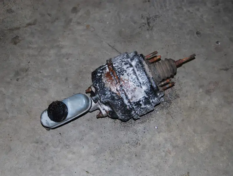

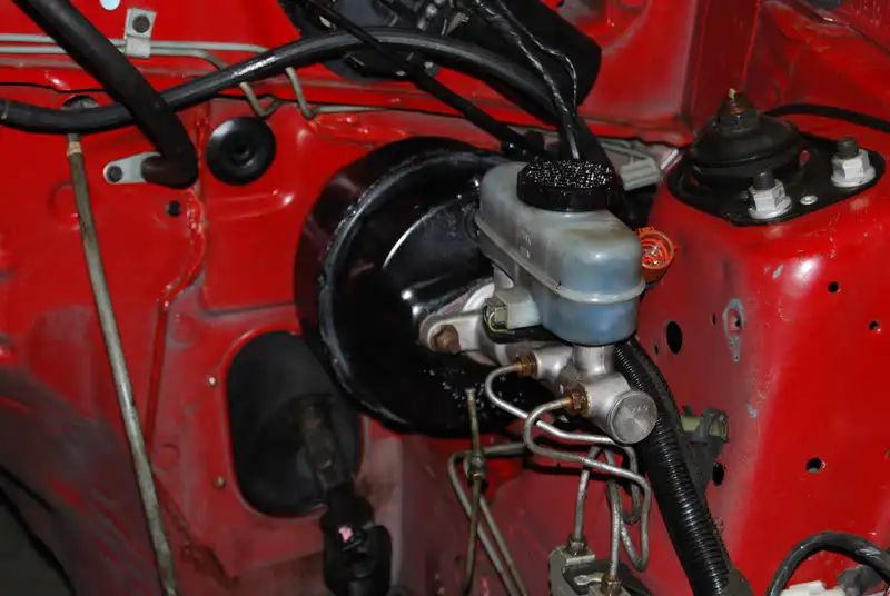

All the paint on the booster was peeling from brake fluid getting on it. So I had to hit it with paint stripper and start over with a quick rattle can job. :p
Got it mounted in the notch, the upper brake lines matched up. I think I can get away with just changing the drivers side front line.... I hope anyway. :shrug:

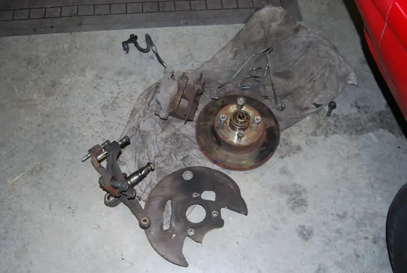

All my 5.0 brake parts for the front ready to go on.

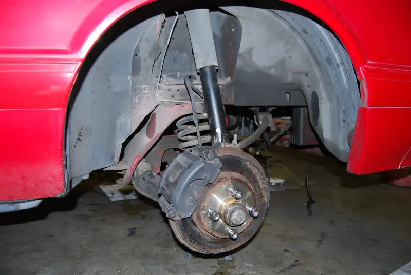

Got both sides swapped this afternoon/evening.

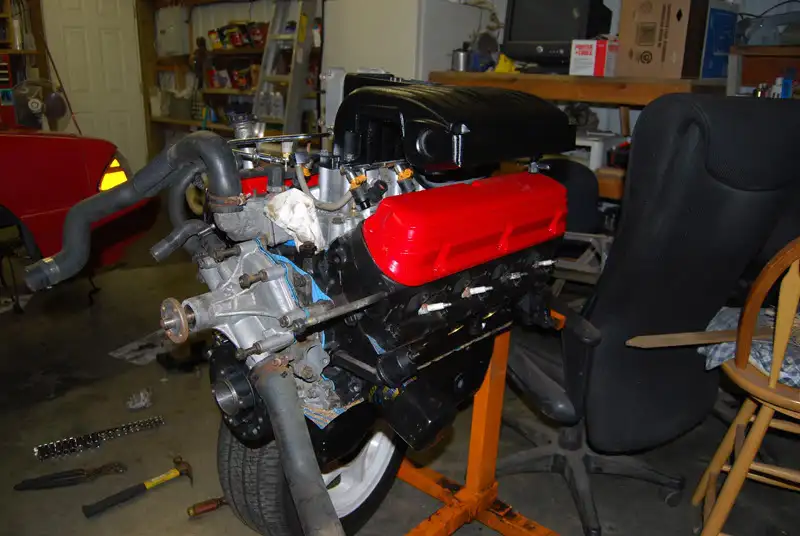

Oh, and I finally got the upper intake on the engine.

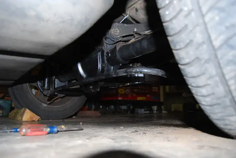

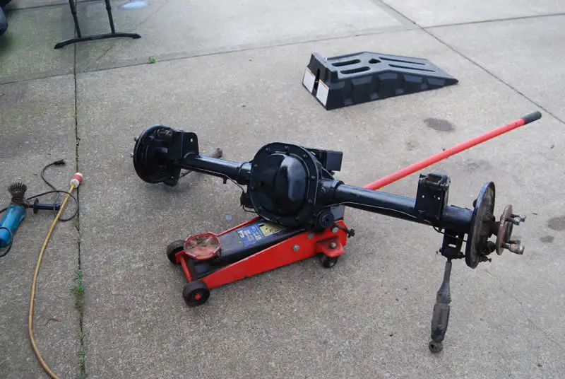

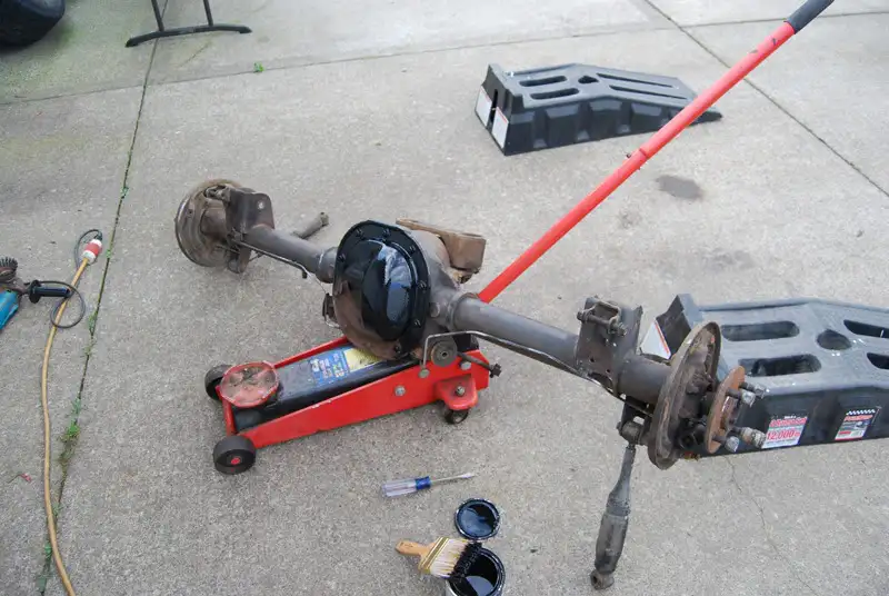

The 8.8 rear end right when I started painting it.
Paint finished.
And it finally in the coupe. After I got all the control arms, shocks, and quad shocks hooked up. I noticed the rear springs were still setting on the floor next to the car. Haha, that really kept the enthusiasm up at 1AM....not.
