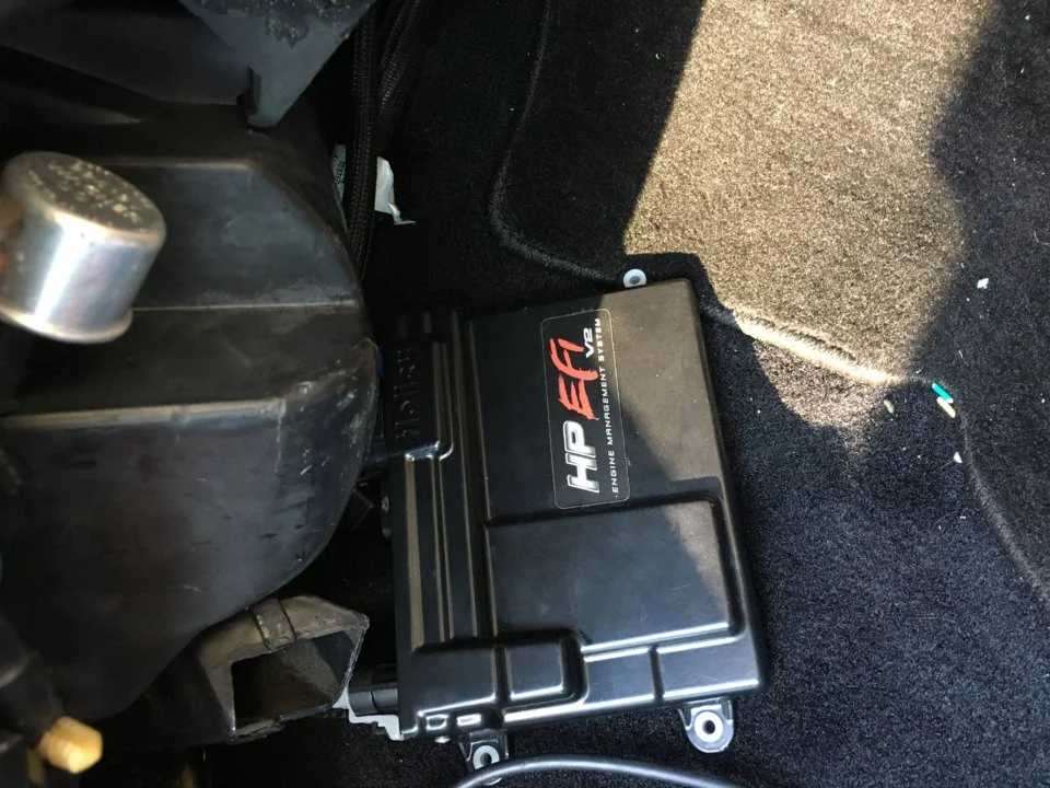

So I'm back at it again fellas, ripping out the cars stock style rjm harness and putting in a Holley hp ecu I got off of a guy in Pasadena. Has provision for boost control solenoids and wideband. Safe to say I'm pretty excited. Waiting on pony down performance to get done with my headers and down pipe. Another week and a half and I'll be getting with the turbo crowd. @srtthis @84Ttop and someone tag Jeff because God dammit if I can't remember his name on this forum anymore hahahahaha sorry buddy

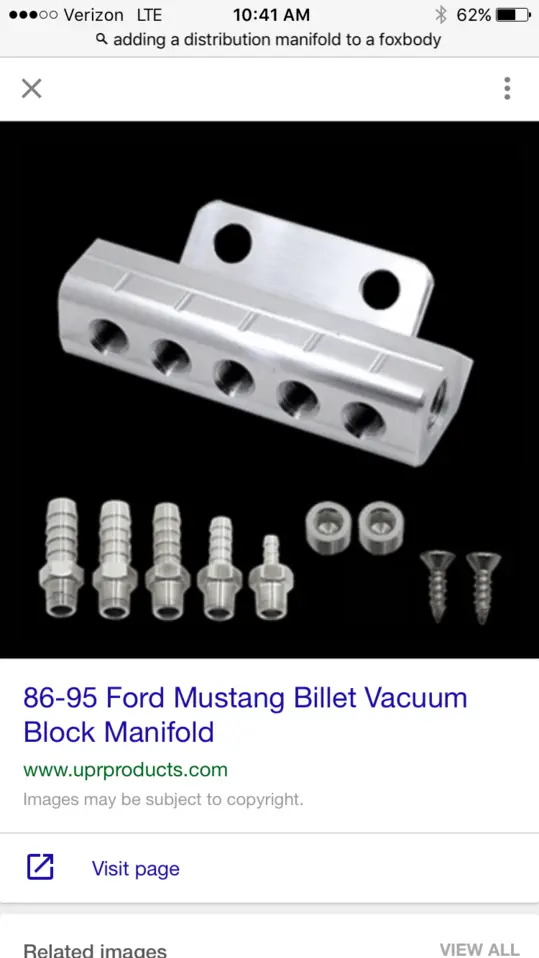

So I've gotten a bit of a dilemma now with the way I routed this harness I need to extend the wires for the oil pressure sensor. I could do this or put a oil manifold onto the passenger side since I will also need it to feed my turbo my question is will this vacuum manifold work?
I won't be using the barb fitting the supply to the manifold will come from the gauge sender location and be supplied with a -4 AN hose. Just curious what everyone thinks because I don't want a whole bunch of tee's coming off the gauge sender location.

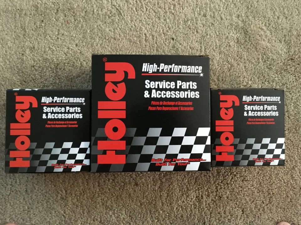

Another update on some parts that came in fellas. Ain't they beautiful!
