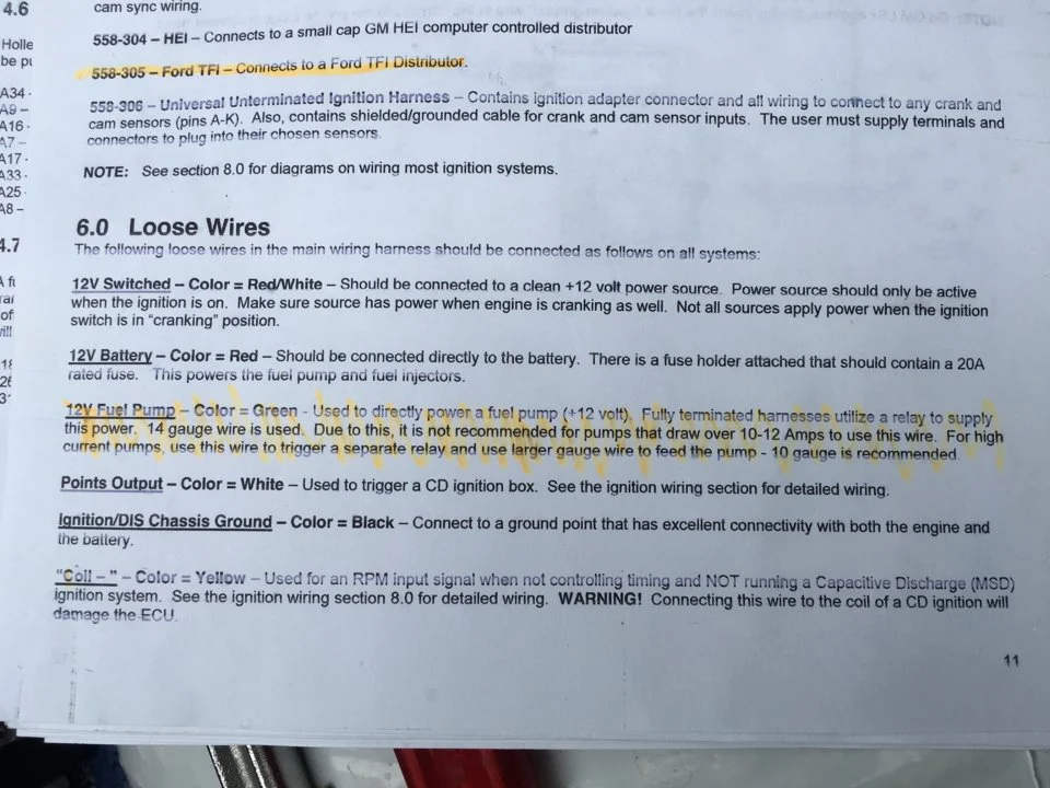

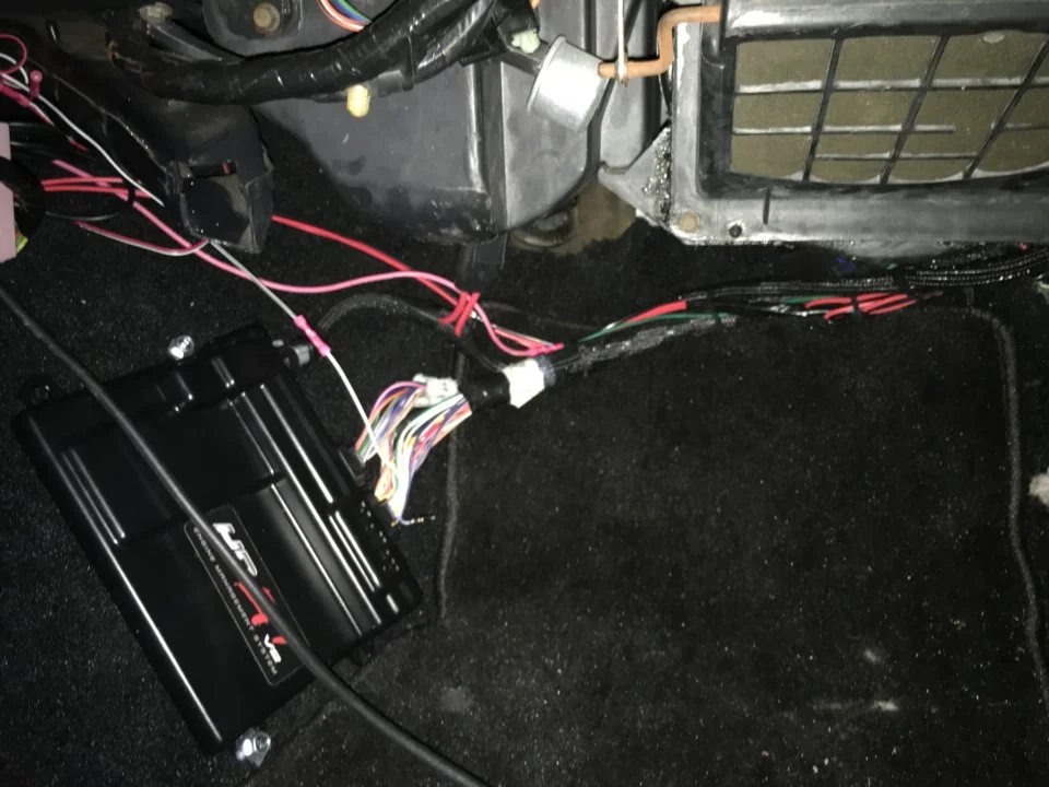

You'll want to see what firmware the ECU came with. Use the matching computer software. I say that just in case something happens if you try to upgrade the ecu firmware before starting the car. You may think there is a problem with your car, but it could be an upgrade issue. Mine is V2 and has a V2 sticker on the ECU. I haven't changed to V4 yet. If it ain't broke...@RacEoHolic330 ok I'm getting really close to trying to start the car for the first time ... Electrically I still have to wire the ford iac and hook up some loose wires in the harness. I did not receive the disc for the software to download onto the computer and I've called Holley with no call backs. Which version do I need? I see v2,3,and 4.
