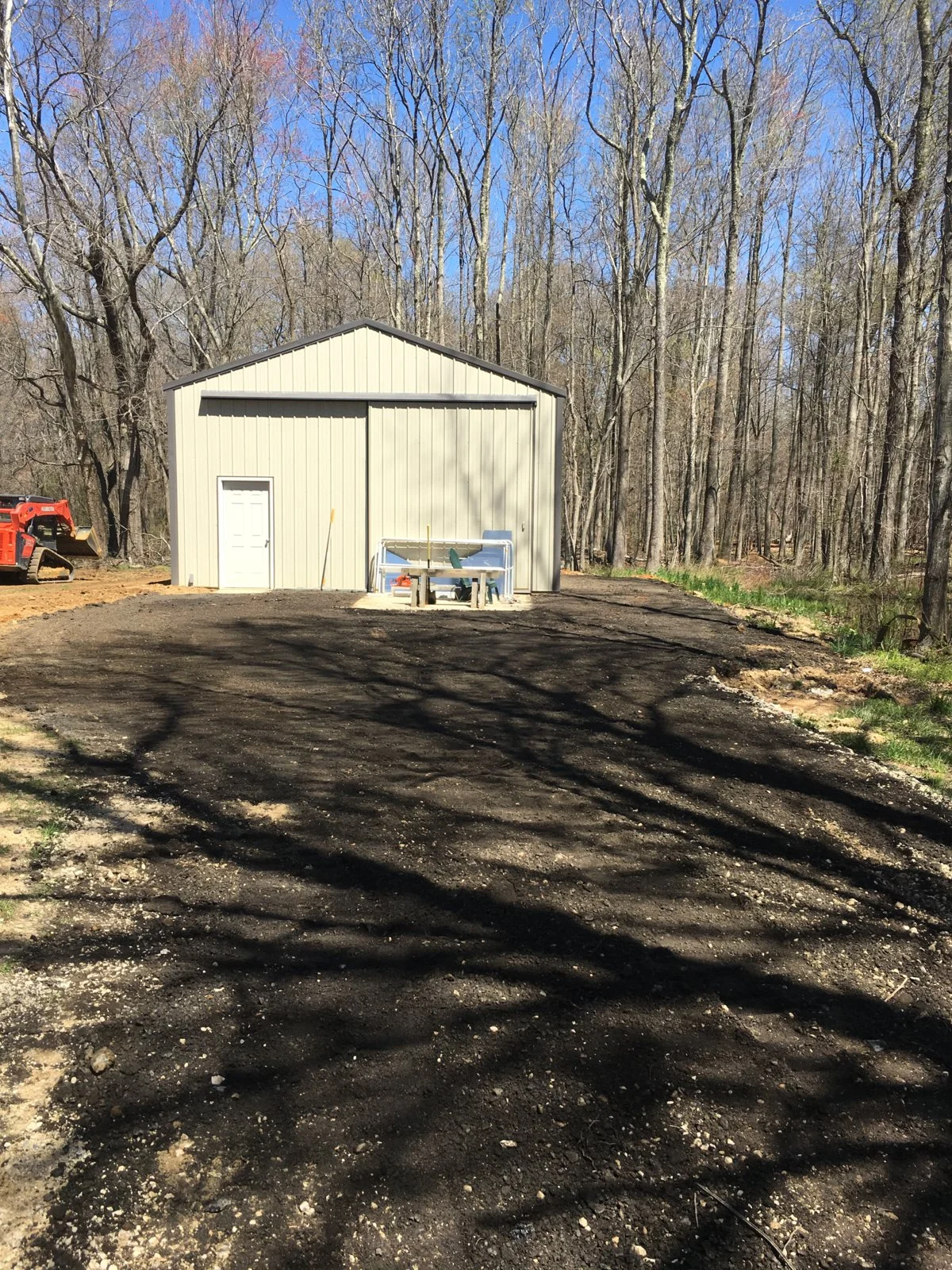

Oh yeah it’s pretty much finished everything’s in there now I’m gonna pull everything out soon to put studs up and insulate it all so I can put my mini split in I got from work.

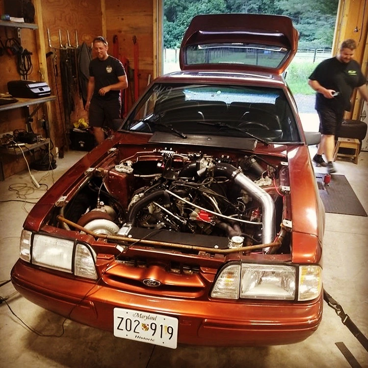

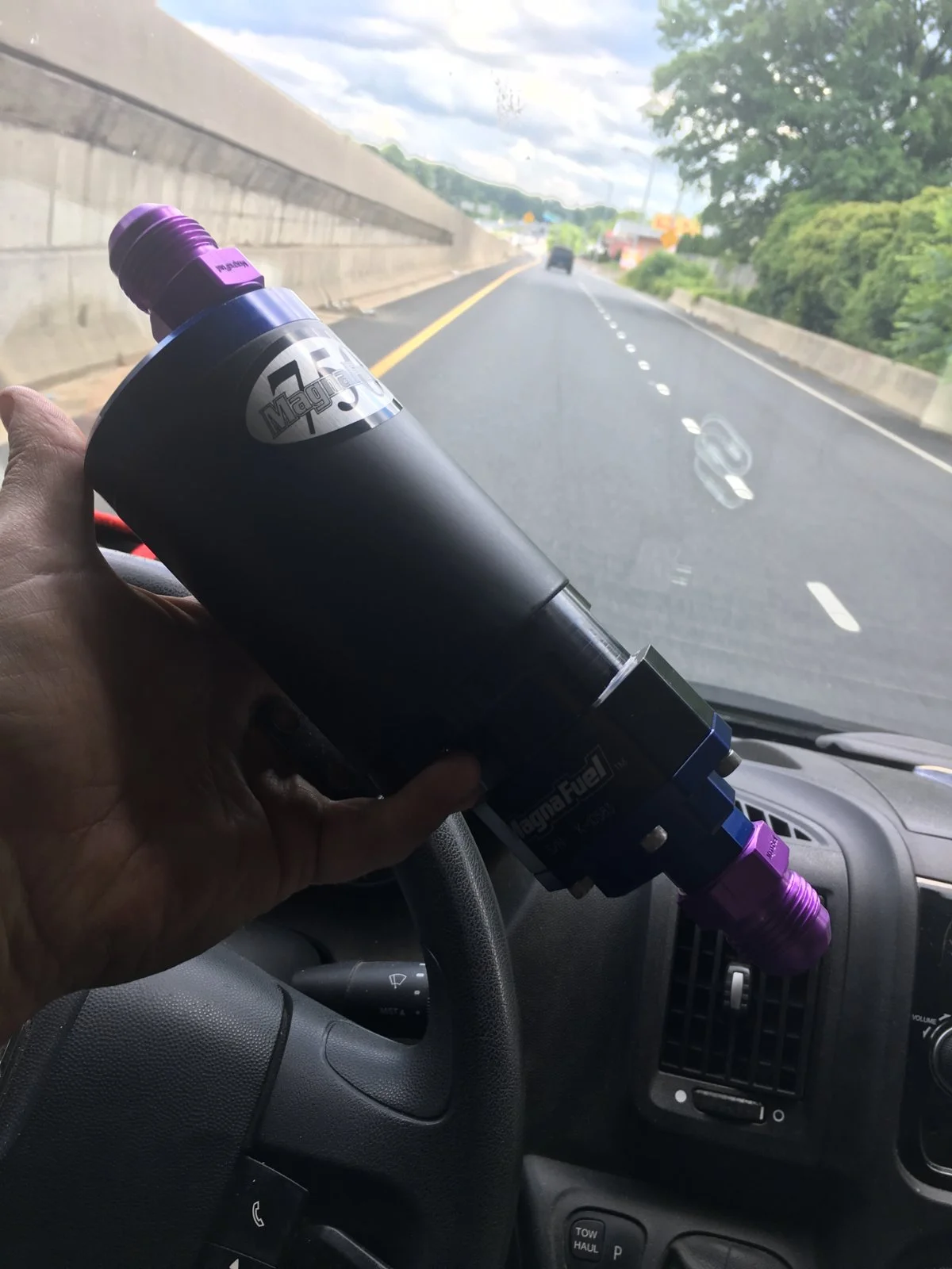

Took the car to jersey Tuesday to have some tuning done so I can really start throwing the boost at it. Made a few pulls and started dropping fuel pressure badly. Thought it was a clogged fuel filter, removed and cleaned and tried again. Same results with the fuel pressure dropping. Turns out my holley 1200-2 pumps just can’t keep up anymore. Car made decent power at 5500rpm which is where we stopped it at. Went to local speed shop yesterday and bought a new magnafuel 4303 fuel pump. Gonna head back to jersey next Tuesday to try it again.

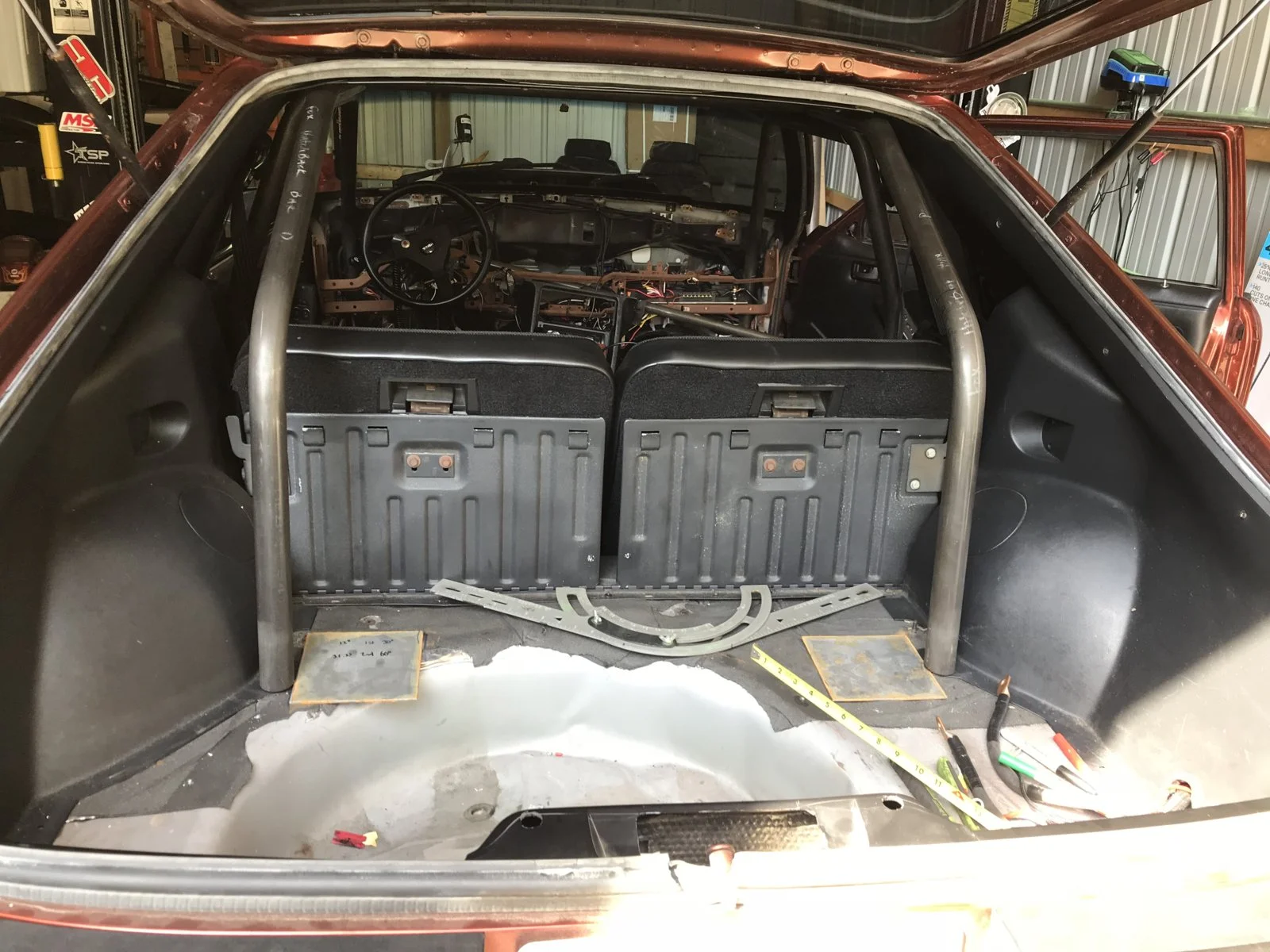

Haven’t really done much with the car other then drive and race with it but, the class I’m in now requires me to run a cage. Contacted team z to get a pre notched and bent 8 pt cage. The cage came out great but I need to make some minor modifications. One being the bars going to the trunk area we’re just straight bars and they touched the rear seats as they went down. So I decided to re bend them with the bars they supplied. I think it turnsd out pretty good actually. Nothing in the pictures is welded in yet just sitting there but gives an idea of what it’ll look like.
