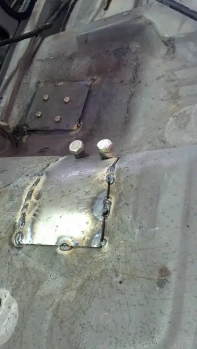

Got my torque boxes welded i dont have more pics for i sound deadened everything right afterwards

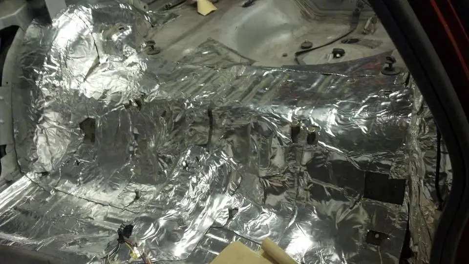

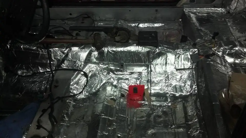

Got my sound deadener in this is just the first layer another layer of foam based insulation goes down but i forgot to take a pic before i put the carpet back in.This stuff is up there woth dynamat but half the cost, www.raamaudio.com
Another view of the raam mat but dont tell me i missed a spot i just havent gotten to it yet i was getting to the point where i could carpet back in and get it to start forming to the car again.

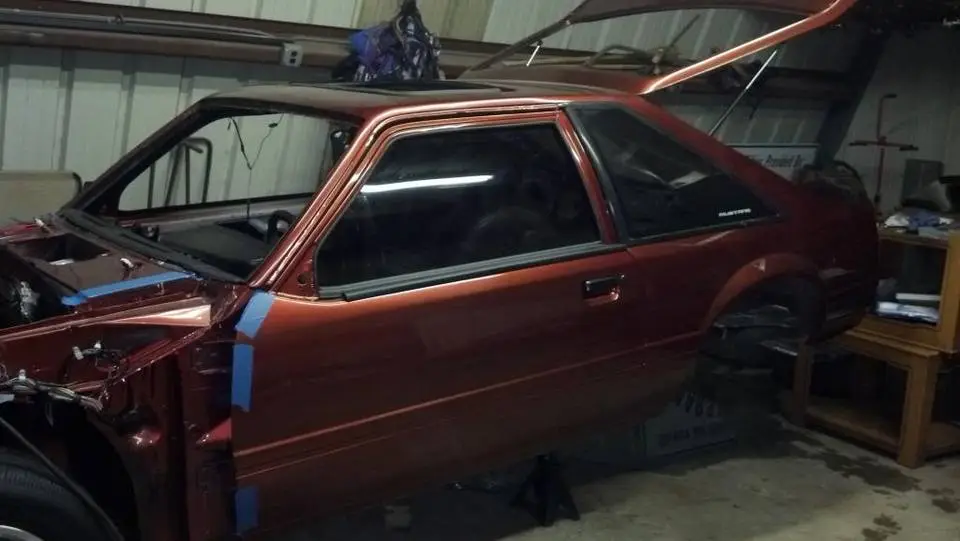

I also was ble to get both door windows and 1/4 windows installed as well has anyone had a hard time with the windows fully seating in their new window run channel weather stripping?

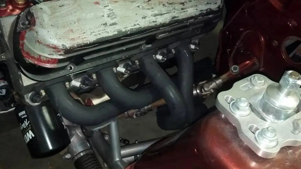

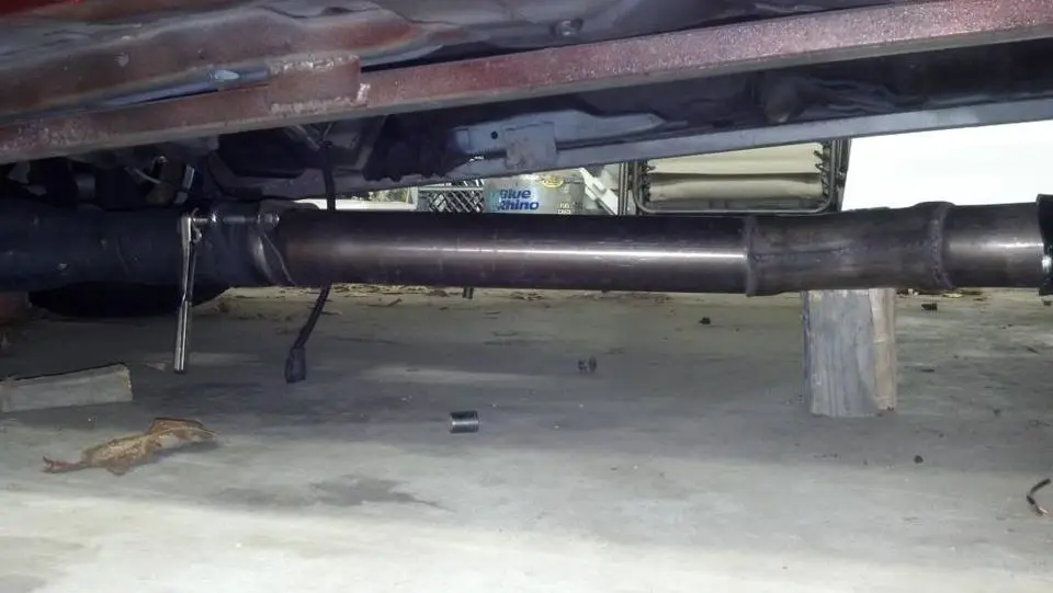

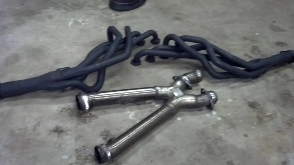

So I purchased some exhaust pieces from a fellow member here on stangnet and just wanted to show him i got them put on the car. I got a set of stepped headers and x pipe from 90lxcoupe.
they were definitely tight to put the collector on like you said but a little never seez and they fit right on in there.

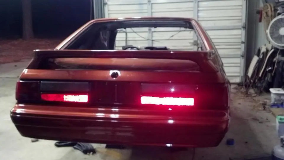

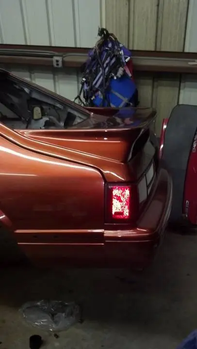

I also put the rear spoiler bumper and tailights back on the car i was going to wait to put that stuff on so i dont mess it up but i couldnt wait much longer.
as soon as my seat belts come in i can finish most of the interior minus the headliner.

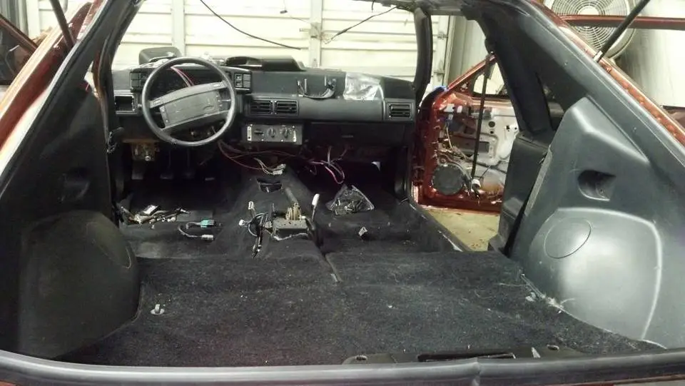

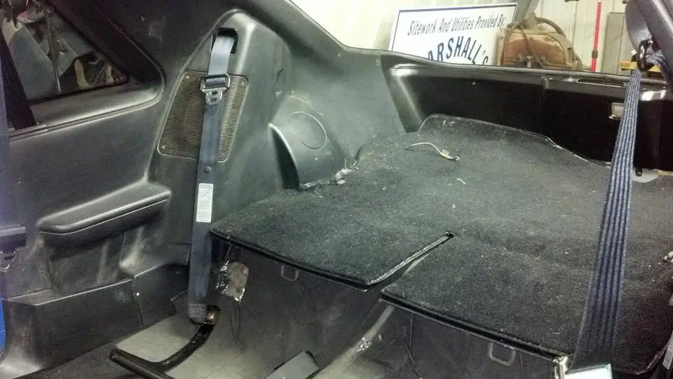

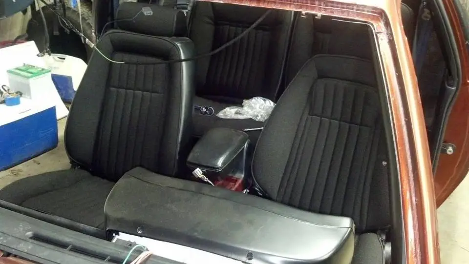

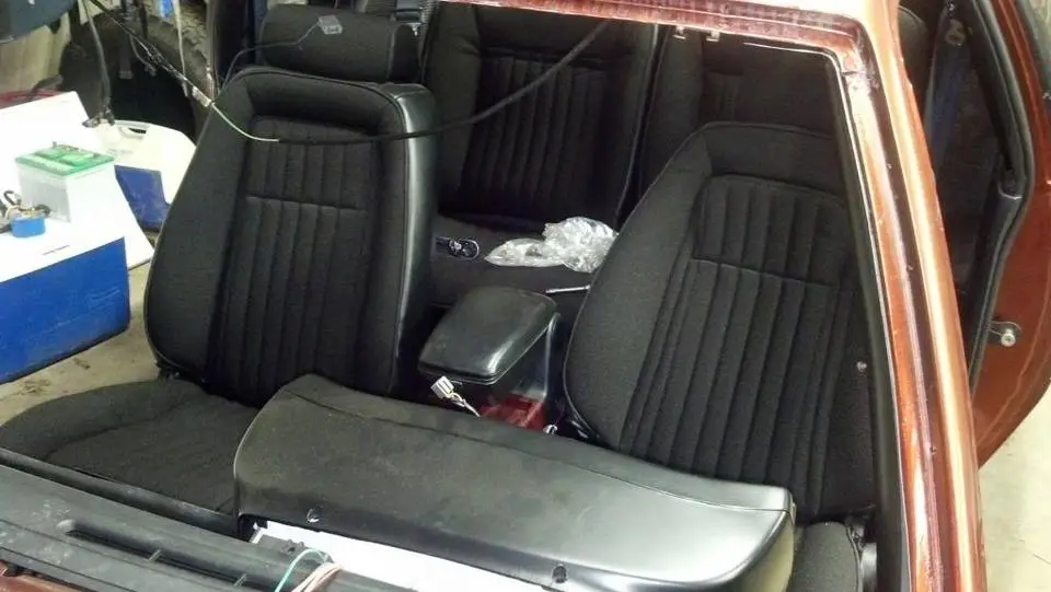

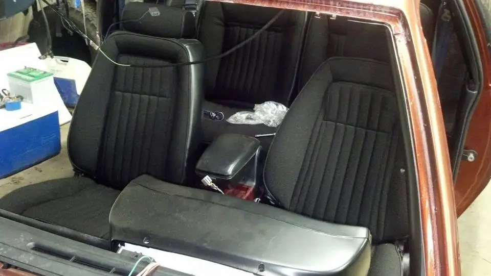

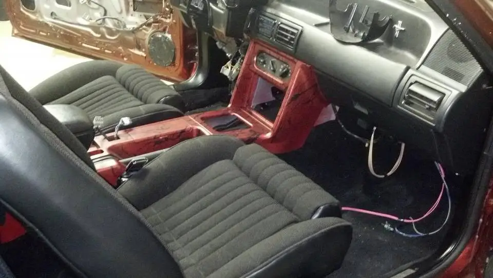

Got my interior back in in the rear, I know I am getting close to the end because im starting to run out of parts in my basement haha, only pic i didnt take was with the rear seats in.
It needs some clean up but i will do that before i go any further i think

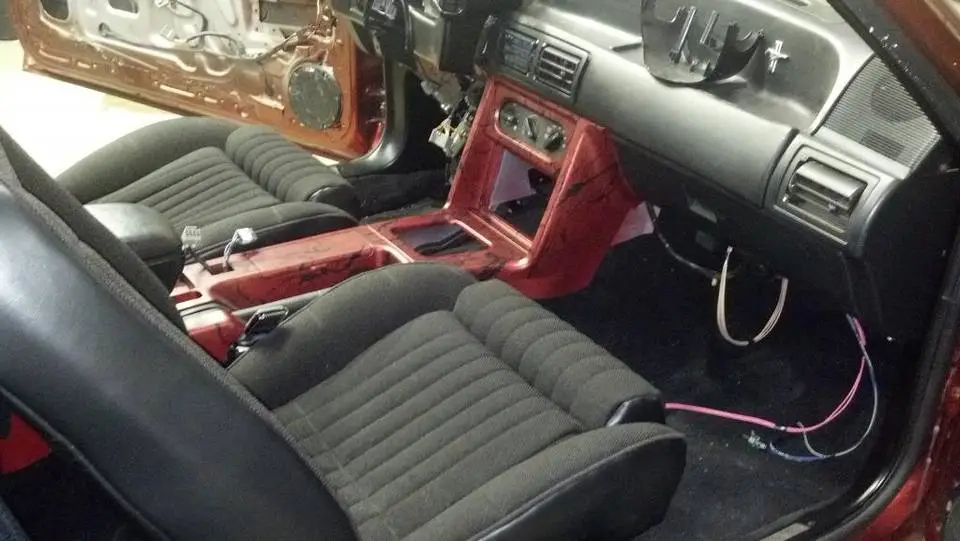

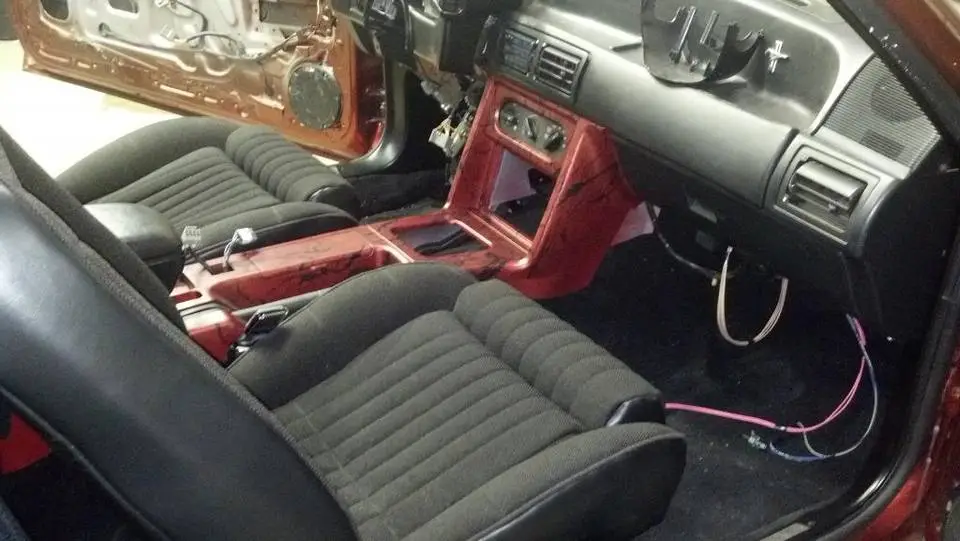

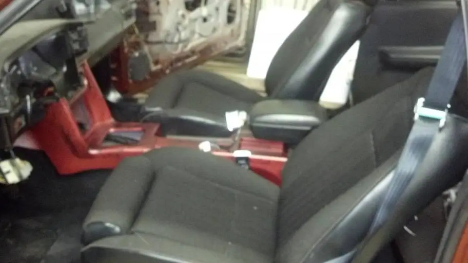

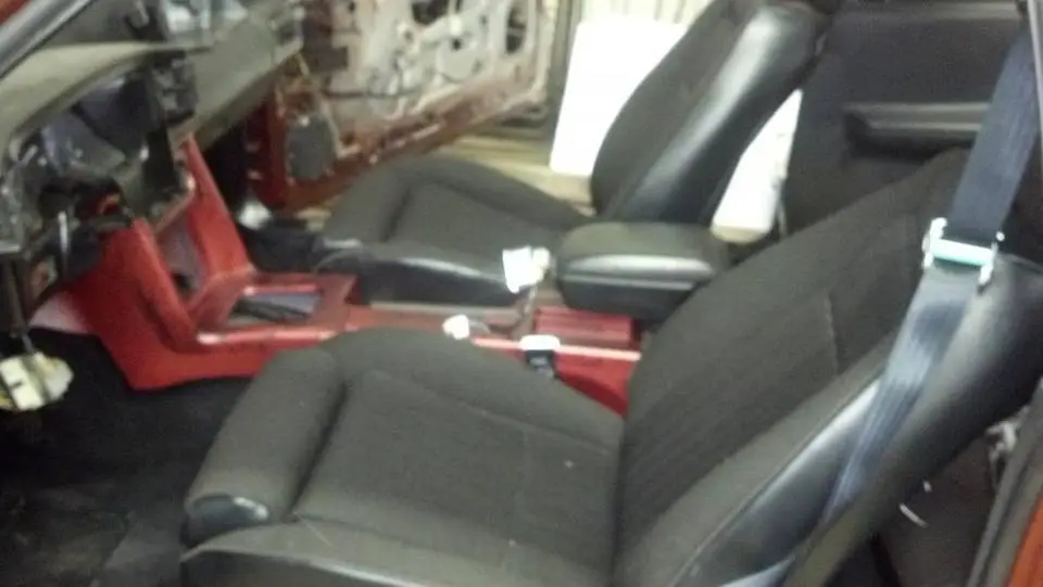

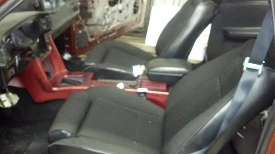

Alfight so i went into overdrive on this project the interior is now 85% done just need the door panels in and headliner and i can cross that off the list. Now onto pics
