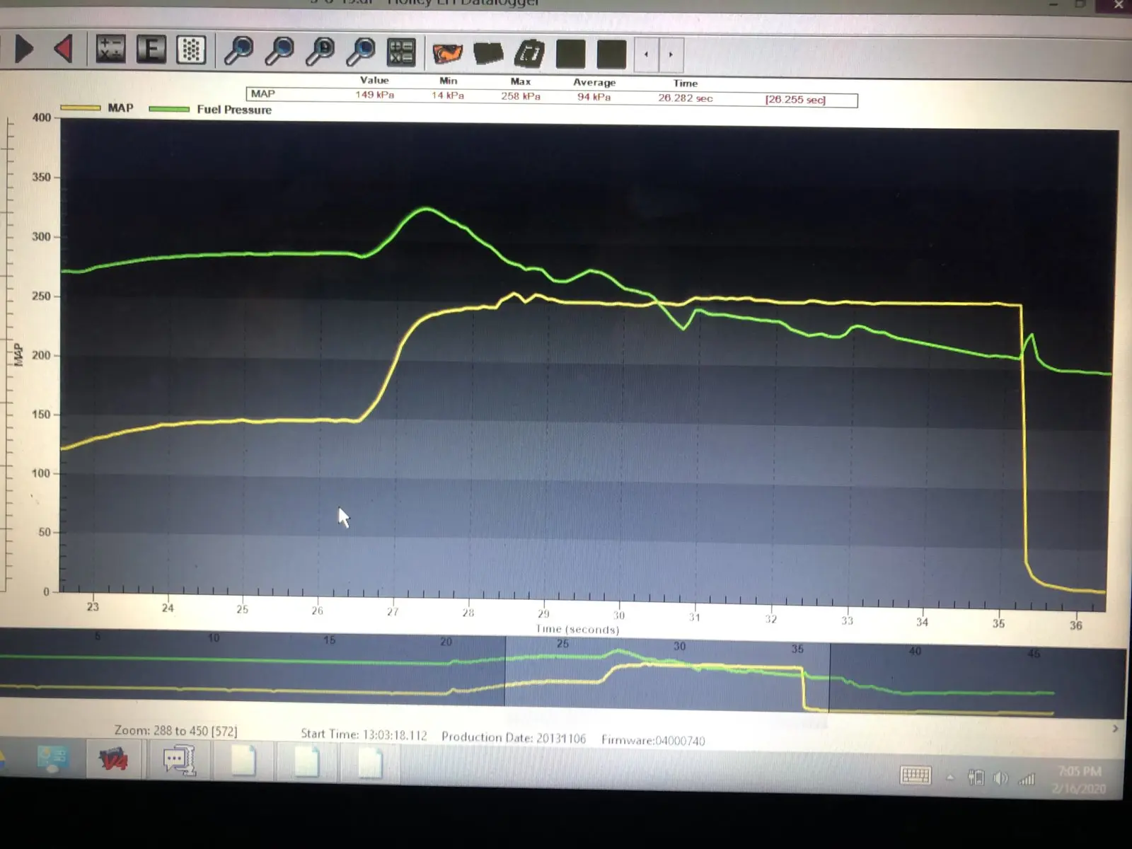

lol, well your doing pretty good then. do you log backpressure? if you do you can do MAP/EMAP for the Y axis on the fuel table for a much better model of the engine VE. they are expensive to buy but you can get away with using a long piece of tubing and attach the sensor at the end of it. This will give you a solid value to use for turbo sizing and you will then be able to tell when adding boost is no longer effective.
Nice to have even if you dont use it in the fuel equation..
another great one is monitoring the CLT pressure, you can use any passage in the block that will accept a pressure sensor. Just log the pressure and view after the run or setup a diagnostic light to come on when the pressure rise or delta value is high, this will let you know that a gasket is failing or a head is lifting BEFORE you lose the engine.
@a91what if I had the ability too you bet your butt I would. That’s the only downfall to the holley HP is limited inputs and outputs. If the funds are there this year I might switch to the dominator. Sensors I wanna add are
back pressure
Pre cooler boost pressure
Coolant pressure
Trans temp
Driveshaft speed

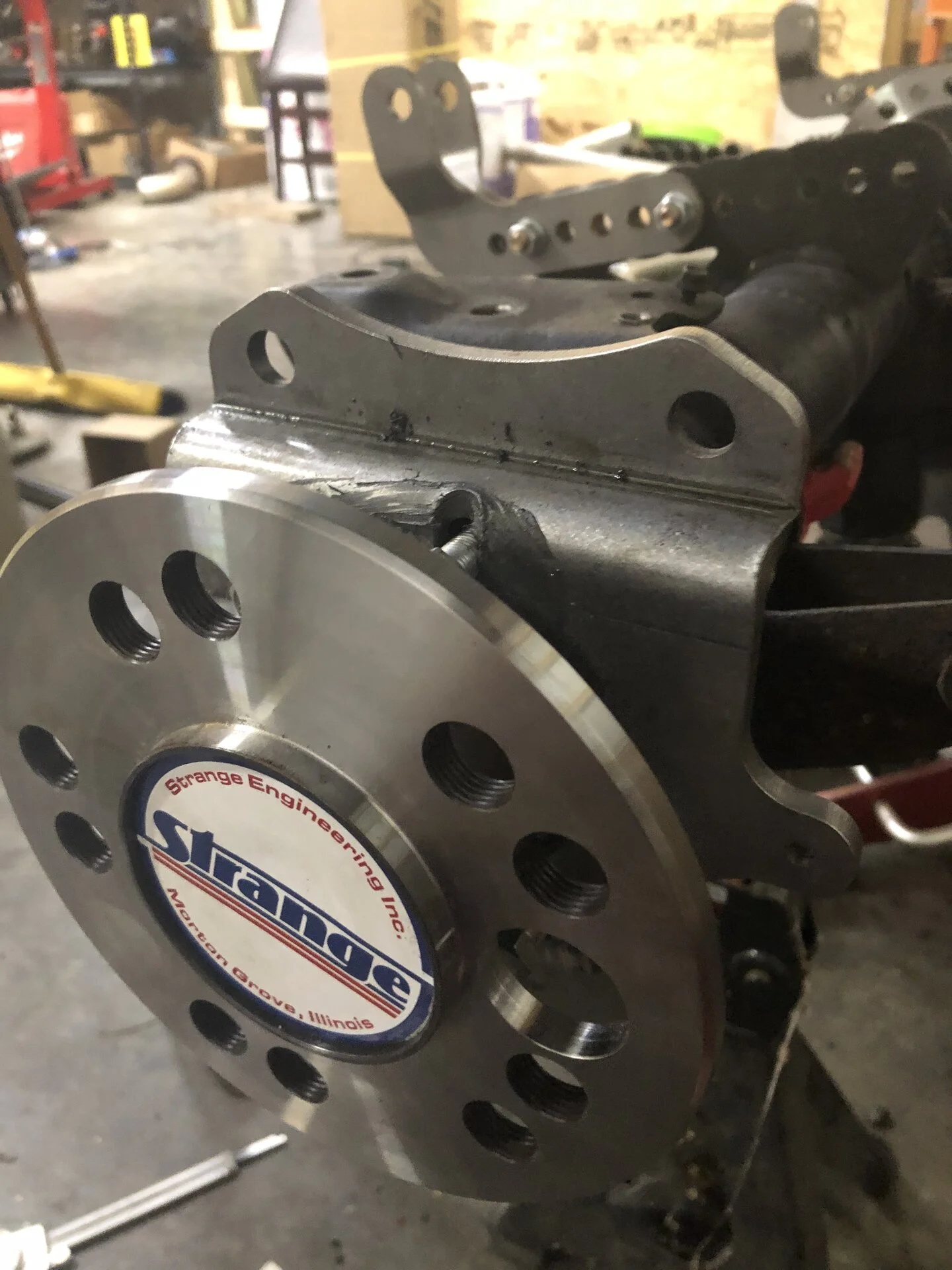

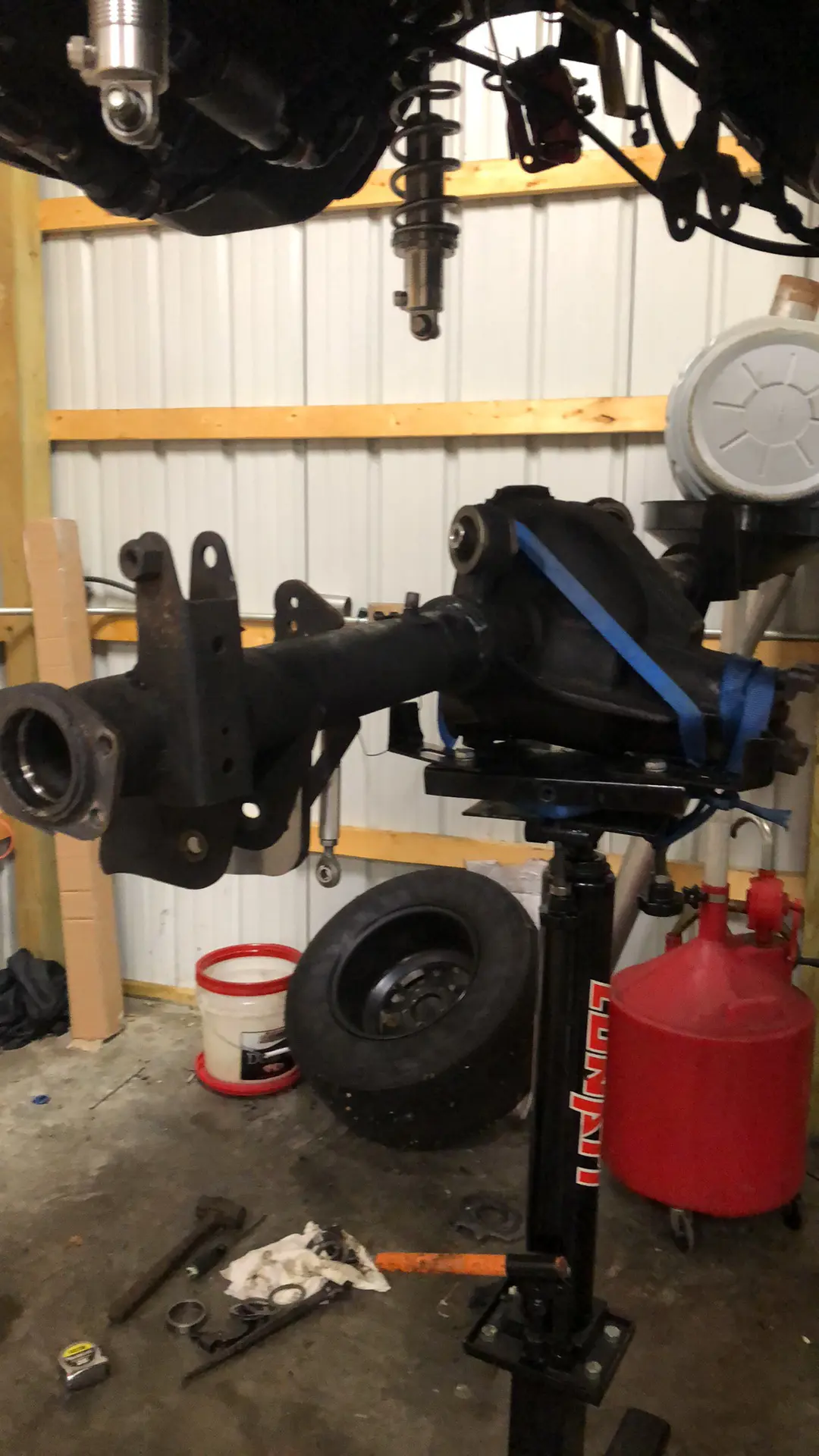

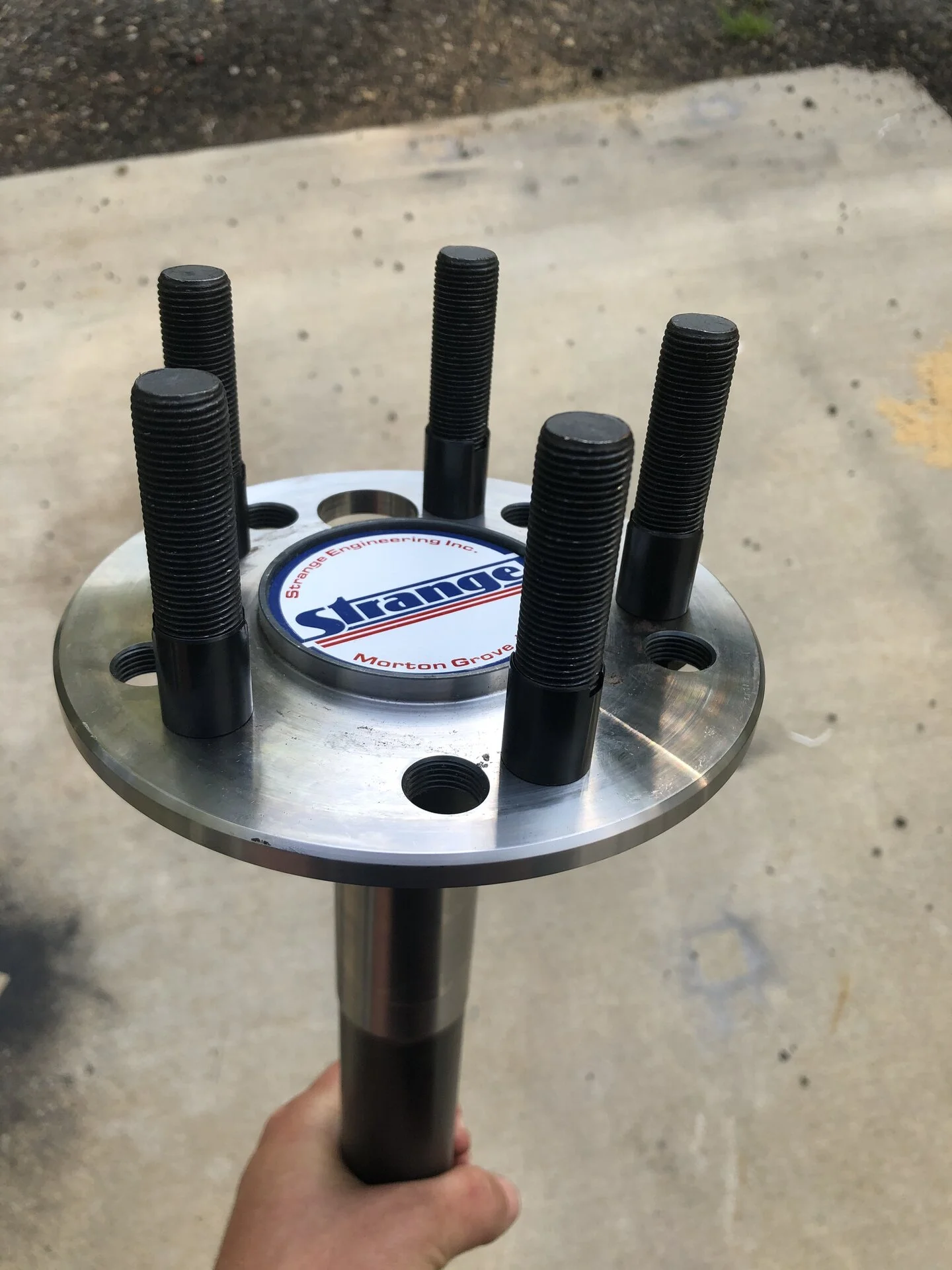

So had a bad day at the track a few months back. Launched the car and the 31 splines and spool said see you later.

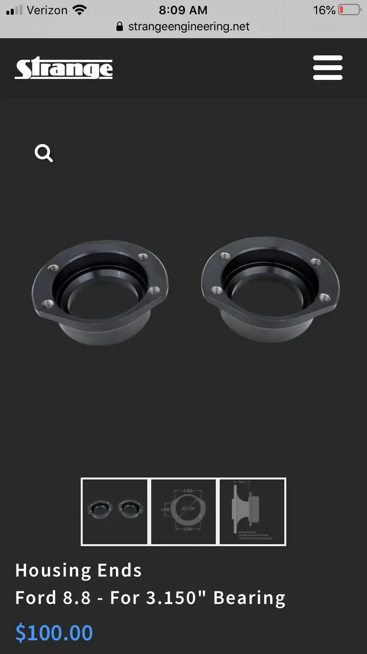

So with that I ordered a new set of 35 spline strange pro axles and spool. Also decided to put 9” ends on with 8.8 bolt pattern to retain my brakes I’m currently using.
These 5/8 studs are huge thankfully my rc comp wheels fit them just fine.

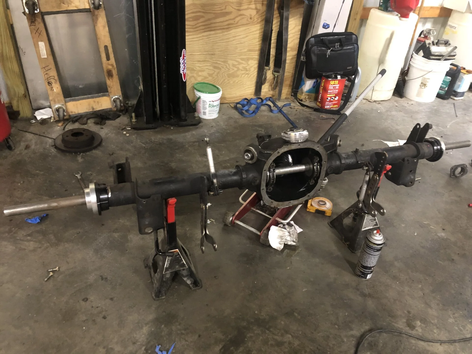

went to put my north race car brake brackets on and didn’t realize the 9” bearings do not fully sit inside the 9” end cups

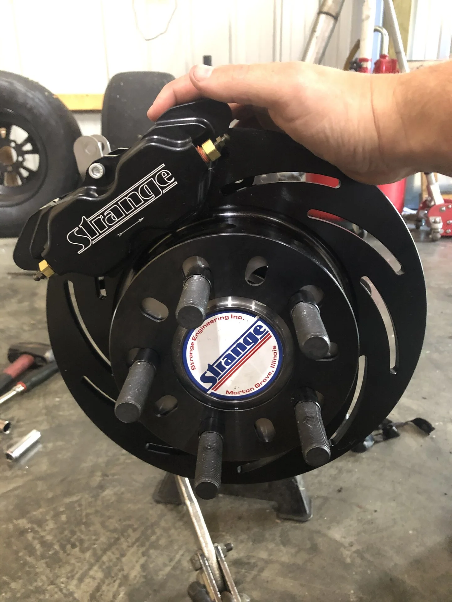

So now off to order new brakes for the rear so the caliper bracket fits around the bearing nicely.
Brakes are in and couldn’t be happier! Hoping to knock this stuff out during the week and get back out there soon.
