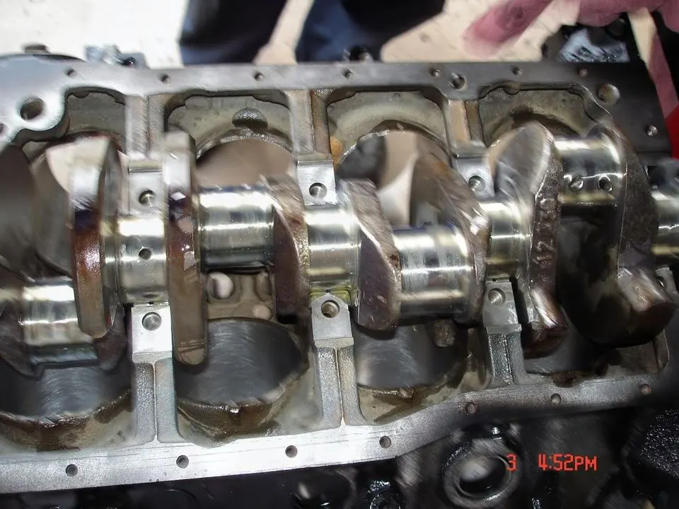

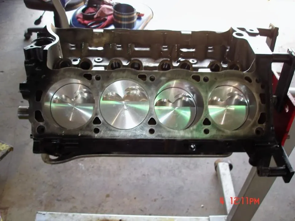

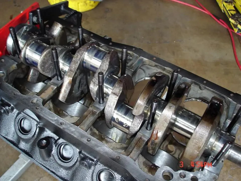

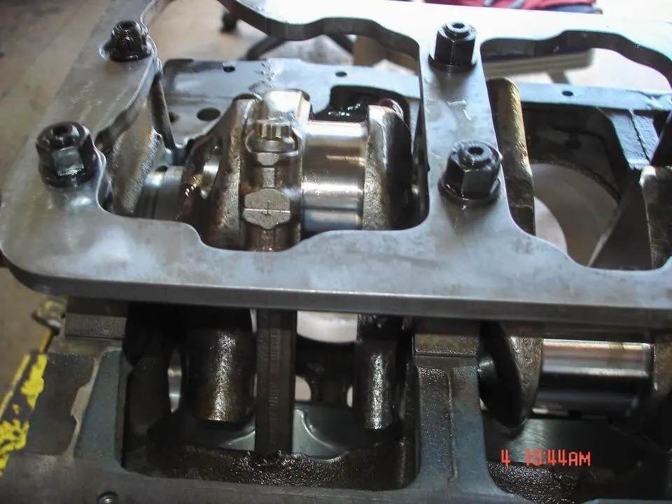

You having any work being done to the crank to balence and clean it up?

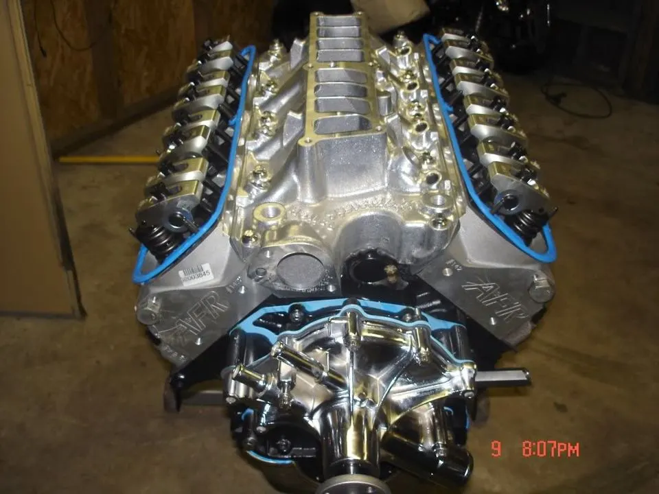

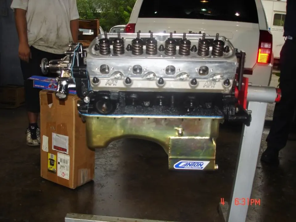

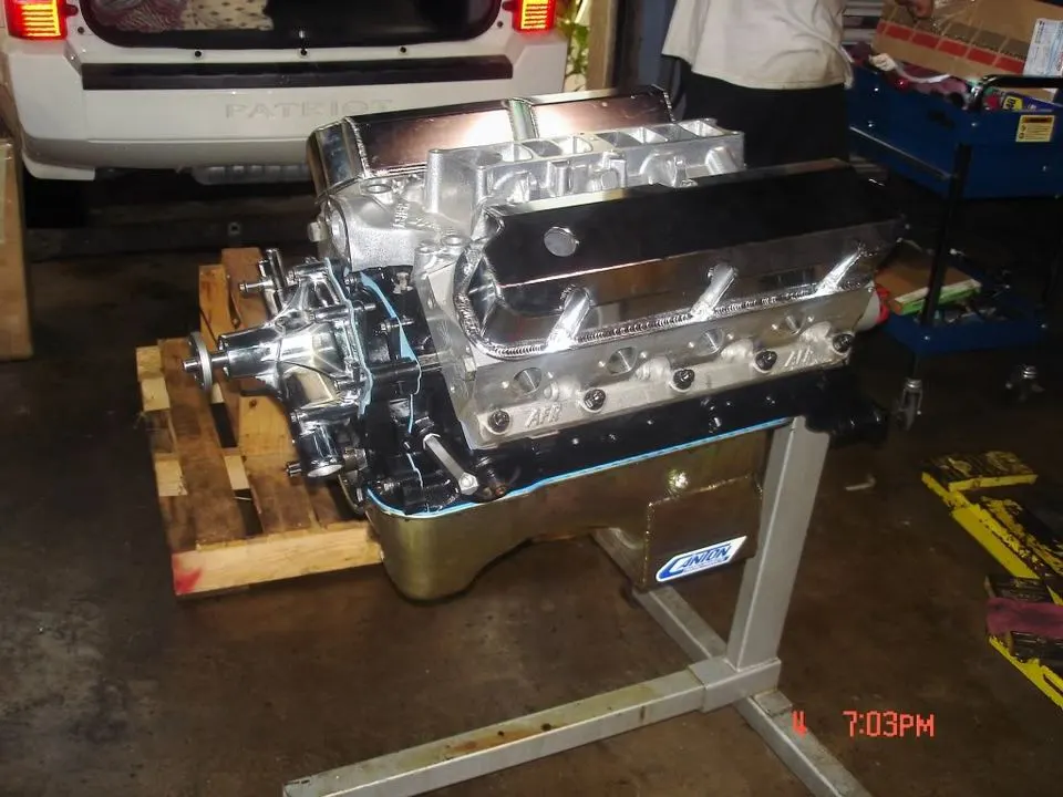

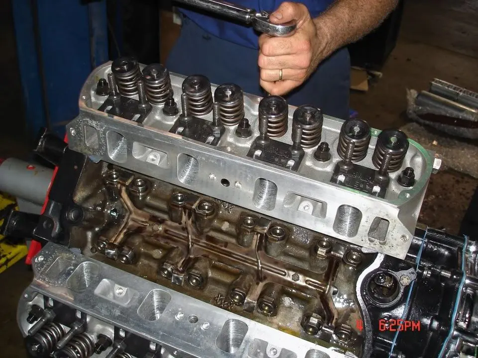

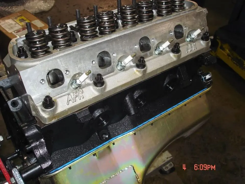

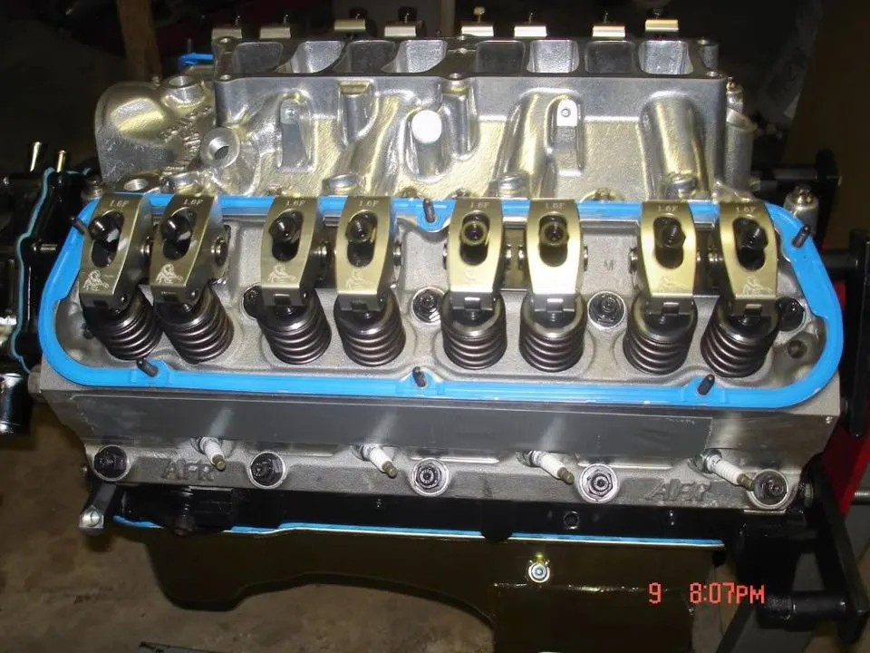

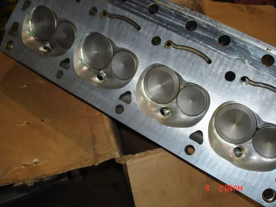

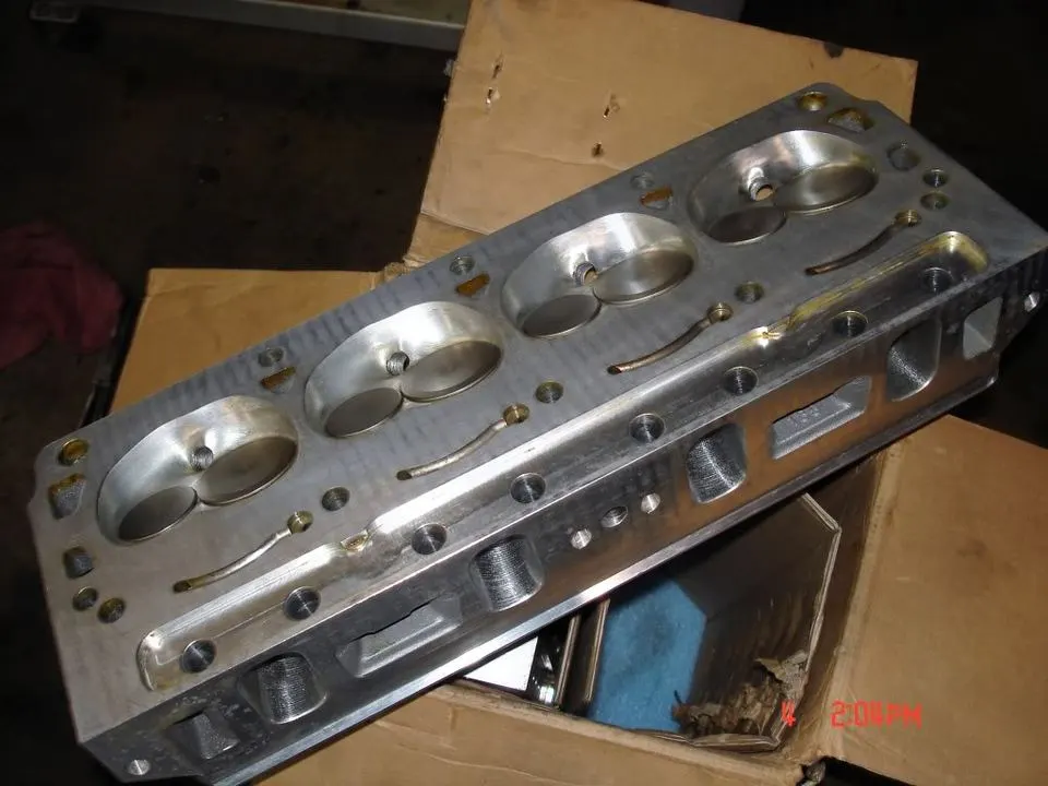

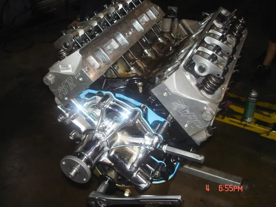

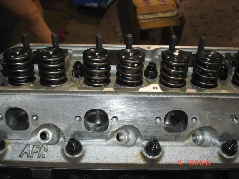

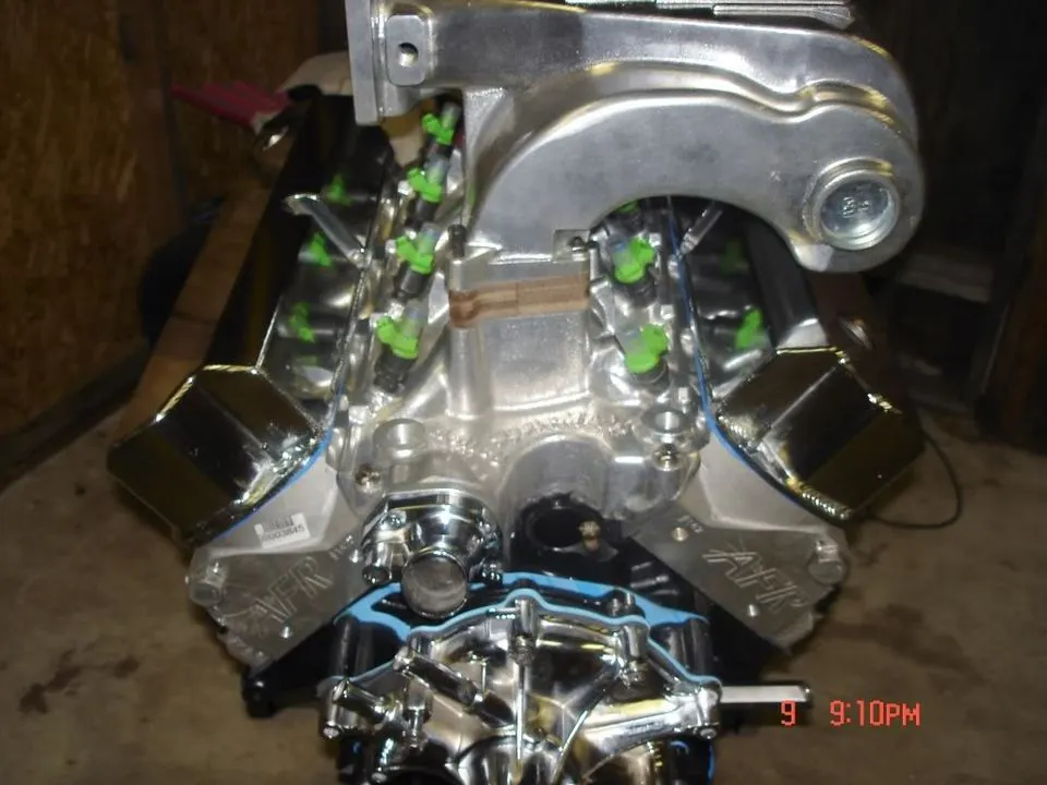

Looks good! What heads and intake are you planning on using?

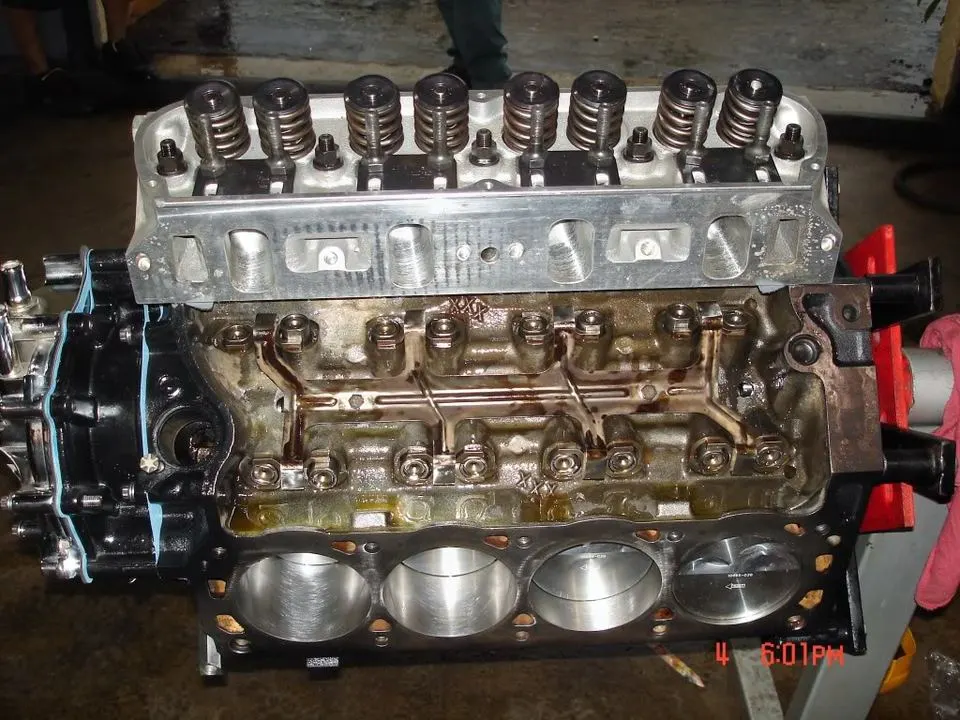

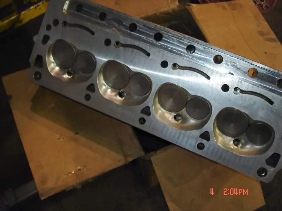

I picked up a set of AFR 185's from a guy that dropped a valve and then they were redone with 2.08's installed...... they are the 58cc combustion chamber... i believe they are part number #1422 ....

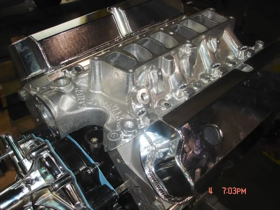

I have a brand new upper and lower Holley Systemax II

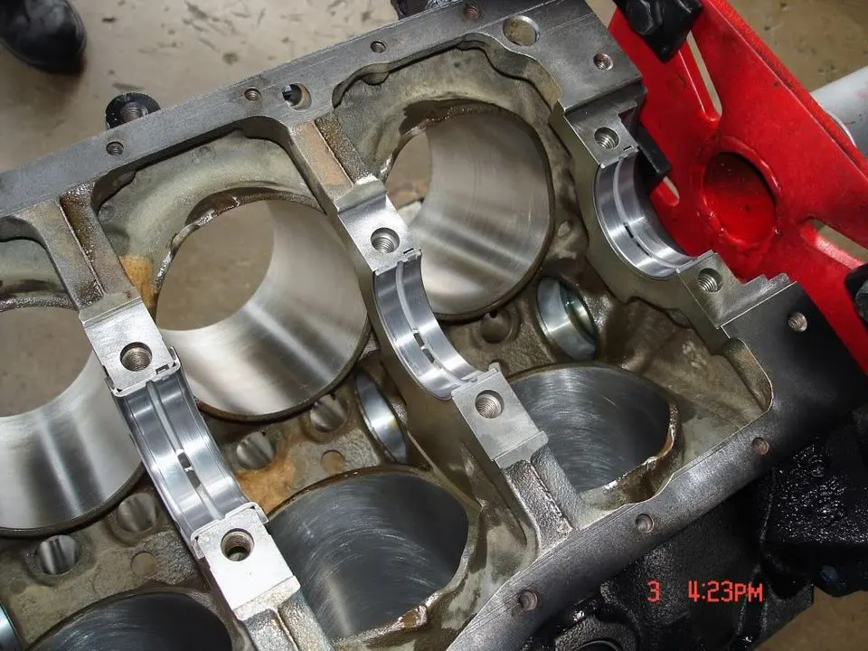

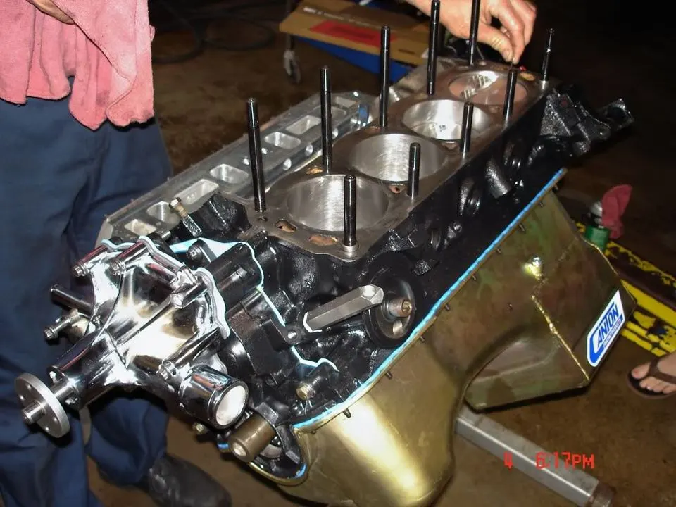

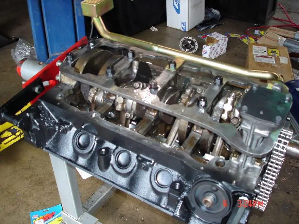

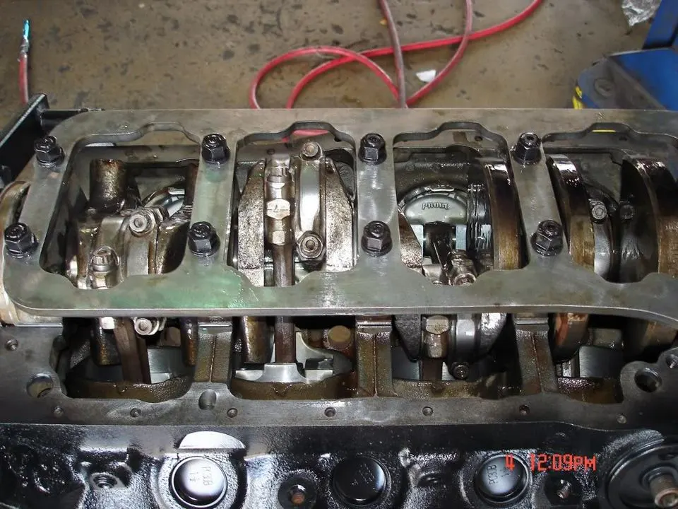

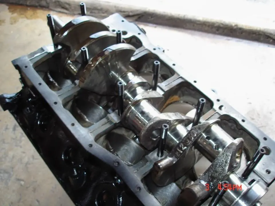

The crank, rods, and pistons were balanced at CHP...... I was told and I'm under the impression that it was a street fighter kit.

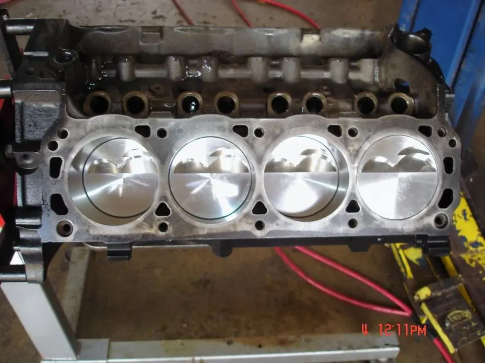

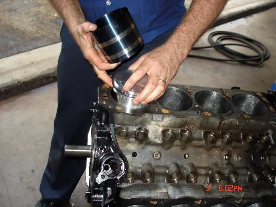

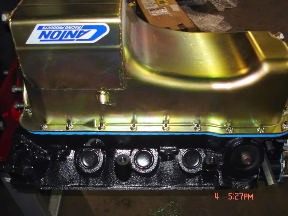

Bottom End Assembly
