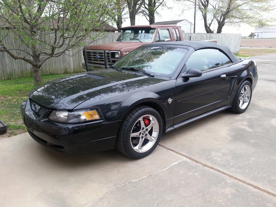

Info on NH: started with a bone stock '99 vert V6 for a good clean foundation, something that hadn't been hot-rodded or messed with
Nighthawk before work.

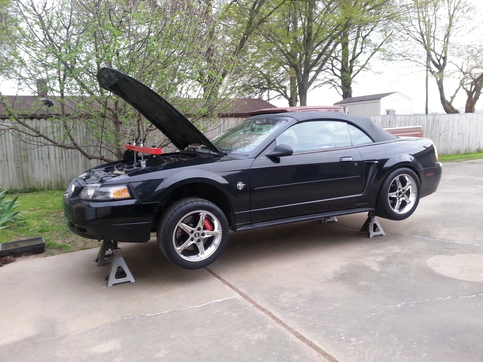

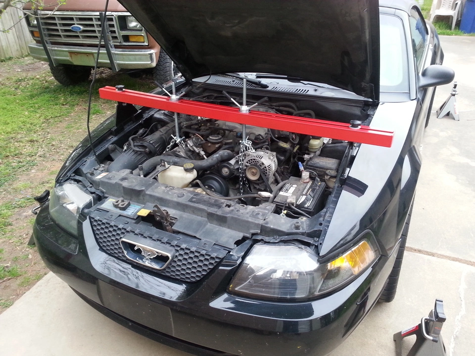

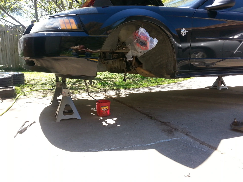

NH in the air, she's flying!

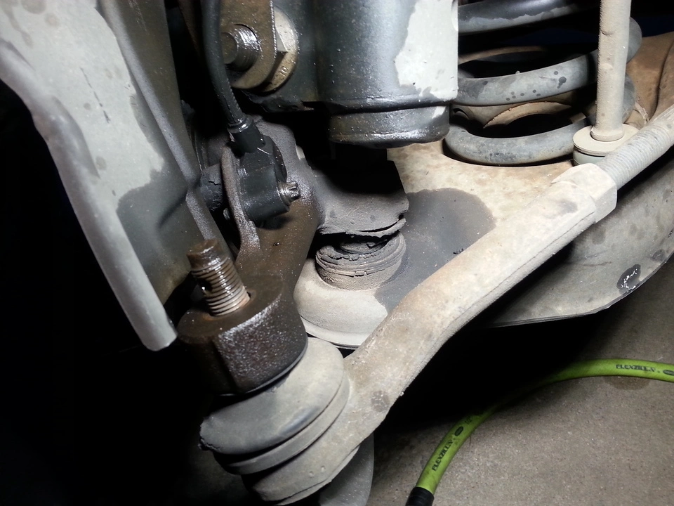

149,xxx pretty sure these are original BJ's... started noticing noise around a month ago, now I know why

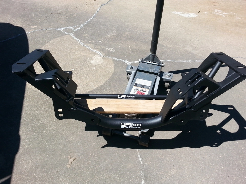

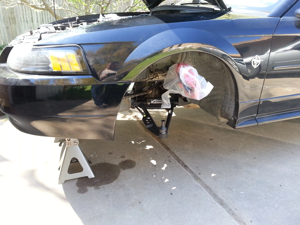

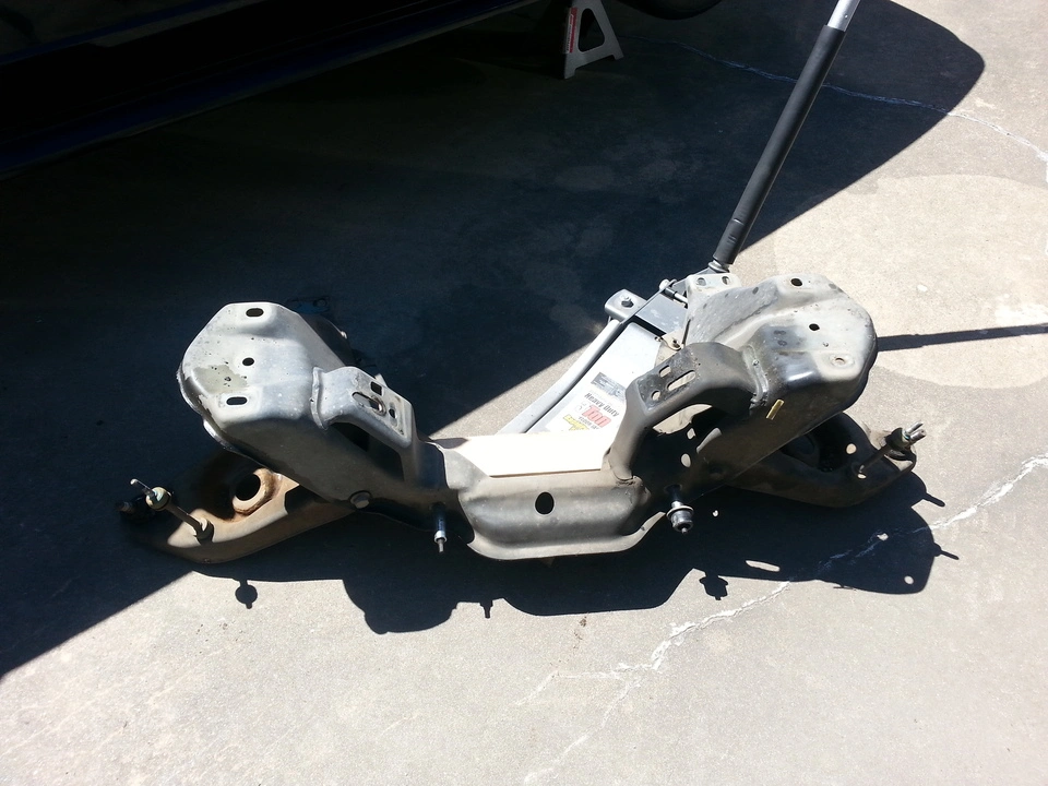

stock K member is out, everything metric, except for the stupid rack power/return lines... go figure
new K!
K installed and front to back dead on, diagonal / side-to-side +/- 32nd of an inch, sorry would just take too long to get it perfect and I can live with a 32nd lol
camera skills suck, yes I know

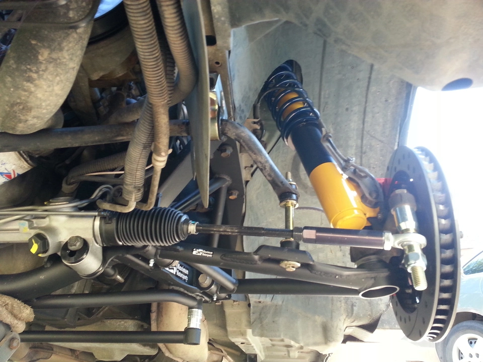

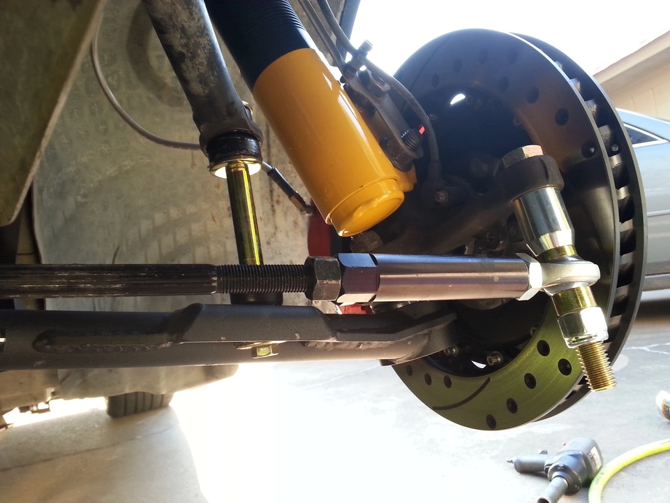

A-arms installed now =D

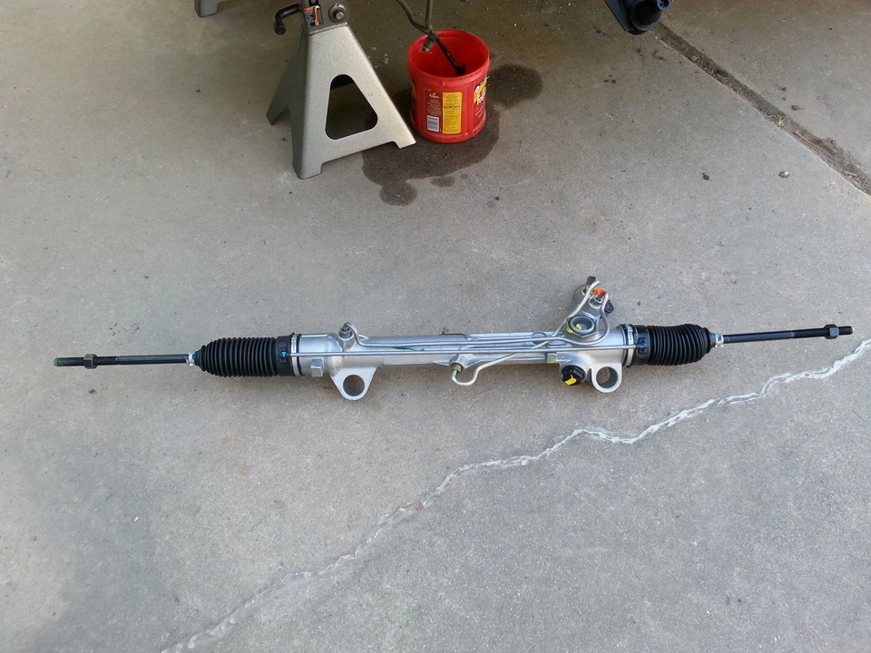

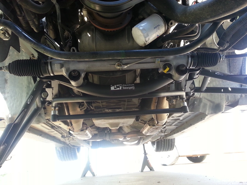

installing the rack n pinion this morning, kind of a pita with the aftermarket K member BUT, you can clearly see the diff in rack placement for improved bump-steer
edit: 2003 cobra r&p new from the dealer, don't bother trying to deal with remans from napa or autozone, they both carry the same reman units and they cant guaranty they units will even be right, you may get a v6, a gt or a cobra, but more likely you'll get a low end one
The nastiest grease known to man... prothane poly-urethane grease, wear gloves or you'll never get it off
drilled the 4th hole for the C-C plates, pita slotting them

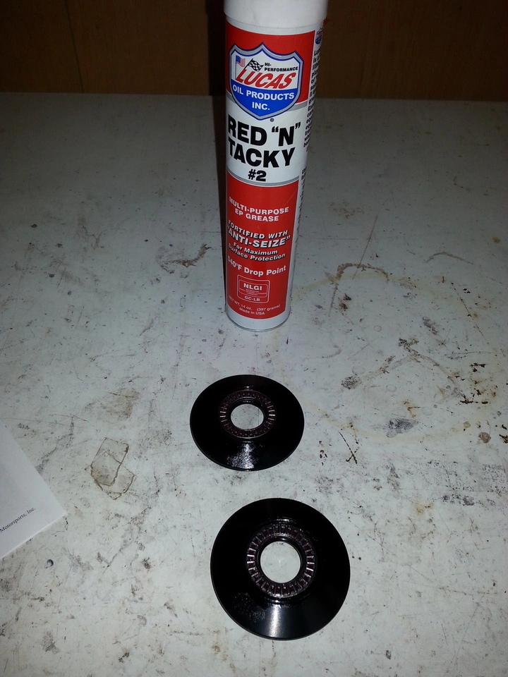

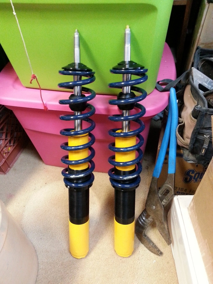

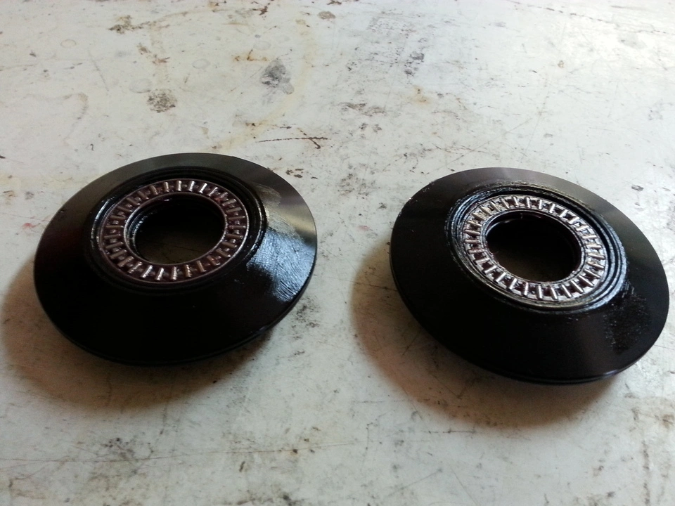

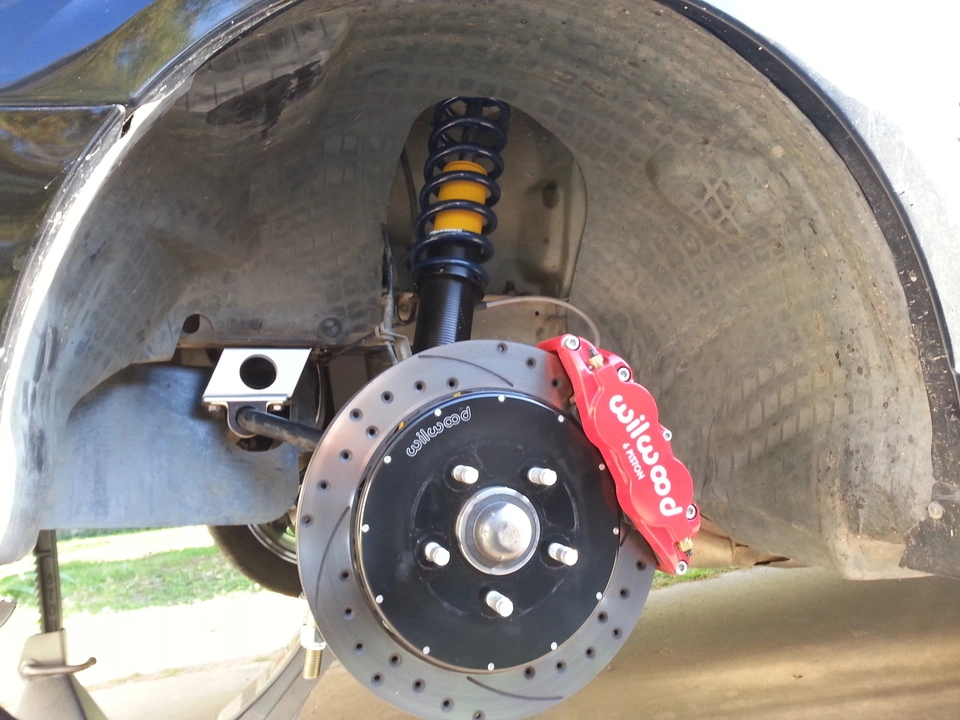

assembling the top bearing units for the coilovers and the best grease in the world imo
coilovers done and ready to put install after lunch

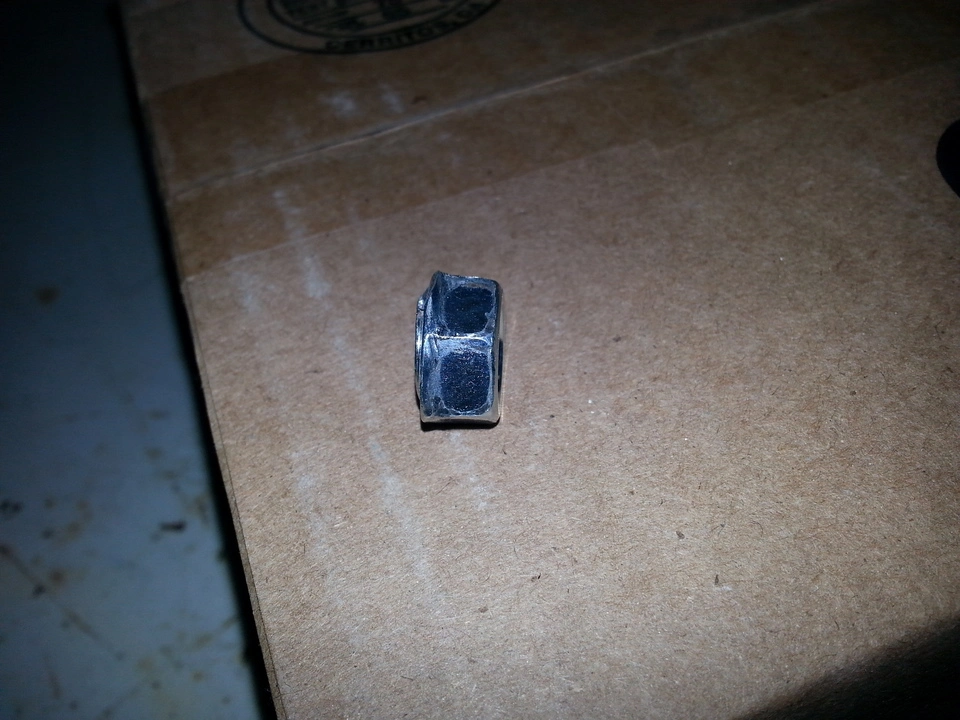

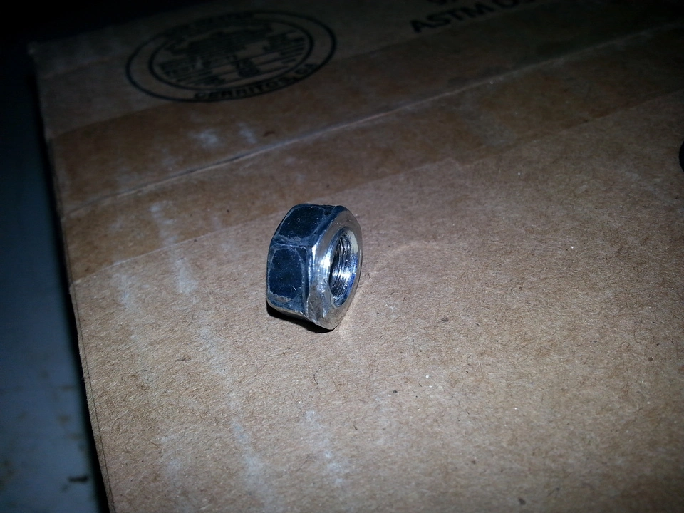

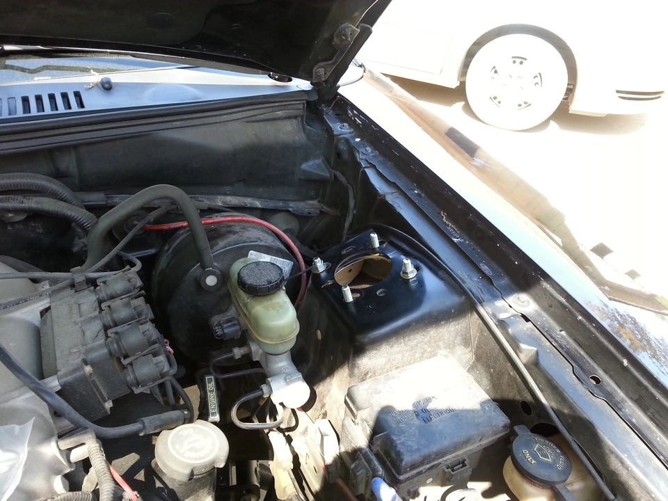

finished up after some plroblems, A: the 3/8 nuts for the caster camber plates exploded... literally exploded when I torqued them...
B: had to drill the spindles out from the 7/16 taper to a 5/8 straight, just didn't realize it when I started the project or I woulda accounted for it
other than that, everything is installed now

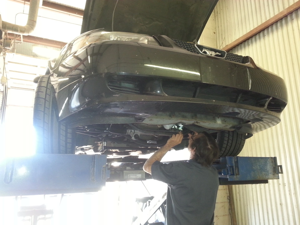

Bob is our local dealer mechanic, he was blown away... he's like "dude, idk how to set this man... it isn't stock"
I gota say... at first I wasn't sure about it, at low speed it feels normal, the grippy sensation from the tires is gone, it feels perfectly normal. Untill you do something like change 3 lanes in an instant, then it just slams you sidewise and shoots that way.... corners are insane, normally you would break the tires loose but now it just grabs and BAM throws you that way.

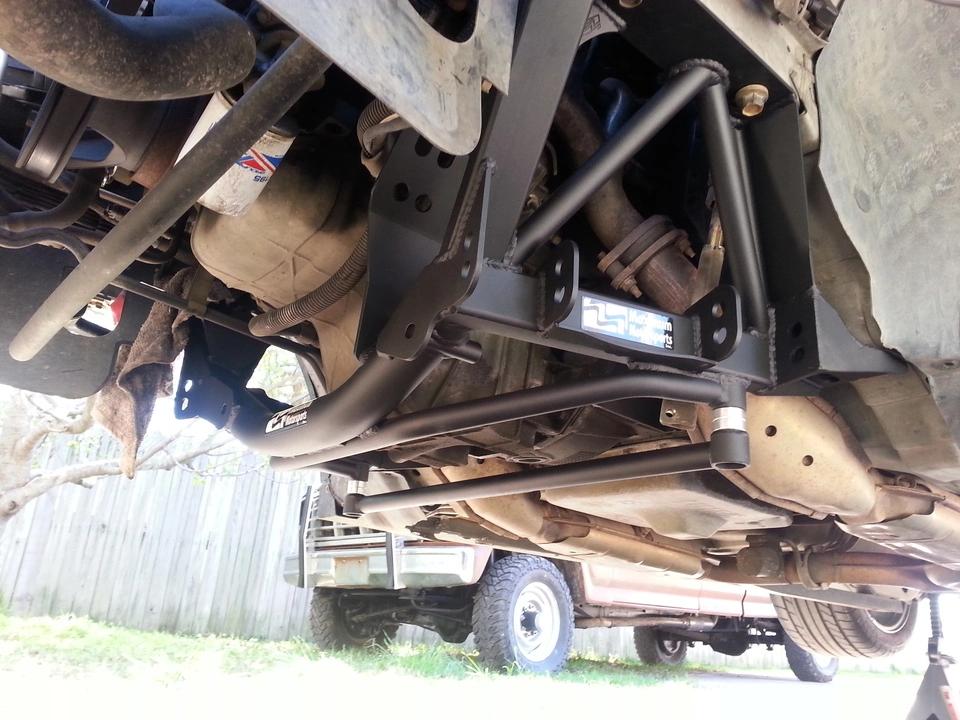

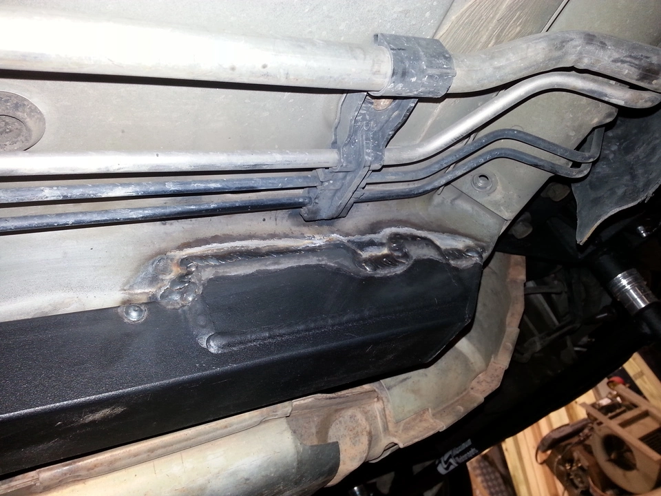

hoping to get the new rear in this weekend, then maybe next week get the subframe connectors welded in

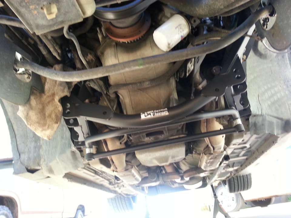

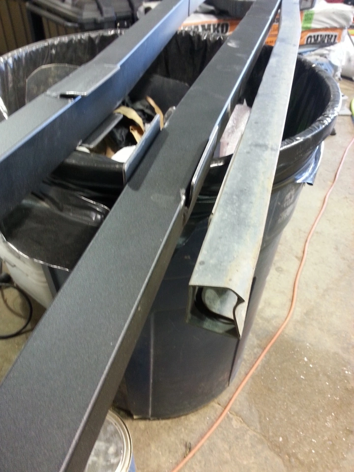

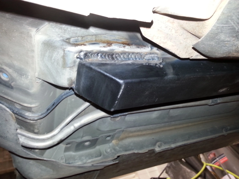

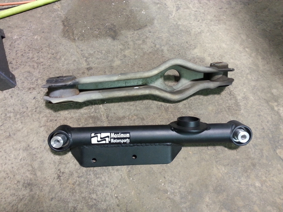

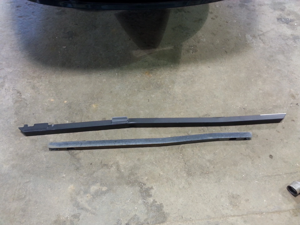

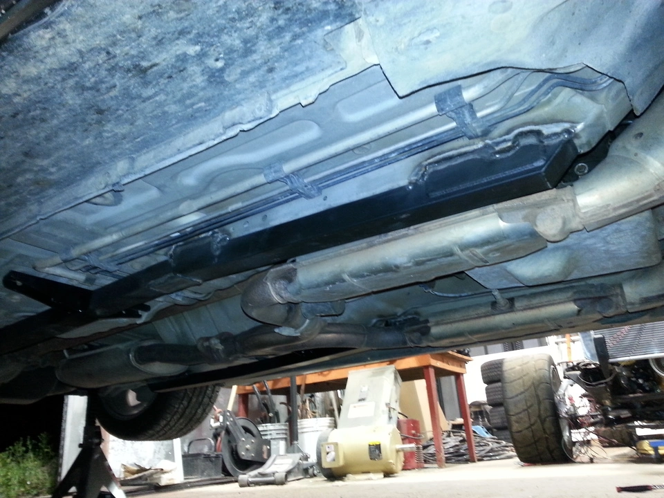

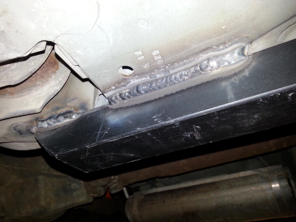

working on getting subframe connectors in today, comparison of stock vs the MM ones... double the thickness and almost double the length lol
always wear your protection, would have been ALOT worse if I didn't have my gloves on, wire wheel on the grinder, wasn't pretty
whew, long evening but done with the subframes!
took it out for a spin, it's amazing how much it quieted everything down... it's like going back to 60 tires, all the misc rattles and buzzes from the plastics are gone, bumps are firm yet smooth, i'll find out how it handles tomarrow...

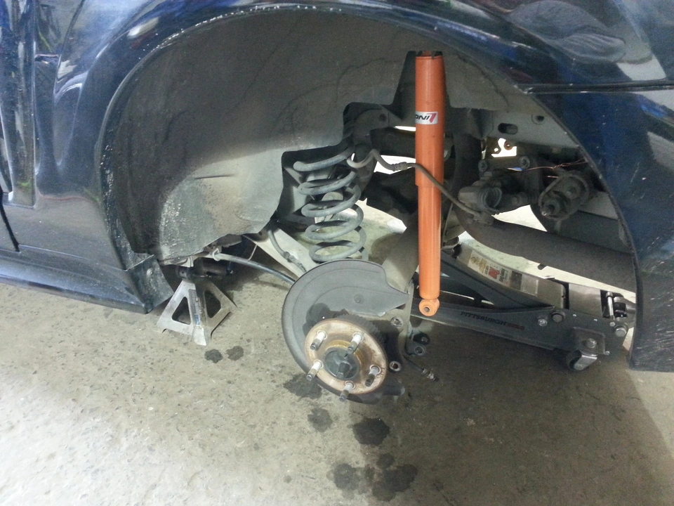

now im ready to start the next phase for the rear, the torque arm install! had to have the subframe connectors in before I could do it cuz it mounts to the connectors, so now it's time to change the rear end out to the 8.8 ive got sitting in the dark and change everything over to the torque arm setup... then suspension work is done, and it's time to start focusing on the motor swap

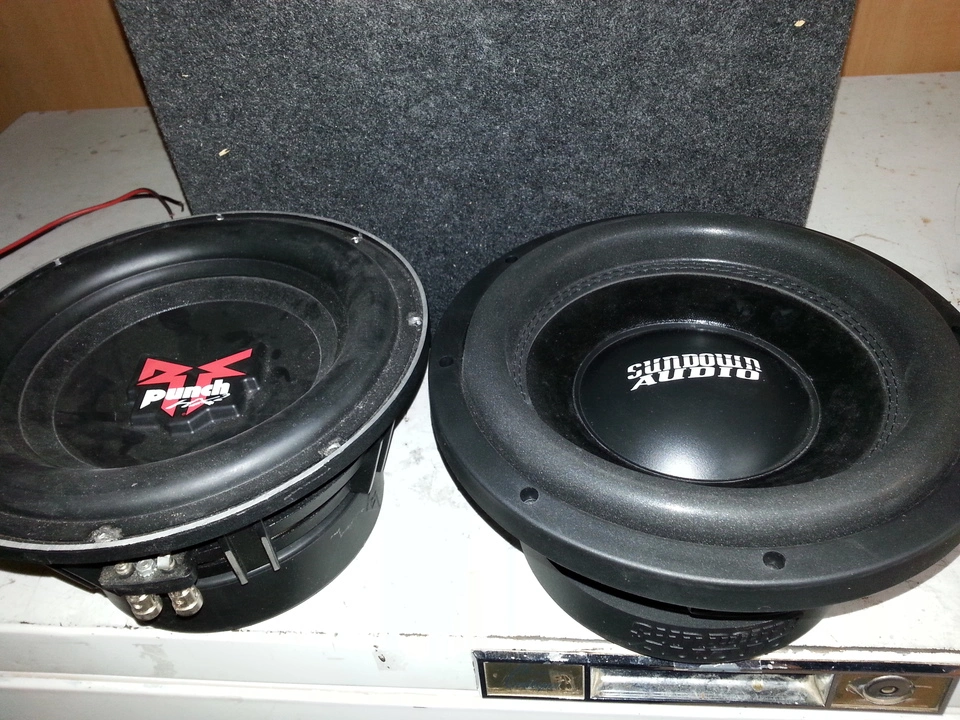

did some trading around and picked up this little beauty, 10" Sundown SD3v2, will be perfect for Nighthawk's tunes.
next to my old Rockford Fosgate Hx2's

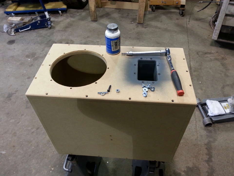

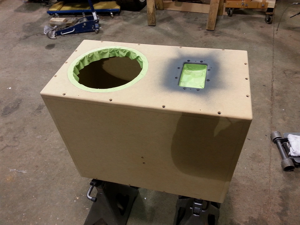

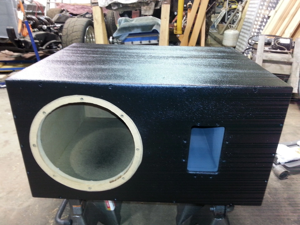

Getting ready to paint the box, 2.5cu tuned to 28hz, installed hurricane nuts for swapping subs, I tend to do that a lot lol

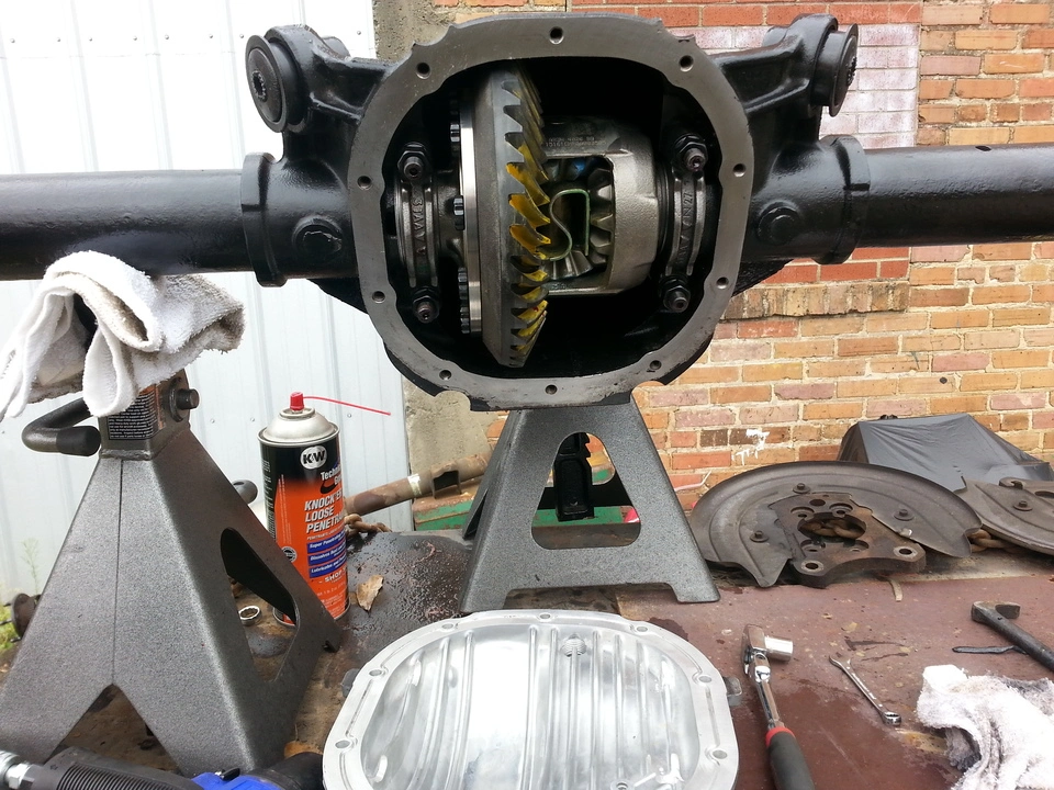

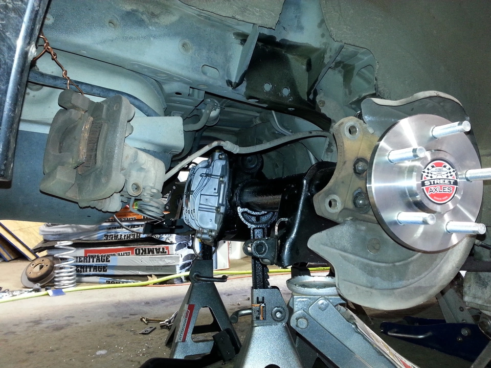

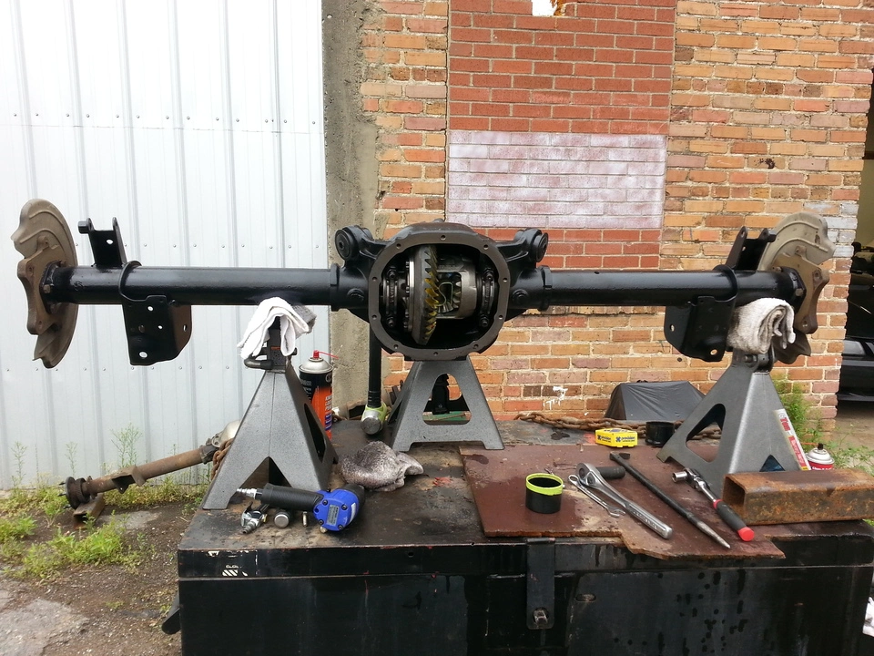

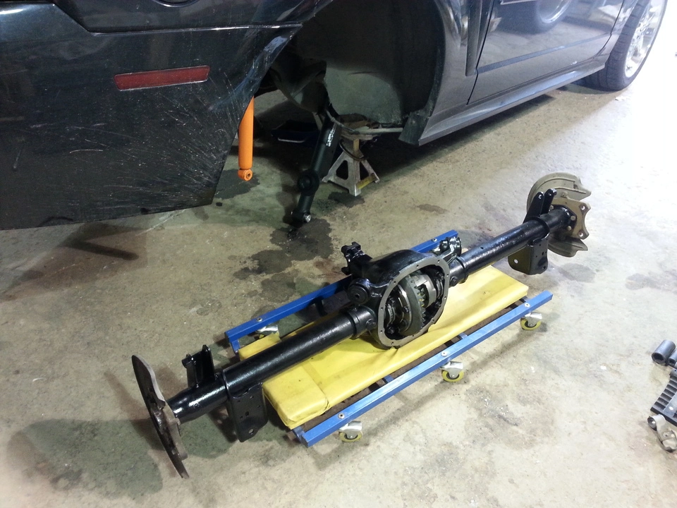

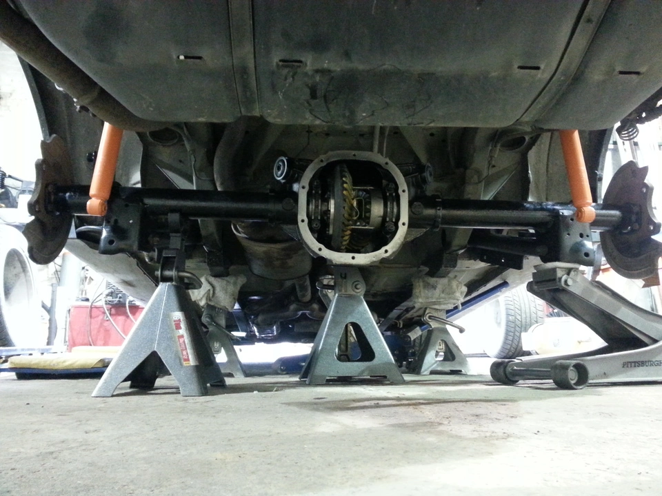

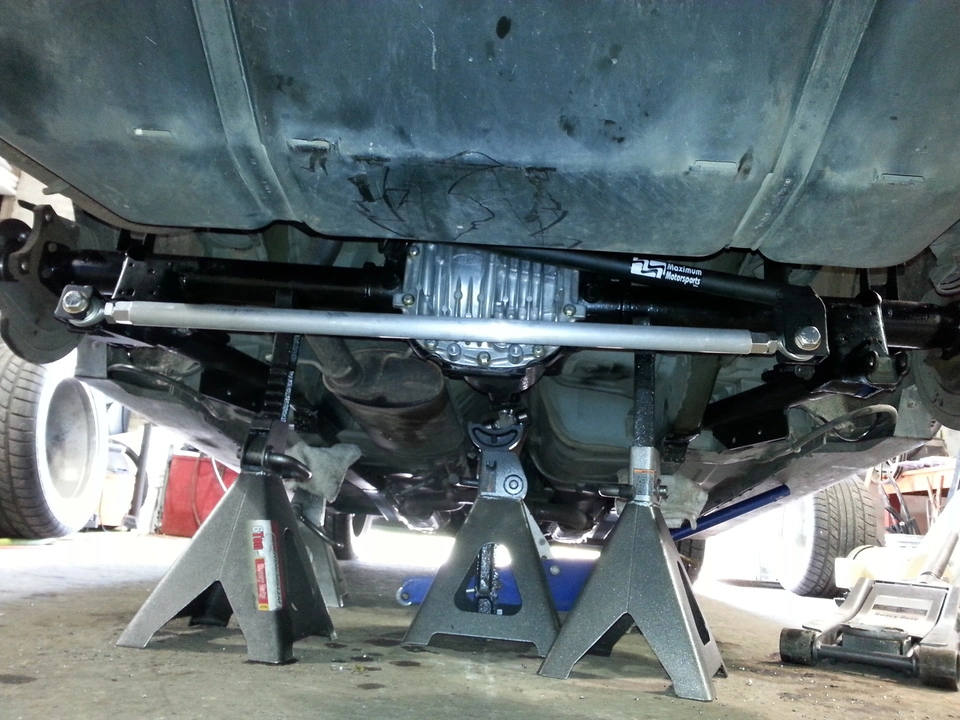

the new rear end is in, only about 40% done tho, still have to install the TA and PHB

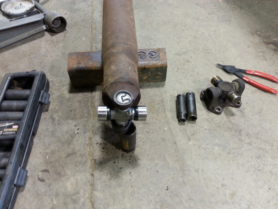

original driveshaft, using a 1330 to 1350 conversion Ujoint to fit the new rear end cuz im using a 1350 yoke instead of the factory style flange
installing in!
you can never have too many jackstands... I think I have 10+ lol

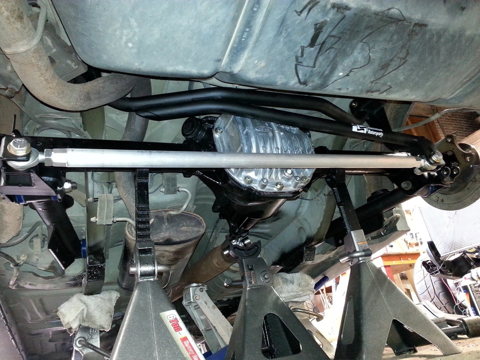

glad today is going better than yesterday, finished getting the PHB installed today and buttoning up the diff
PHB has been annoying cuz nothing is there, it's 100% new install so im having to read and re-read the instructions to make sure I get things right, BUT... it's all been worth it when I got it in and everything looks perfectly square and parallel to the rear end.
I gota say, for the not-much-more than competitors, Maximum Motorsports stuff really does fit well, you get everything you need and then some, everything is WAY overly well-built and fits in there like stock, worth every penny for these kits

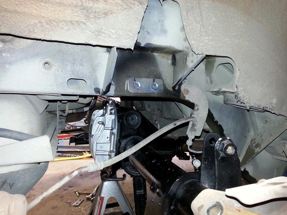

Drilling holes for the special brackets for the PHB mount
Special sleeved bracket that keeps the subframe rails from collapsing when torqueing the bolts down
bracket finally in and almost done!!!!
