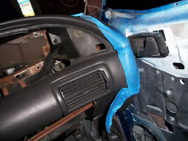

I think it's spot on. That's where I cut both of mine. I was stil able to use the fox door handles too. They cleared the dash but I did have to trim about 1/8" or more of dorr handle. No biggie. You cut a little too much off the passenger side so you will have a gap between the dash and the lip of the windshield edge. No worries, I did the same thing to my current project. I was paying closer attention to other alighment issues and didn't realize what I was doing.

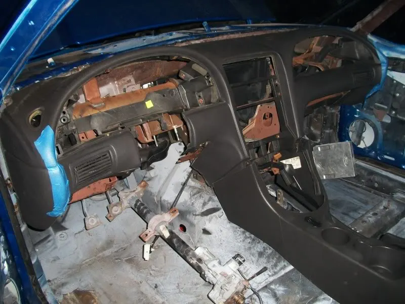

okay finally got the dash bolted up had to cut the main tube to get it in, maybe the 1981 body is not the same i dont know but it would not mate up tight without it.
used a piece of cardboard as the windshield to make the clearances.

I would fiberglass or seal that tube somehow. That is also the ducting for the drivers side A/C vent. If you are going to make it work again...
when I put mine in, i had no issue with that tube at all... wonder what the difference could be...

i could not get the driver side to lie flush by the door, the metal pipe is hiting the upper firewall so i cut a big slice out, ill just flip it over and weld it all back up
