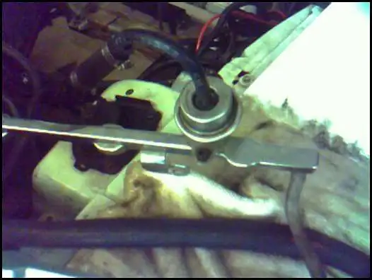

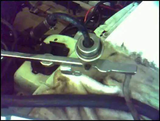

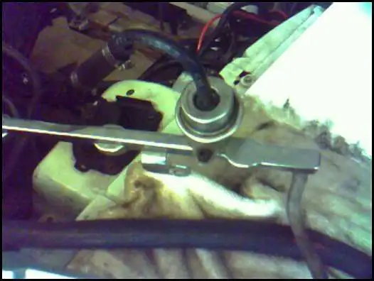

could this be part of my HG blowing problem?
what fuel pressure should i be running?? what pressure does the stock FPR run?

39psi is stock FP (vac. line un-hooked at idle). If your running a charger dont you have an FMU or Tune/tuner. The stock FPR will not handle boost by itself unless the eec has been given the correct fuel changes to make up for it, and even then I think you may need a adj. FPR. (I am not a boosted guy so I dont know what is needed but stock stuff prob. is not ideal)

Not sure what you shouldbe running, but stock fuel pressure is 30psi at idle, and 38-40 under load (or with the vacuum line off). I really can't even guess what fuel pressure you need though. :shrug: I'm not familiar with S/C setups.

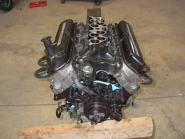

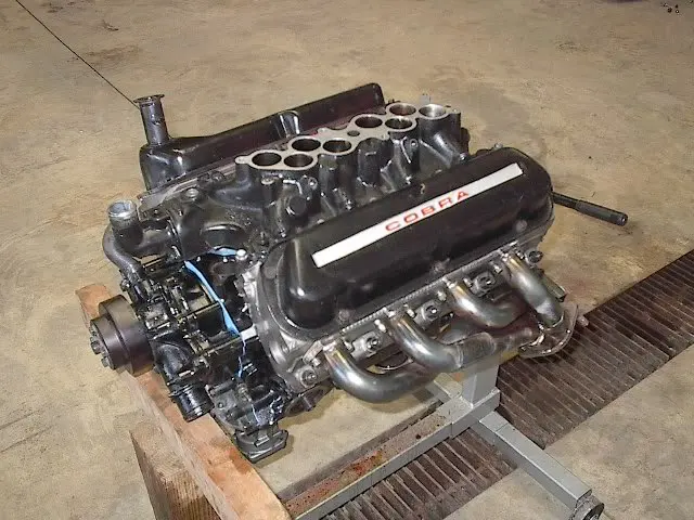

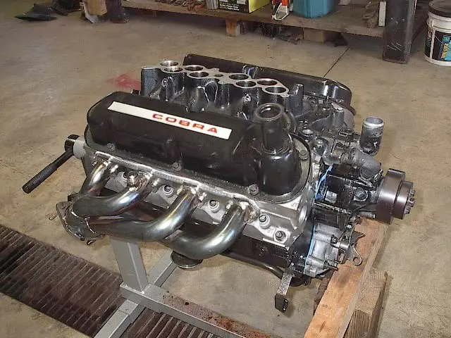

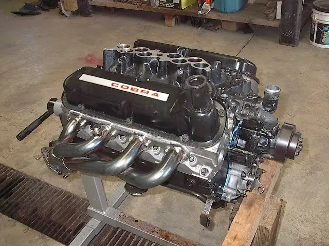

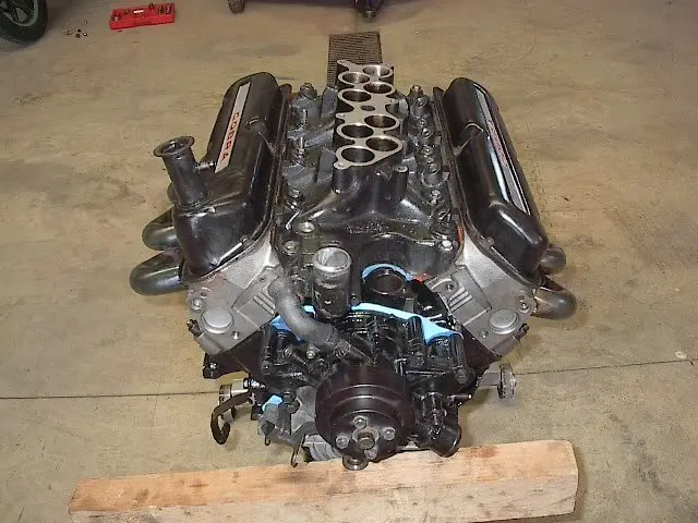

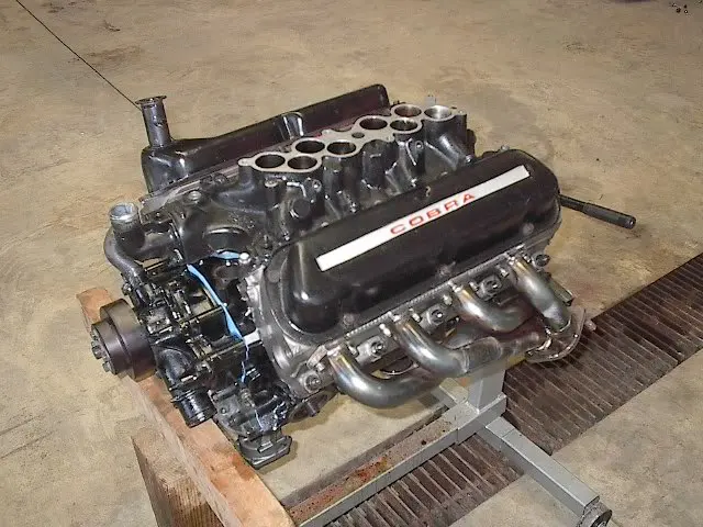

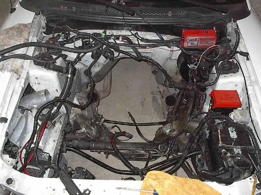

This is what it looks like now... im waiting on my oil pan and i still need to plastigauge

5.0snake said:
looks awsome! Cant wait to see the finished product! What kinda numbers do you think you will be putting out with the new short block? You upping the boost?
thats a good question... i think im going to keep the boost the same, hook up my meth. inj kit get that fuel pressure fixed and see what happens.... i was at 423rwhp before the 306, cam, meth. inj. and flowmasters so i dont know :shrug: maybe 450-475??? not sure
