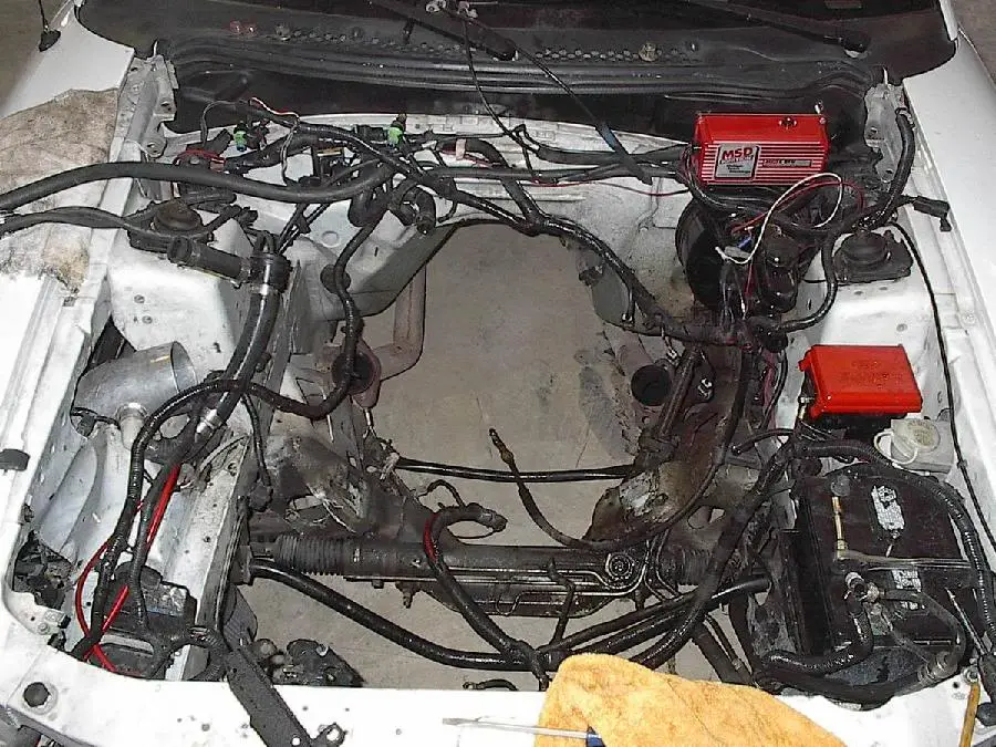

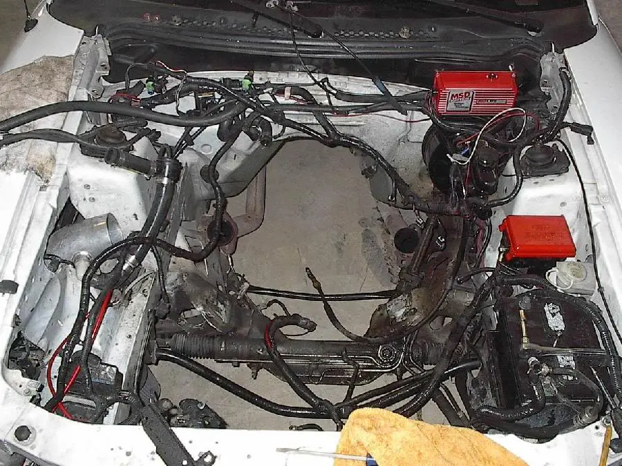

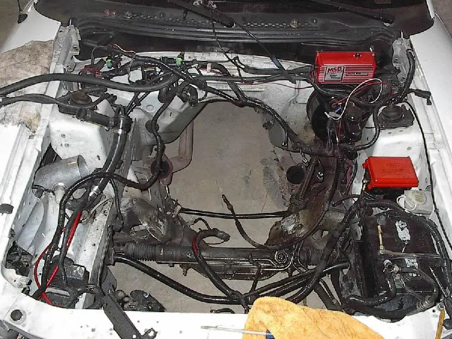

Hey what kinda of hood do you have on the car. I ask because I have the Cobra R hood and I want to install the MSD box in the location you have yours and want to know if there are any clearance issues (i.e. hood hitting MSD box) Let me know. Peace

Welp i washed out the engine bay tonight... i used simple green and a power washer, it did a great job!! i'll get pictures up later....
