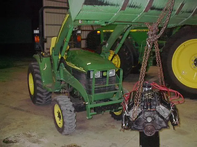

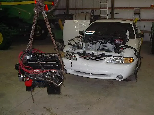

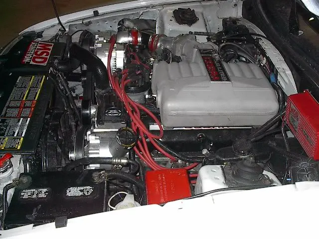

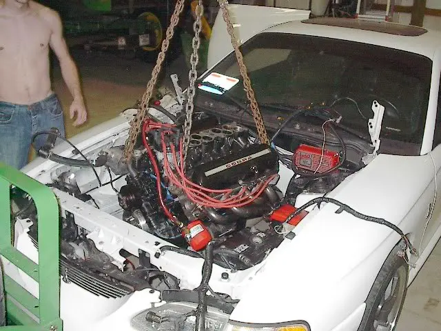

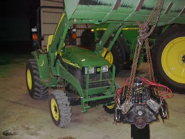

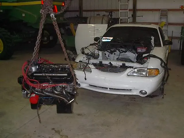

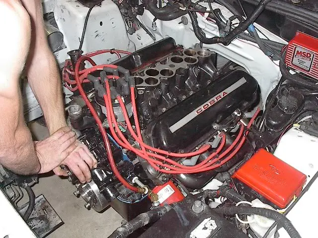

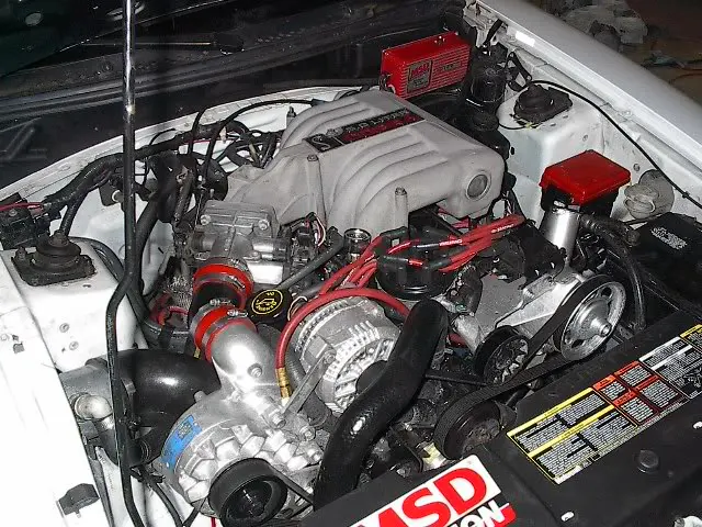

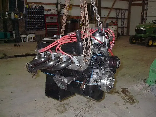

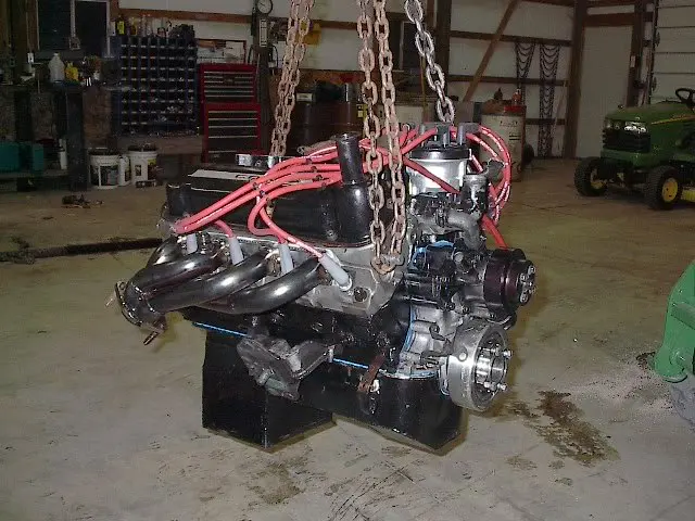

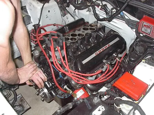

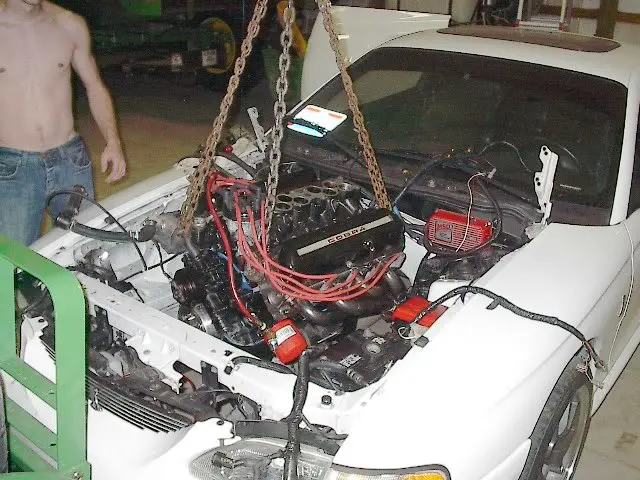

Well, i actually had some time tonight to put the oil pan on and tap the hole in the side for the S/c return line. NOW IT IS IN!!!! some progress pictures
YES i am a HICK
My Friend Wes who helped me line things up as i dropped it in.... What a weirdo
Almost there!!!
IN!!!!

before i tighten down the engine mount nuts should i level the engine in the engine bay? before you answer level is only reletive to the levelness of the car and of the ground.... how do i find if its level in the car?

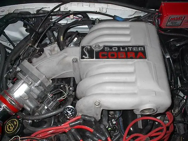

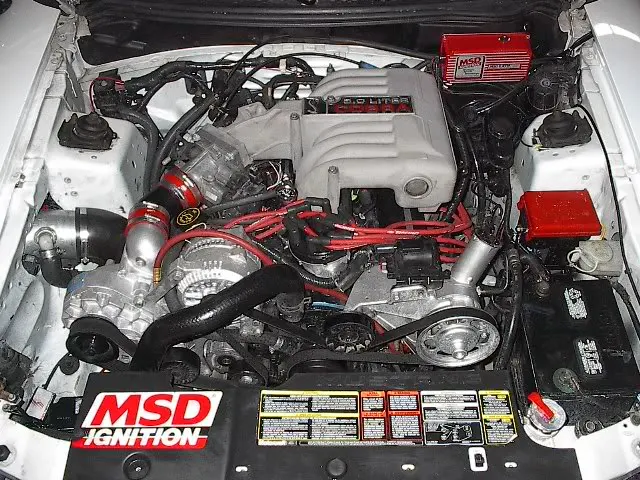

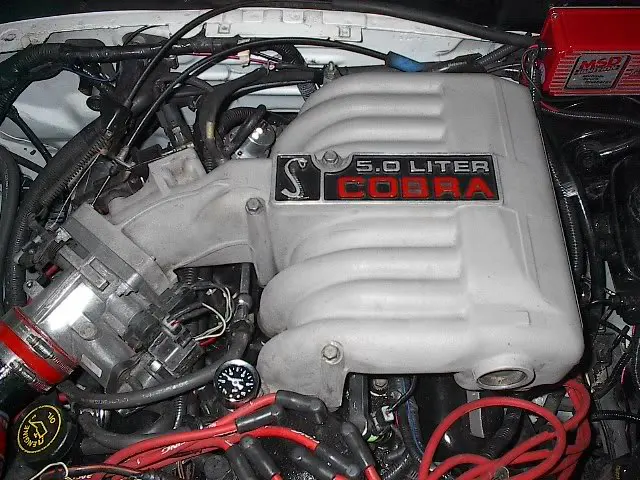

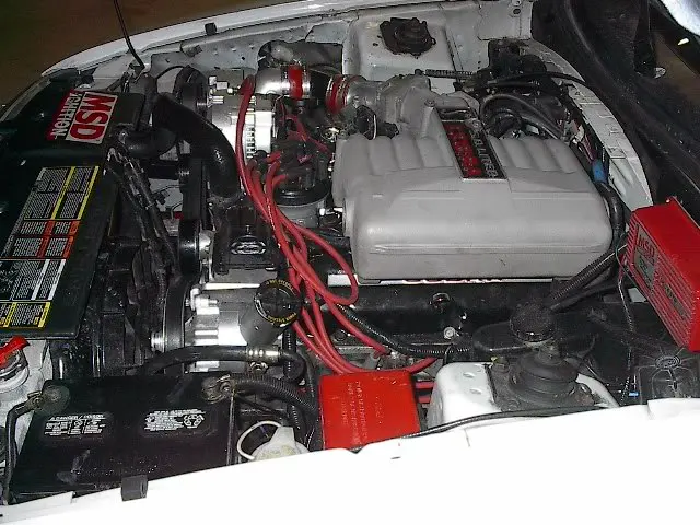

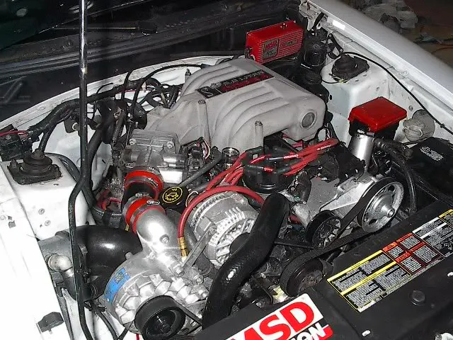

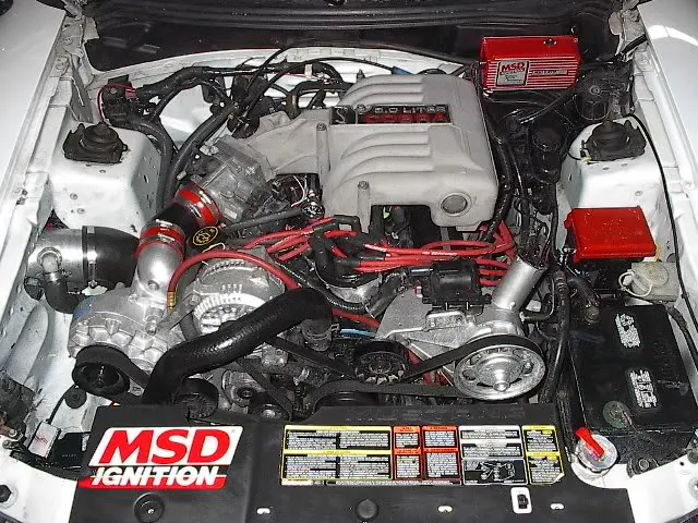

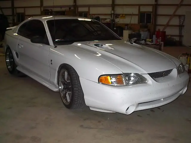

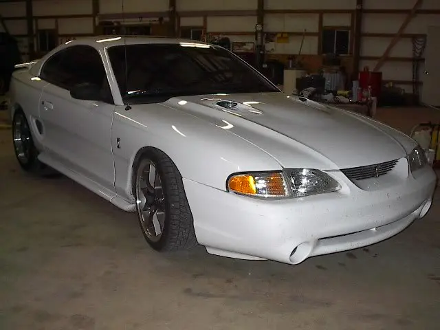

Finished Product! Sorry they arent the best pictures, taken at 12 midnight in a barn...
My car is much happier now... :)
still having a few issues but ill make a new thread about them.
thanks for all your help!
