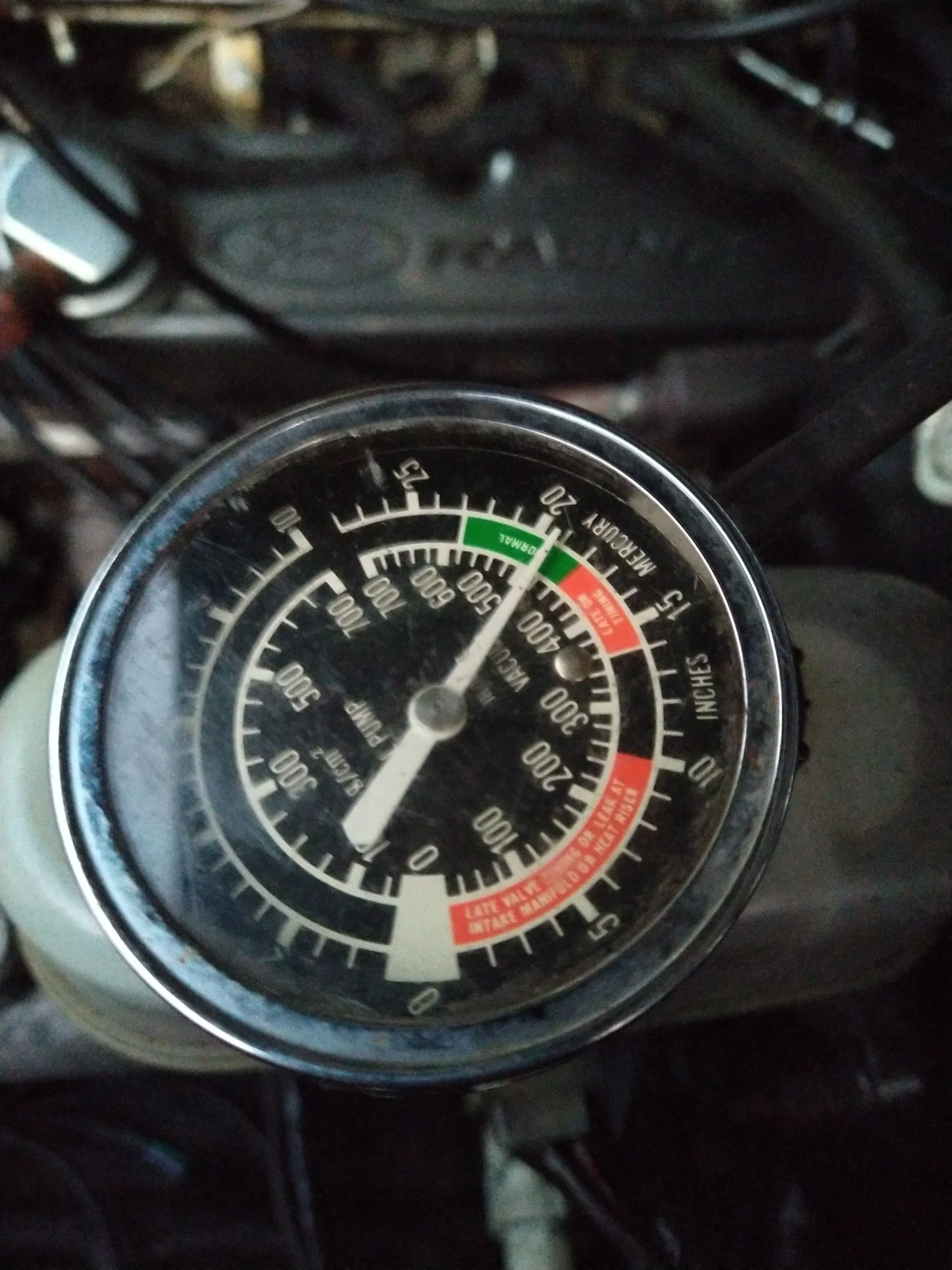

Depending on how much inches of mercury your engine pulls determines the direction in which to make changes...Some carbs require drilling the PVCR to get a better emulsion so having a vacuum gauge helps alot.....

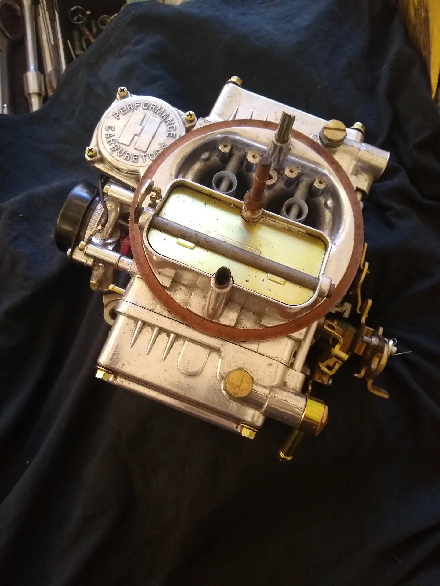

For the street Im more partial to these types of carbs as they help with gas mileage but still offer performance......

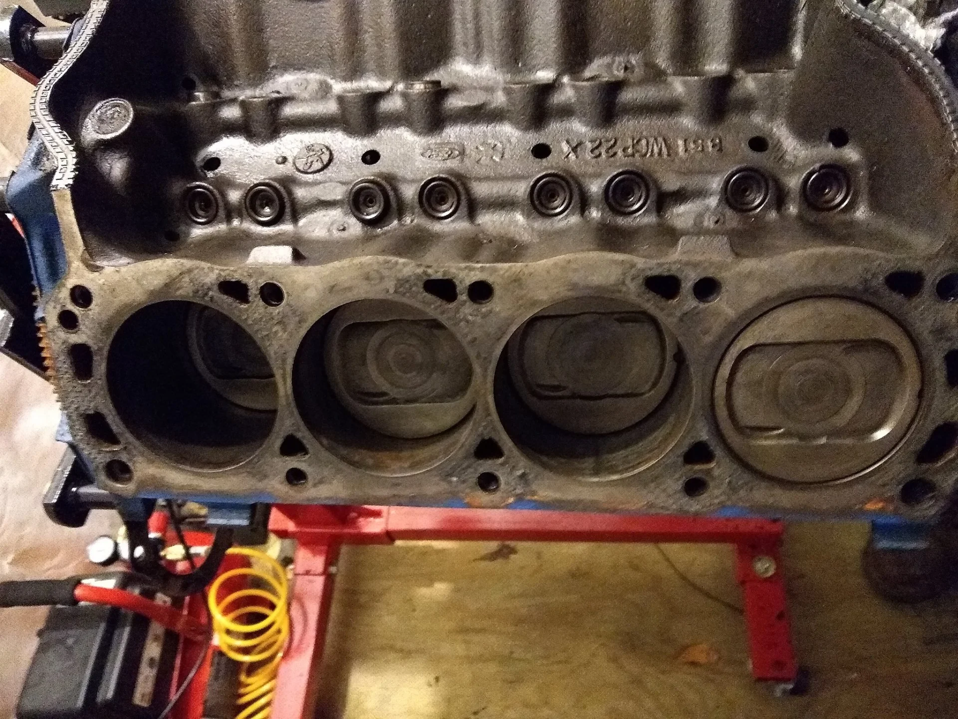

I believe this one is Holleys Avenger Series I got on an engine in a parts truck..The 351w had 302 heads and a performer camshaft w/.493/.509" lift camshaft and adjustable valvetrain and OBX stainless shorty headders with a stock cast iron manifold I bought for a core for my 408w engine project..
I definately got a good deal for the $400.00 I paid for the whole truck as this is what that junk looking 351w looked like on the inside plus it had some pretty nice power and a shame to disassemble it til I pulled the heads and found ridges at the cylinder tops telling me the engine was refurbed by an ultra backyard mechanic as it shows because whoever did it didnt go the extra mile and change the rings and bearings or hone the cylinders but pulled the heads.......LOL
