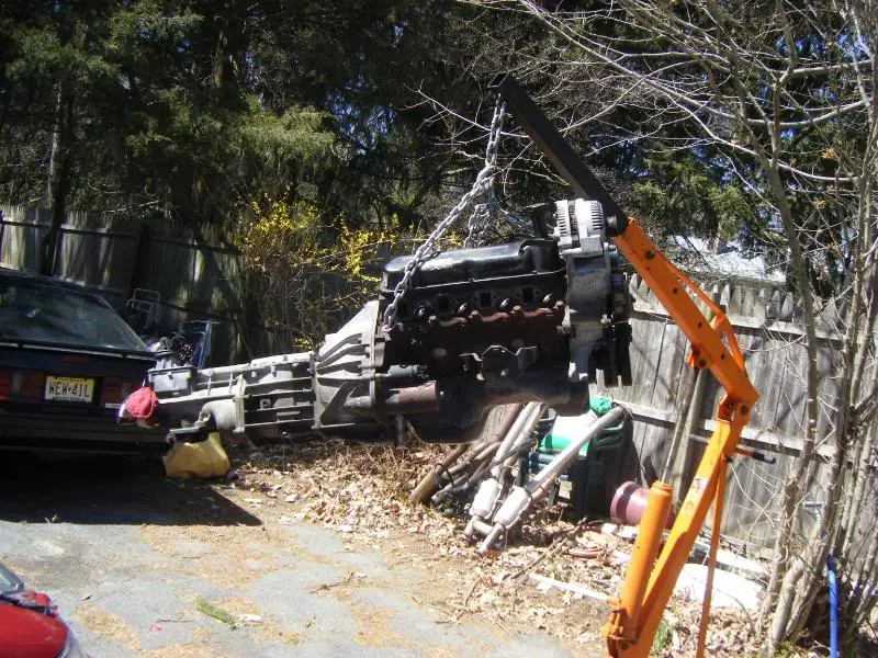

CAKE! :nice: much much faster IMO this was like 3 hours from fully connected engine...
