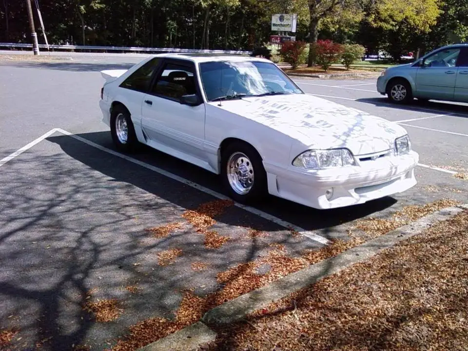

heres mine:
3.5x15's up front and 15x7's with a 4.5 bs out back.... the tire currently on the back is really wide(12.5) and im going to go a tad narrower.. i know all the guys on here are going to start bashing the way the back wheel sits but its perfect for me because with the tire out farther i can get the best of both worlds wide tires and retaining my quad shocks...
