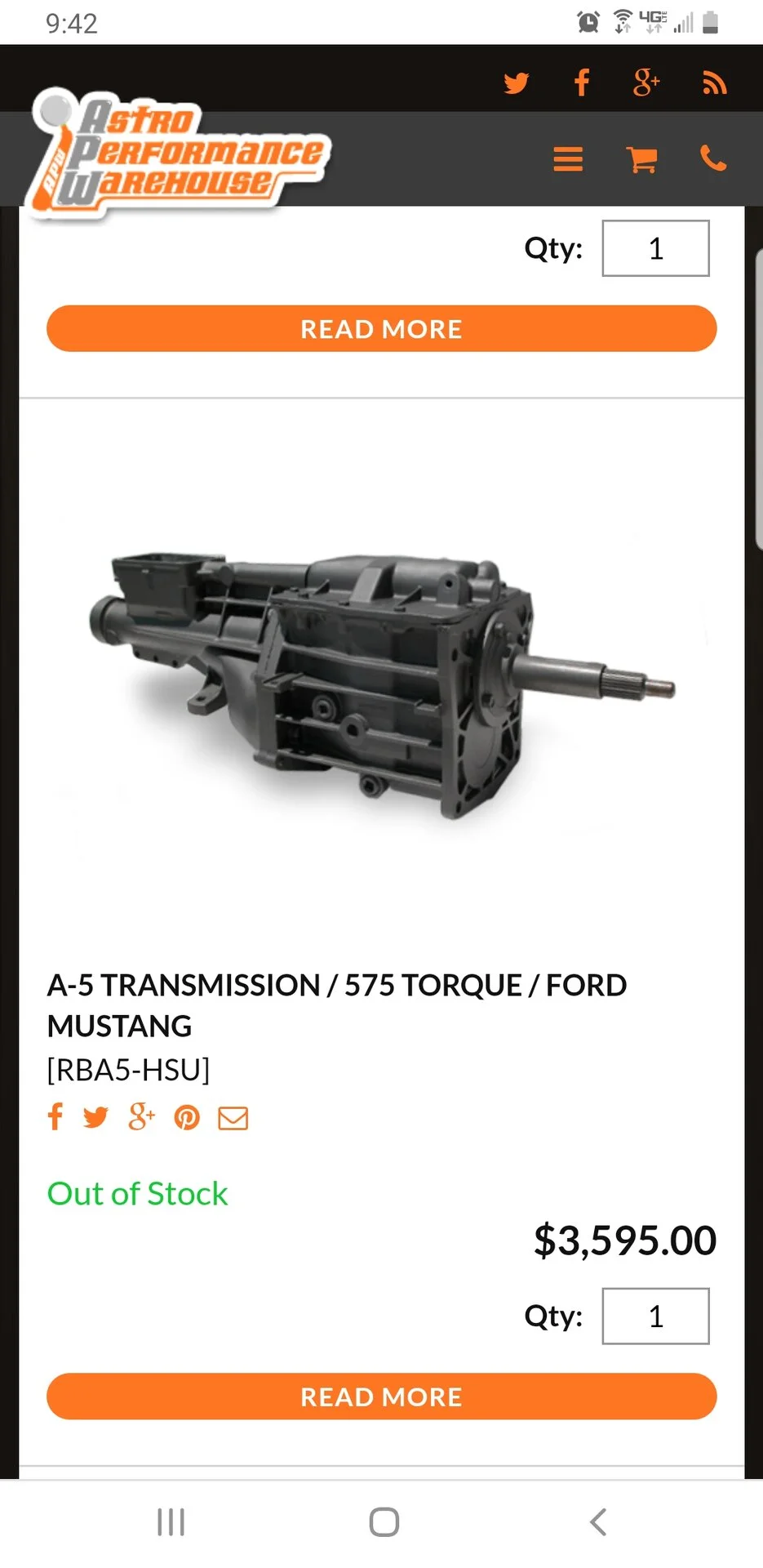

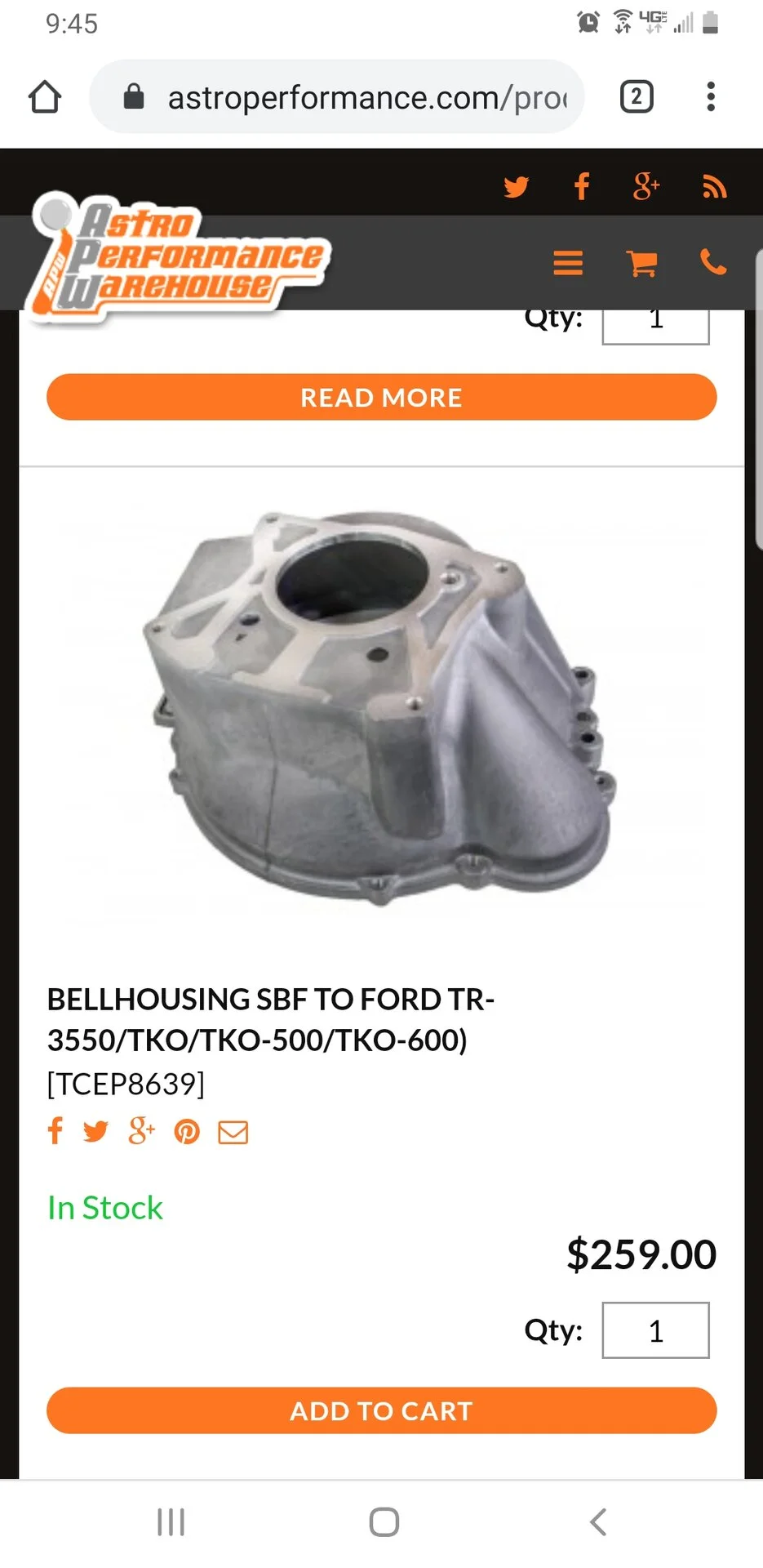

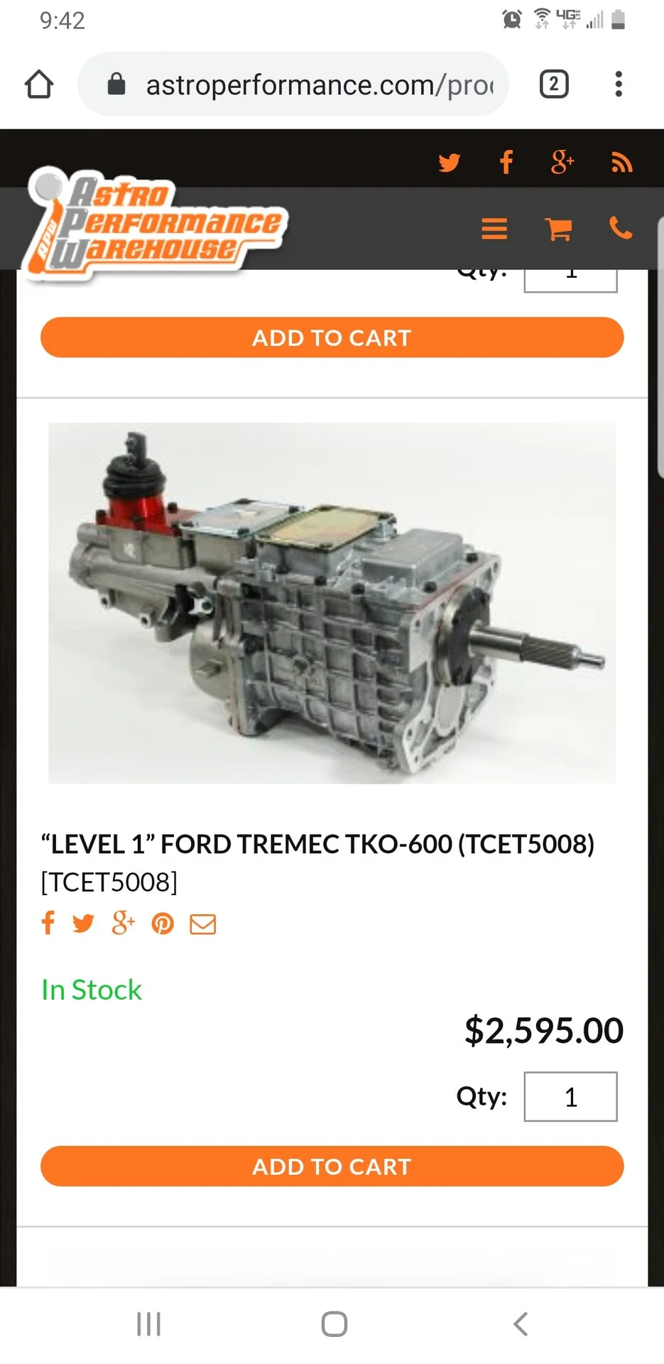

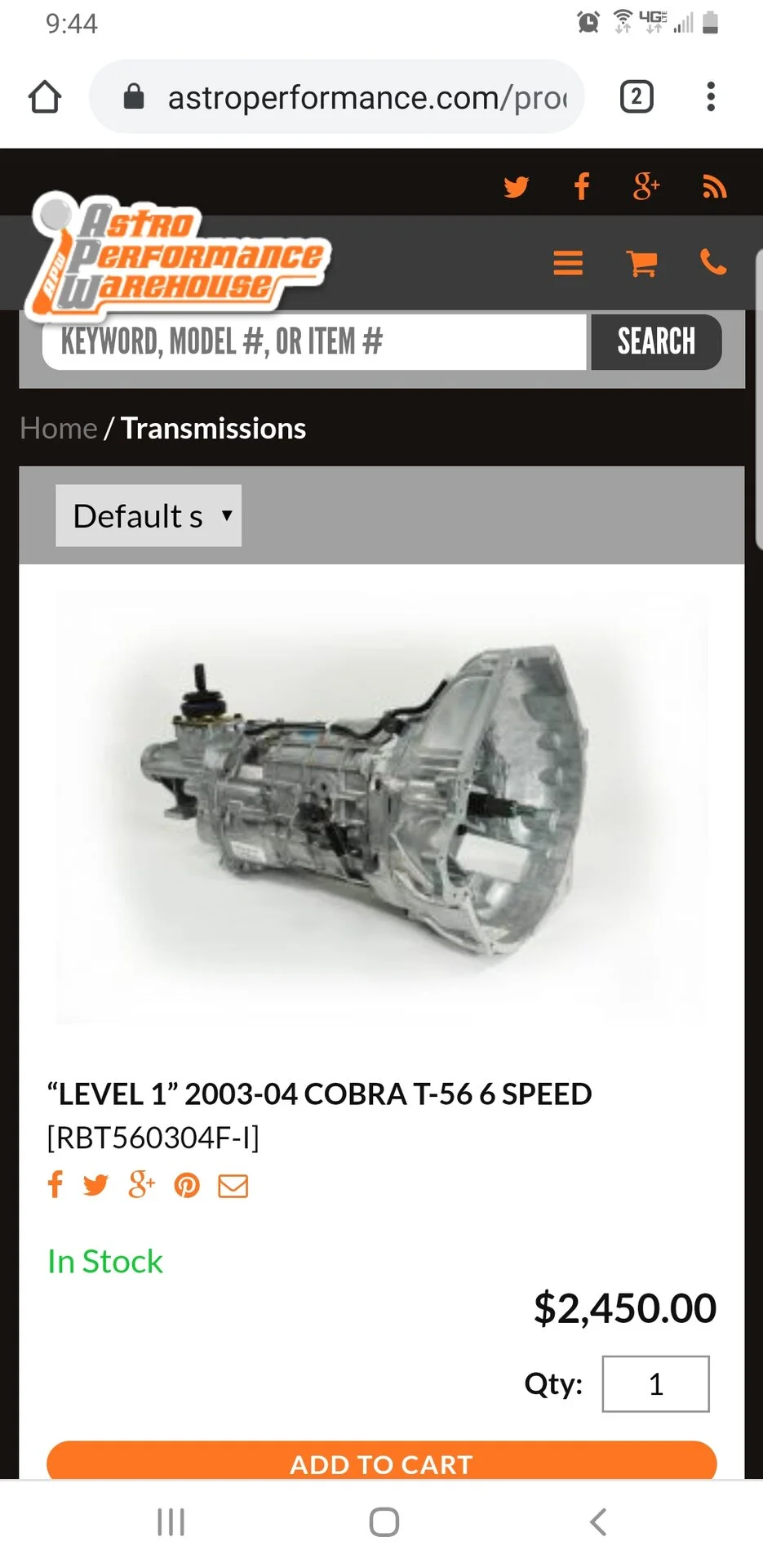

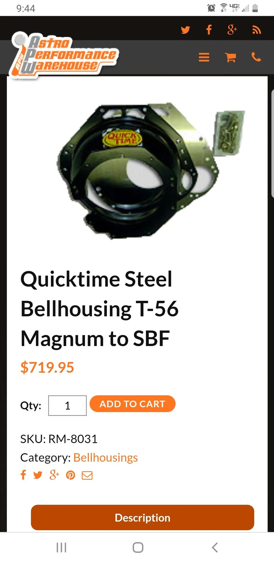

My decisions are down to these...
Most expensive...out of stock. In stock equally expensive with 700 dollar bell housing...
Seems like it may be the cheapest with bell
Seems like the tko 600 might be the best option cost wise. Shifting can be a little notchy and noise isn't uncommon. The t56 would be my favorite option but only with the .50 6th gear. The astro a5 could use my existing bell and cross member....but the higher price and out of stock listing may push it out of the deal. I'll have to contact Astro tomorrow. Smh

For the money, what's the down-side of the TKO?
All I know is that they can be notchy getting in gear...and I've seen a few that whine. That might be because of straight cut gears. Guys at the track used to always run them. It's the proven mustang transmission. The A5 is good too but dang the price is up there.

Modern Driveline sent me a quote for the whole t56 install kit. It was just under 6k :puke:
