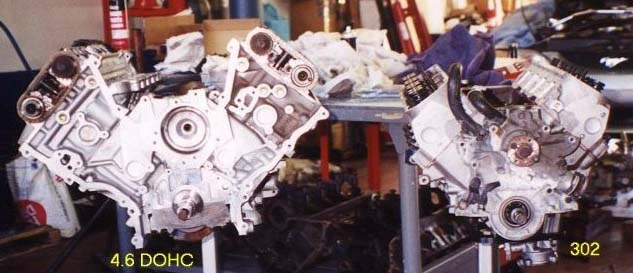

Pesonally, I think mod motors were a step backward. Sure they are strong and can make lots of power, but look at the package! Displacement shrank and the engine grew......dramatically. It's not like all that valvetrain allows it to rev like a bike either. On top of that, there is hardly any room for stroker cranks. Then again, Ford seems to be good at shooting their own feet. I would have rather seen a skirted, OHC, all-aluminum 302/351W based duo, if anything. I guess from a practical standpoint, the gains aren't worth the trouble or cost.

I used to think the same as you, but after reading about some engine builders getting over 1,000hp with a stock block, crank and rods I think maybe Ford must know something. Try getting anywhere near that with a SOHC 427 and you'll find out why those motors are extinct. Time tends to cloud the faults of some of the icons (like the SOHC 427) when in fact they were nowhere near the equal of Chrysler's Hemi, and stock Hemi Mopars would have their heads handed to them by a modern 4.6 Cobra.
1000hp on stock modular ford rods is laughable, most guys making over 300rwhp NA are using aftermarket forged internals, I'm not saying thats the limit of stock rods, just that they are apparently marginal enough at that level for most people to replace them. Modular engines, other than boosted DOHC engines, have absolutely no advantage over a 302 or 351.
