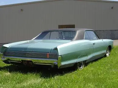

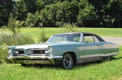

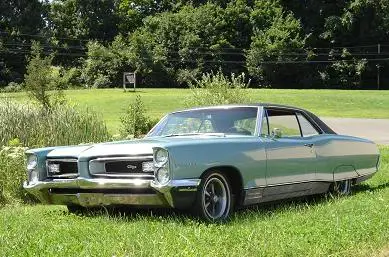

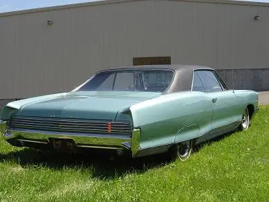

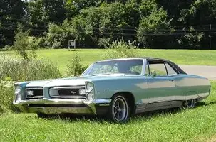

Here is a pic of my hauler..........
1966 Pontiac Grand Prix
