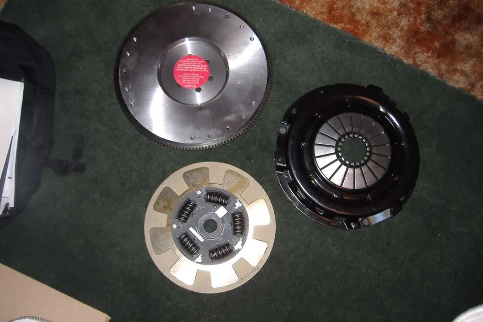

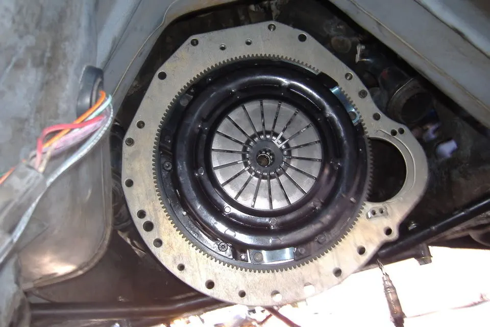

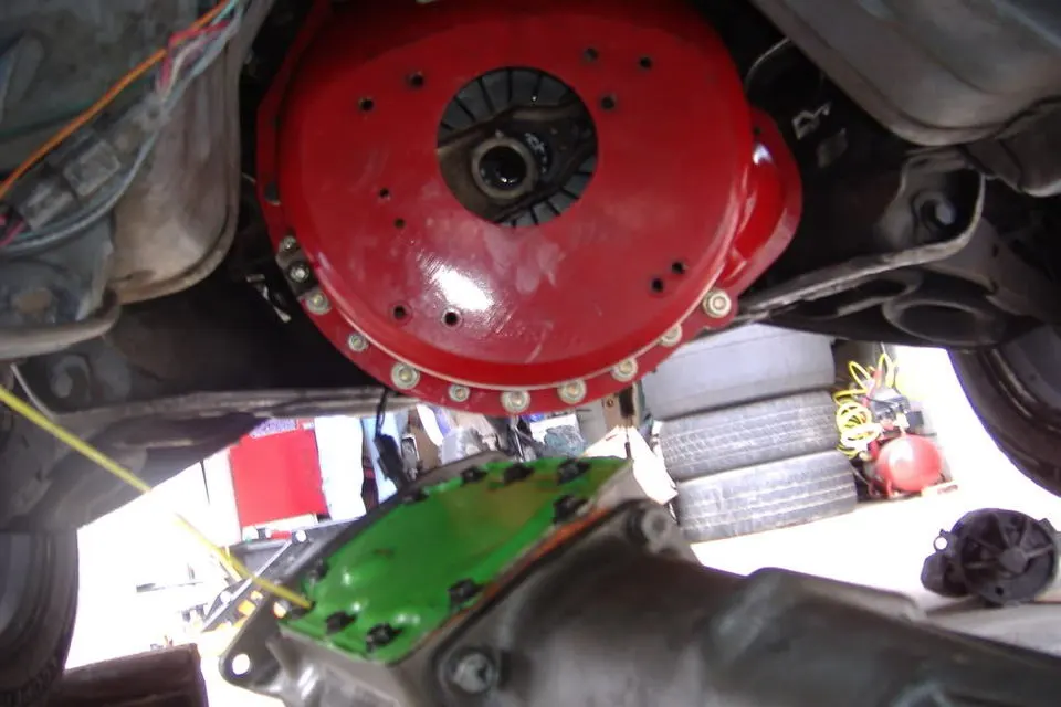

Ram billet steel flywheel and Zoom kevlar clutch

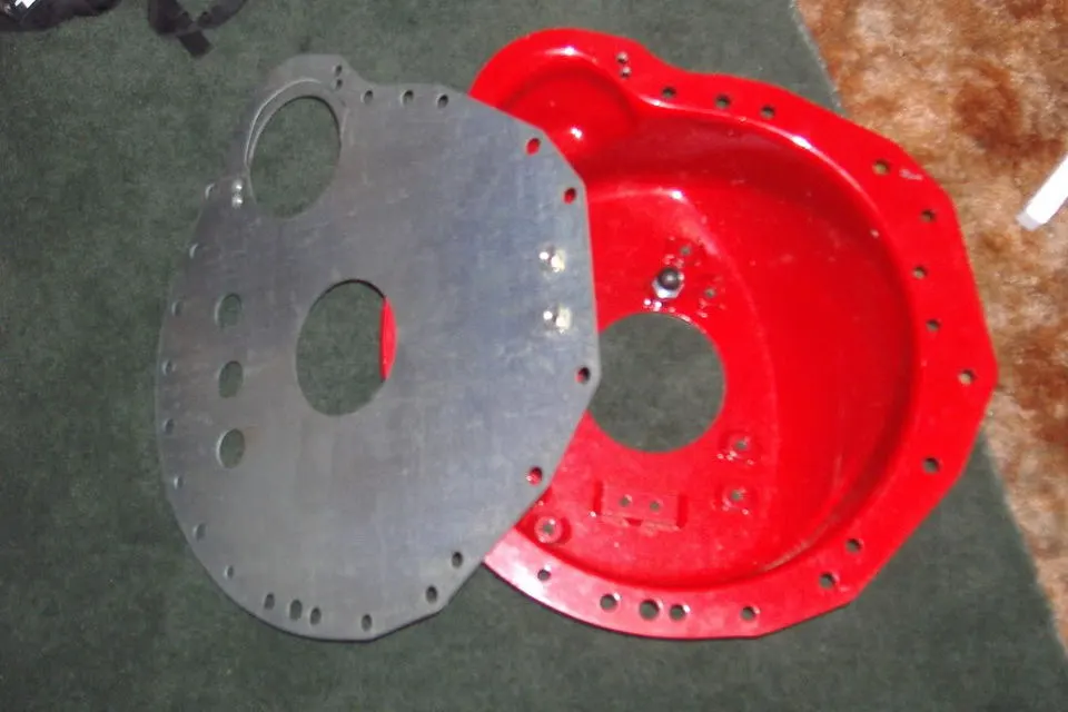

Lakewood blowproof steel bellhousing: this is the main part of this conversion. Lakewood makes this bellhousing specifically to allow you to put a toploader into a foxbody Ford

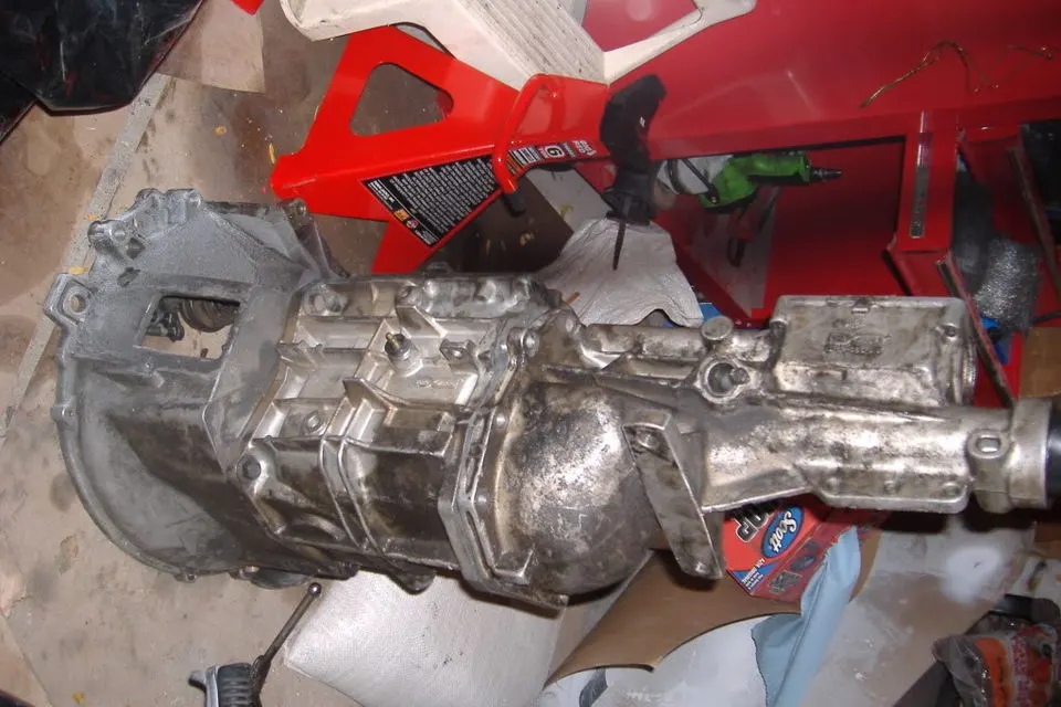

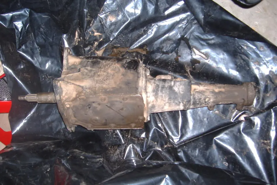

The old T-5

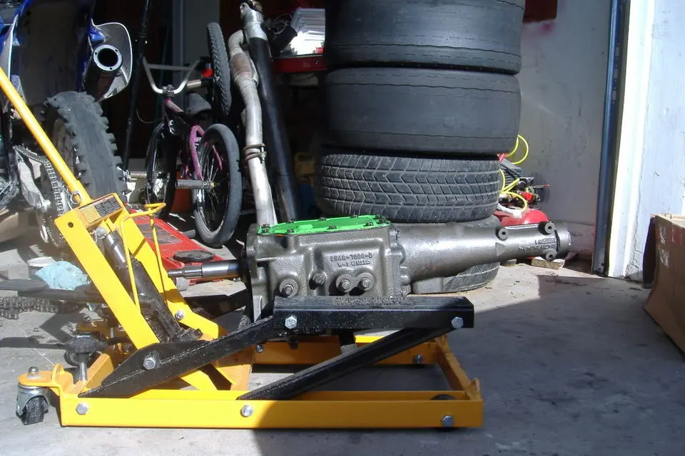

The new/old Doug Nash clutchless toploader that my dad had in storage for over 20 years. took it to a trans shop and found out it wasn't clutchless

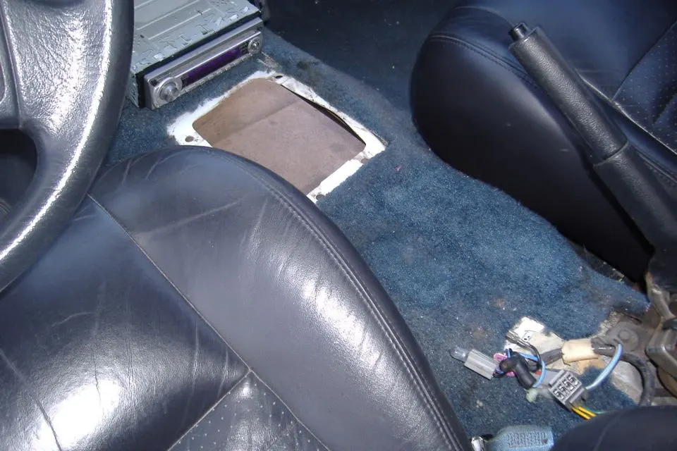

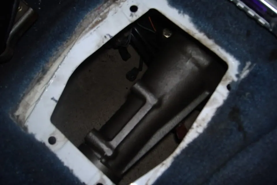

I pulled center console out so when i get the new trans and shifter in there i can see if i have to cut the shifter hole anywhere to make the shifter fit

picked up the transmission on friday from the trans shop

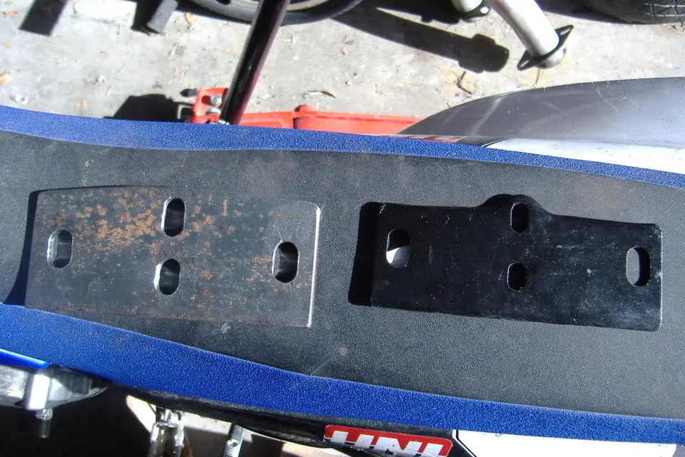

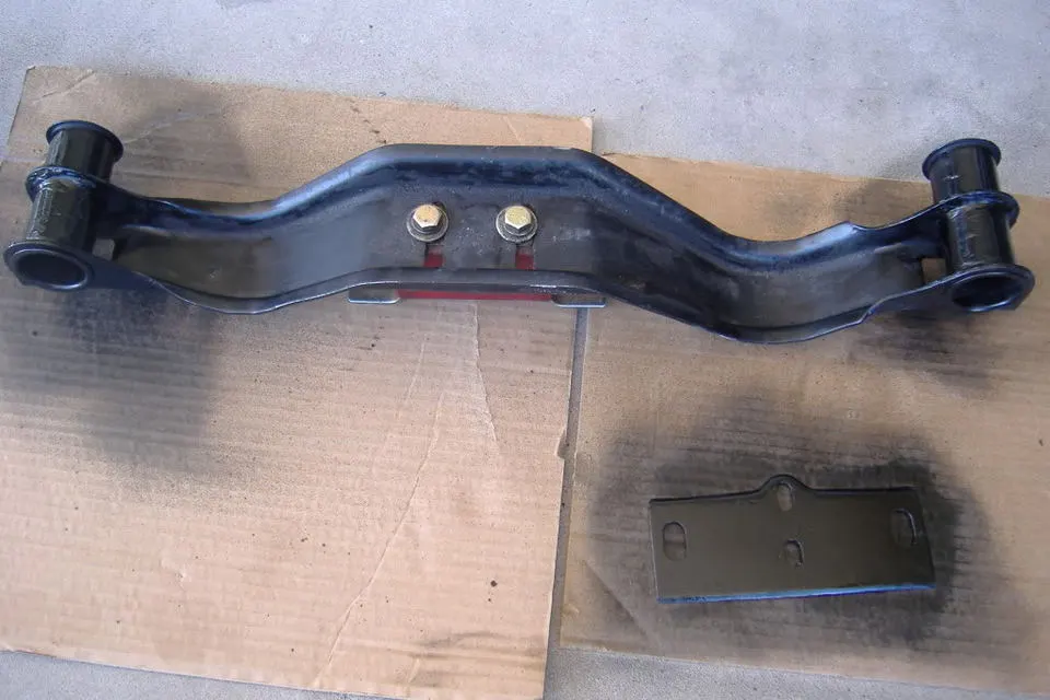

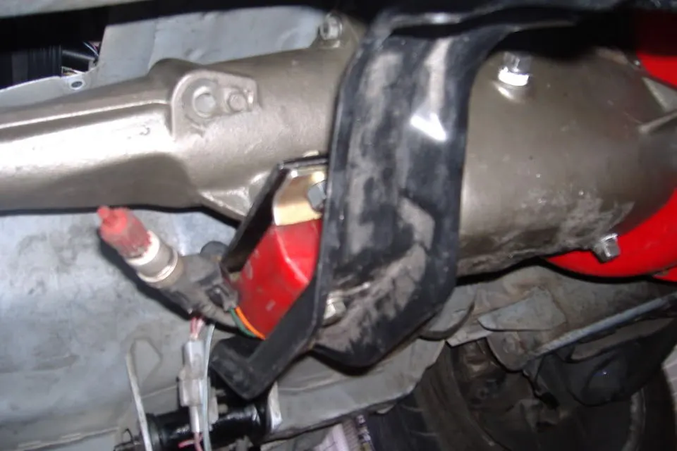

went to my dad's friend's shop friday afternoon to make a new mounting plate that goes in between the trans and trans mount

looks like i won't need to cut up the floor to put a shifter in

All the money and parts in the world won't make any T5 as strong as an "average" top-loader. Ecxellent choice there, if you don't need overdrive. The reason the Tremec's are so strong is they are built similar to the top-loaders. I used to run top-loaders in my older stangs and mavs. I NEVER lifted off the gas while shifting. Top loaders can handle it. I still have a couple of them just in case I need a tranny someday and don't have money for a Tremec.

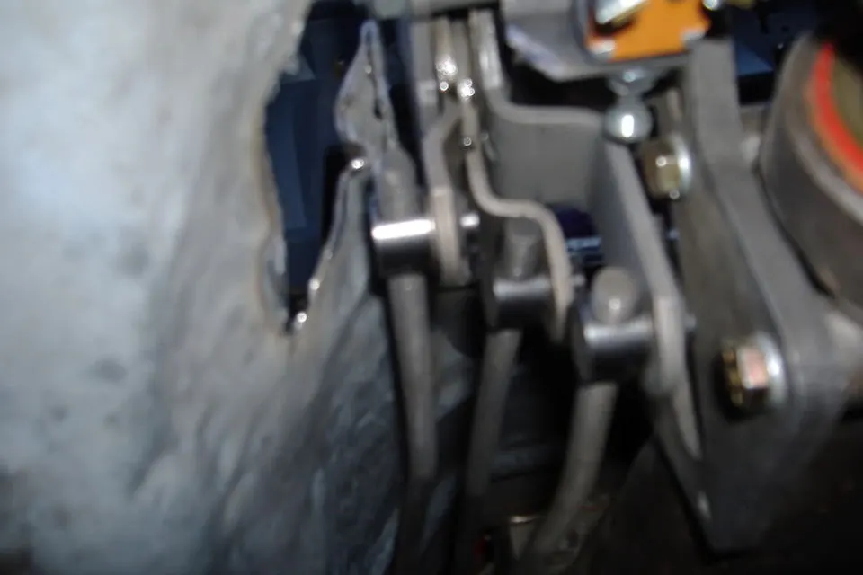

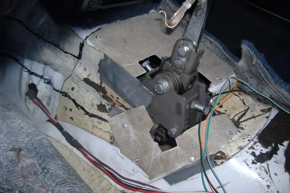

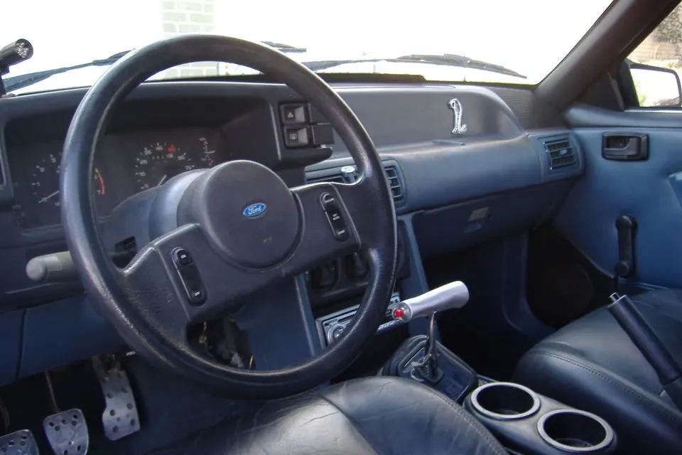

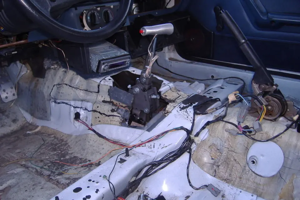

my dad ordered a Hurst Super Street shifter, Super Street install kit, T-handle shifter, shifter boot, and back up light switch and they came in earlier this week.
we went ahead and put it all in last night

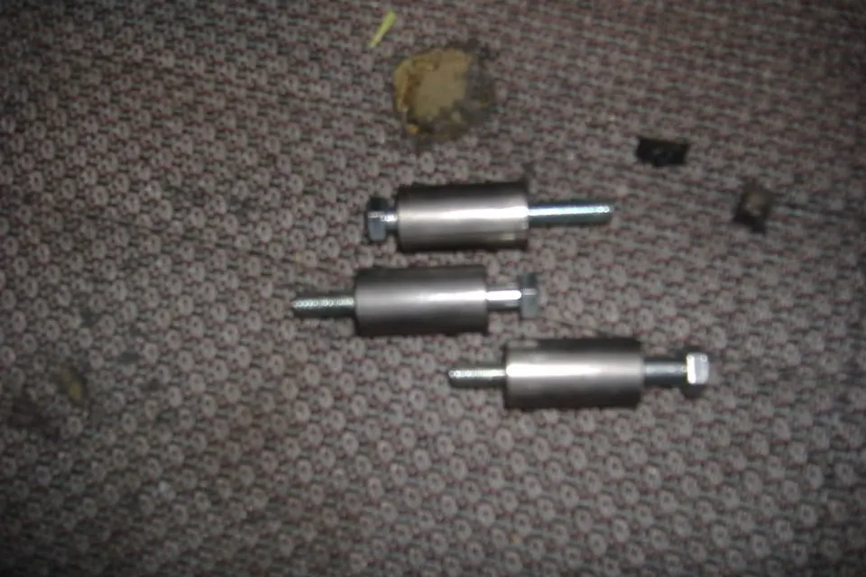

these are spacers that go in between the trans and the shifter mounting bracket

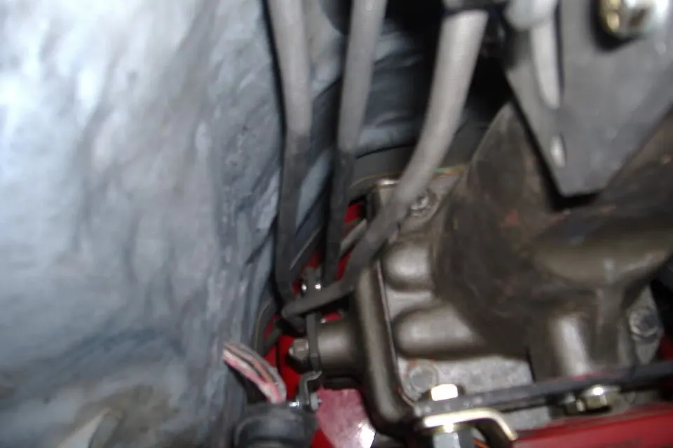

but since i didn't want the shifter to be on my seat we left them out and bent up the shifter rods so we wouldn't use the spacers
we had to trim the trans tunnel a little bit but the shifter will still fit under the stock center console...barely

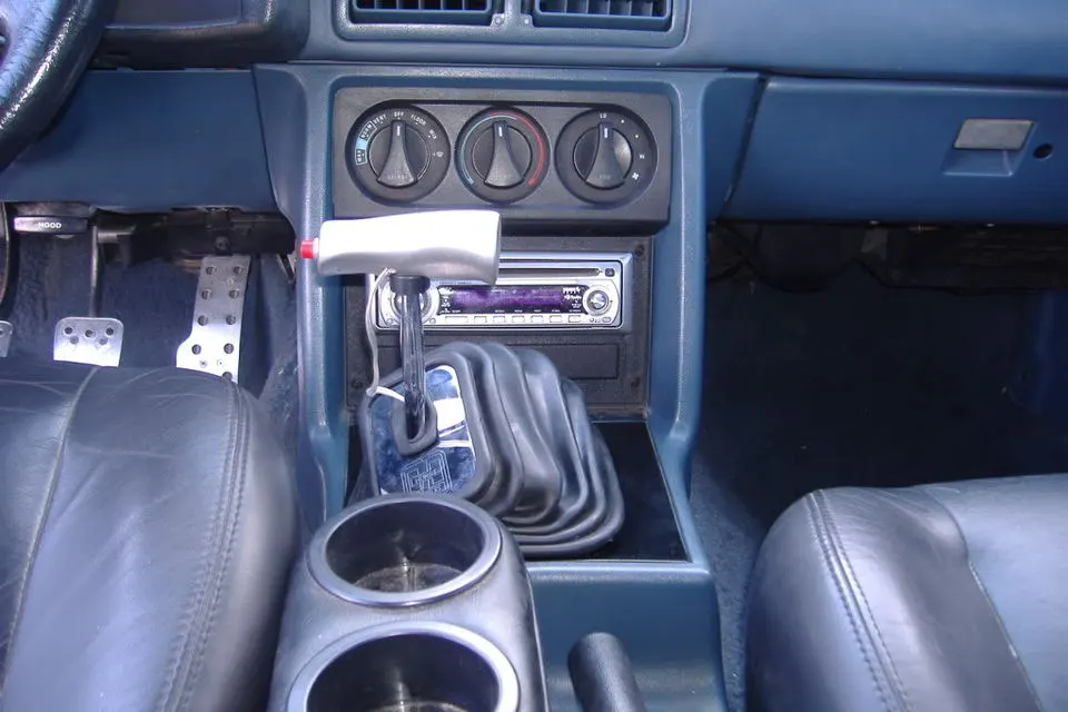

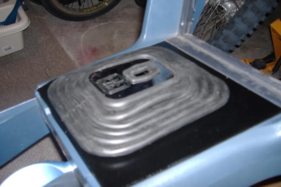

fitted a hurst shifter boot to the stock shifter boot bezel
now all i need to do is put the interior back in it and get it registered and inspected and she will be done!!

Looks great! I did the same thing in a 90 GT after my T5 took a dump and I read about it in a mag. I loved the toploader. Takes some tweaking to get the shifter perfect but well worth it if you don't mind no OD.
